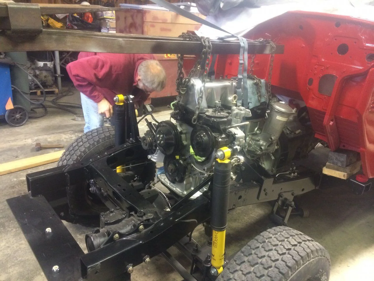

Sadly due to a project building a yurt all year I haven't had the money to throw at the project nor the time to keep researching small things that needed done. But the engine/trans/t-case are in for the last time (hopefully). Everything is looking good. Body mounts should be on today and then placing the cage and seats in the next few days to clean up shop space.

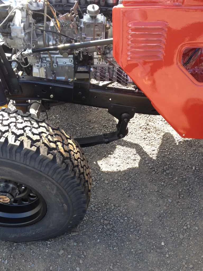

Only real issue is it looks like we are going to have to move the rear shackle mount forward on the front springs. The weight of the engine moved the springs down a couple of inches but that shackle angle isn't going to fix itself with more weight.

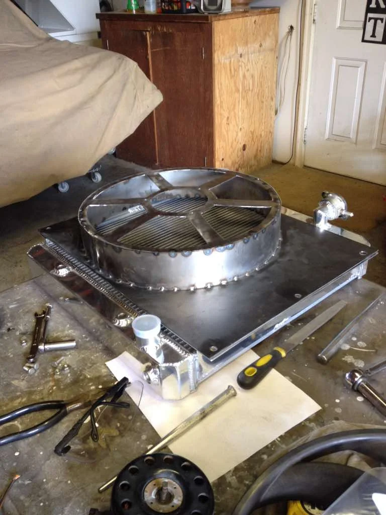

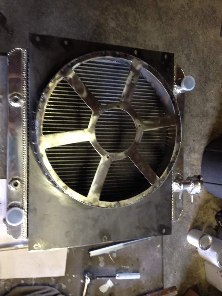

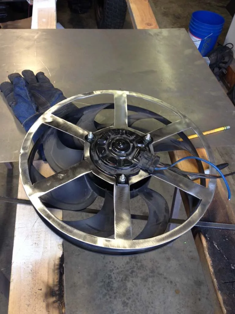

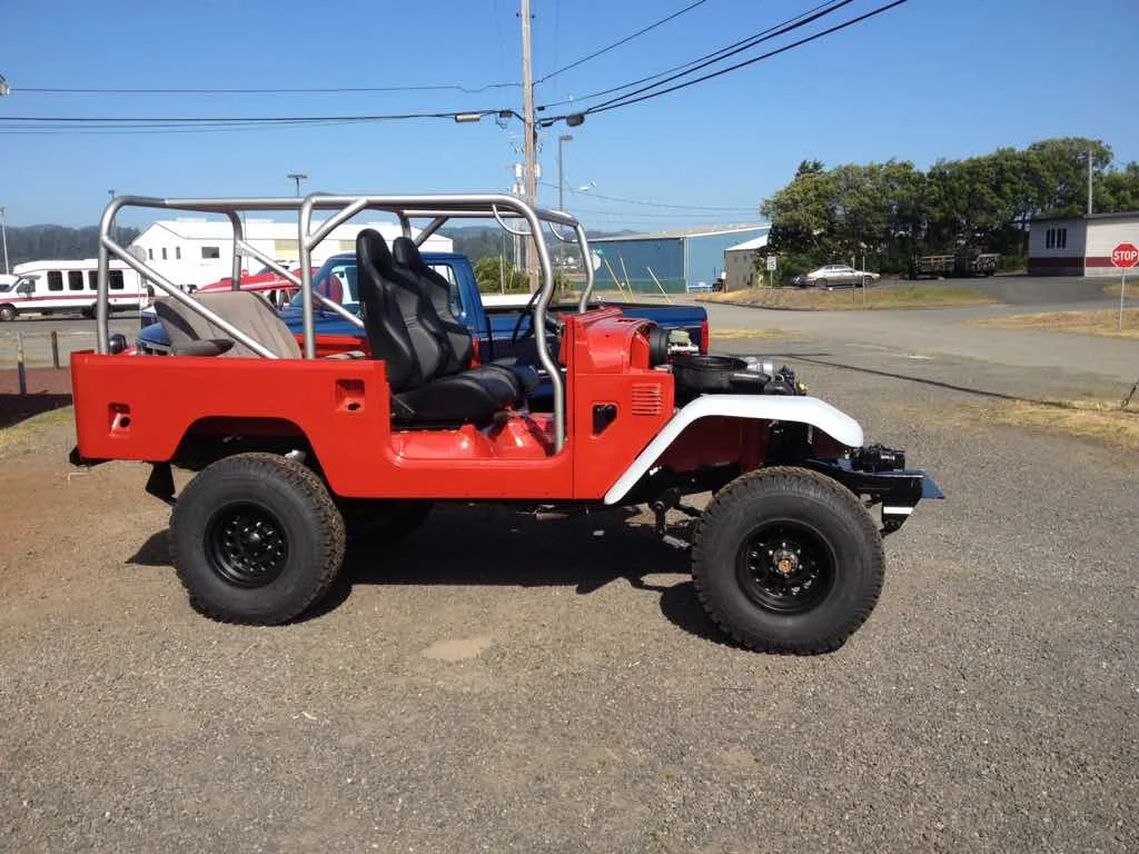

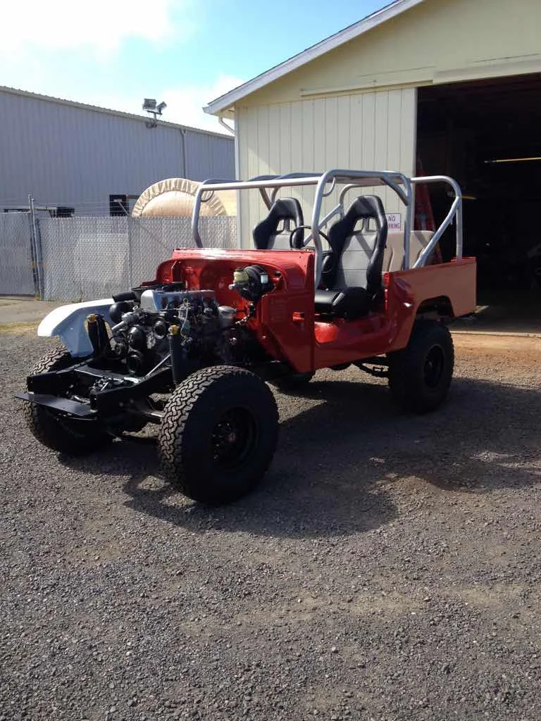

Highlights were building our custom fan shroud for the Taurus fan on the new aluminum radiator, painting and installing the roll cage, and installing the tires/wheels.
Accomplished a few other things like got the seats in permanently, painted and installed the fuel tank, mounted the steering column, brake booster, clutch, Installed a new torque reduction starter and a bunch of other small odds and ends around the engine, like timing the fuel pump, installing injectors, glow plugs and the like. Messed around with the AC compressor for 2 hours and still never found a good way to mount it that I really liked. To big of a pump and not enough room next to the frame.

We will have to redo the front suspension as the hangers are to far back and the shackle angle is way off. Moving our axle forward makes the wheels look a bit odd in the front fender well so that may be something we have to address in the future and my offset/backspacing in the wheels leave them hanging out past the wheel well about an inch in the back and I worry about rock chips and flinging mud. Sadly already painted the rig but though about welding/molding some flares in the rear or tubing. I'm not a big fan of the bronco looking fender flares you often see. Anyway millions of decisions to make still.

I call it the star fighter and I wanted to clear the whole thing with my dads signature and all the weld marks as they were. My dad in his perfectionist ways finished it up with seam sealer around the the whole thing and painted with a high grade black paint he uses for industrial trailers.
Let me tell you this thing really sucks some air. We had much less room than I thought do to moving the engine forward with the 5 speed transmission. To the point we could not center the fan to get it to fit in between the pulleys. But testing reveals it will pull air through every part of the radiator and she will suck better than your high school prom date. No worries at all about cooking in the future. With the progressive controller I'm hoping it barely ever runs.

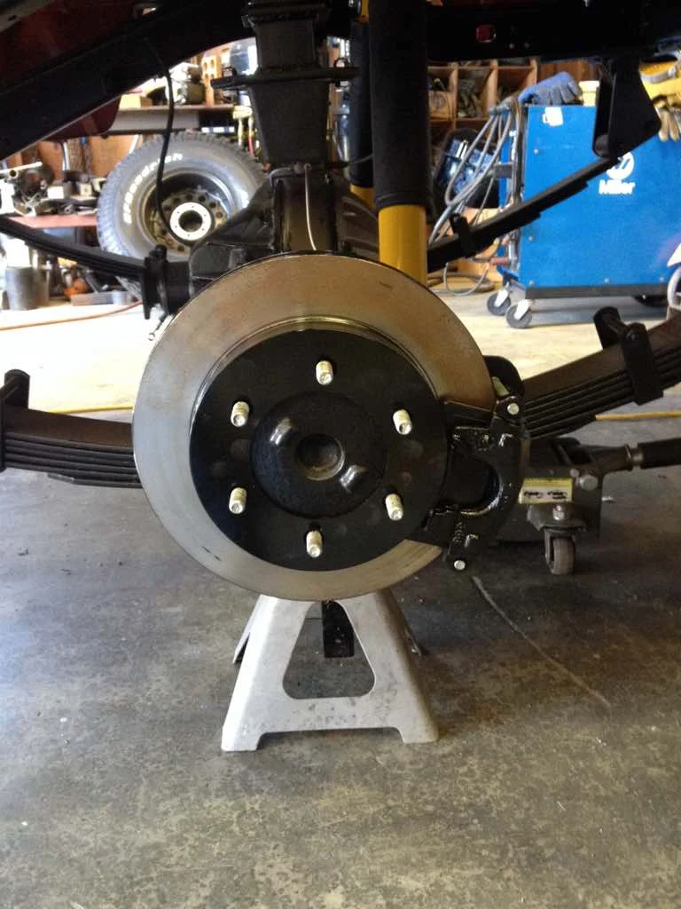

I pulled the rear rotors and calipers and painted them as well. I thought they had been painted silver from the factory but it wasn't and was blood red from rust from the fresh castings and salty coastal air. Need to get that thing out of there and to a warm dry place or a dehumidified garage.

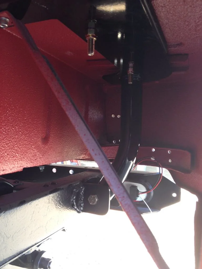

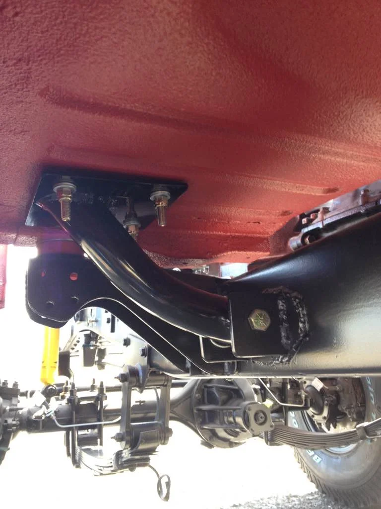

Pictures of the roll cage mounts we built to tie to the frame. Bushings to reduce vibration. Family should be very safe.

Sadly I didn't take a lot of photos. The custom springs in the rear are heavy an as others have stated that all the fj45 length springs from alcan are short. I'm hoping they will lengthen enough when I get more weight back there with the top and rear fuel tank to squat it down. And bring it level with the front. Also see shackle angle in the front. He miss measured by 1/2 inch on one side and 3/4 on the other. Unless they flatten out we are going to have to move the rear mount forward at least 2 inches to get the appropriate shackle angle. Anyone have thoughts on this that have installed the MAF kit? I actually like at one in a parking lot on a fj40 while in town and he had the same problem with his shackle angle straight up. Also tracking that he put the rear shackles on upside down. At least I think. The directions he got from MAF had them that way though so who knows.

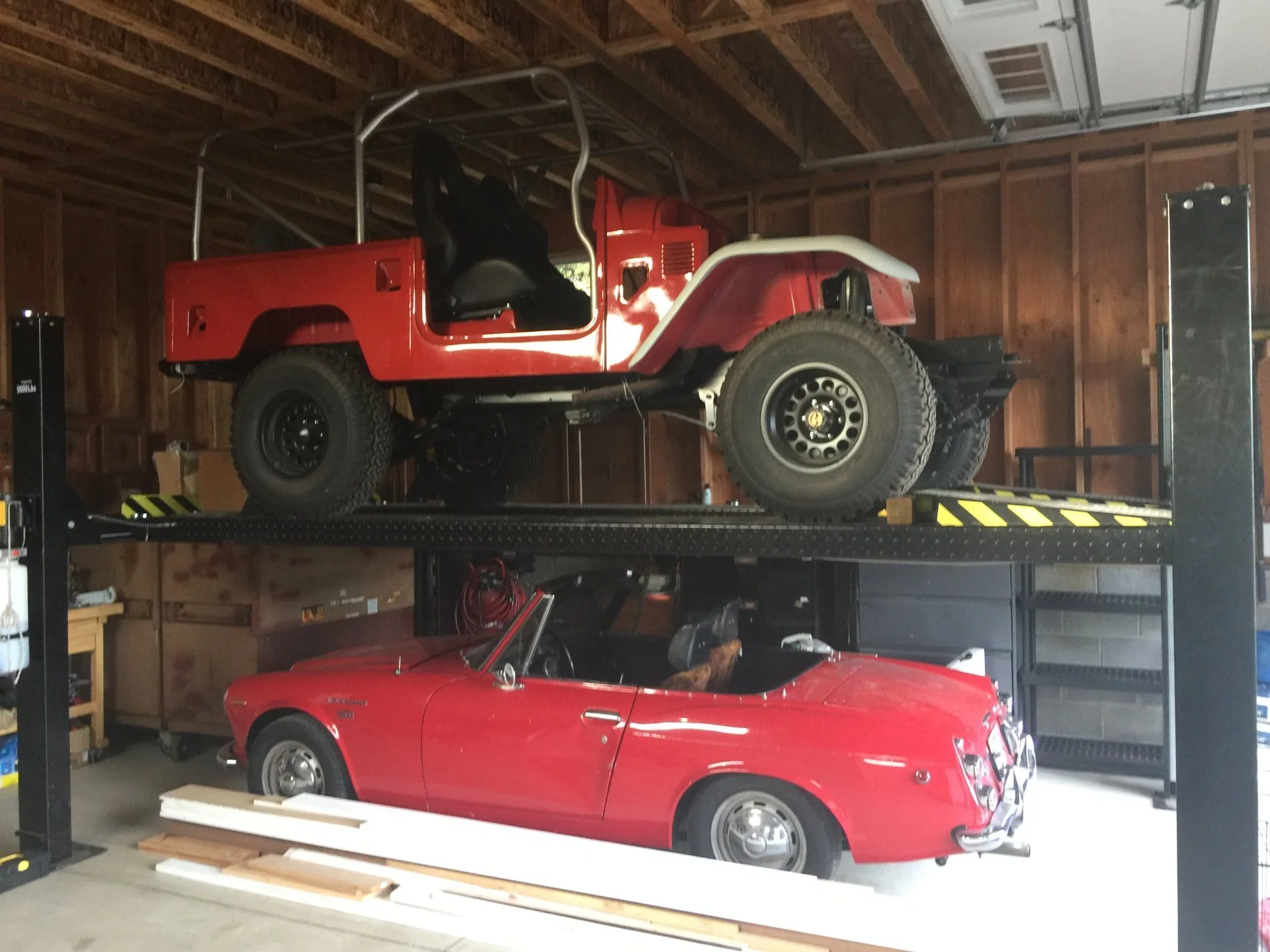

I have not done ONE SINGLE THING to the cruiser since the last post. Moved it from my dads shop to give him more room and into my new garage. In the middle of my second mid life crisis I picked up a Datsun 2000 Roadster that I have wanted for some time. Luckily only took a few weekends of work so far and not much money. Something to satisfy my urge to drive something Japanese and red until I finish the cruiser. Sadly no spare funds or time for the cruiser so it may be another 5 years before I get to it. Must be the Traylor curse as my dad did the same thing with his 56 Ford. Would love to get on it though and meet up with some of you in the Oregon area. In North Bend/Coos Bay area on the coast now.

Side note...only 1/2" to spare between top of lift and cruiser when moved to the bottom in the priority position.
