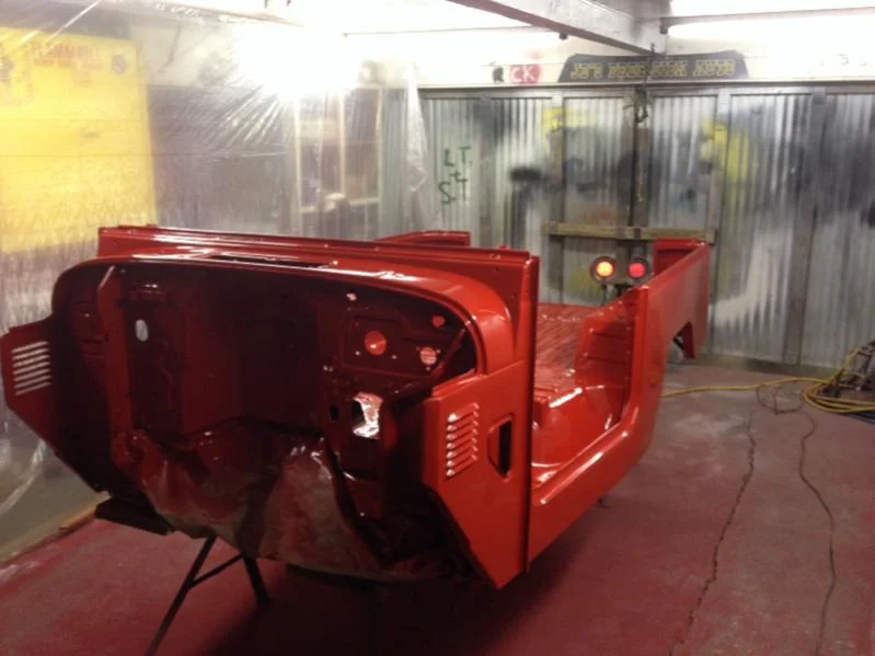

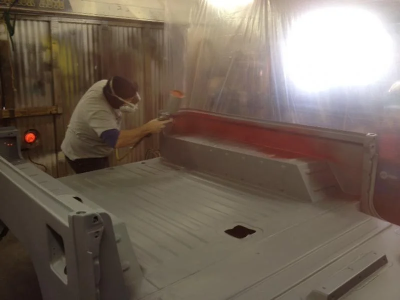

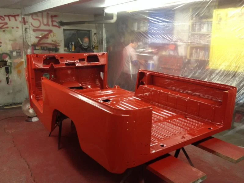

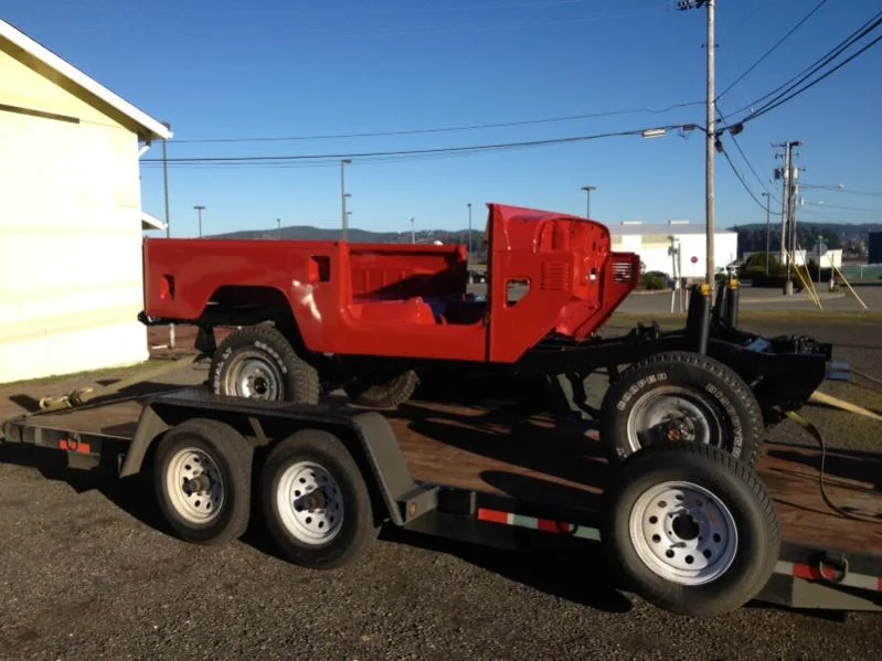

I had a few photos of my truck. We painted the body while I was home but my phone is not making it easy to transfer right now. Shot it with PPG Concept. Expensive stuff but shot real nice and laid down well. That is until our heater ran out of propane while we were letting it dry and it orange peeled up a bit. Nothing horrible but nowhere near it was after 30 minutes of shooting it.

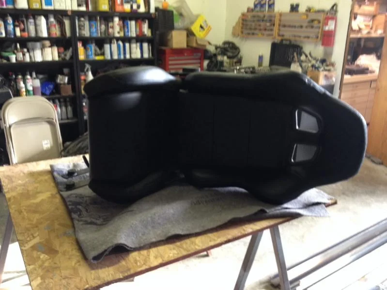

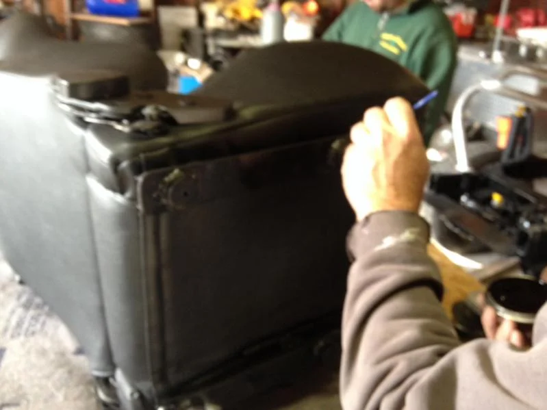

I did a bunch of body work and installed some seat mounts on the seats and then installed the seats in the truck. Figured out the body mounts and got those on the truck as well. Messed around with some parts and checked out all the work that has been done. Still a LONG way to go. Biggest hang up of course the engine. I should have just purchased another engine and car and been done with it.

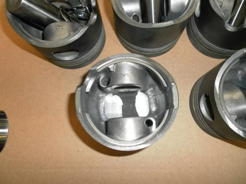

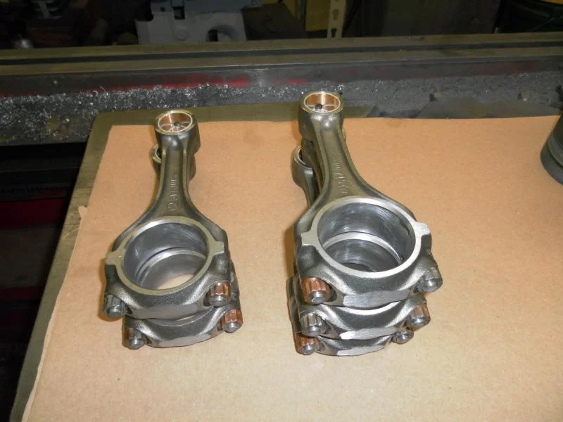

Trying to figure out how to post more of the pictures I received on my phone. The block is decked and everything balanced out well apparently. Some of the pistons were 15 grams off all by themselves. That is amazing in my mind for an engine that is known for superior longevity and relative smoothness. I guess Mercedes really had that external balancing thing down.

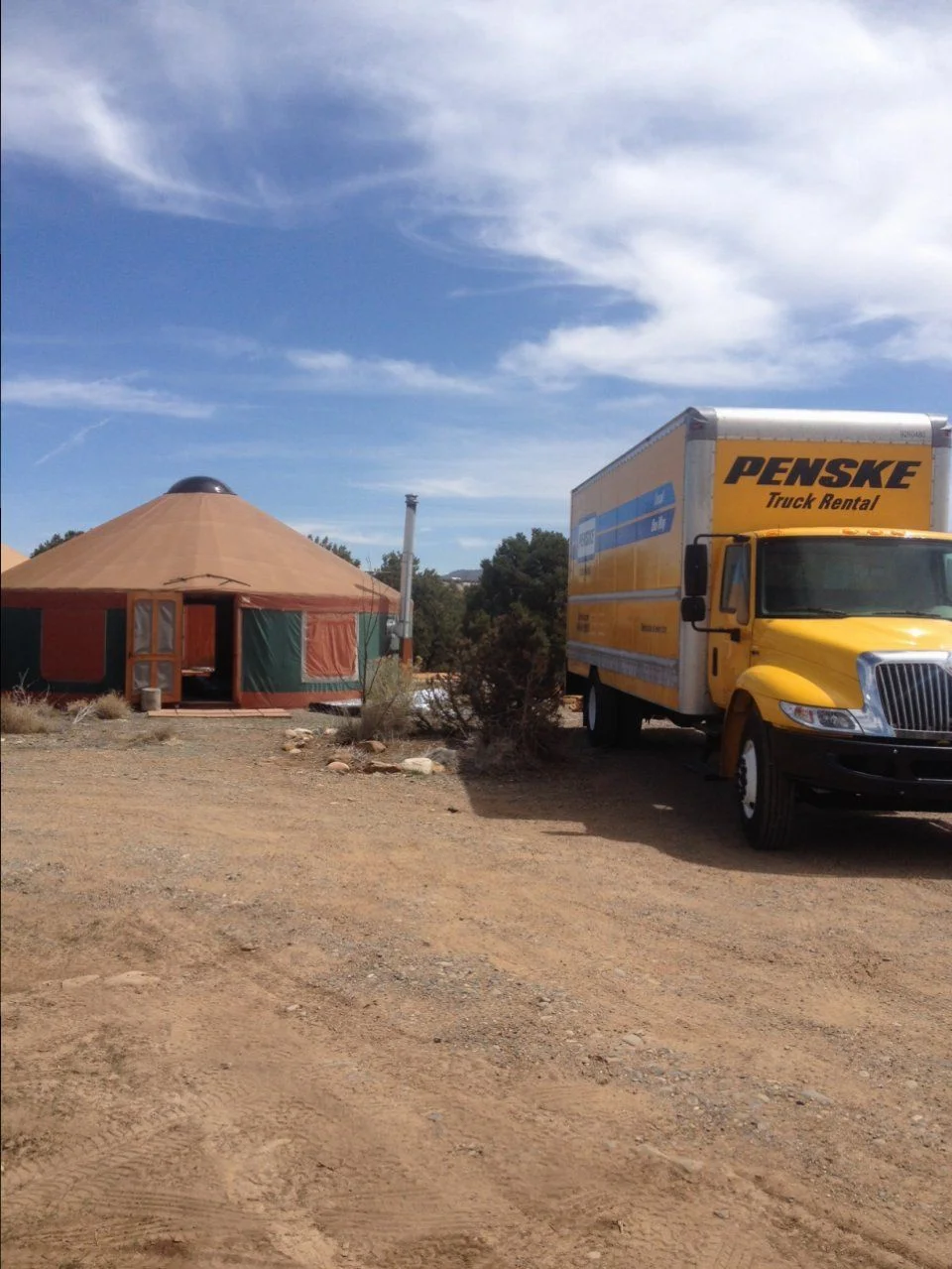

Been pretty busy and have been sidetracked by another project. Started working on moving off post and we are building/moving into a couple of Yurts in a couple of months. Flew to Colorado and met up with my dad, tore them down, then drove across the country to Savannah GA where we are currently hoping to raise them when I get a few days of nice weather, no work, and no babies :)

Not sure how much I have into the engine and it would have been much cheaper to scrap out a few cars and keep extra engines on hand but this is just not that kind of project I guess. Builder said he could not believe how much external balancing they use from the factory. He also noted that the flywheel that came with the adapter was horribly out of balance as well. Should purr like a kitten up to 5K RPM :clap:
