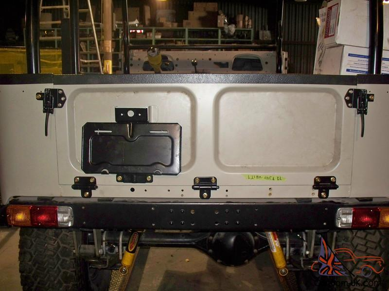

I noticed some tailgates have 2 holes on the hinge portion that bolts to the tub, I have also seen one hole (see picture).
What is the reason for the difference?

This is not OEM, this is an aftermarket product. The OEM version had two doors (left/right) with hinges on the outer edge.

This is a OEM door to the best of my knowledge. It still has the manufacturer sticker on it.
I've seen these as well. Maybe it's for the later models with tailgates. Say after 73? Mine have the 2 holes

Your latches look like they're OEM, but the hinges look aftermarket to me. I haven't seen them before, but I haven't seen everything.

Yep, I may have spoken too soon. I understand they were very rare. Specter Off-road sells the retro steel aftermarket ones.
This is an OEM hinge on my 2/73 FST
I show a hinge change 1/79. Years ago I bought this tailgate from a wrecking yard before a friend needs the hardware. At that time the only hinges available were the newer style which didn't met what my friend needed.

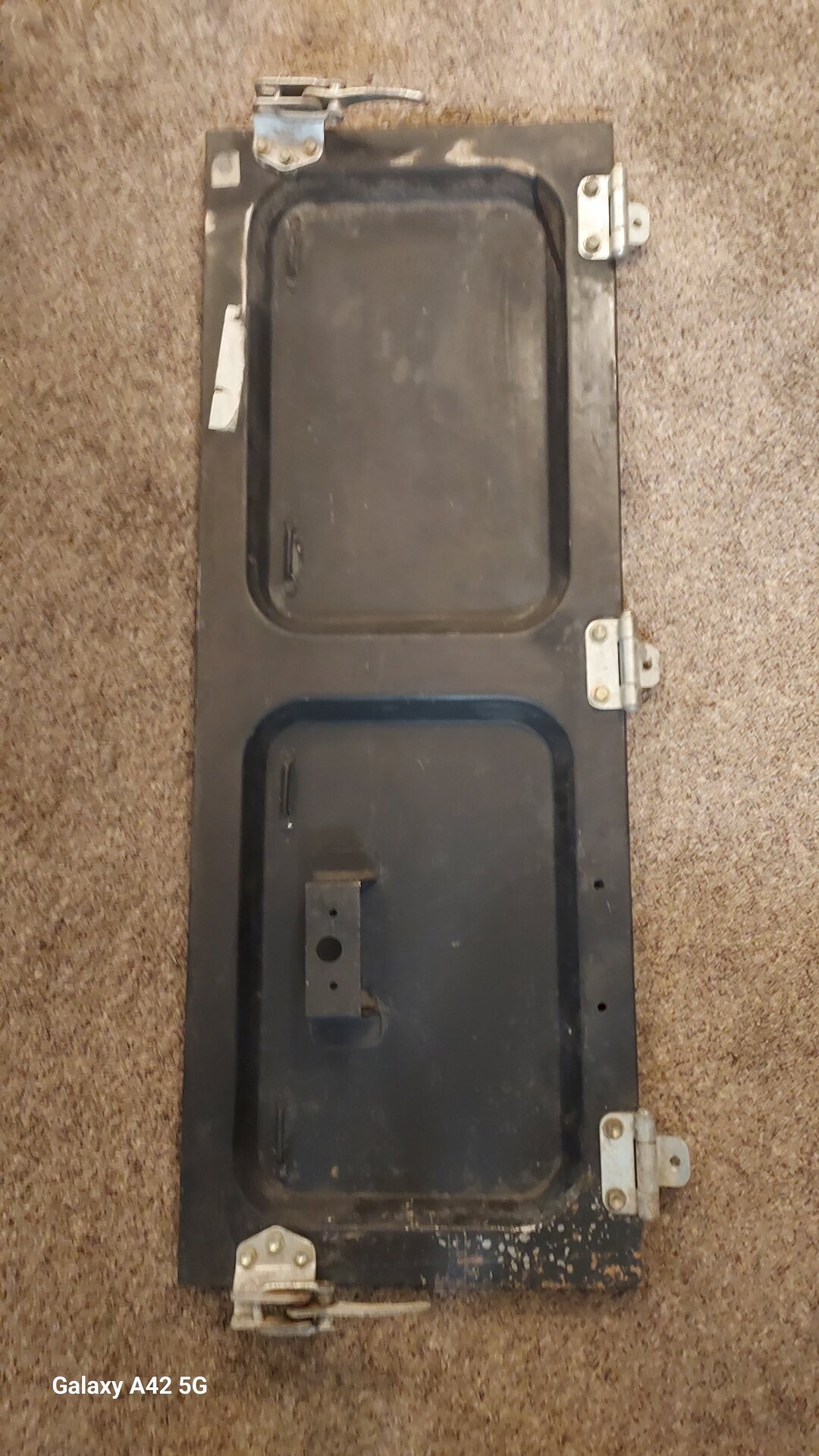

Here is two different OEM tailgates. The one on the left was off a 62 FST. Center channel is narrower.
This black one is an OEM replacement still with the black primer.

I checked SOR and did not find any reproductions. So far I've found one image showing the single bolt attachment setup.
There are two holes in that one. Just hidden because of the camera angle.
The repro's we make are 2 hole just like the factory but we have done ones with single holes or a shorter tab when we are doing a custom job and don't want to destroy the rear sill on the late model tubs.
