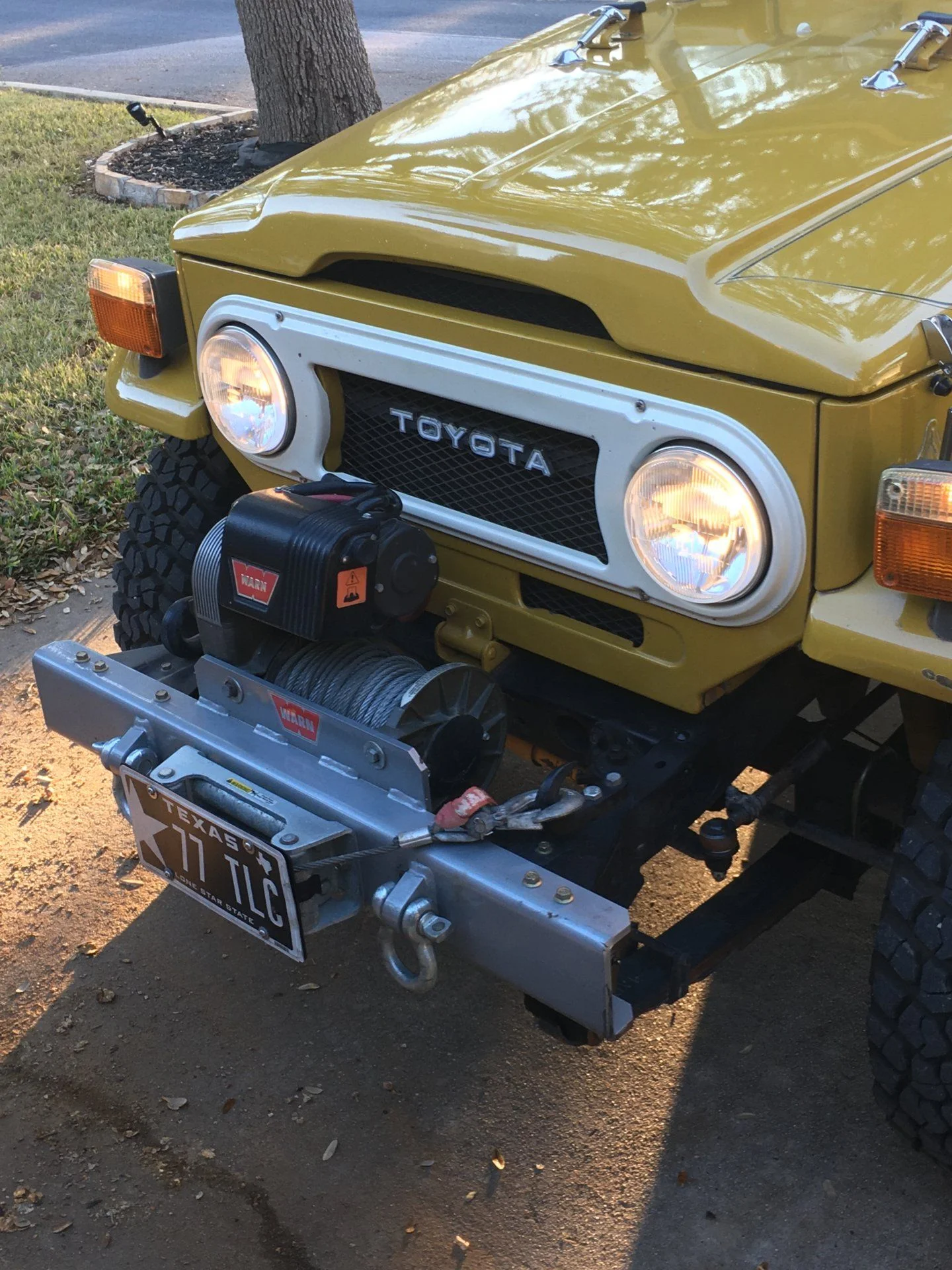

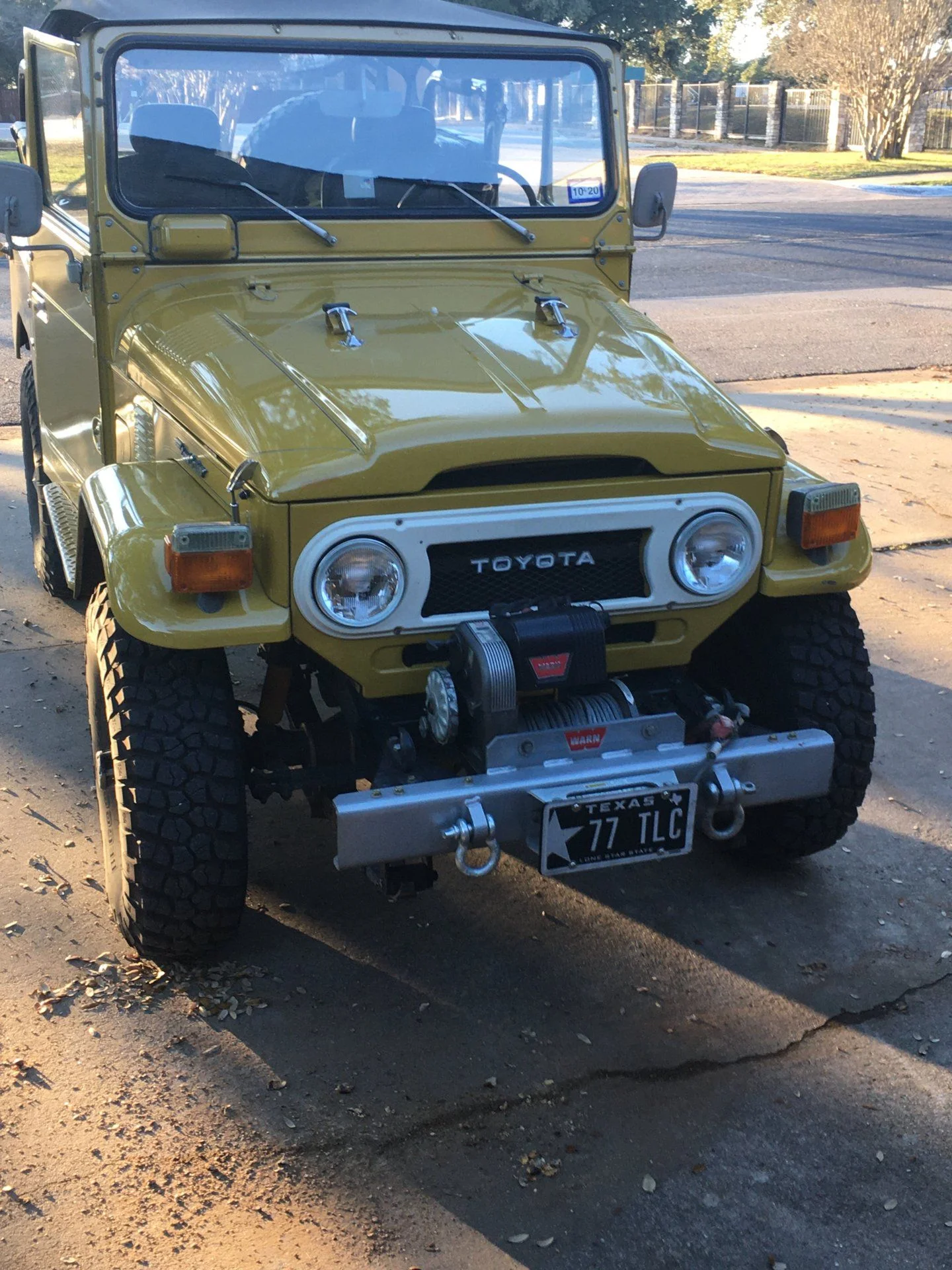

I do miss my 55The Warthog got its new eyes today

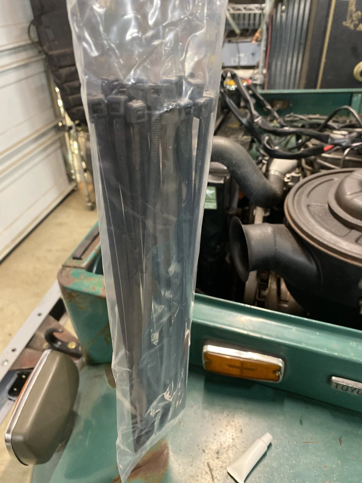

I spent more time zip tying lines than it would have to cut them for sure lol

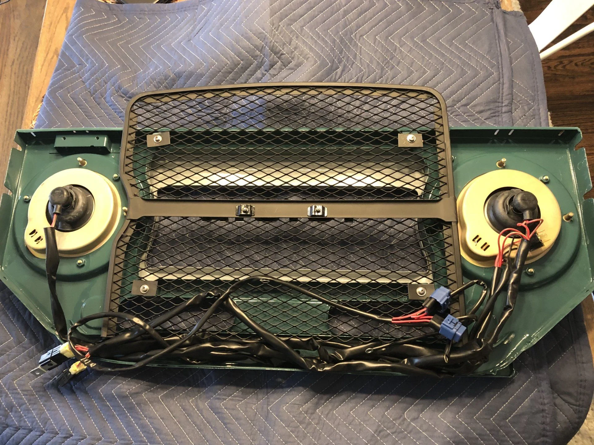

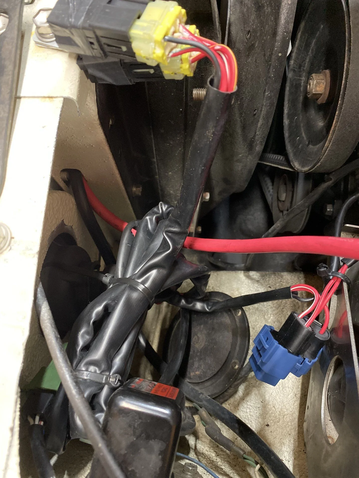

Can you guys show how you routed the loom between the headlights? I pulled the 40 in the garage and unrolled the harness and was surprised how long it was between the headlight plugs. Decided to hold off and see how you all tidied up the wiring.
I’m talking about this style. Is this the type you have? If so, how did you get that plug from the supplied harness in that housing ?

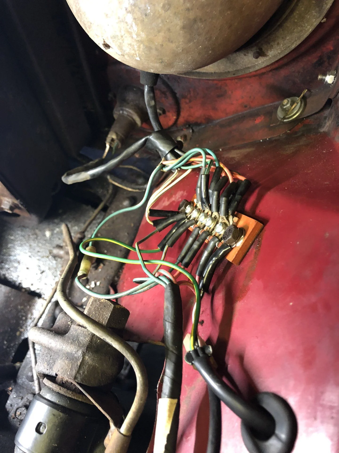

wngrog, sorry to go backwards here, but what what year is your 40? The reason I ask is that on my 66 I don't have "Plug B", the vehicle side plug. Someone else mentioned that one would have to go "upstream" with the harness, in this instance, but I am not tracking as to where. The RY and RG wires that come from my dash go to the "dopey wire bar" and then from there they split to the two headlights. I'm thinking I'll need to disassemble "plug A" and put spade connectors on them to then connect them to the dopey wire bar, which it is. Thoughts?FYI....I’ll post this both places being discussed. If you have closed light housings and the dopey wire bar on the fender, the plug and play kit is not plug and play. You will have to drill a big hole in your housings or put the relays upstream of all your factory stuff

That’s pretty much how I did it. Just used spade connectorswngrog, sorry to go backwards here, but what what year is your 40? The reason I ask is that on my 66 I don't have "Plug B", the vehicle side plug. Someone else mentioned that one would have to go "upstream" with the harness, in this instance, but I am not tracking as to where. The RY and RG wires that come from my dash go to the "dopey wire bar" and then from there they split to the two headlights. I'm thinking I'll need to disassemble "plug A" and put spade connectors on them to then connect them to the dopey wire bar, which it is. Thoughts?

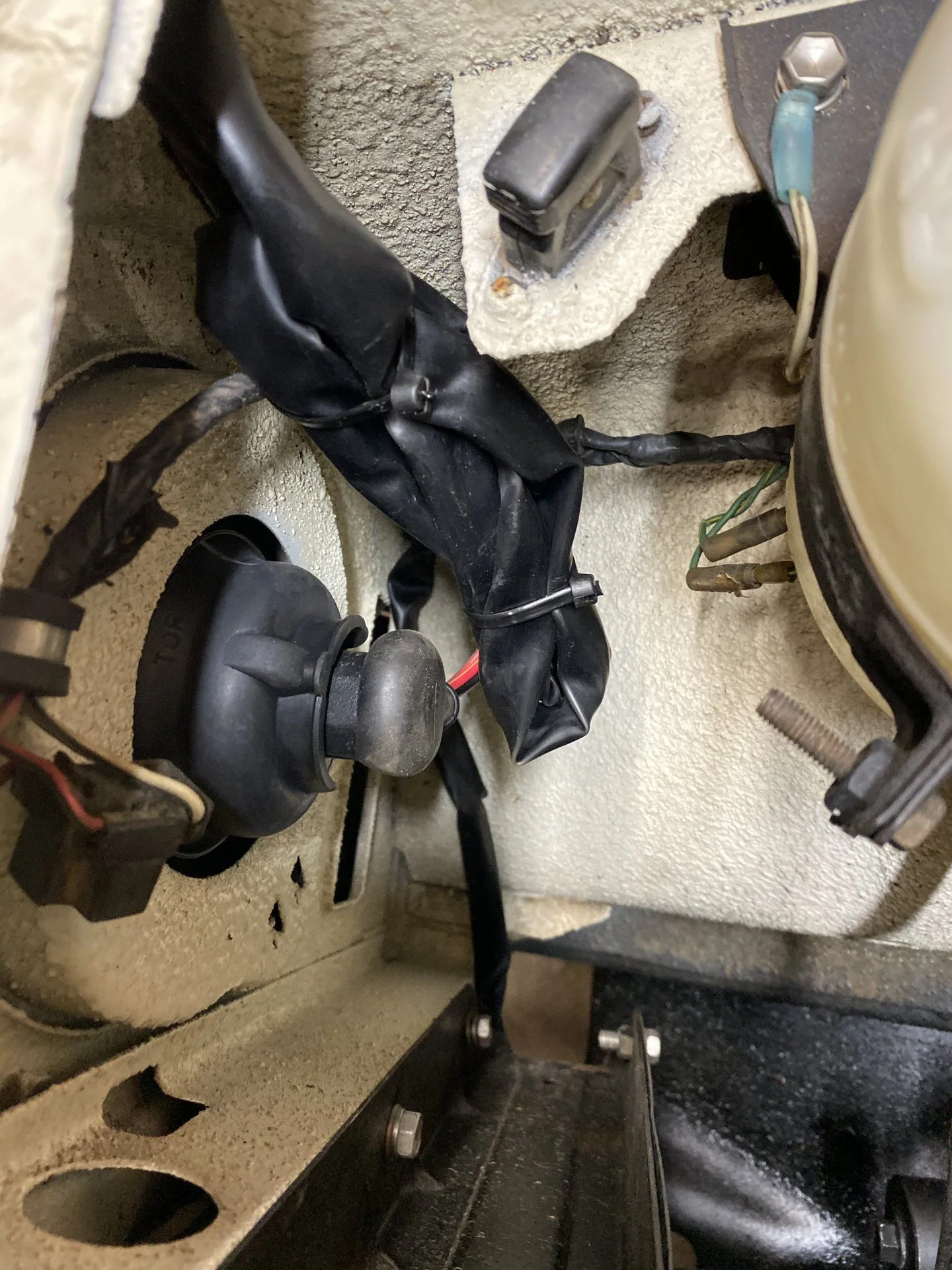

1966 FJ40 Koito headlight kit install: So I installed my Koito light kit today. As wngrog had previously stated, it is not plug and play for my year. There were a few variances: one was the headlight bucket (as previously mentioned). Second was the lack of a "plug B", the vehicle side plug. Third involved slight mods to the harness. I don't know what year the closed bucket style stopped, and also I don't know when Toyota started adding the vehicle side 3 prong plug that the Koito harness plugs into, but early 70's somewhere.
It is possible to remove the prongs from the headlight plug that connects to the actual headlight. Then one can, one by one, maneuver the individual prongs through the small hole, use a different hole grommet to protect the wires, and reinstall the plug with its weather condom. It's finicky, but doable. Instead of cutting a larger hole in the back of the bucket, I think I'd rather find a compatible part from a newer year and just have the backs of the headlights exposed, but the bucket is integral to the aiming mechanism. Inside the bucket, there is a welded tab that holds a spring, so getting a big enough hole isn't really solving the problem, per se, and you'll end up with a bunch of rust inside the bucket where the water collects. One could cut it, but I elected not to. I also had to lengthen the harness on the passenger side headlight, as finessing all the wires through the bottom of the bucket ate up precious length the harness didn't have. Not difficult, but certainly not a "1 banana" situation. LAST, I had to just cut "plug A" ( harness side of the plug) off and install a ring connector on the ground and spade connectors on the high and low beams.
The cool thing is that, Toyota being Toyota, all the wires coming from my light switch are the same colors as this new harness (red/yellow, red/green, and white/black). And all the plugs are labeled. So you can see which color goes to the Drive beam, and which goes to the Pass beam (low, high). I just hooked up the RY, RG, and GRND wires to where the old ones were on my passenger side wire bus. The wiring diagram in my manual did mostly agree with reality as to where the RY, RG and WB wires hit on the fender junction boxes, so that was also nice.
I am not INTO wiring, and this was doable for me. Took the afternoon to do it all. I'd call it a 2.5 banana.

The Koito upgrade is amazing. How about a pic or two of your rig with the lights installed? A build thread would suffice as well.![]()

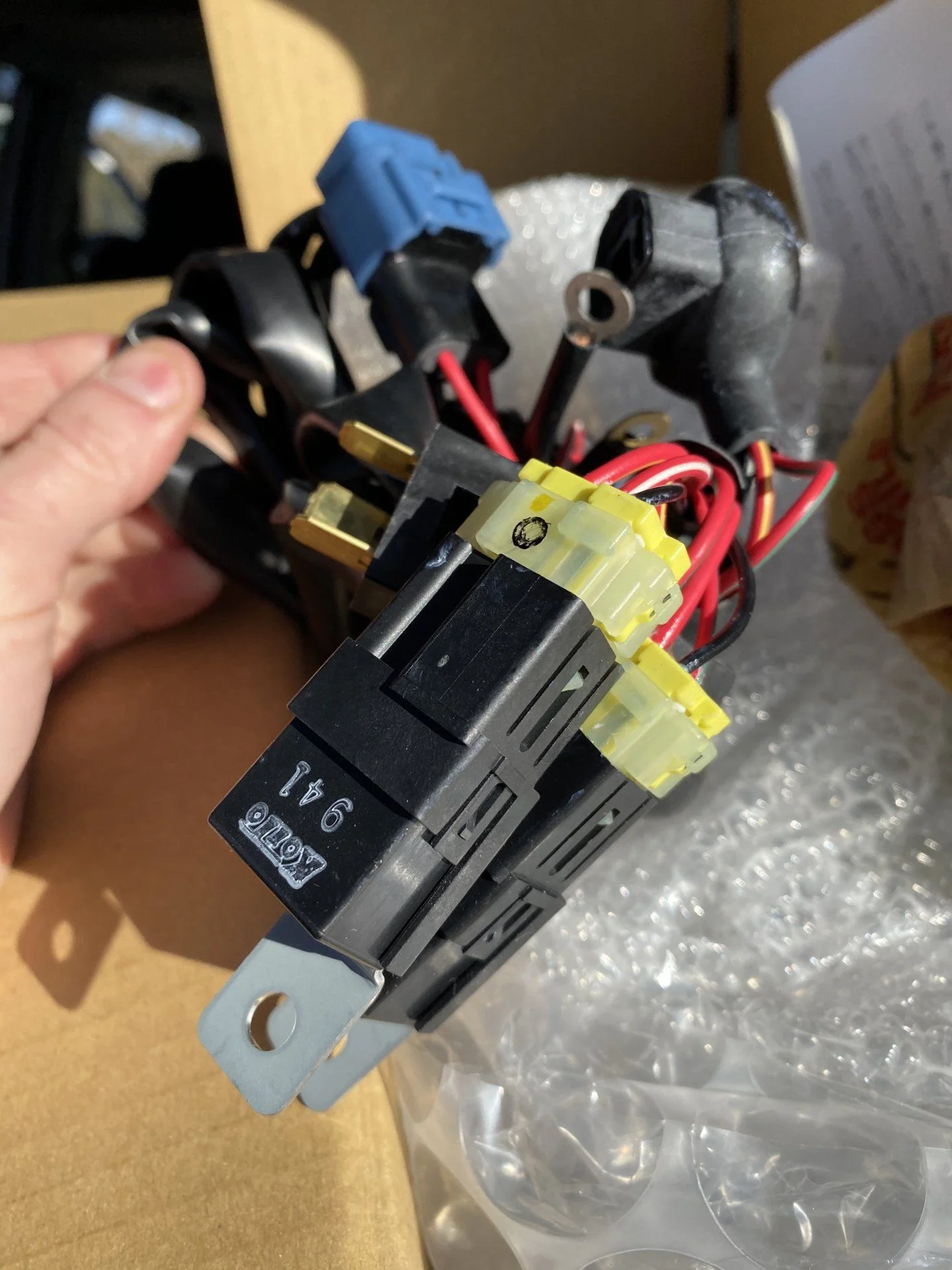

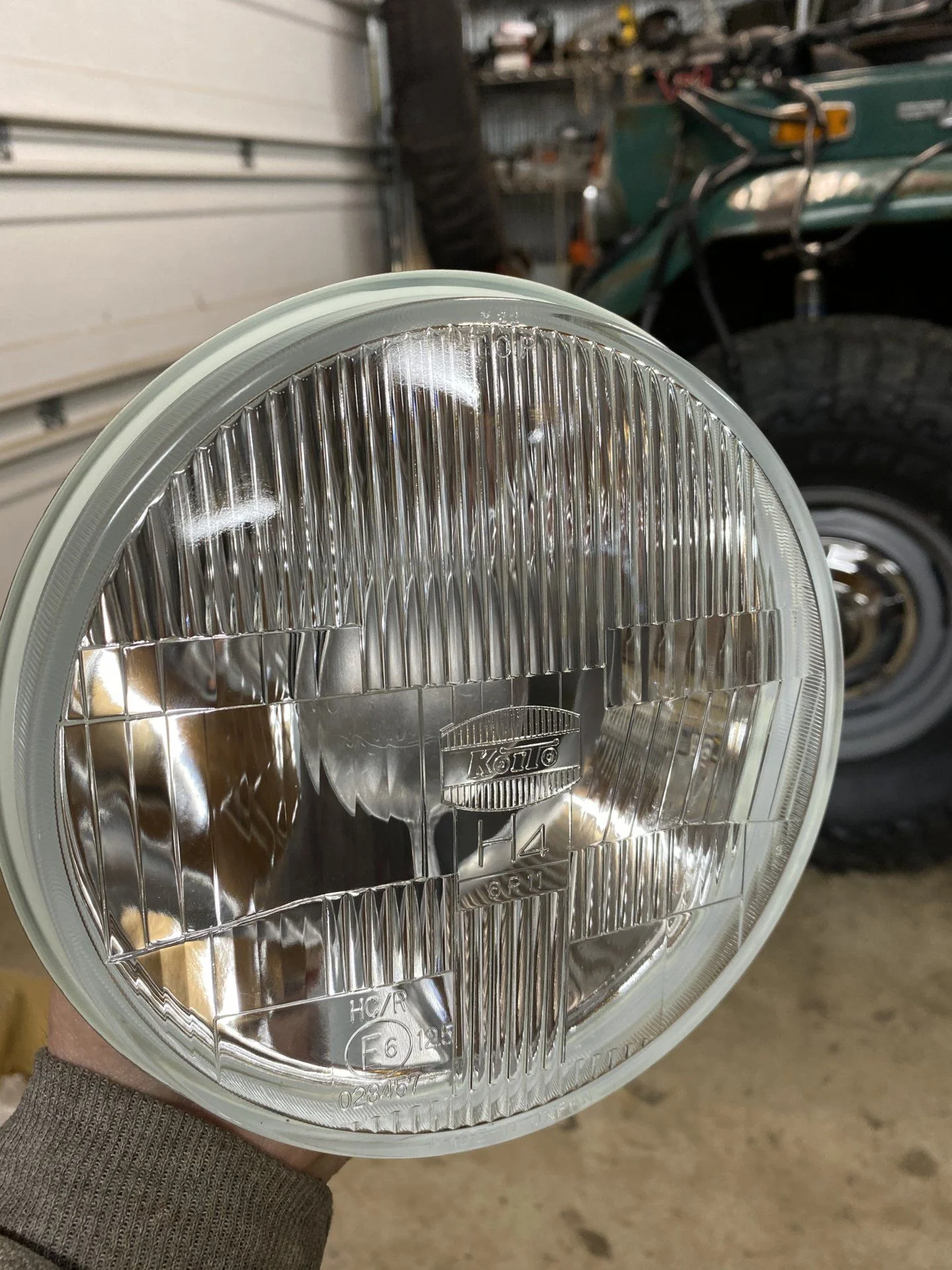

Got the lights.
Truly awesome. There is more value in the wiring harness, bag of zip ties and tube of grease than they charge for these lights. This has to be the most underpriced item ever for a Land Cruiser.
Dealer cost is $30 a PAIR and Retail is $64. I’d pay double the retail cost or more for this beautiful light.

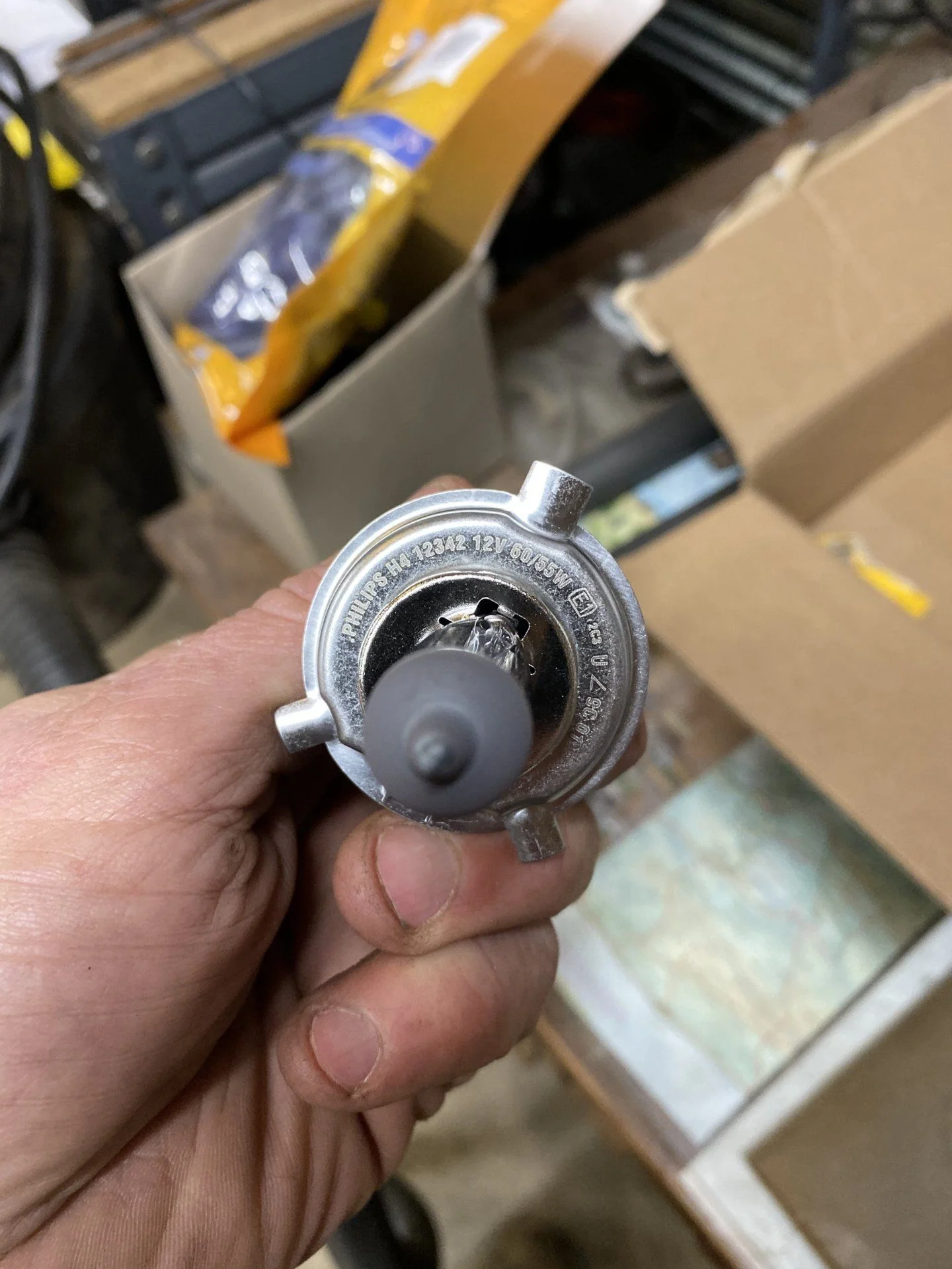

The bulb that comes with it

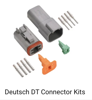

I used Deutsch connectors. They do require a special set of crimpers. Good news it is a 4-way crimp which is super solid and they don't require soldering, so it actually saves time. You'll find yourself using them everywhere. PM me if you want a parts list, but I get all my wiring stuff from ProWire USA. Iwiss makes an affordable pair of crimpers. Think I got mine from amazon for less than $50. The crimpers on the ProWire USA site are hella expensive. Another nice thing about this connector is that it is easy to disassemble if you need to run the wires back through holes and such.Old post but I am going through this now. I have a 64 fj40 that I am wanting to do this headlight upgrade. I already have the Kit to do it. Another member said you had done this upgrade on an earlier fj40. my question is how did you adapt the wiring? any pictures?
