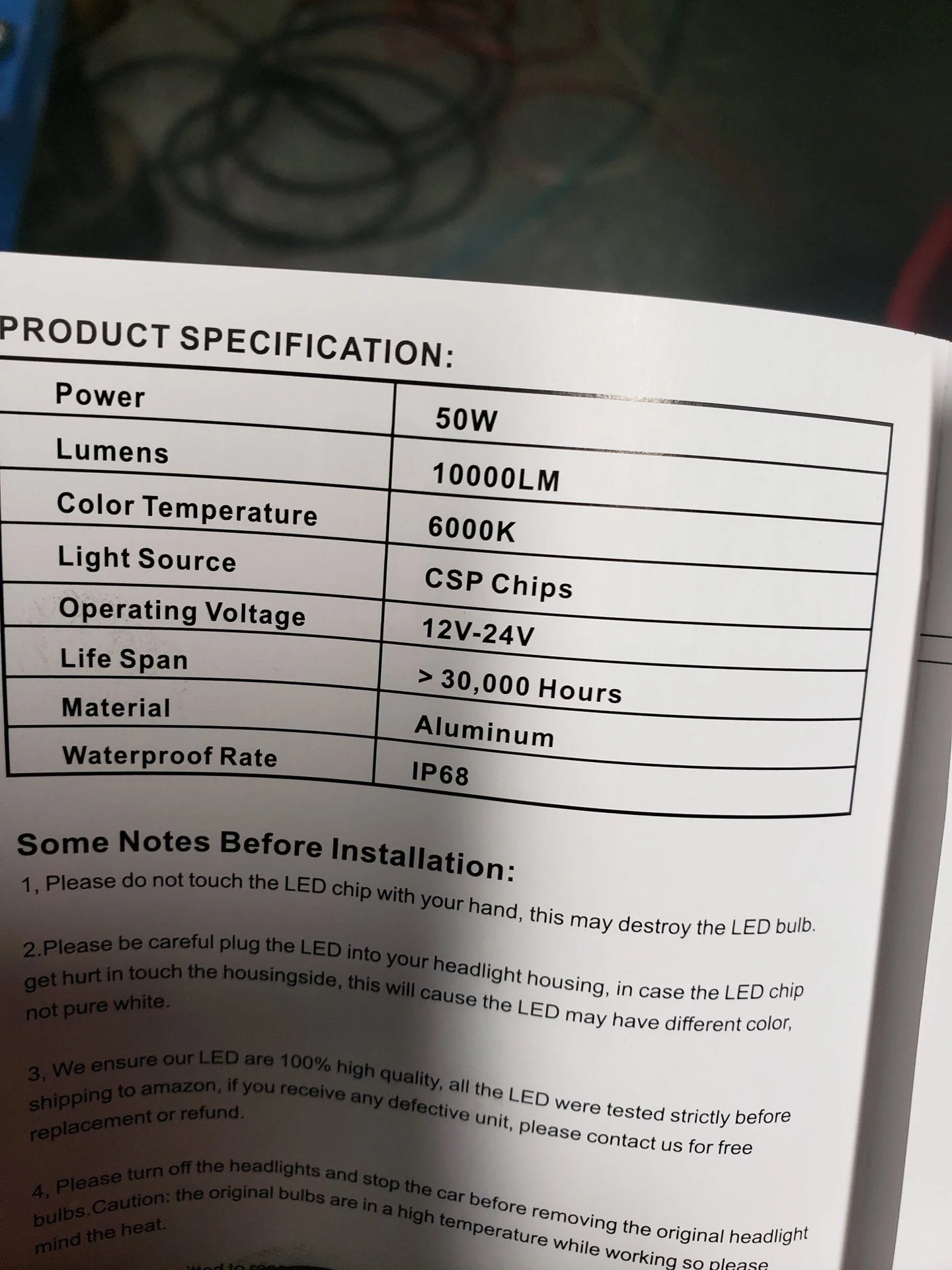

After doing some research I settled on some LED Bulbs and $30 later had them in hand from Amazon
Amazon product ASIN B07FRG4NSH

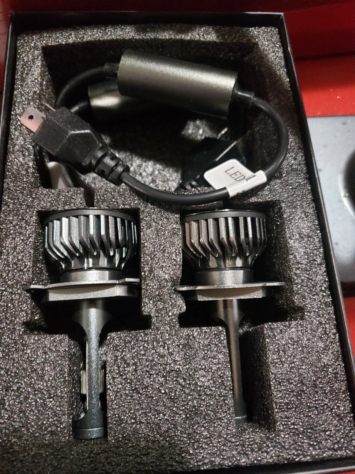

The bulbs themselves are a direct H4 replacement and even have some funky little cooling fans on them.

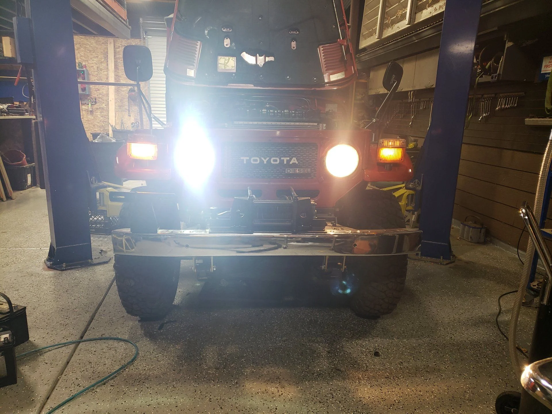

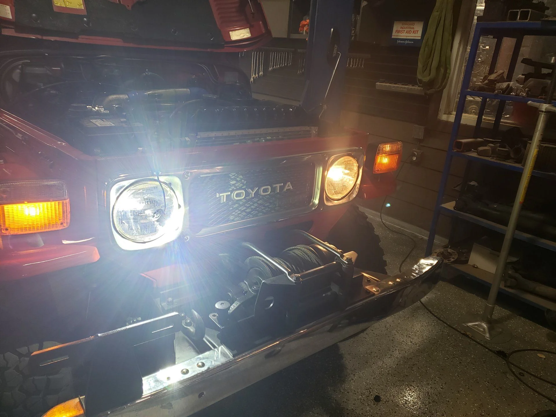

Before putting them in I figured I Should test the 24V theory so I just hooked one up, straight away you can see a significant increase in light and this is without the reflector assist.

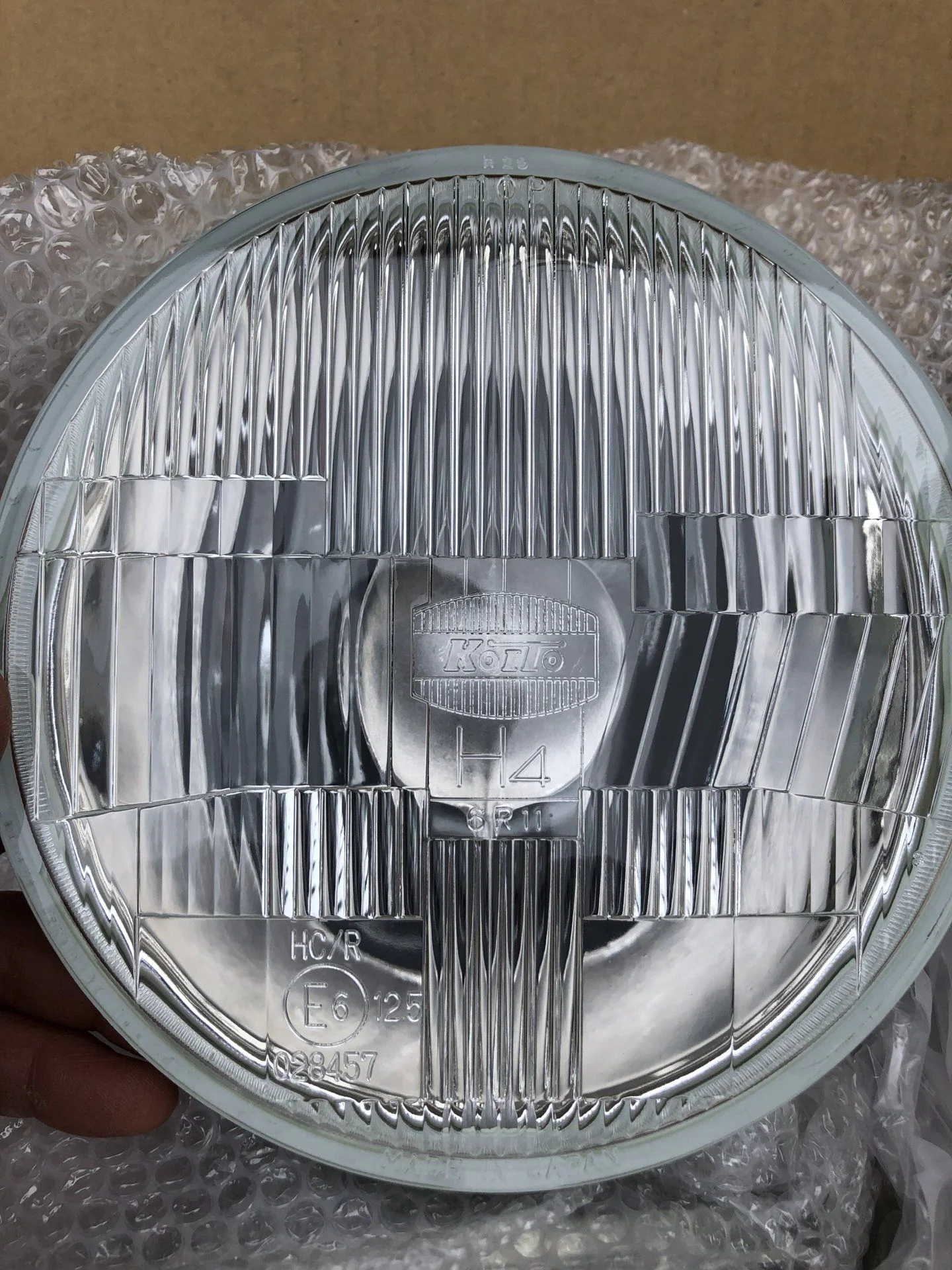

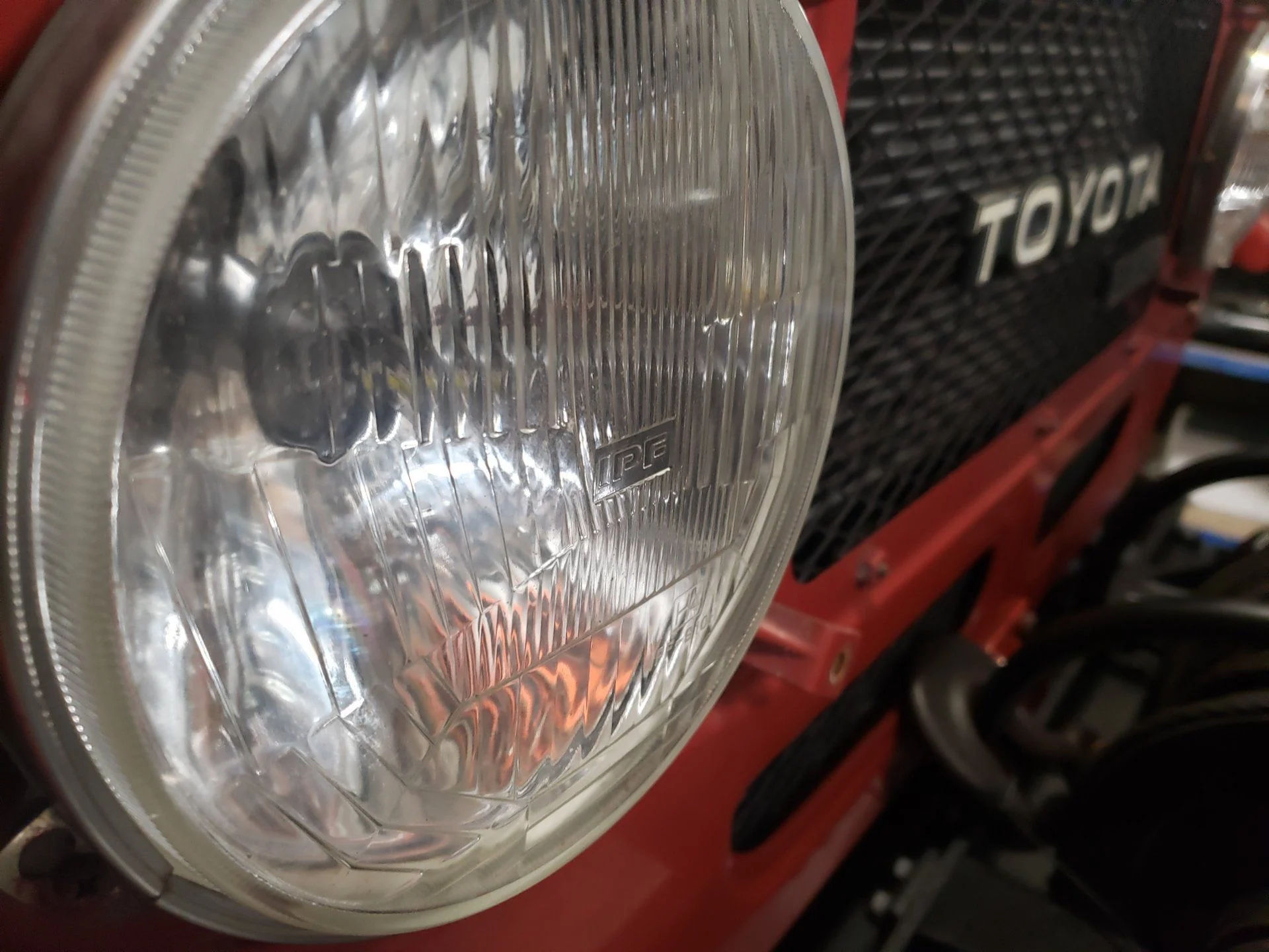

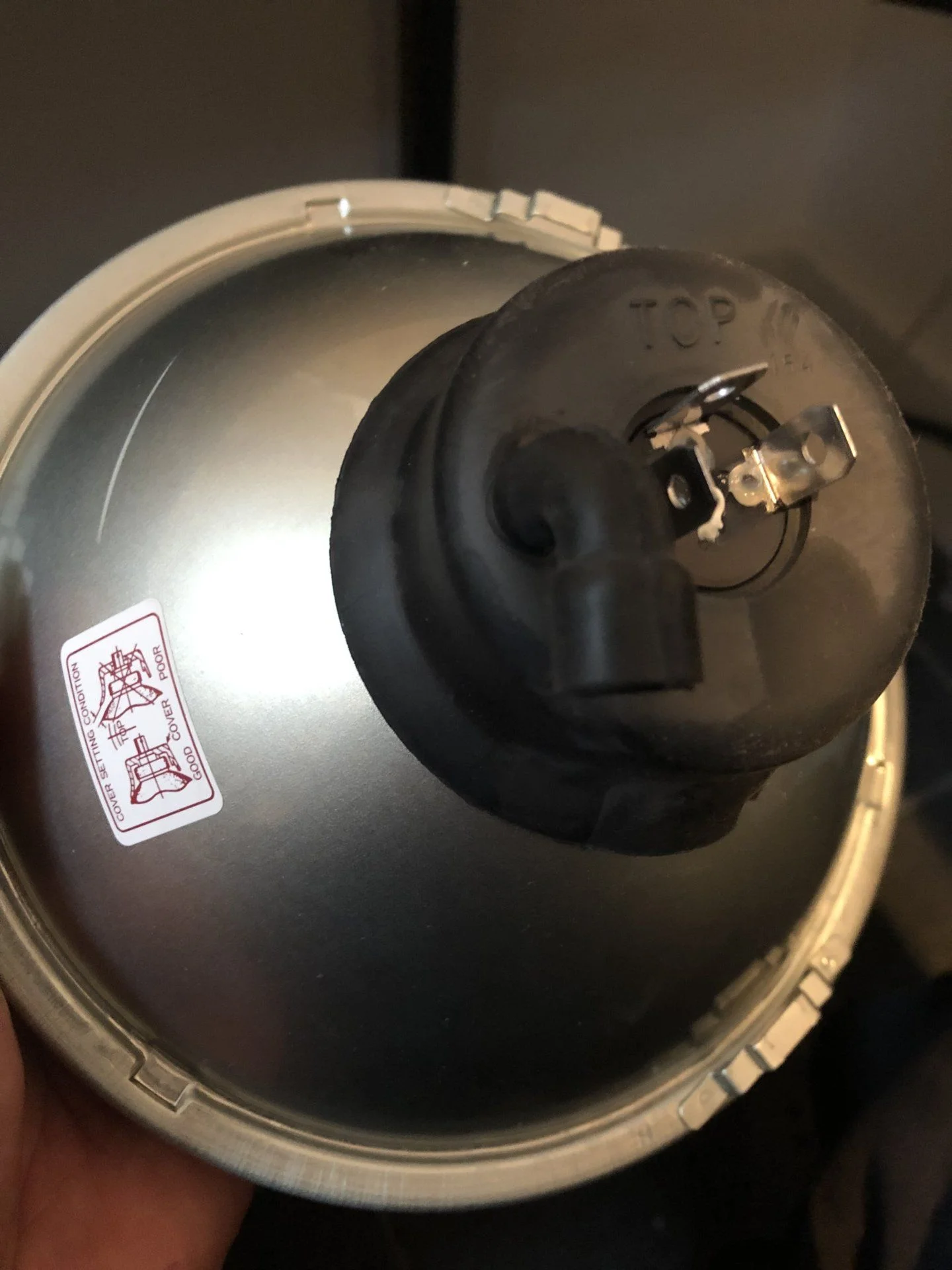

Being that I had sealed beam first I swapped in a set of IPF H4 Reflectors . I have used both the IPF and Hella units and been very happy with both. Narva are also worth a look in but harder to come by. I avoid the Chinese stuff as I find it rusts.
With the reflector fitted I dropped in the bulb and stood back to check it out . As you can see there is more than a small amount of difference. I will get some real time driving experience in the next few days but in the shop it is a significant increase in quality.
For the geeks among us Amp draw on the hi beam is 6.2 amps so the factory loom and fuse etc handles it no issues.
So far well worth the $30 and being 12 - 24V easy option for all 40's

What housing did you use for the bulb? I still have sealed units sylvania i believe last time i swapped.

Sorry, but looks awful. A lot of scattered light/glare, I don’t know if any is aiming to the ground. 🤦🏻‍♂️ Those never work properly in "fluted" glass headlights. Oncoming traffic will hate you. 🙈
Agreed. LEDs on classic cars just don’t work very well and look out of place.

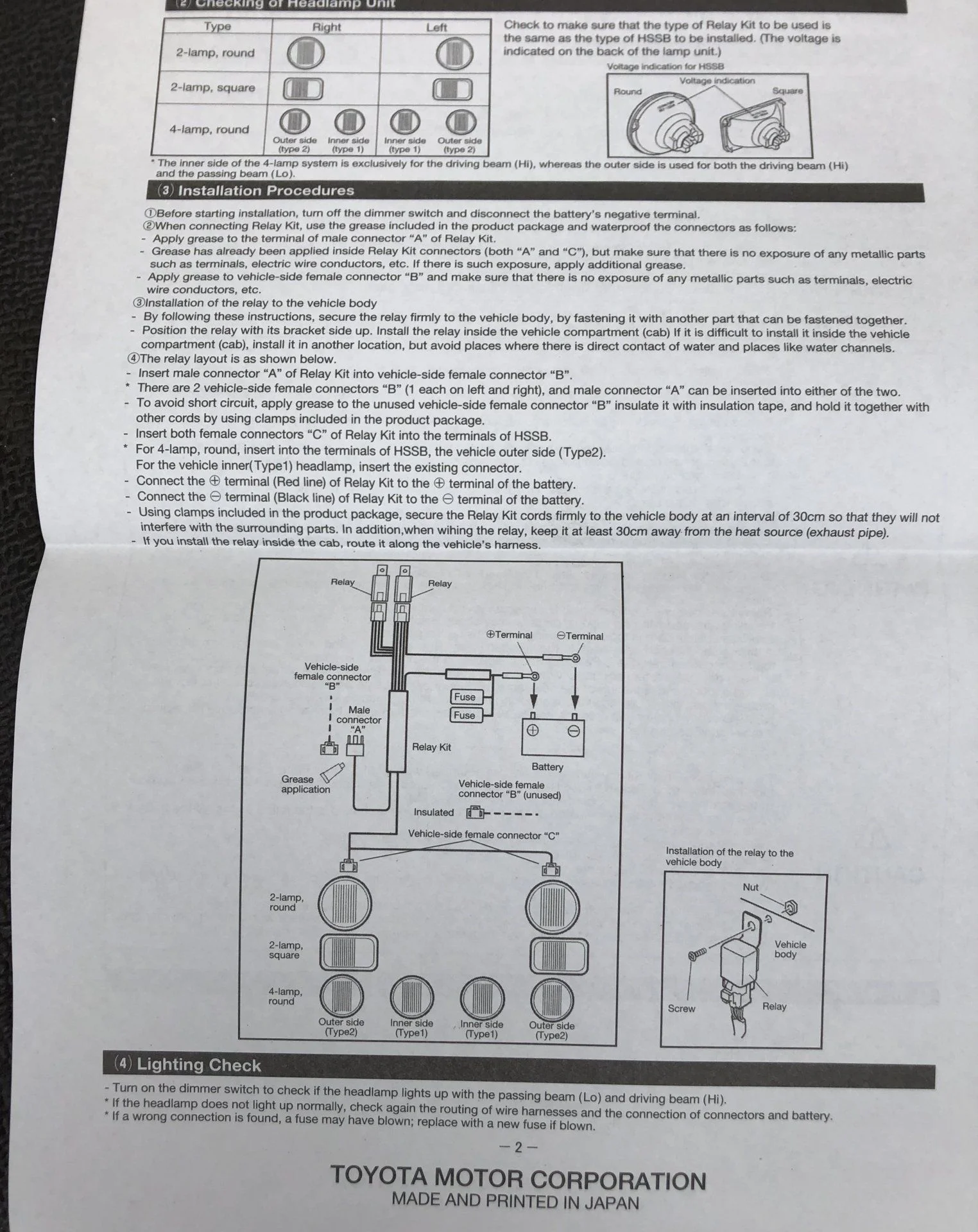

Keep it all Toyota and go with the upgraded housing/wire harness kit... Less than $50 for the kit and available from any Toyota dealer.
