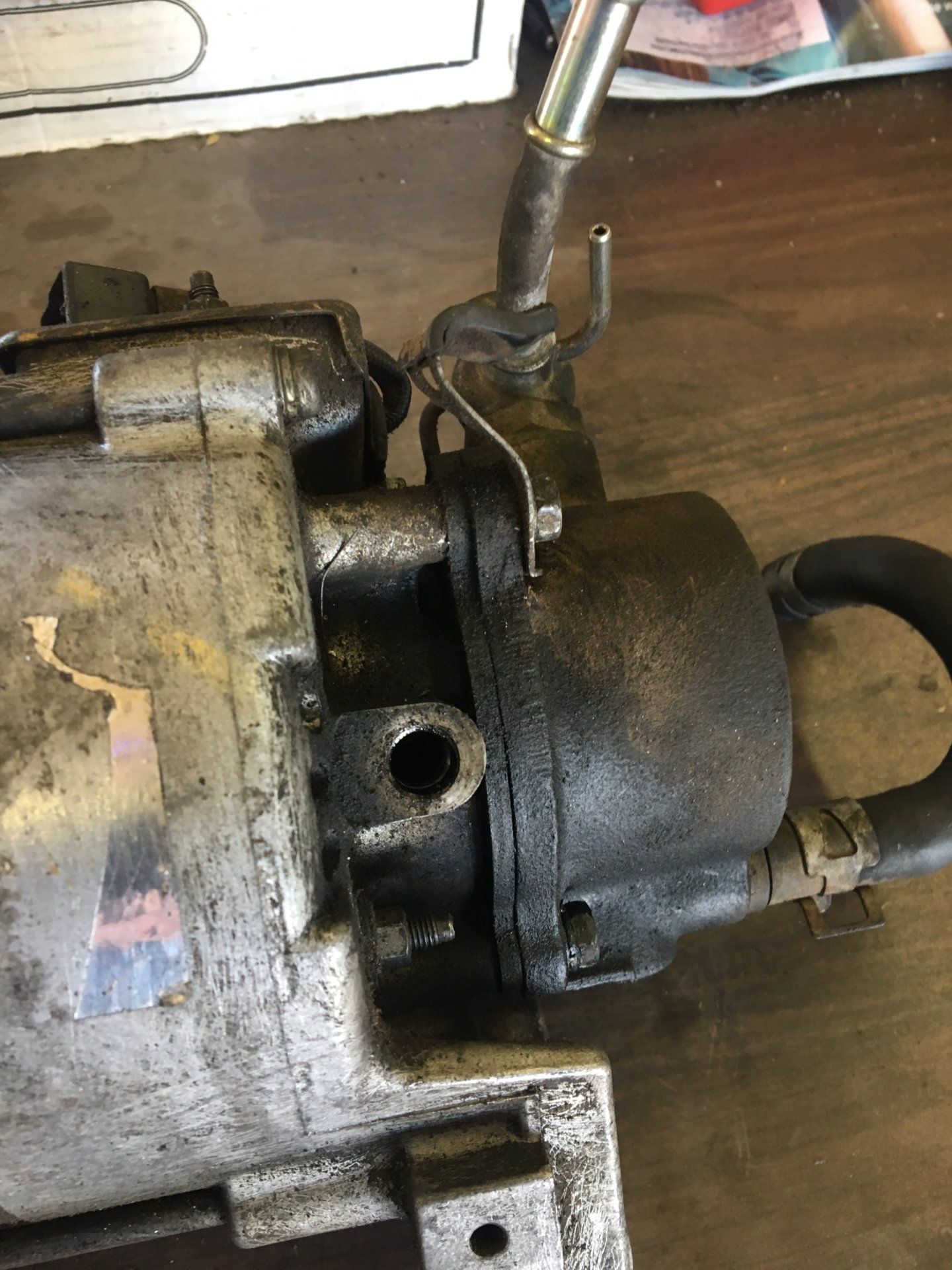

Can you restore/rebuild a smog pump for the same?

Not doing smog pumps right now.

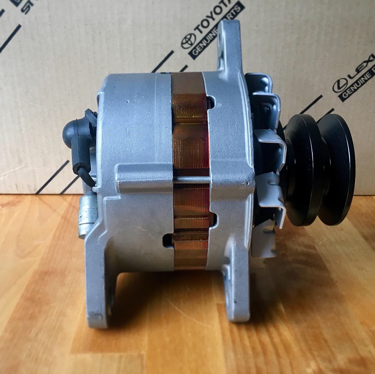

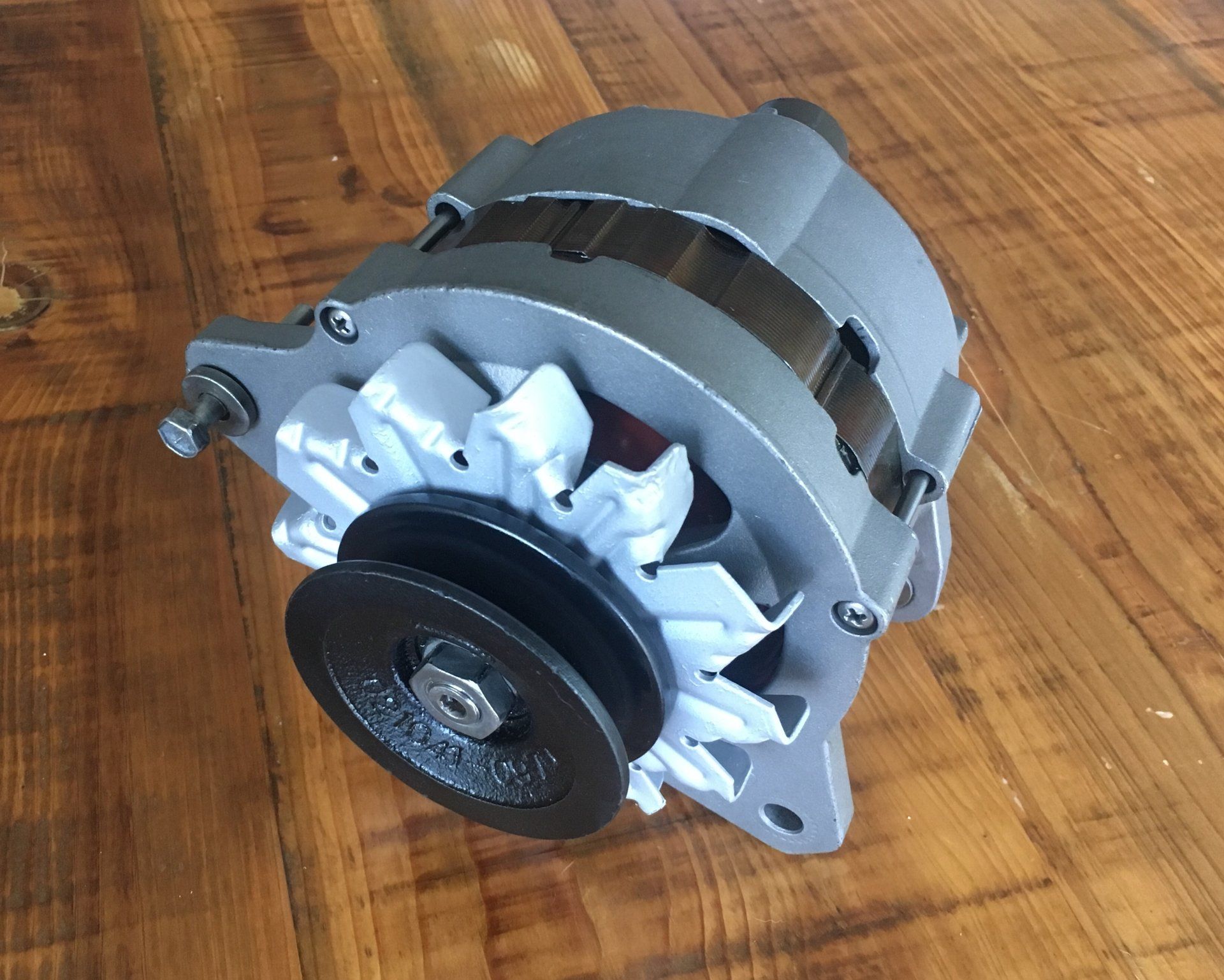

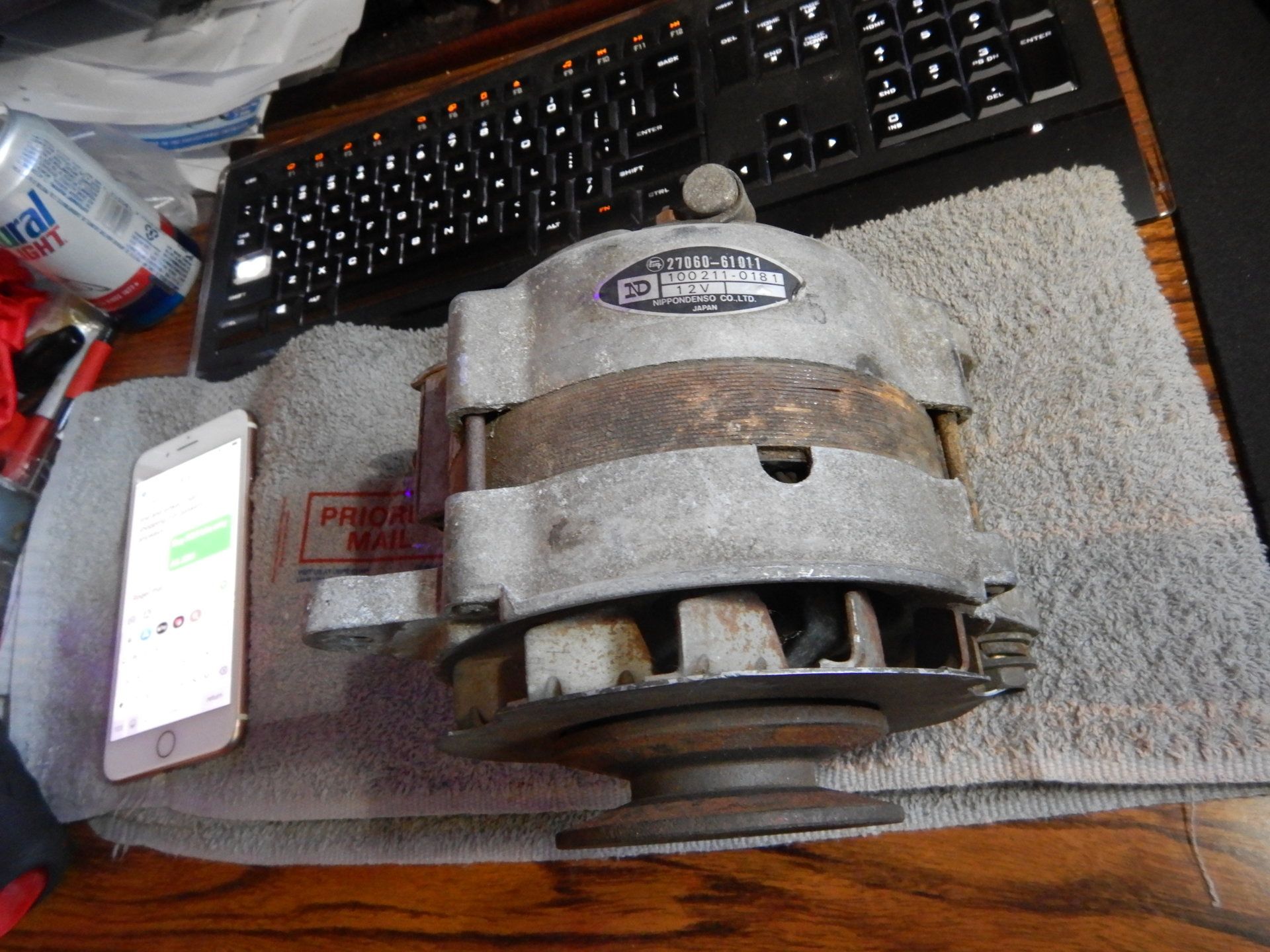

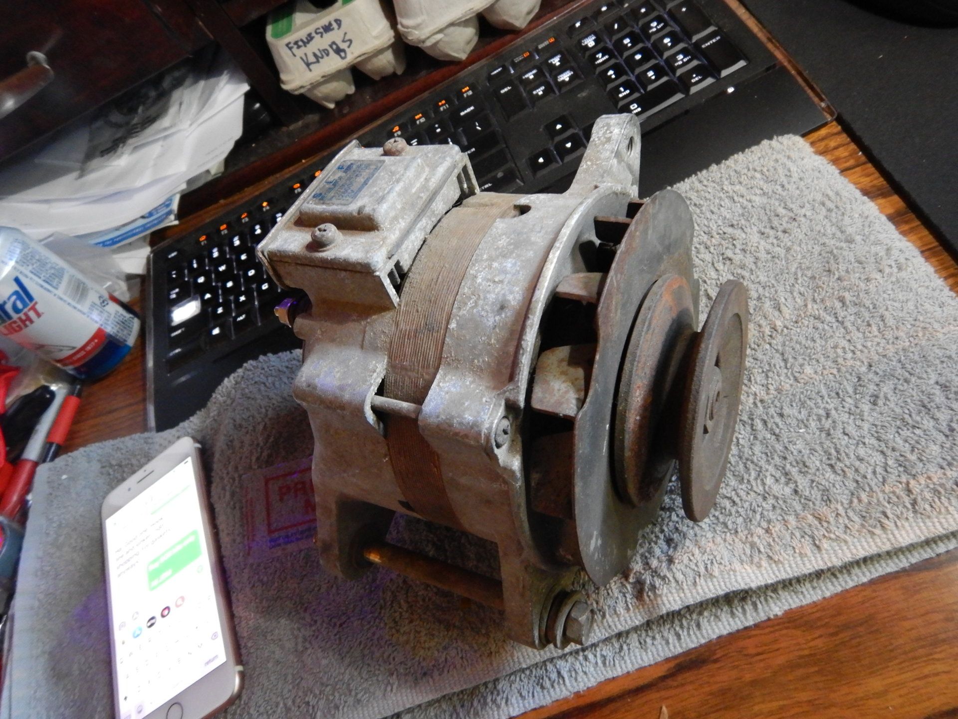

Here’s one for @andybudge that came from pardion’s stash.
Before:
After:

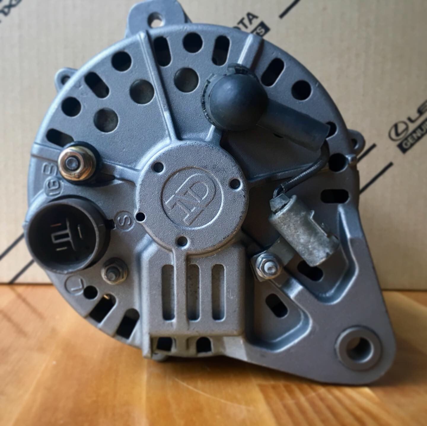

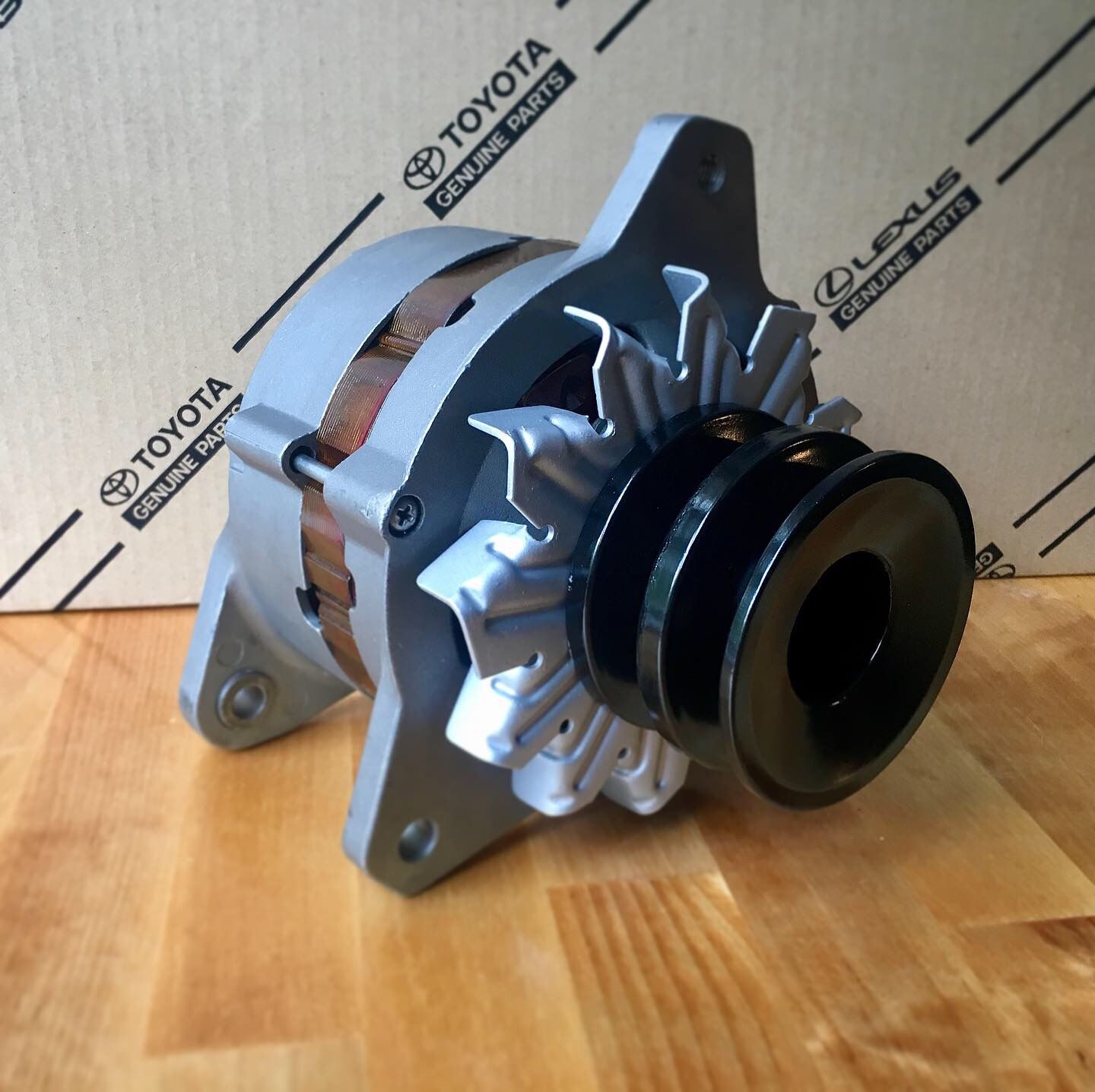

Here’s an FJ62 unit for @techster82 to use on his 60. We scrounged up an FJ60 pulley for belt alignment.
He also got a new internal regulator, which fixed the broken plug in the back.
Check out @Curtice ’s beauty after her mani-pedi at the alternator spa...

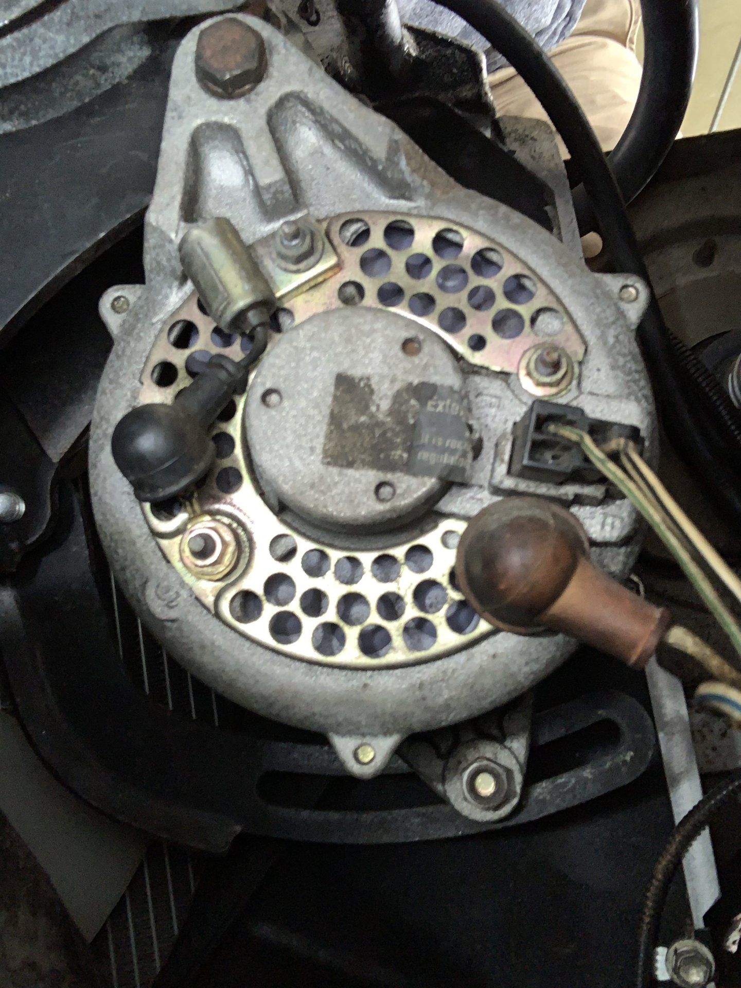

@FJ60Cam I'm looking for a 27020-61070 (55 amp FJ60 alt) to put on my '77 FJ55. I can't find one on the web and was hoping you or @pardion would have a core that you could refurbish for me. No rush but it's on my list.

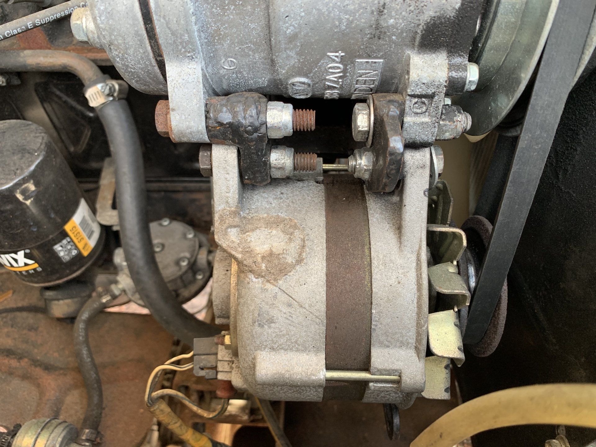

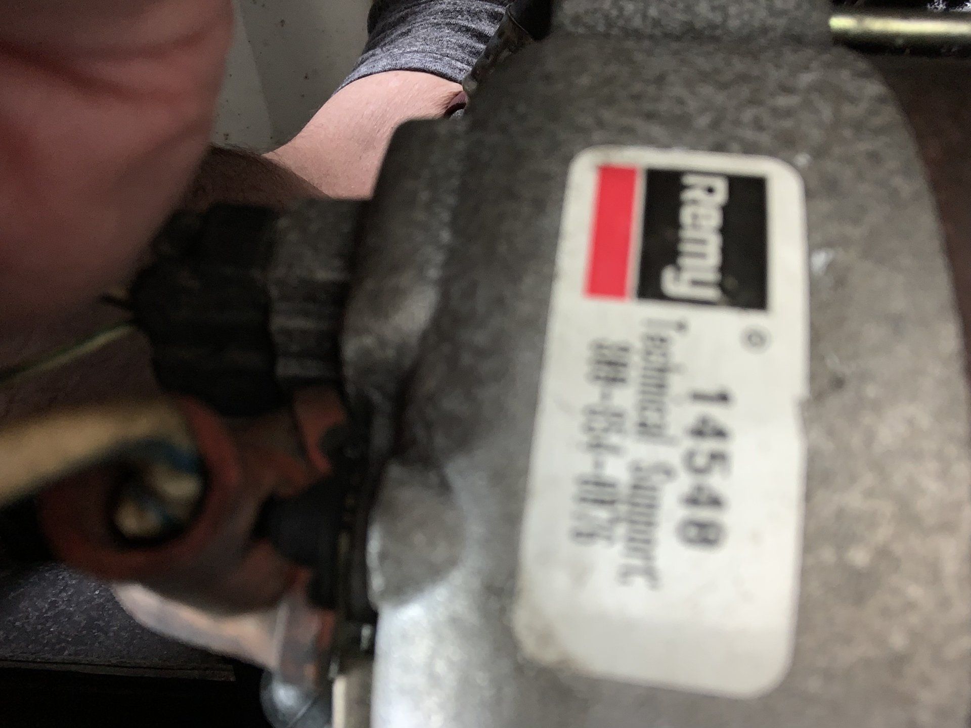

The PO had @Trollhole install A/C and I assume at the same time installed a Remy alternator. Unfortunately the alternator cannot always keep up when the A/C is on and typically/often/sometimes drains the battery. It's a bit of an intermittent problem but I figured I would change the alternator anyway to an internal regulated type and get some connectors from @Coolerman to wire it up. From everything I've read, 55 amps is OK to use with the OEM wiring and meter.
