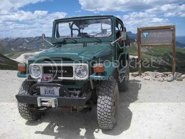

I've run my 1980 with the stock sea-level jets (and with the HAC system intact) up to 13,000' and it did just fine.
