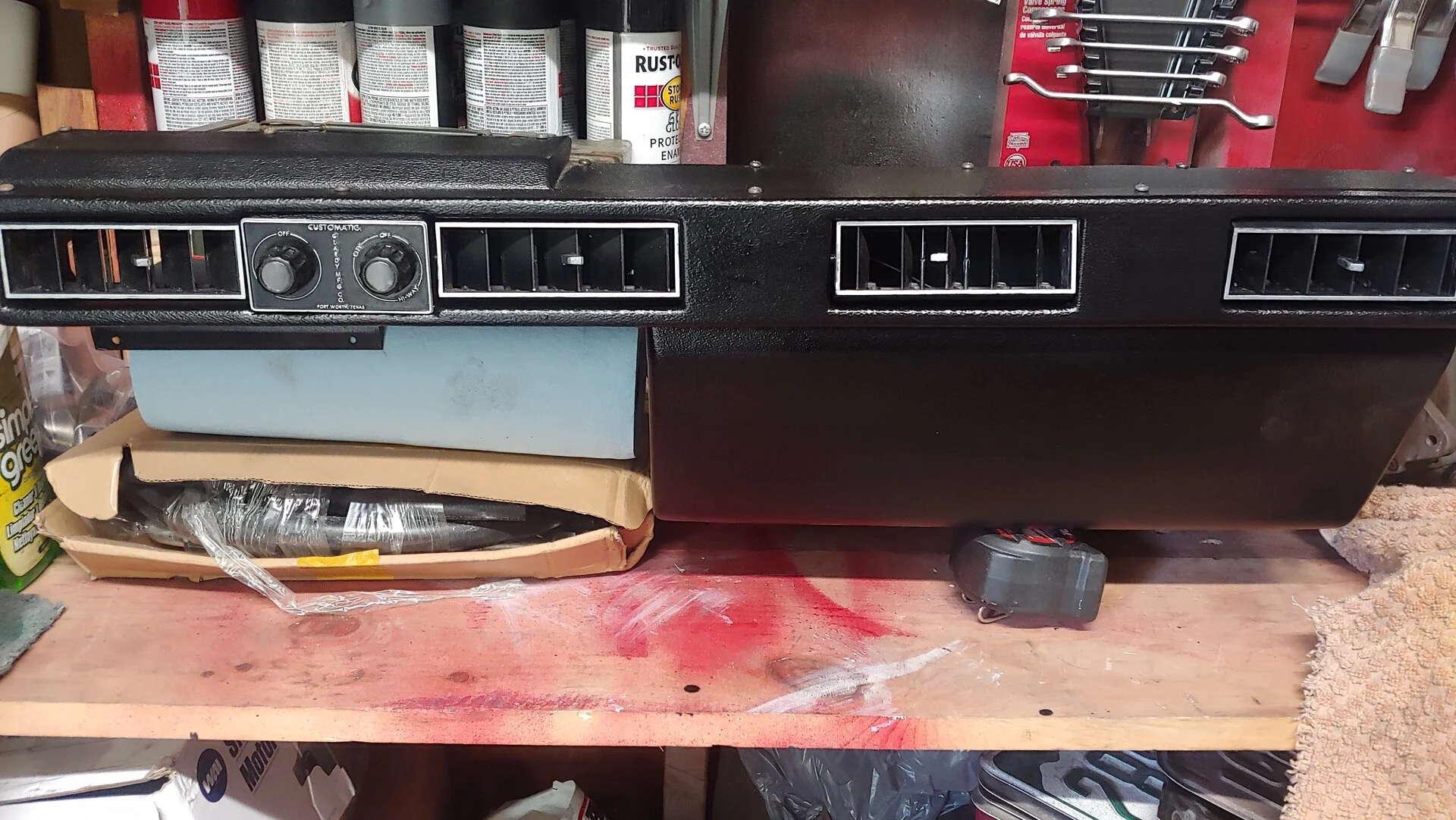

I have an aftermarket evaporator unit that was from back in the day that takes the place of the heater duct. Works pretty good, great for defroster/defogger operation. I paired it with the AC compressor I got with the 3FE and a NOS condenser from a Jeep. I will be selling this one since I now have a new OEM evaporator and controller.

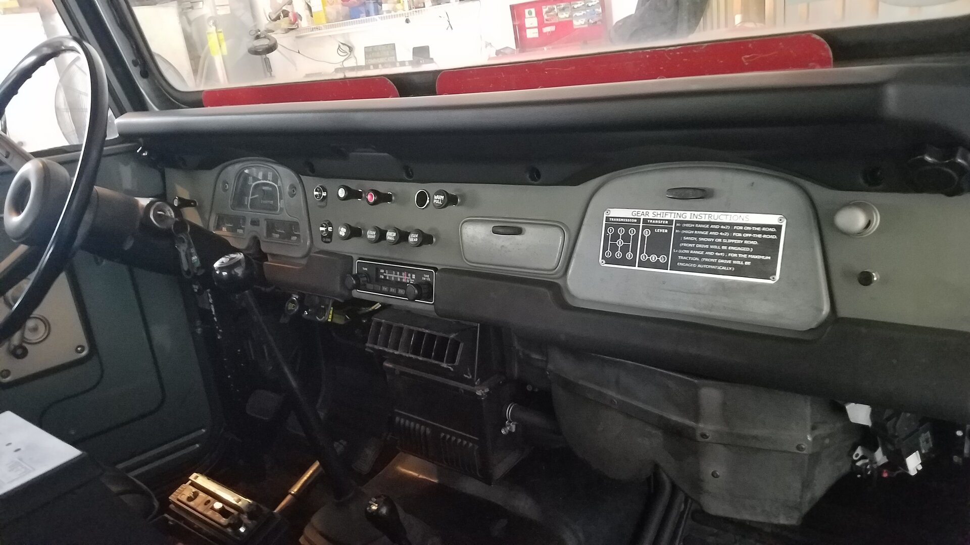

What year? I have one that fits around the later heaters with the top vent. Mine is a 1970 with the lower vent only so doesn’t work right with what I’ve got.
For reference Clardy "dealer add on" a/c that retains heater box
This is the one I need! The other version comes down on the left/skinny side to clear the upper heater outlet.
Again, year/heater dependent if you want the full width style.

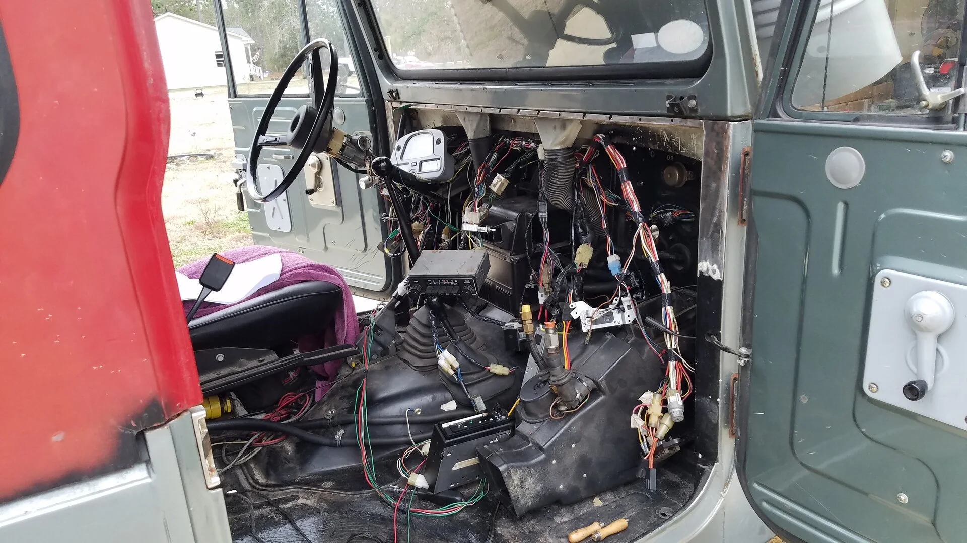

Side track - how did you get your whole dash face off (and reconnect it)? I hate hate hate when I have to work behind/under the 40 dash. This looks awesome haha.
I was replacing the dash panel, my old one was pretty hacked up. Was lucky to find a '73 to match. You have to cut the welds on the ends and where the glovebox connects to the firewall. Then drop the windshield and drill out the 72 spot welds that run across the top. I thought about trying to make it removable like the old heeps but I think it is welded for structural integrity.

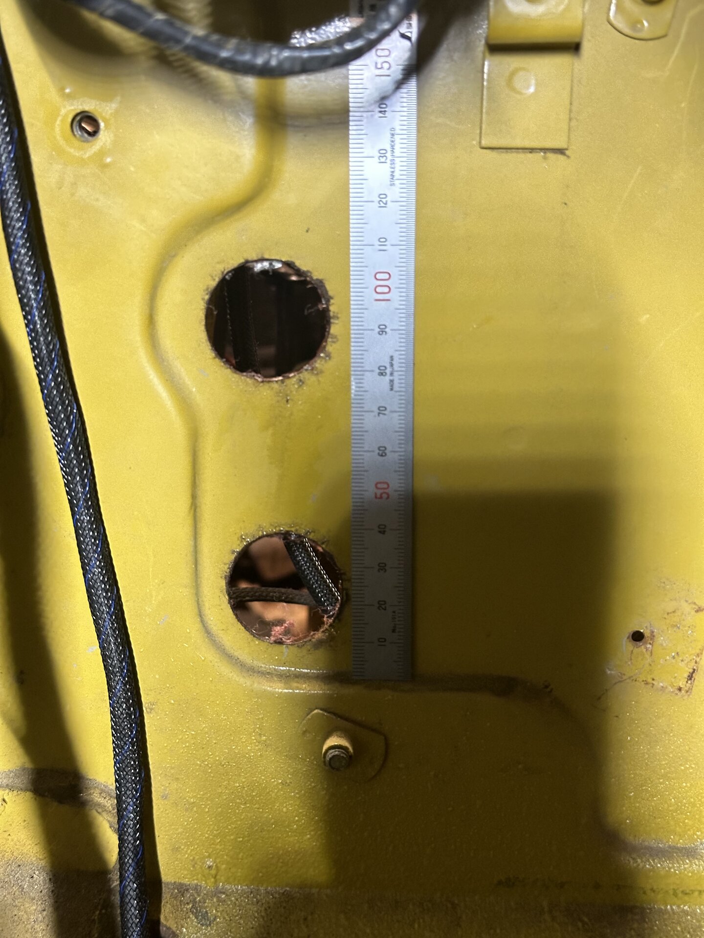

Just FYI - at least on my 79 the Clardy install puts 2 30mm holes in the firewall and has several sheetmetal screw holes in the body and dash.
