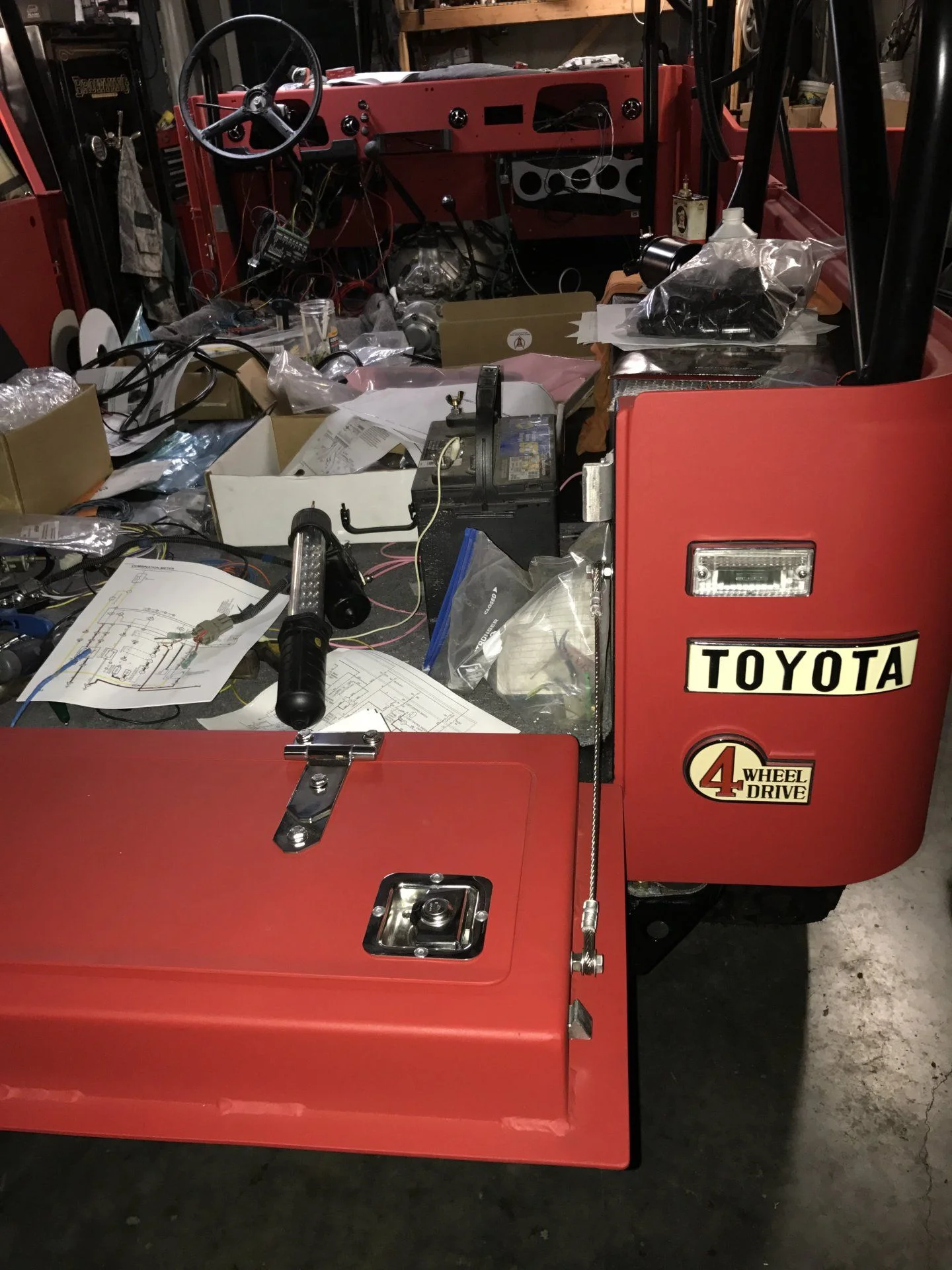

And the assembly and wiring begin.

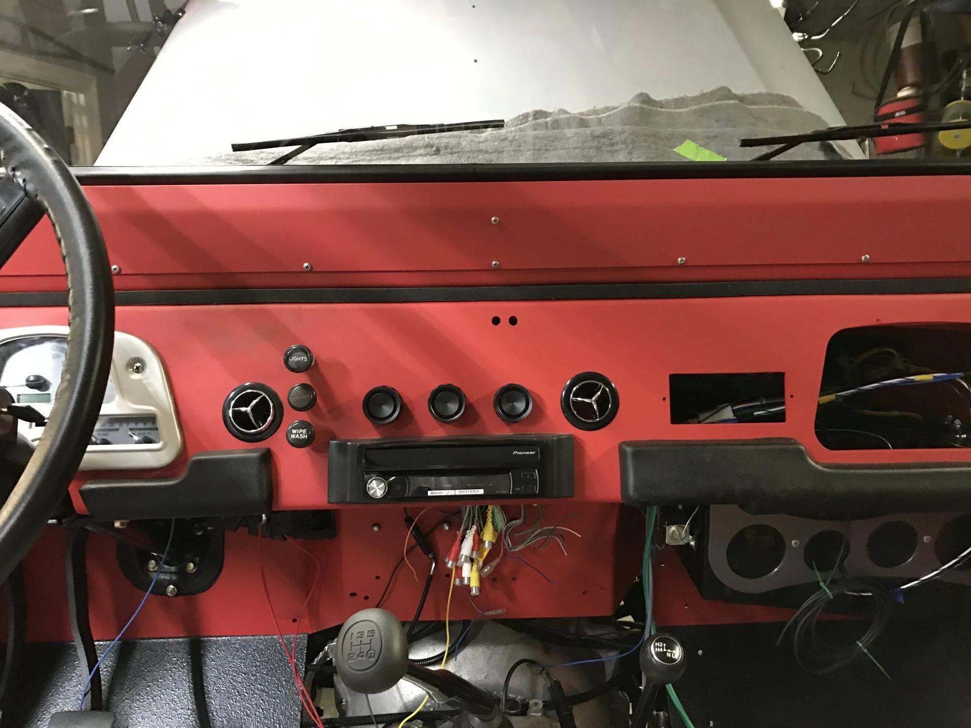

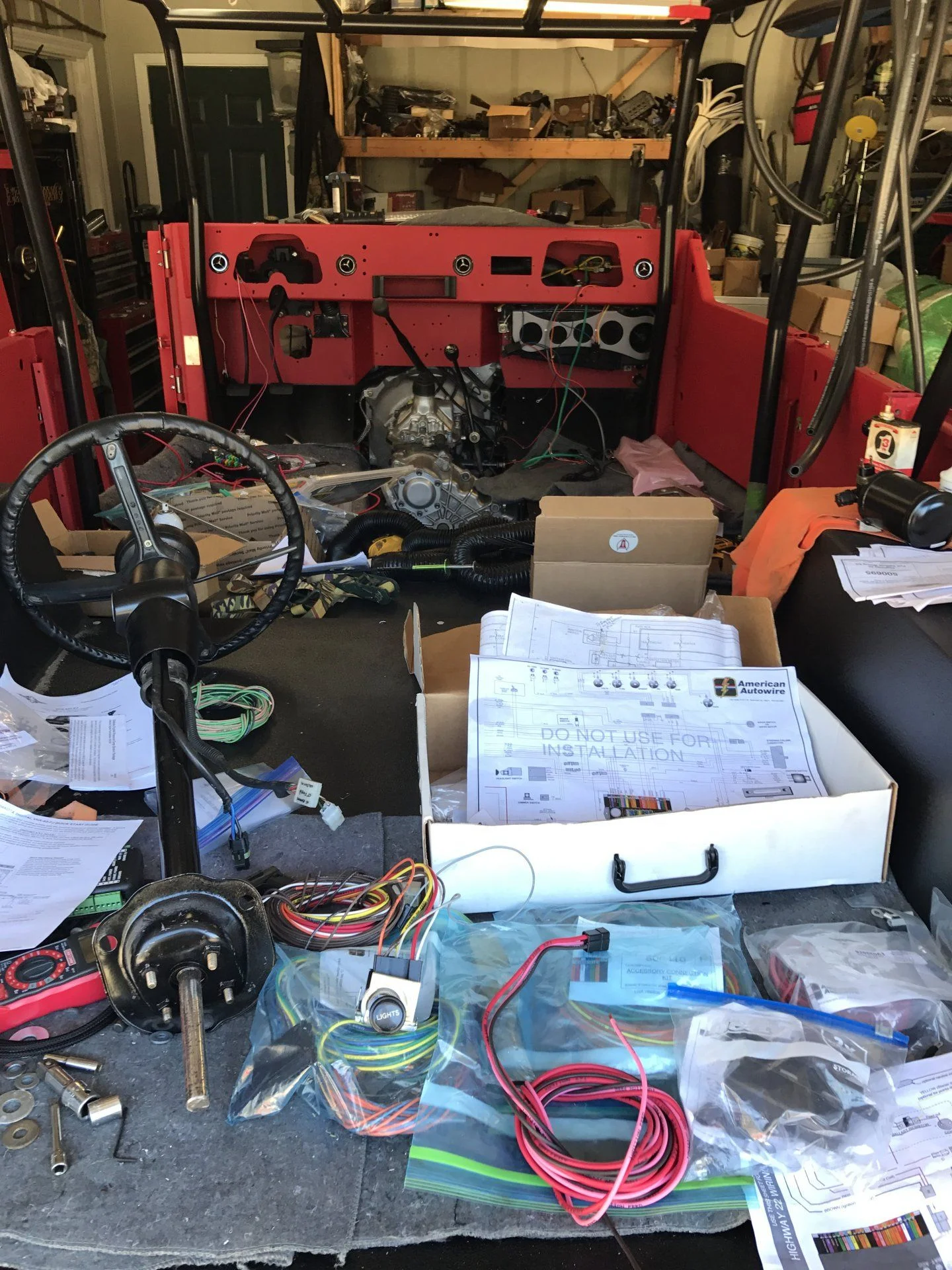

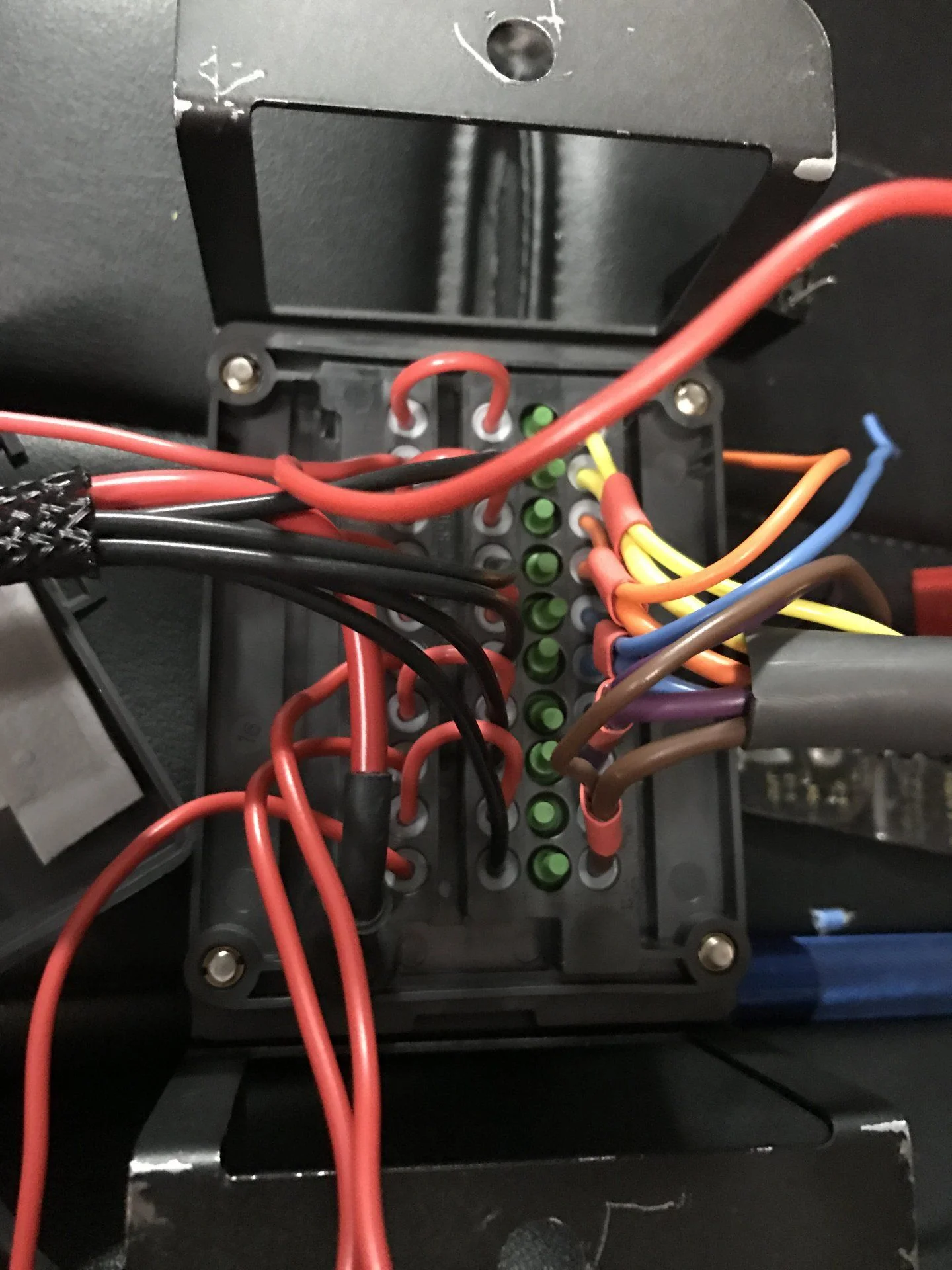

I went with the American Auto Wire Highway 22 harness setup. They make a nice product. I used an FJ40 steering column, hazard switch, light switch, and wiper switch. so I interfaced those into the Amercian Autowire system. Of course I had some help from Coolerman with a harness for the wiper system and technical help.

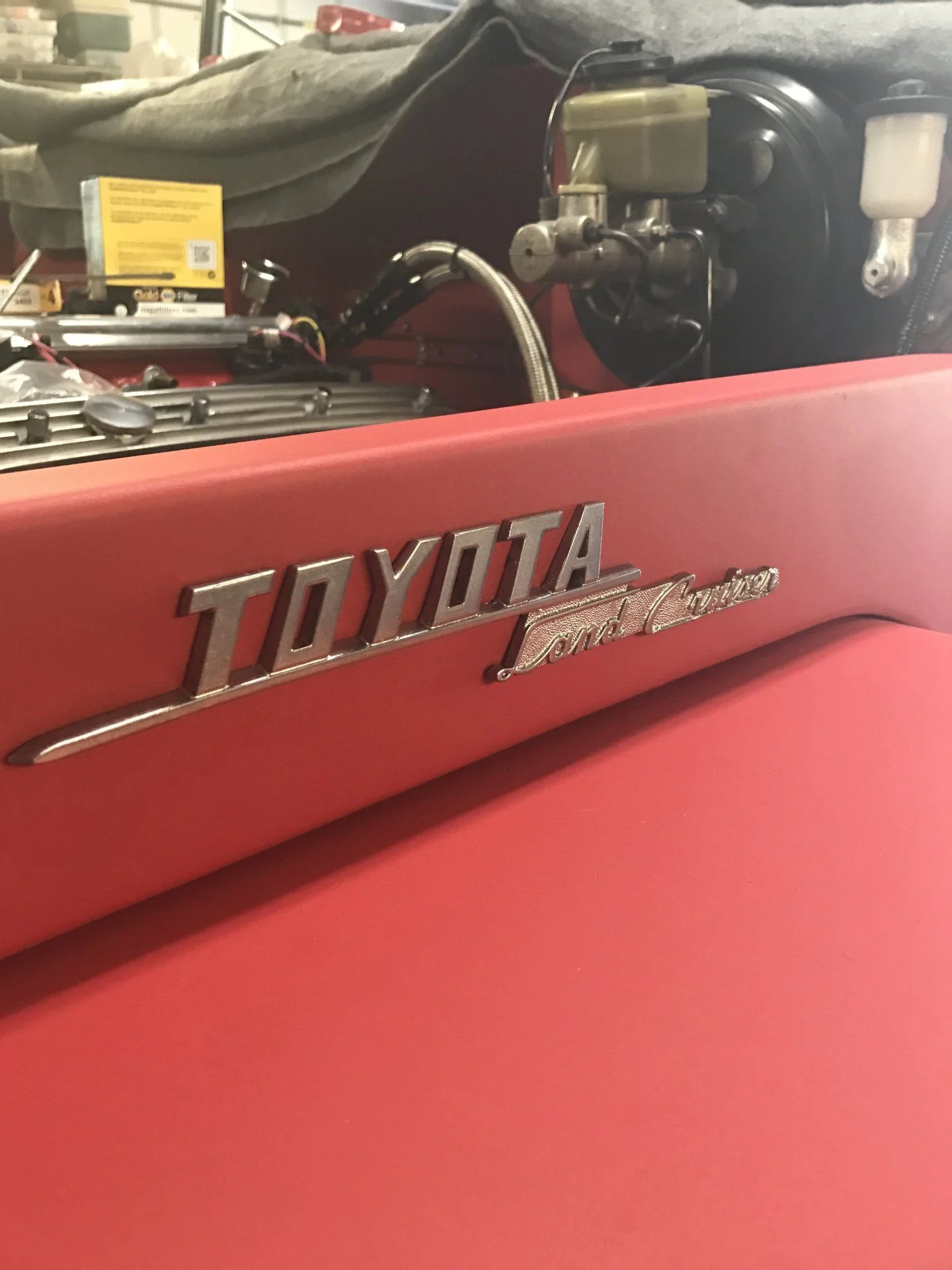

I had an older style apron emblem that was pot metal. I took it to the powder coater and had it done in a chrome like finish. I liked it becuase is made it look like old chrome.
Many hours went into the wiring.

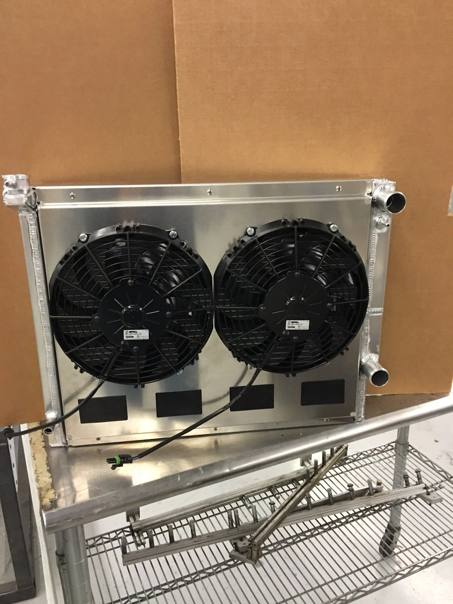

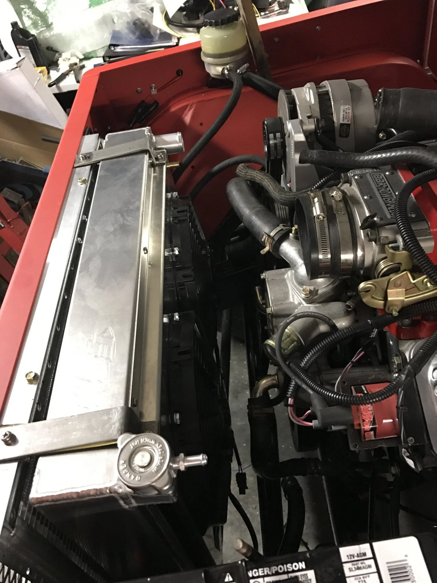

Lots of measuring for a custom radiator and fan. I had read Cam's thread on his "60 getting a heart transplant", and he used Four Seasons Radiator in Memphis. I contacted them and with lots of pics, measurements, and discussion they were able to fabricate a combo that worked out great.

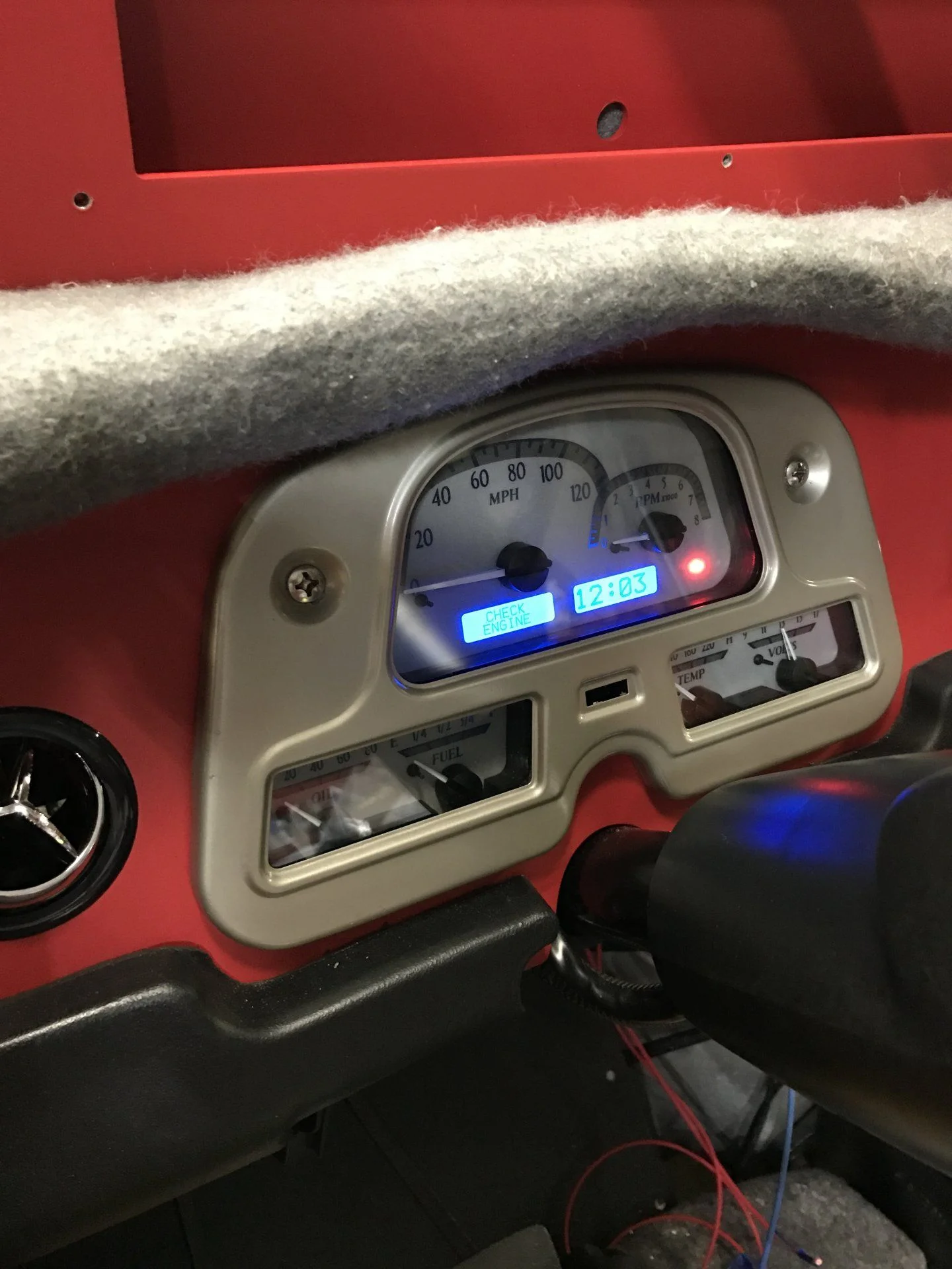

I also opted for the Dakota digital 40 style dash. Man what a nice piece.
I used the RestoMod Air AC system.

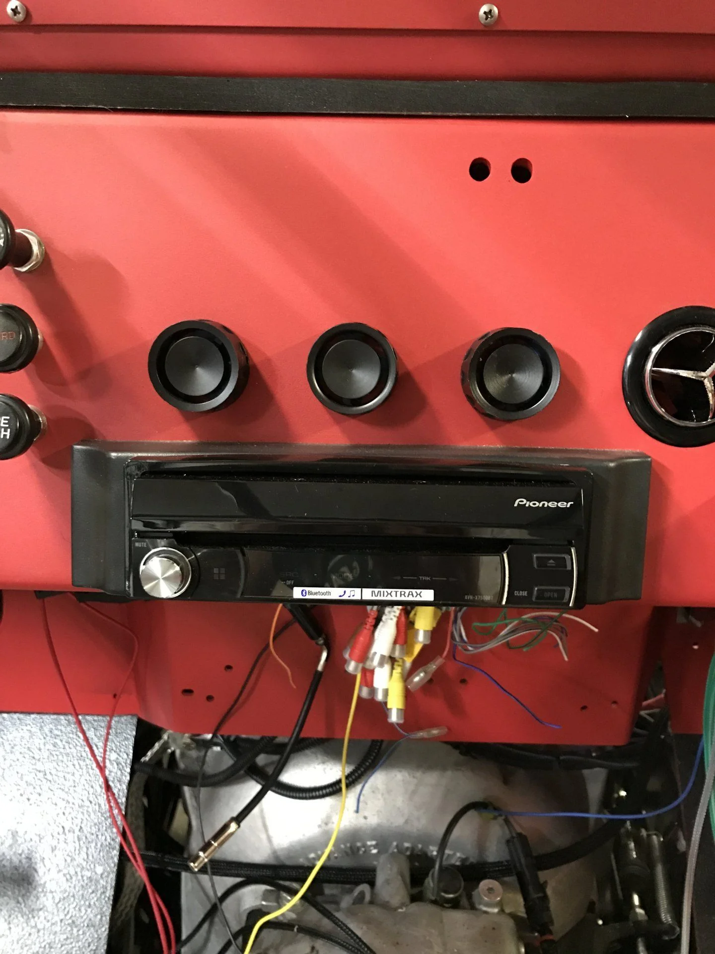

I installed a single din, with mechanical screen Pioneer.

More wiring, and more wiring.

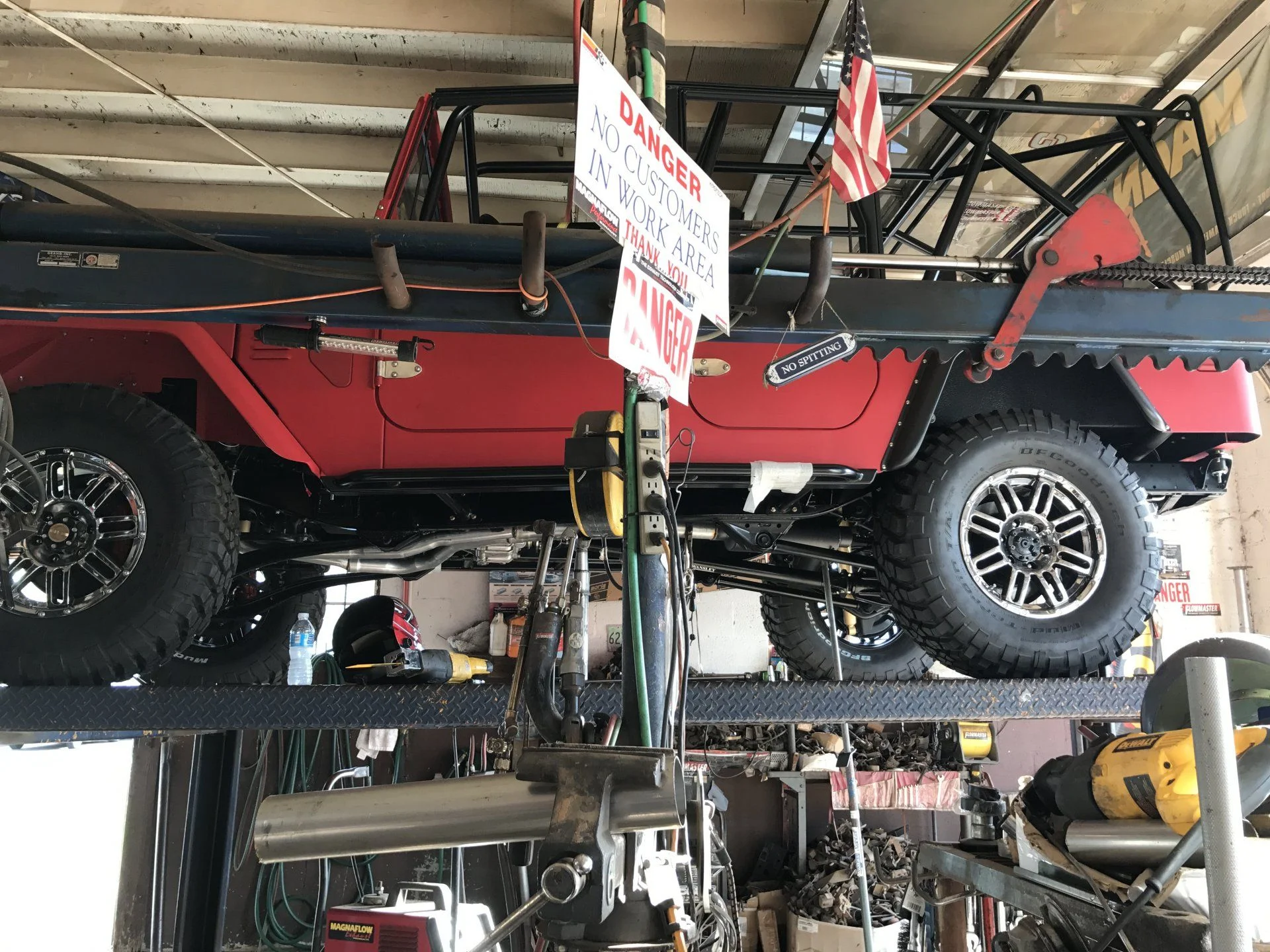

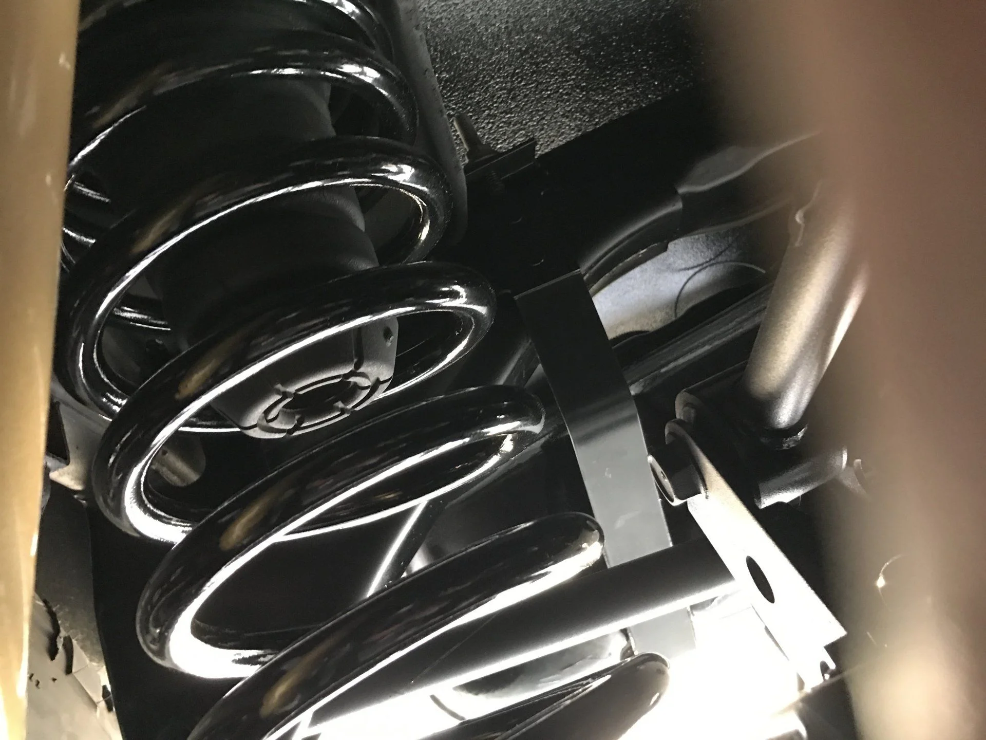

so the body was on the frame with the old springs and stock Toyota shocks.
I decided to go with the Icon Vehicle Dynamics 3" lift springs and TJM shocks.

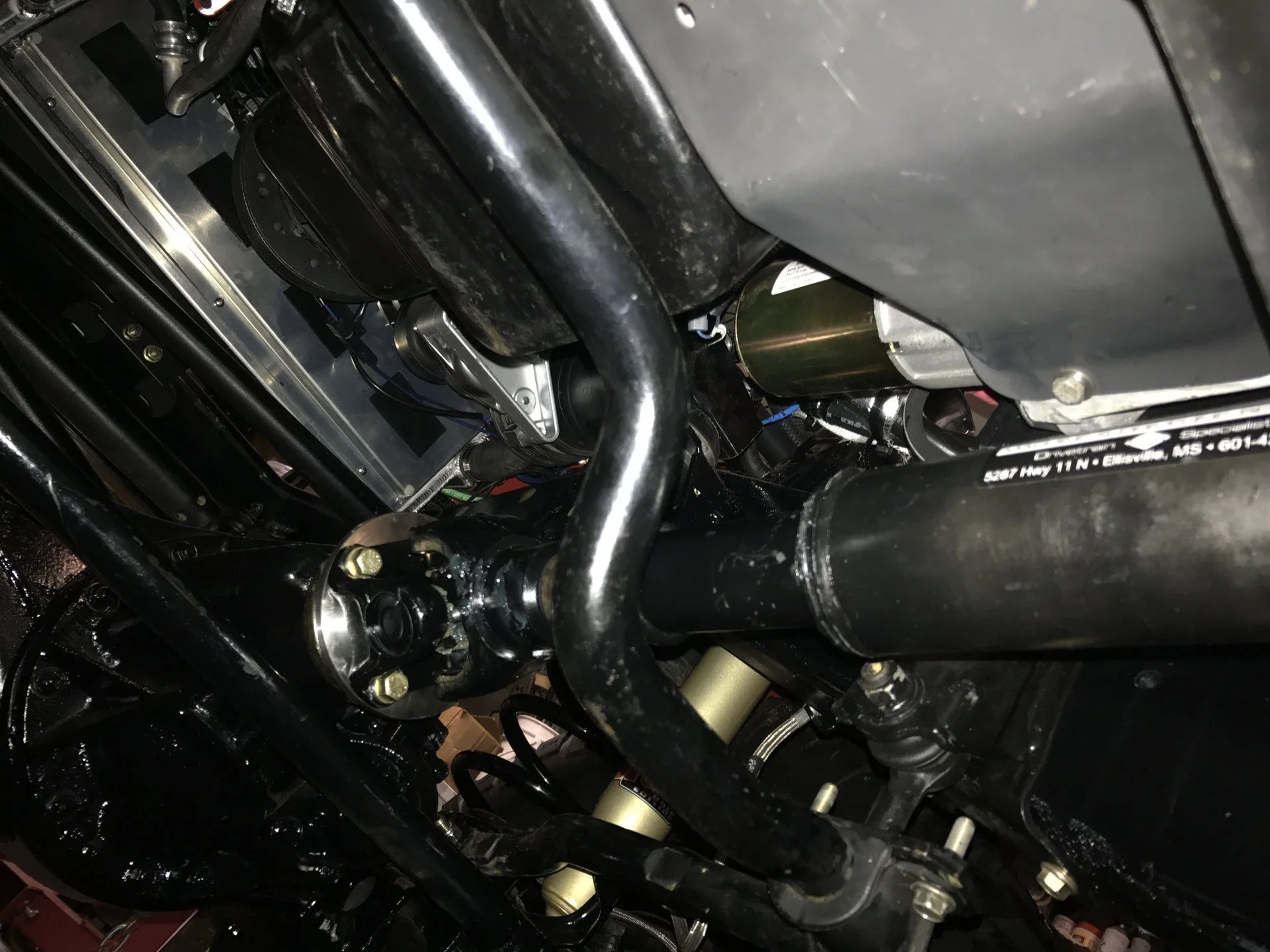

Custom drive shaft lengths for front and rear. the front is a early 80's 60 style double cardon. Cruiser Outfitters fixed me up with transfer case flanges. I had to change the front differential pinion flange to a FJ60 style to mate with the custom driveshaft with the double cardon joint. It worked out nicely. The rear drive shaft ends also were from an early FJ60 with new ujoints and custom length. Wansley Driveline in Laurel provided that service.
it did give it the clearance needed for the 35" tires. Ride? I'll have to report on that later

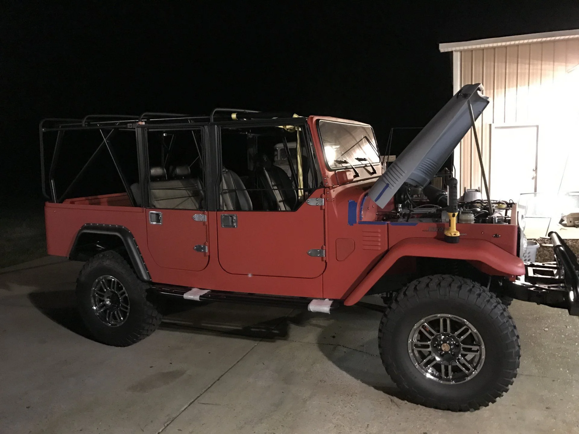

so I have been focused for the last couple of months trying to get this baby ready.

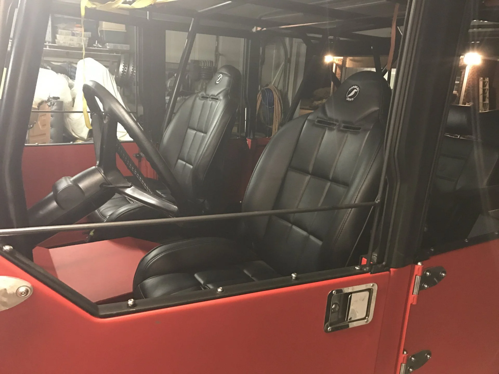

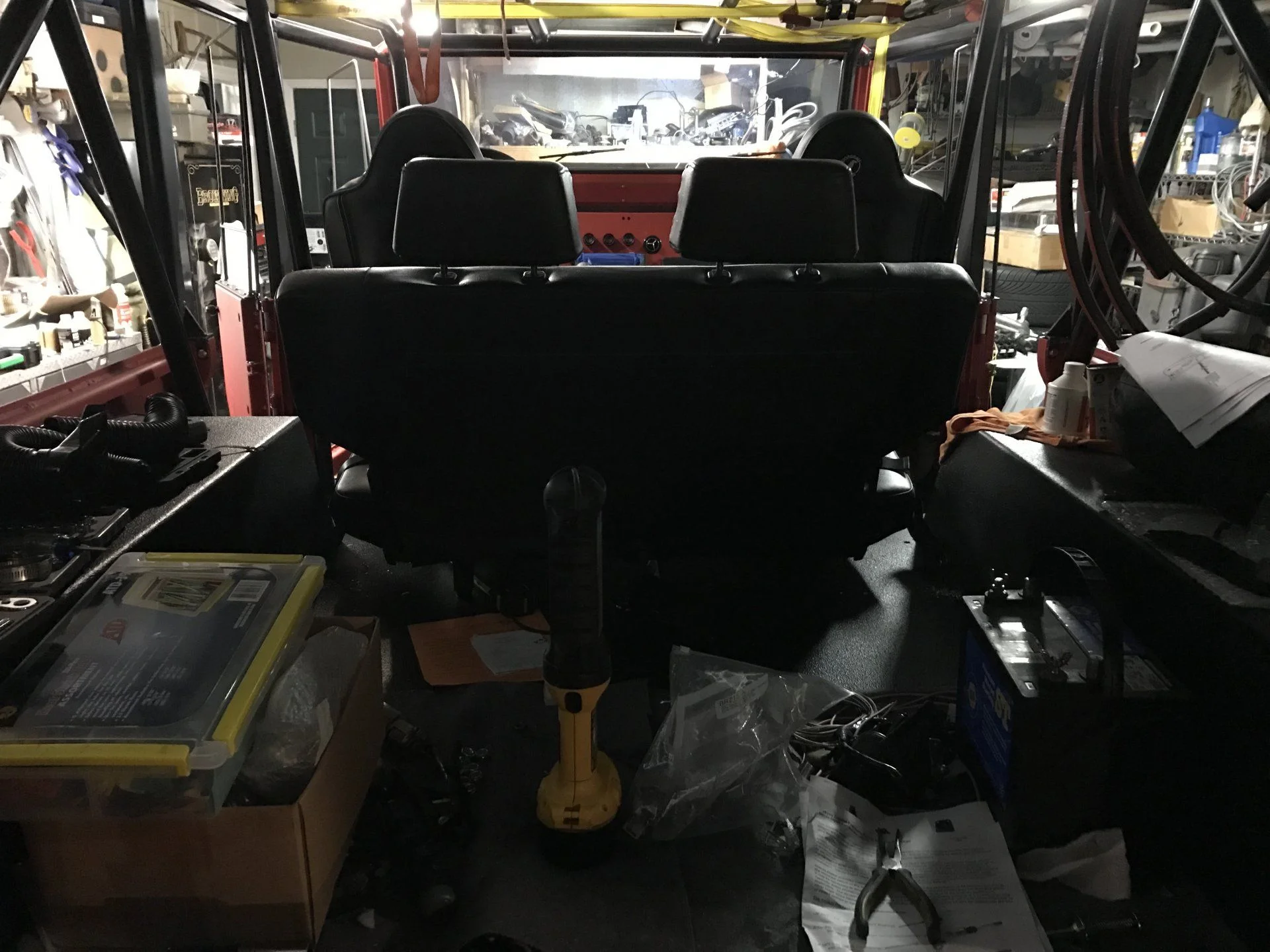

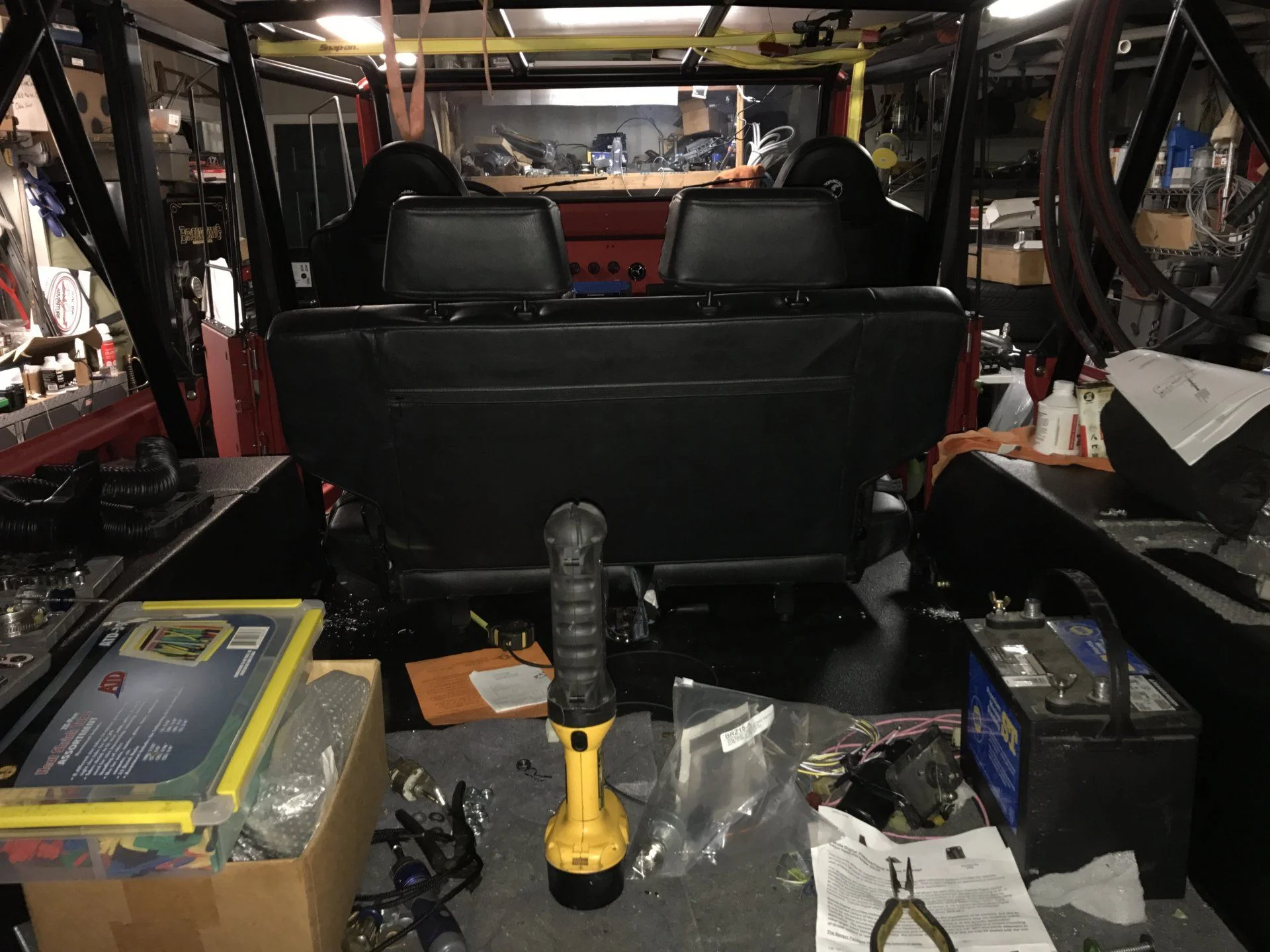

Interior work- fold and tumble rear seat, Corbeau Baha reclining front seats, exhaust system, etc

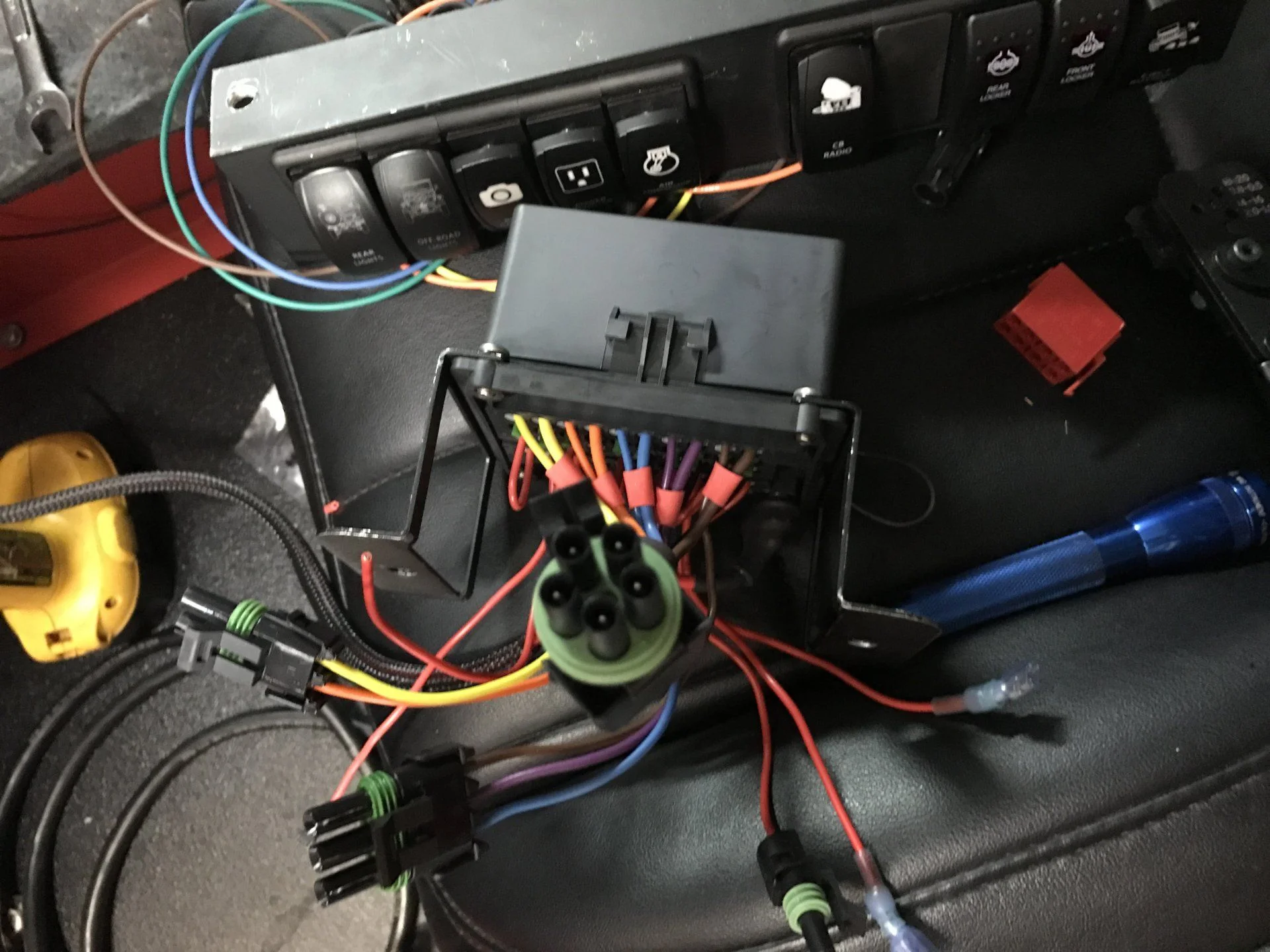

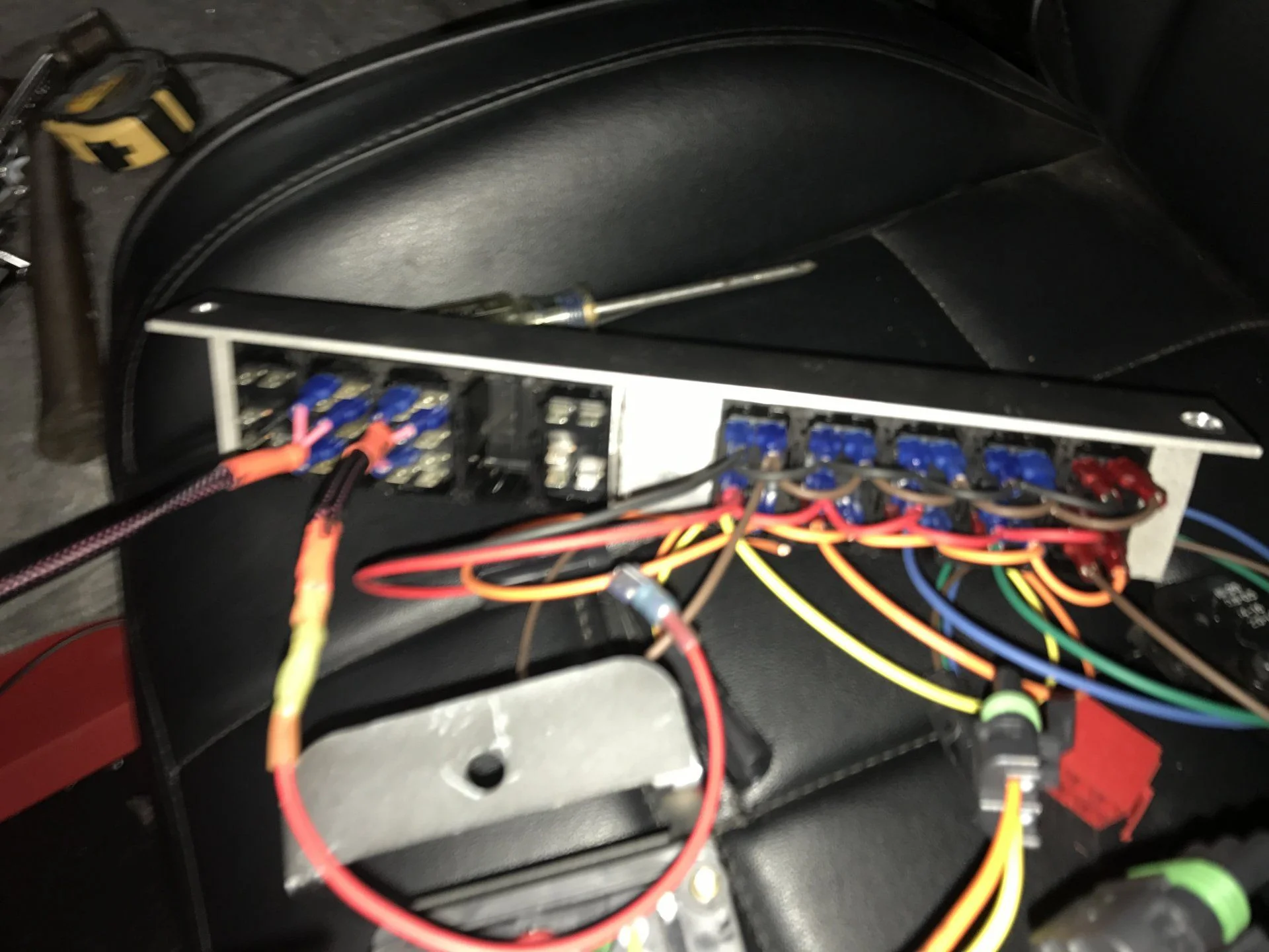

I picked up the e-locker switches from Lowrange Offroad, built a harness to connect to the e-locker differential harness (thankfully I had).
after some head scratching and research, BAM! I have e-lockers functioning as they should and independantly from each other.
a separate switch panel for lights, rear camera, and ejection switch (ha) was put in.

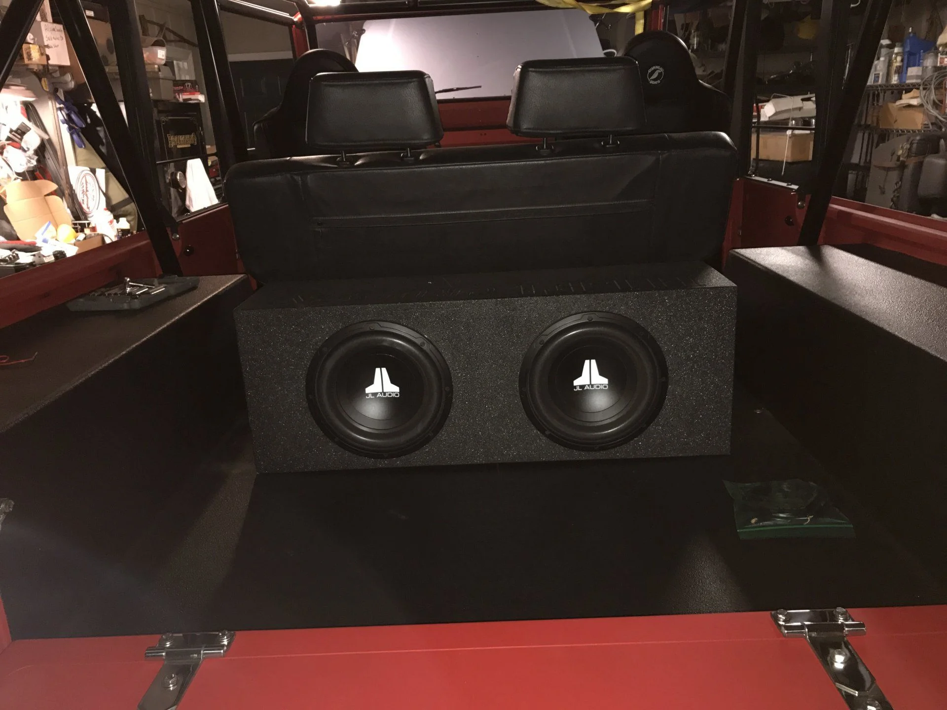

Oh, and one must have some BOOM! BOOM! so my son says with his contribution of a nice bass system with amp.

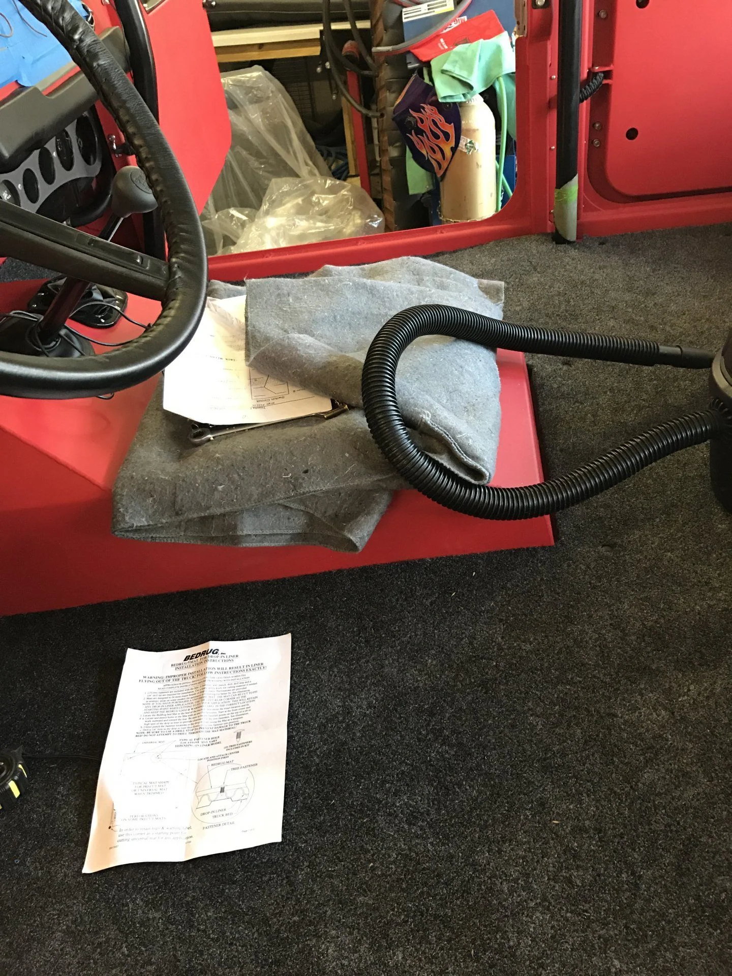

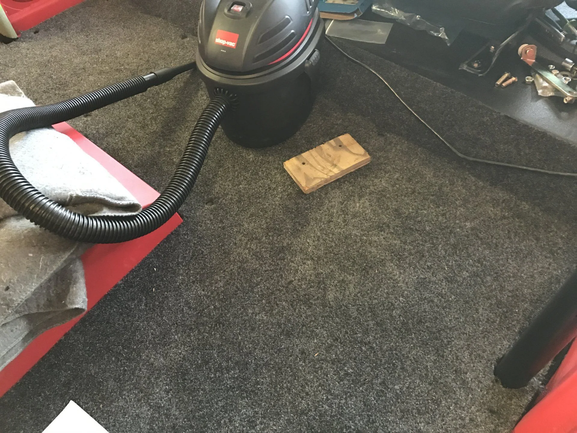

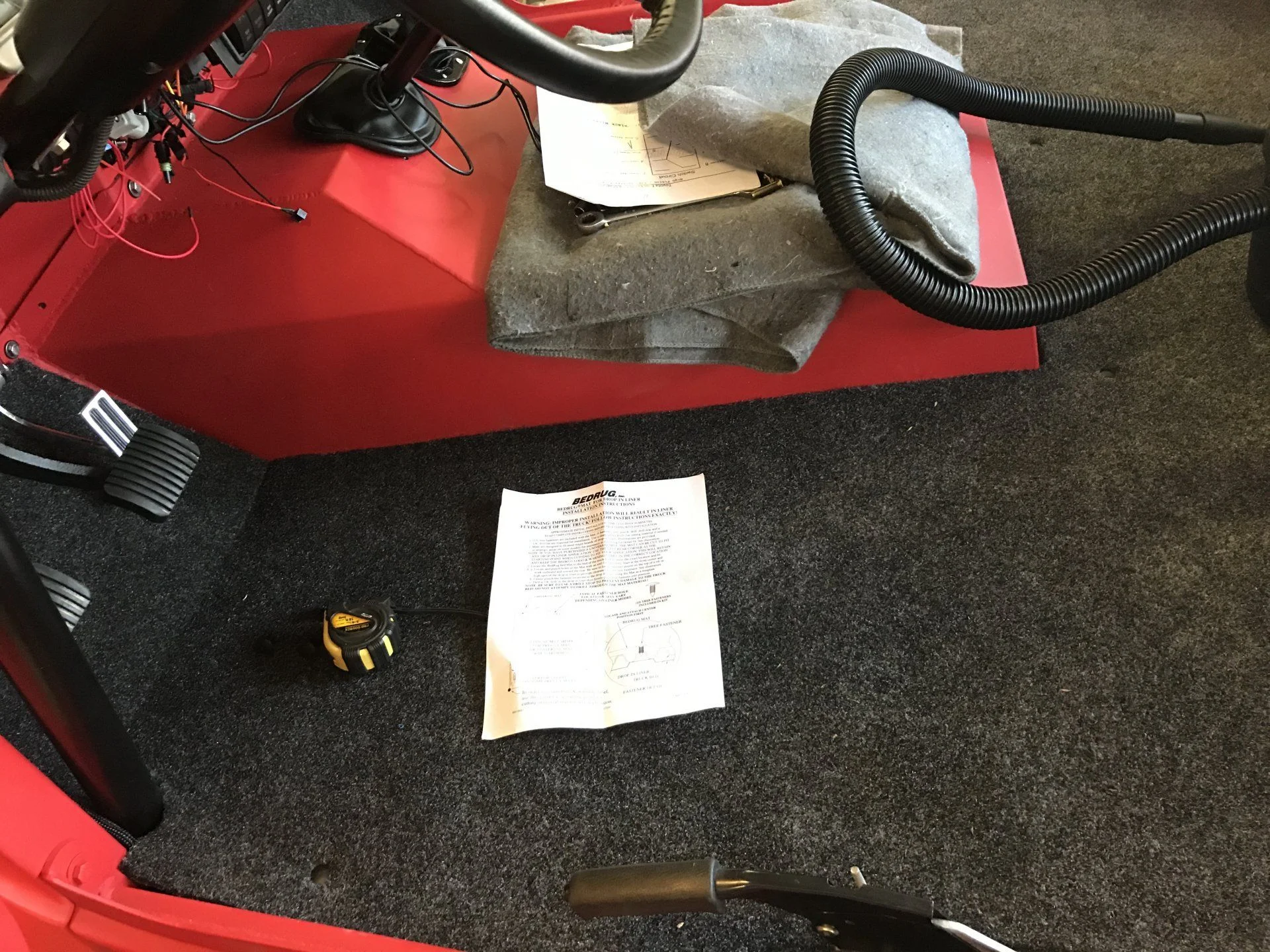

I have used the BedRug system in the bed of my last two trucks. it is nice stuff. They offer a piece 66"x98" so I got it to cut to fit the interior floor.
The pioneer radio is very clear, and operates nicely.
I went with a Tuffy 12.5" wide center console. The interior space in this model is awesome.
Lots of rear leg room and not crowded at all in the front seats.

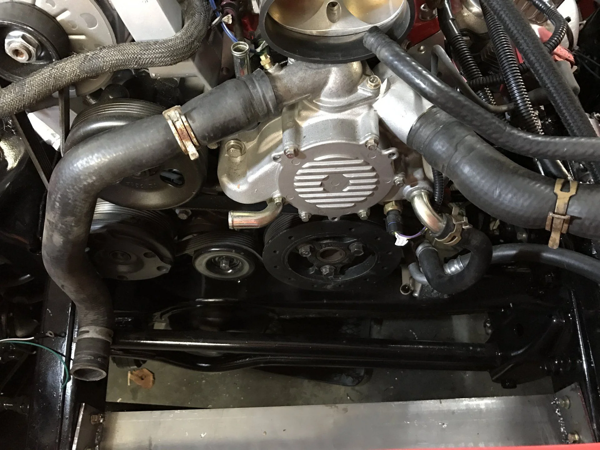

I'm currently converting the LT4 Optispark to an LS1 type coil per cylinder using the LTCC conversion kit. I did get the engine running and I wanted to make sure it would run before I did the conversion.
I'll post some pics of that later.

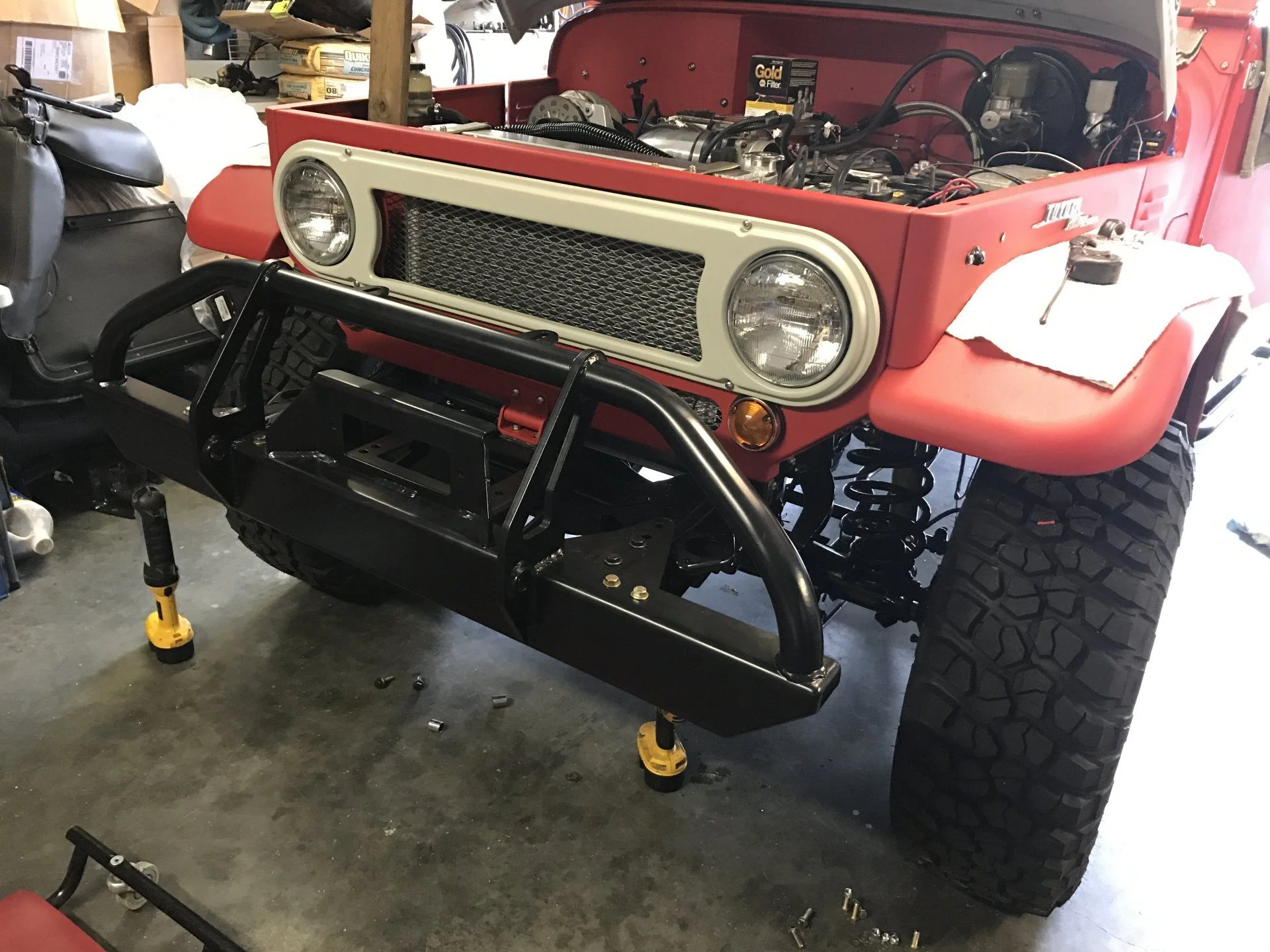

I forgot to post a pic of the 4Plus Products custom front bumper. Because the frame is wider than a 40, Dave had to custom make the front bumper.
Nice work on his part.
