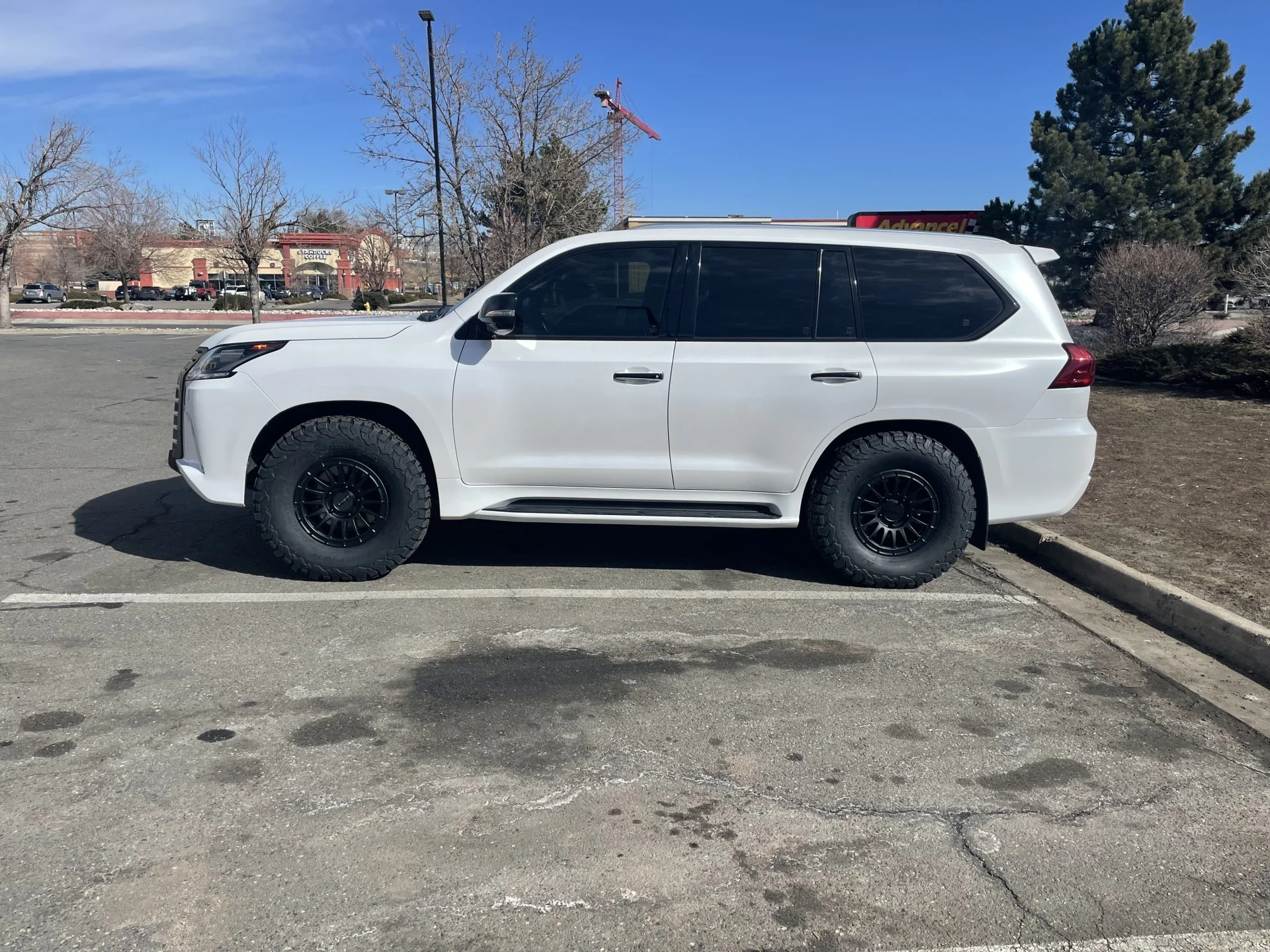

Threw some 315/70’s on 17x7.5’s yesterday. Technically 34.4”x12.7” Front sensor lift maxed. Rear stock for now. No rubbing so far in the urban jungle. Unmodified body mount.
Nice! I think you're on +40 offset?
Keep an eye on the UCA. Especially high compression with high steering angles dialed in. High probability of rubbing the UCA.
It’s a +25. Closer to the outer fender but will check after some flexing and turning combos.
Ah, it'll be super close but you may be fine. Keep an eye for witness marks near the underside of the arms.
With +25, the other concern is fender lips. Both front and rear. On full compression, you'll almost certainly have contact and that's too nice a rig to mangle the fender on. Could roll fender lips/fenders. On front axle, can add a bit of negative camber. Can also add larger compression stops.
Yea, thanks for the heads up. Definitely watching the outer fender lips. Fronts seem to be able to clear. Rear is another story. I’m super familiar with the Timbren active off road bumps and think they could help if I can get them setup correctly.
