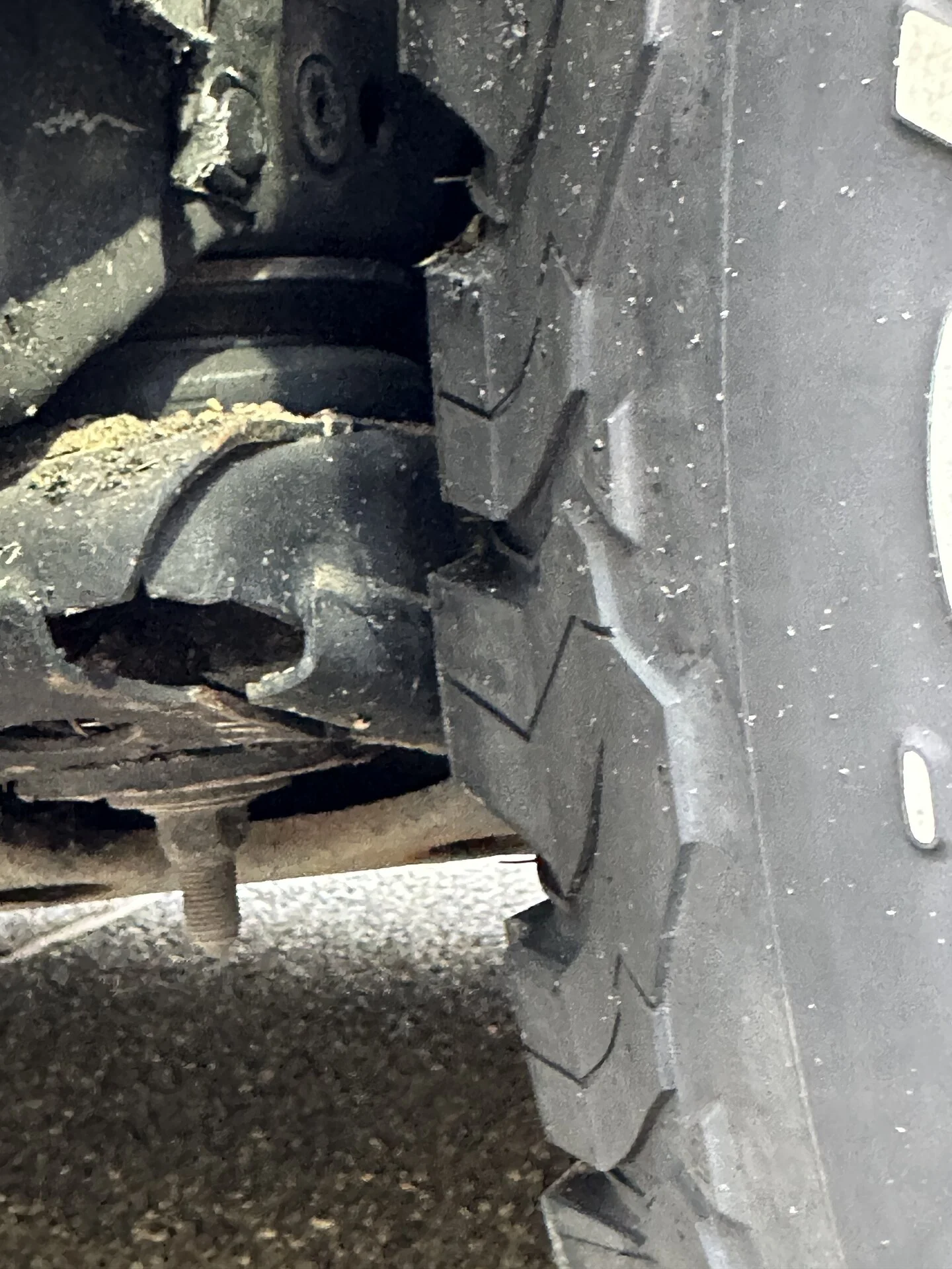

How do you know whether you need a body mount chop?
My tires don’t rub and I’ve got a fat fingers width at the closest spot
15 offset and kenda 35x11.50r17…true 34.5” when weighted on the vehicle.
For your fitment and offset, I think you might be fine against the body mount.
The test I use is to trail brake into a turn. That is having some steering dialed in and brake while listening for any rub.
Having more caster dialed in can also help pull the tire forward away from the BM. May want to avoid UCAs if you don't need it as that pulls the tire rearward towards the BM.
go into low, and turn full lock to lock. See if you hit anything

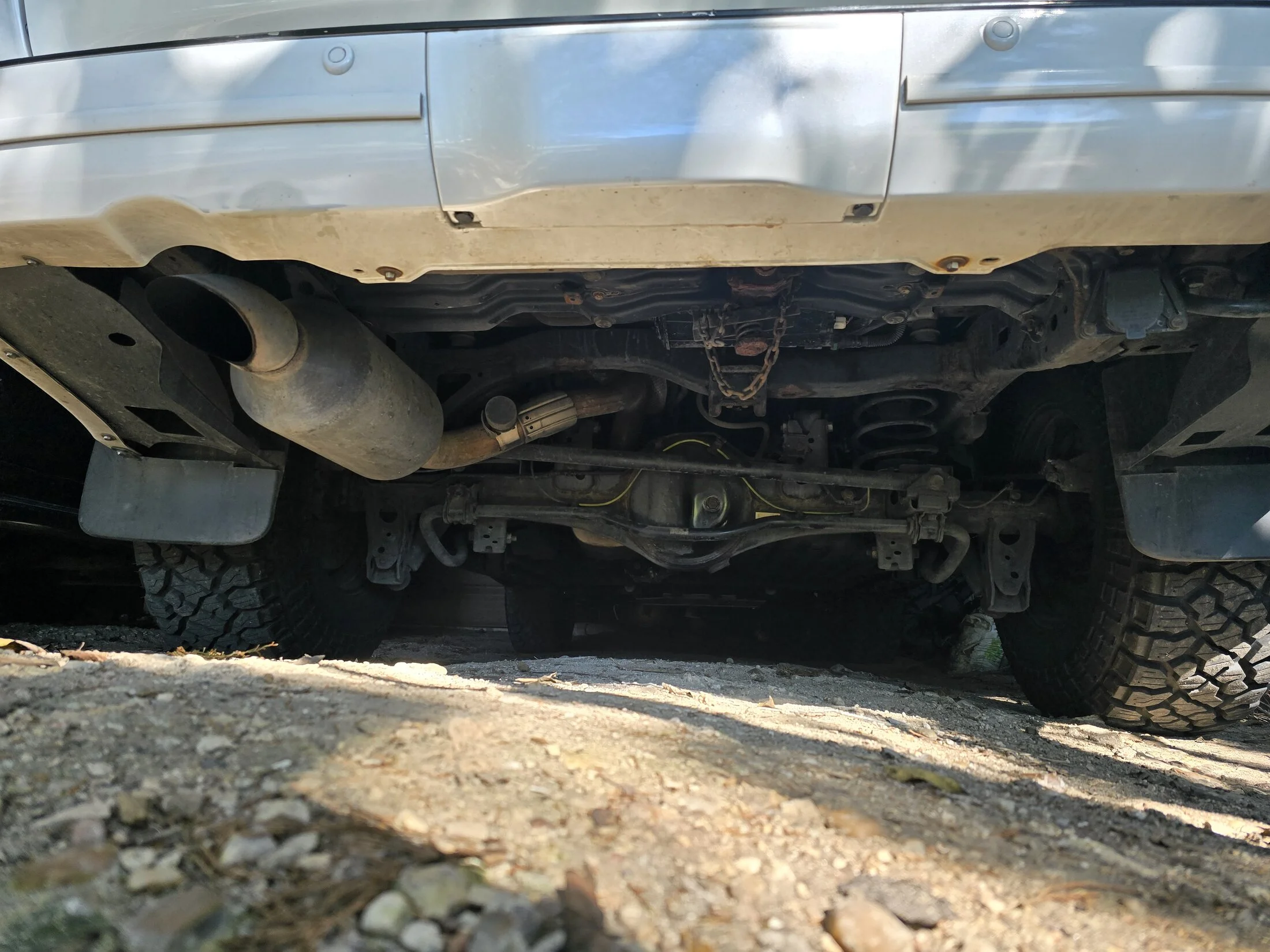

Spare tire
I won't go down the path of rear swingouts for several reasons. So I need to maintain a workable spare. I continue to be amazed at what the 200-series can fit.
My situation is a bit unique in that I have a 12.5 gallon LRA aux tank in the boot. This pushes down the spare by 1". I wasn't happy with how far my previous 33.2" x 12.3" tire hung down in combination with the subtank.
Ideally, I would have a matching spare as I did with 33s, but because of diameter and width concerns, led me to use a non-matching skinny - 275/65R20LT, specs 34.1"x11". Versus 34.5"x12.5" for the full fat 35x12.5 tires. The spare is still a full performance tire, so in the off chance I need it, I can still continue on whatever trip without concern. Those without a tank can get additional width accommodations by removing the bracket on the leading edge, and bending the tube bracket upwards, that comes off the rearmost frame member.
Diameter concerns to the 4x4 system shouldn't be an issue as they're close enough - 609 to 602 revs per mile, or about 1% diff. Whatever difference could easily be made up for in inflation pressure.
Fit in the boot is tight, but good enough. This pic is with the suspension in full droop, so there is the possibility of contact with the panhard bar on extreme compression. I'll check later but I think it'll fit with clearance.
Diameter comparison. Hard pressed to tell which tire is the shorter (hint: far right)
Spare in place

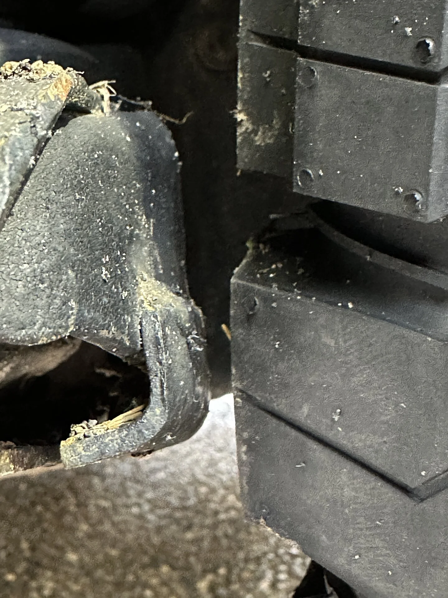

Adding here as a reference but I initially thought I could get away without a BMC on my “runs small” 35x12.50 KO2s at 25mm offset but I’m glad I did it. I did what others have done and just notched the mount and pounded it back maybe 1/2”

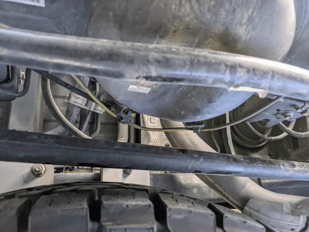

The description you give does sound like the effect of the panhard bar at too much of an angle and needing either of the brackets available for it. You may want to share a photo of the angle it sits at and others can comment.
Here is an image. Ground is just a tad uneven. But this is about the angle it's always at. Didn't know there was a panhard correction kit for these.
There are two kits that I’m aware of.
You’re correct, it doesn’t look too bad in the image but I think most would agree, if the sensor is maxed out, it could probably benefit from a PCK.
Shoot, I have a gx470 weld on kit from eimkeith sitting in a bag here in my office, but it's for the 470. I ended up getting the bolt on one instead from dr. Kdss and installed that. I'm sure it's different though for the 200 series. Still though, I wonder if the angle is severe enough to cause the rear end 'swing/hop' I'm experiencing, to warrant a correction kit. I wish there was a more definitive way to find out....other than throwing parts at it lol
