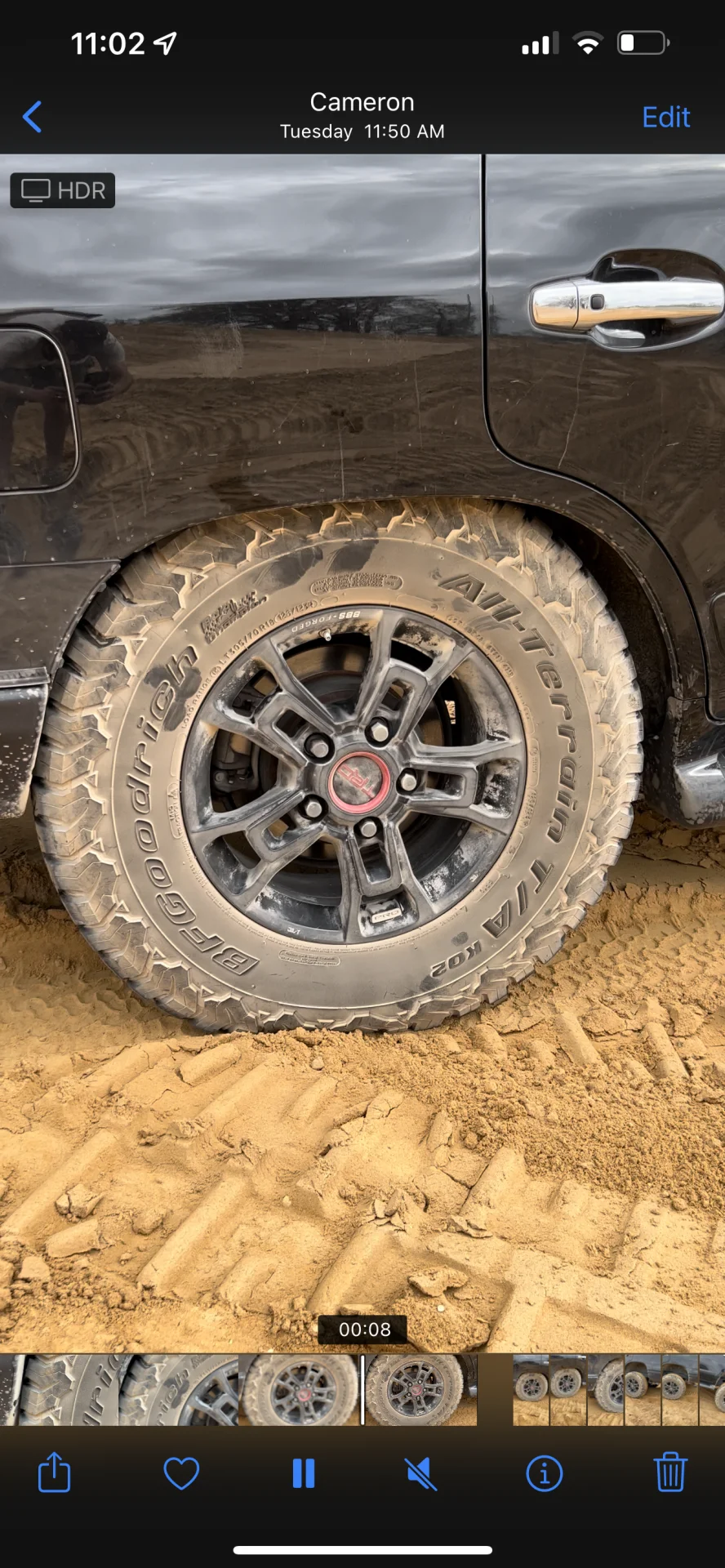

Same, I can't find my last alignment printout but I think I'm -0.8 drivers side and -0.7 passenger side. At AHC High, I am still into positive camber and on pavement handling in high is a mess, but much improved from what it was, I can definitely see why they speed limit the height settings. From a street handling perspective this has made the handling a good bit more balanced, especially when it drops a touch at speed. I found the degree of understeer with stock alignment to be awful, but I get the intent especially with a large SUV and the typical demographic. As it is setup now you can get it to rotate at the limit with a little finesse and throttle. In the dirt it is much easier to get it sideways and hold a line.
My kind of driver. 🤙
You’re able to do this with no body mount chop?? That’s a zero offset wheel. Damn that’s awesome!
Yep. It’s actually a +25. And I’m pretty sure it would clear completely in a full stuff and partial turn situation. Checked when a little flexed and turning and surprisingly could still slide my fingers between tires and the mount.

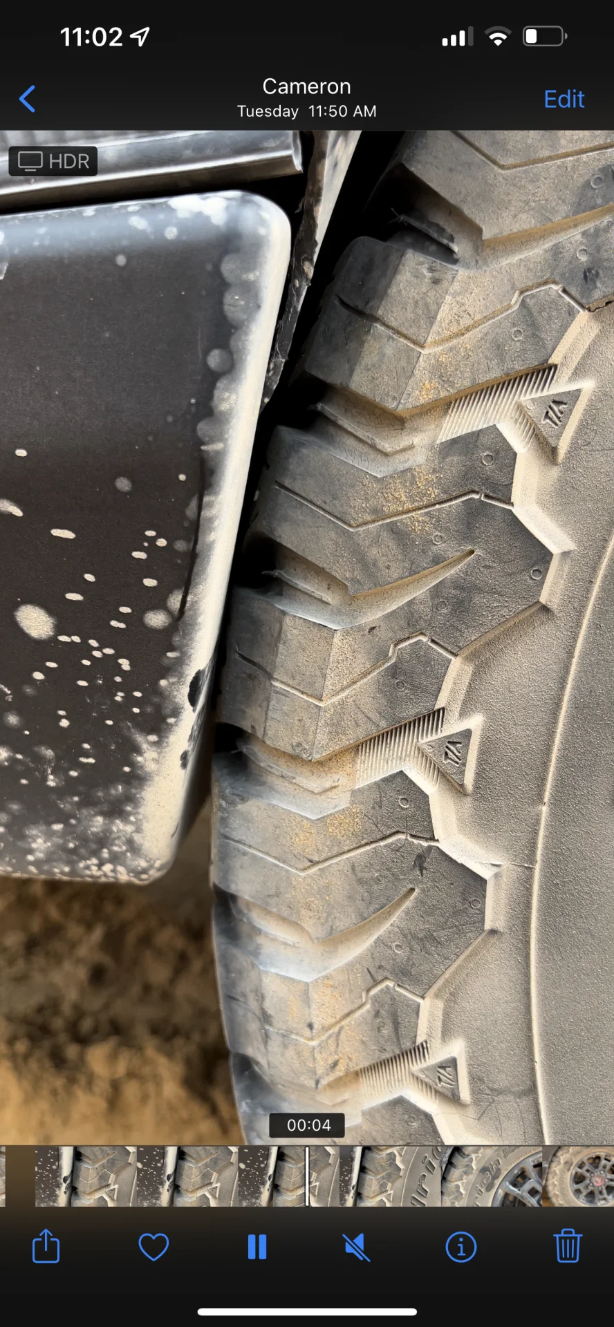

It's something to keep an eye on. The tire will move as the control arm bushings flex under load, so a static test wouldn't tell the whole story.
The litmus test for me has been medium to hard braking with a tad of steering dialed in. If it's going to contact, that's the situation that will bring the tire closest to the body mount.

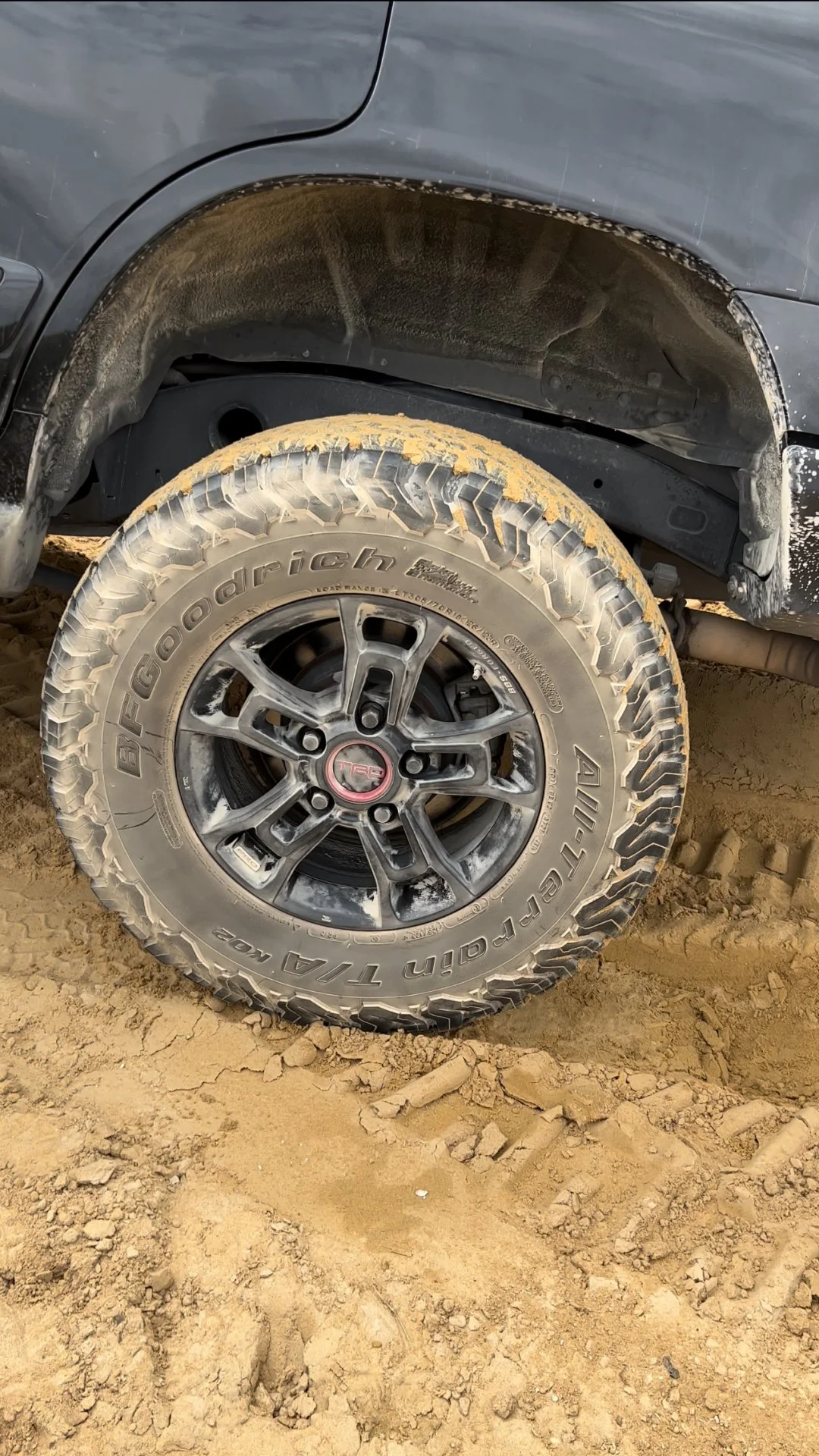

This is how mine stuffs. It seems more centered in the wheel well. Can’t wait imagine why.
This is how mine stuffs. It seems more centered in the wheel well. Can’t wait imagine why. View attachment 2980232
Because the rear is a solid axle, how centered the wheel is will depend somewhat on the opposite tire. I think @radman situation has his opposite tire flexed in droop? With the trailing arm geometry, that'll pull the drooped tire farther forward projecting the compressed tire more rearward.
Could it be in your test, you have both tires more squarely in compression?
I had the front tire ramped so the opposite rear was dropped out. Not max droop tho so could have an effect your speaking to.

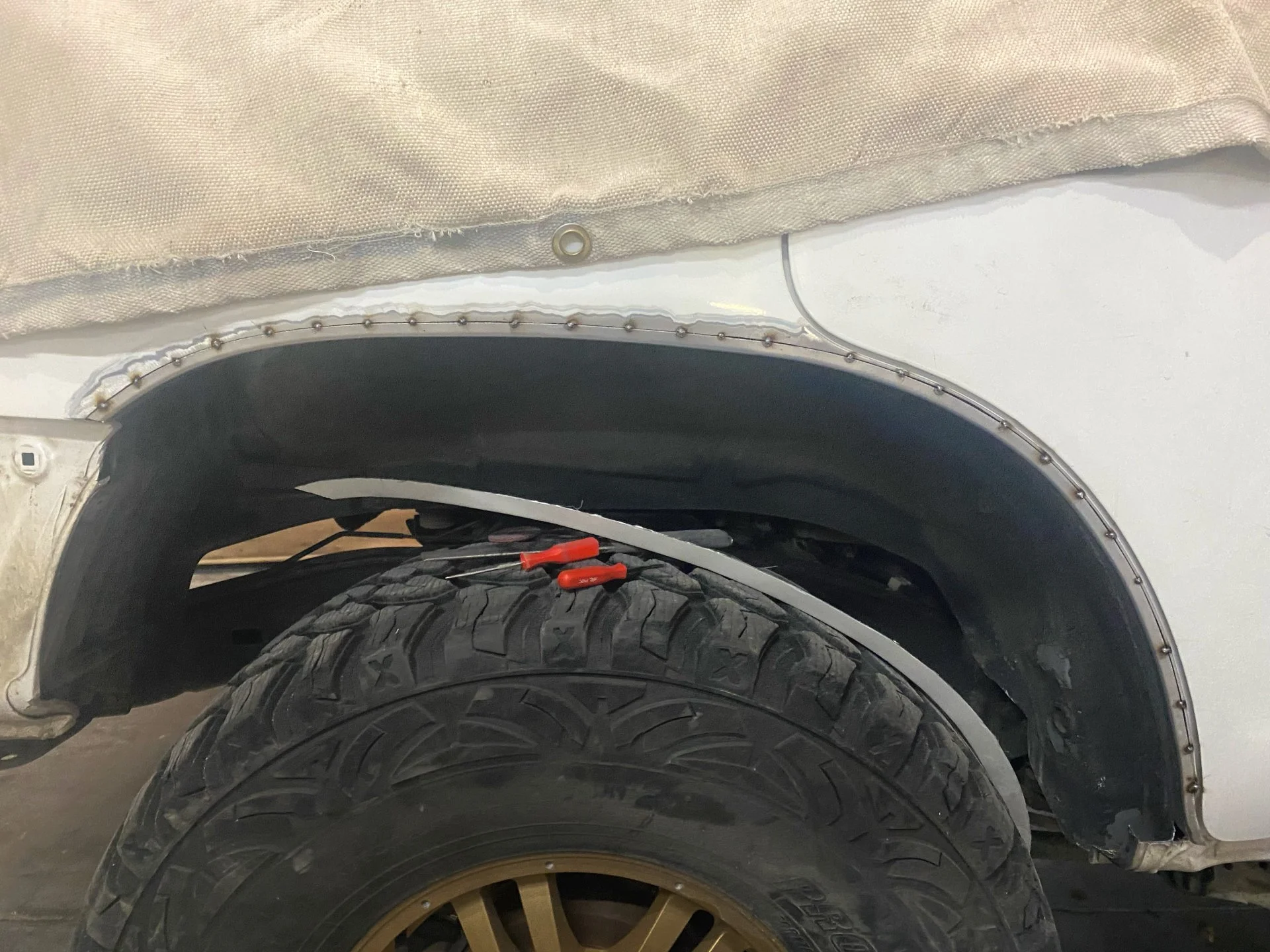

This was a helpful thread. Need to revisit the pinch weld on the driver side and finish reshaping the plastic but otherwise good to go for these kenda klever rt 35x10.5r17. Rock warriors and a 1” spacer

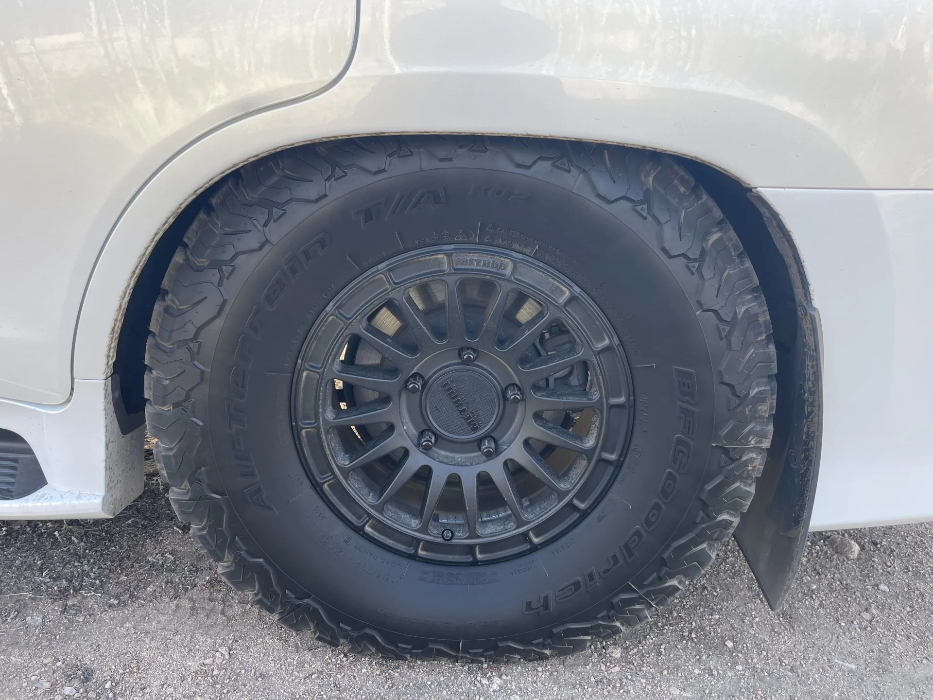

My tires don’t rub and I’ve got a fat fingers width at the closest spot
15 offset and kenda 35x11.50r17…true 34.5” when weighted on the vehicle.
