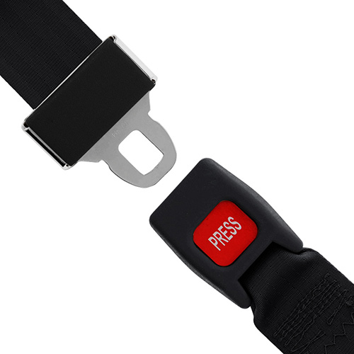

Anybody put seat belts in a 40 that didn't originally have seat belts? What did you go with?
While I'm prepared to die like a gentleman, pressure is growing from the other 2/3rds of the passengers to " not die in this death trap"...my response of it not being a trap, if ya ain't strapped in it, has not gathered any favorable responses yet.

I bought some from seatbelts.com. Buy the 60” for the DS and 72” for the PS, if you have the front bench seats.
Ordered some red ones with chrome lift buckle.
