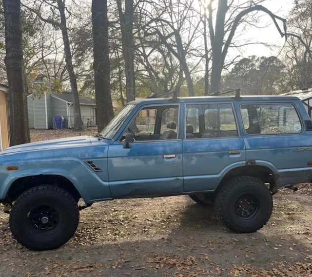

Hello everyone,
I just recently purchased a 1983 FJ60. I have always wanted one and finally made the decision to buy one. This particular one is cosmetically in pretty rough shape. It runs really well though. I have purchased a tune up kit and a knuckle rebuild kit. I have already repaired the fuel gauge and a few other small issues. Currently im trying to figure out a popping noise when im turning and an oil leak i cant seem to track down. My goal is to get it mechanically sound and not do anything with the body. I have never owned a Toyota so im interested to learn about them as i go.

Welcome and nice color! This Forum is invaluable! You will learn to use the search function but sometimes end up using google to get you to the right place on here. Oil leaks are everyday things with the 60. :) Nice rig.

first time new FJ60 owners always make me smile.
If the sound you’re hearing when turning the steering wheel is more of a “clunk” than a “pop”, clunk sounds during turning are often just the leafs in the front shifting within the pack. Not dangerous.
You can verify if that’s what’s happening by spraying the front leaf springs with water. If it clunks even more when turning — it’s the leafs shifting sideways.
I greased my popping leaf springs. It helps.
Just make sure the oil leak is not the oil galley plug on the head, that one can lead to catastrophe. Any other oil is nothing but an annoyance in comparison.
