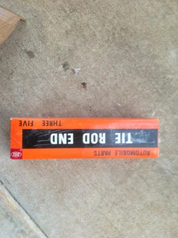

Also, I put the same brand TREs on the 80 that I bought very early on from MAF at the same time I bought the tie rod/drag link, thinking I was buying OE.
They've rusted beyond anything else on the 80 and wondering if its safe to assume that OEs would too.
If not, I'll opt for Toyota on the Pig. Hate rust, especially when it's on new parts that are replacing parts that are +15 years old, and not rusty.
Those are raw steel, you can hit them with some clear spray paint and they won't do that ... the actual TRE is as good as OEM (which you had to buy as the whole rods, but can't get anymore). I remember when I rebuilt my 40 axles with 60 stuff and how mad I was with myself for not doing that on the new calipers which flash rusted the first rain :-(
Didn't think of that on the 80.
What kind of clear paint (??) have you found works best?
Be just as well to mask and paint black?
Honestly, installed the MAF sourced 555s knowing that they might not be on there long and would swap to OEs or 1 tons. (entertained high steer knuckles and hydro. hydro.....eventually, but keep the current rods.)
While I'm thinking of it and since we can expect that 80 parts will be NLA in the coming years, going to ask Onur if TREs are available apart from rods.
I might beg to differ, but......
On 80.
OEs were tight when I pulled and probably could've been reused (106k).
555s show slack at (113k) in the gearbox pitman arm. Not much and it's the only TRE I've separated (many times, unfortunately) but was disappointed in.
That said, the 80 had the OE tires on it when I bought it and 37s in the rocks may be harder on, but would've thought I could get more than 7k.
