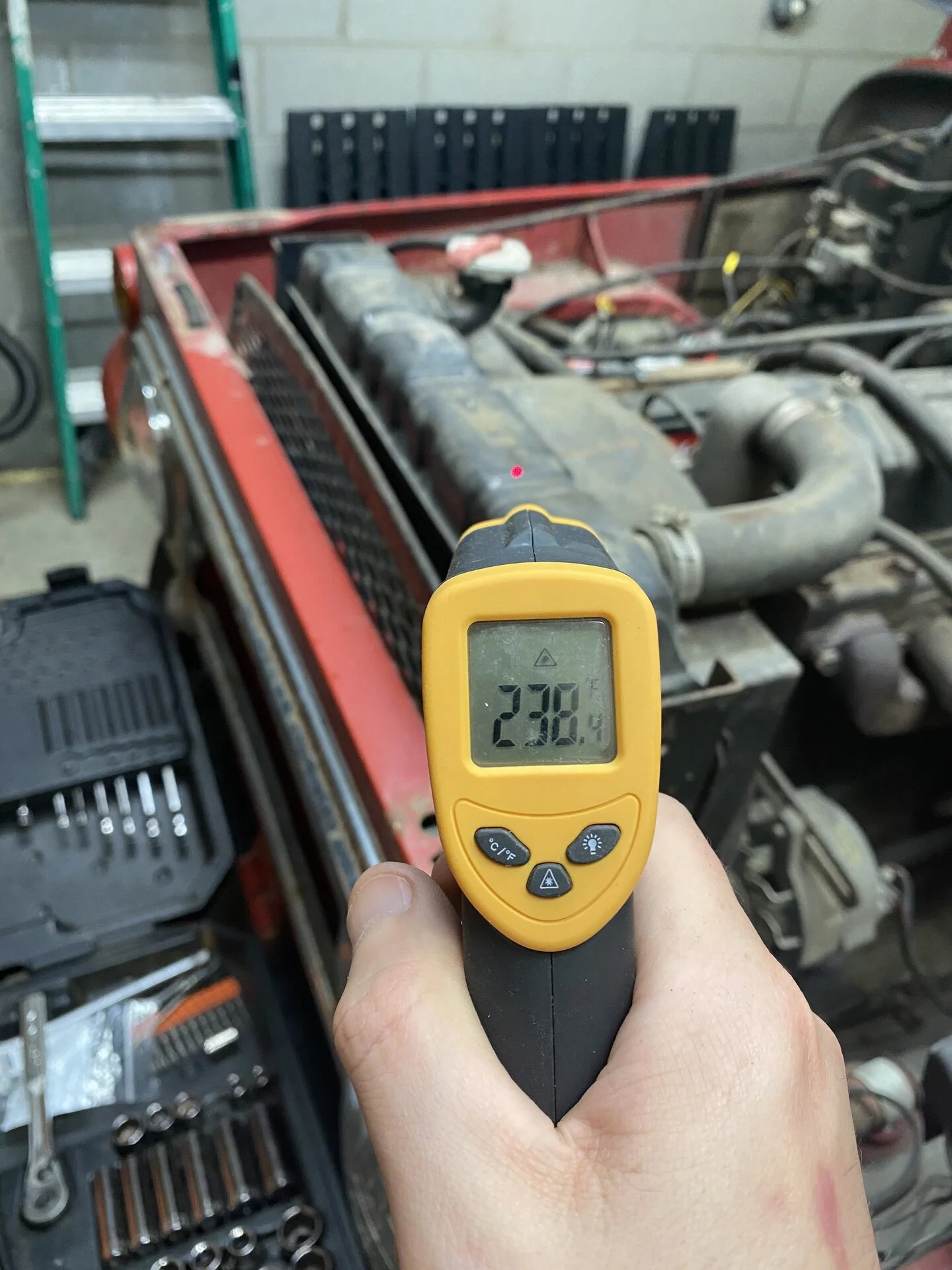

I literally had it parked for 10 minutes in my driveway checking the lights to see what worked, etc. Drove down to the bottom of my driveway…brakes felt suspect, but stopped…maybe that is drum brakes?
Anyway, started smoking/steaming. I unhooked the battery in case it was electrical…but seems like the radiator maybe. The radiator was 240 degrees plus…the hoses were super hot. Also a bolt on top of the engine that seemed to be slightly steaming as well. Didn’t get a pic of that.
Also when I turned the key off the engine stayed on and I had to pull the throttle knob out to get it to turn off.

No seriously, does it have enough coolant?

I’ll check tomorrow. It smelled like when you have water in the radiator, not coolant. Should I use green coolant?

1st inspect for a blown hose or something. To diagnose the problem I would not put a/f in it. I try to avoid tap water because it has too many impurities in it. You can go the grocery store and buy distilled water for cheap, probably 4+ gallons. If the leak doesn't show itself just by adding water, you can borrow a rad pressure tester at an autopartsstore. Once it's fixed then add a 50/50 mix of distilled water and a/f.

Thanks. Just put 2 gallons of water in it and still not full. I’ve got to stop and get some more. I found a leak…believe it is the bottom of the radiator. Lower hose connection looks fine.
