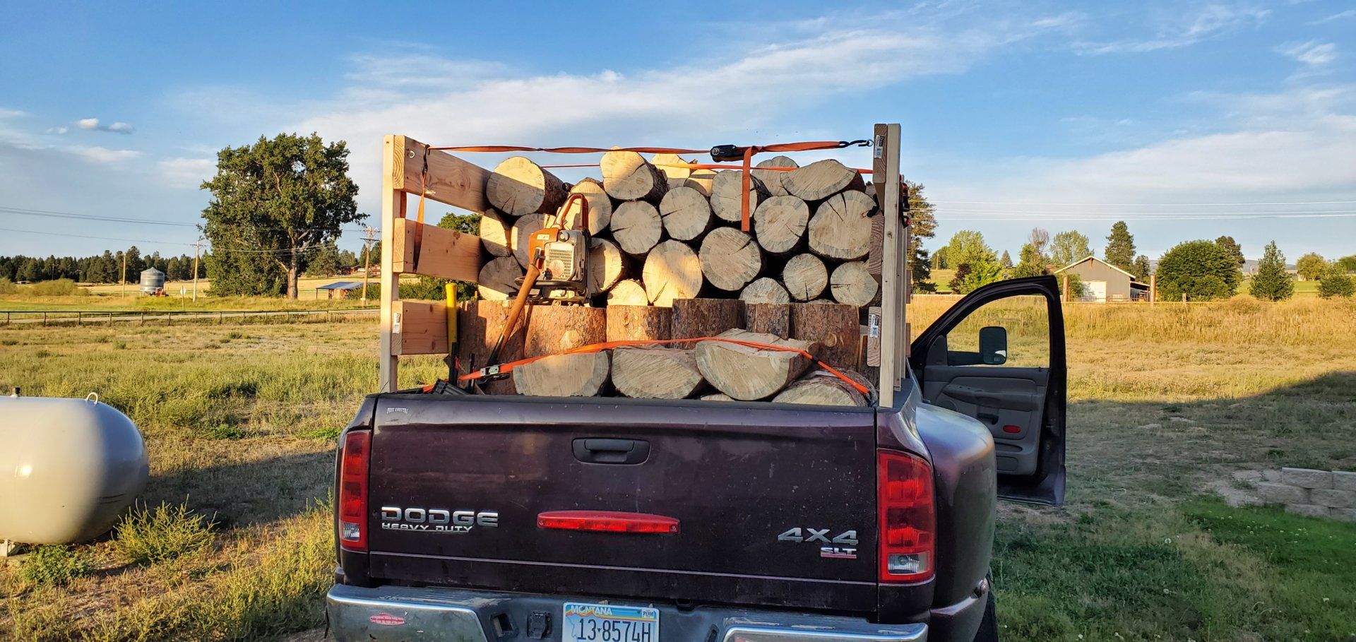

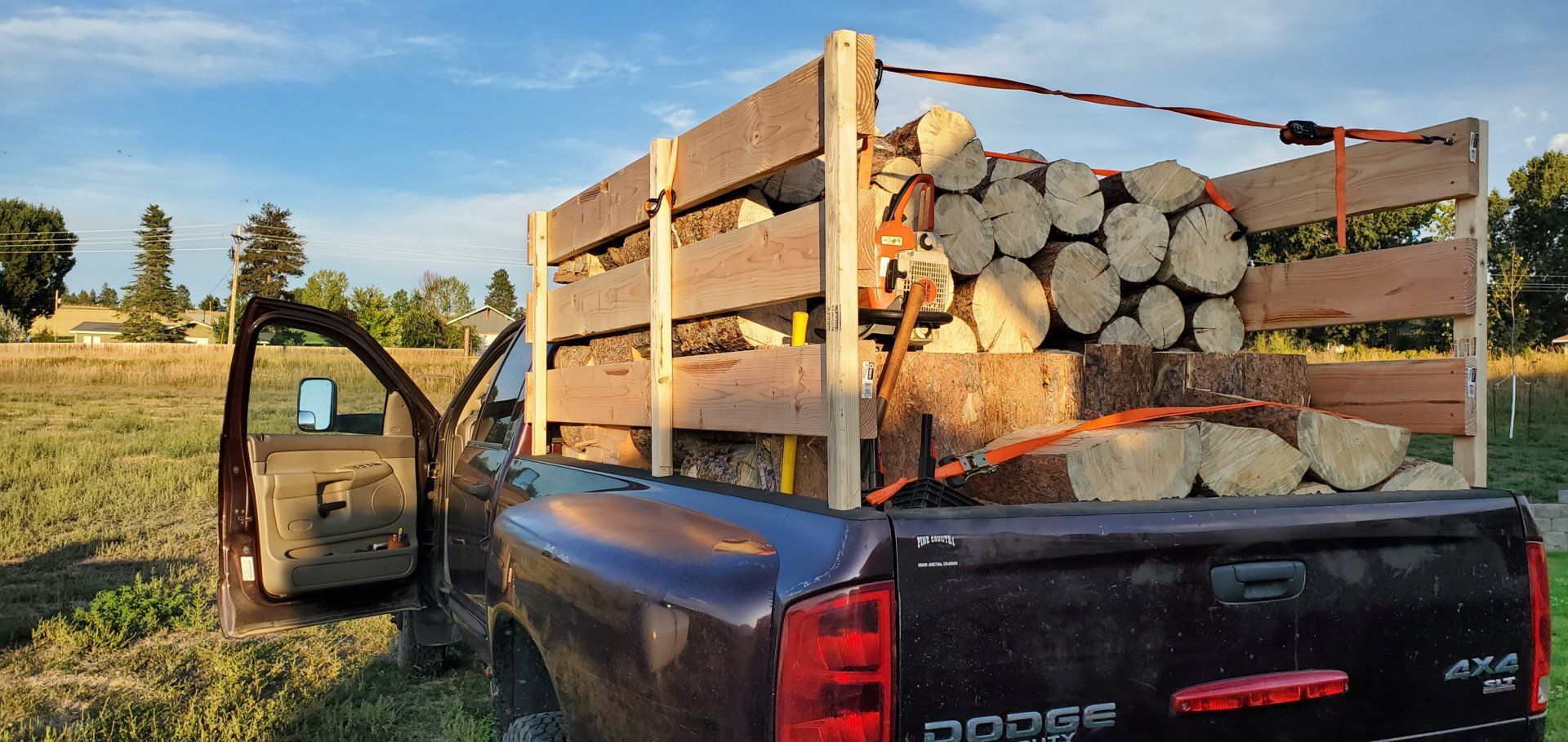

Another load of wood. Mostly lodgepole again, with one big fir in the middle.
I definitely need to get a bigger saw, the MS290 is nice but it struggles on some of the bigger trees, I will probably step up to a MS362.

Nice load of wood. If moving 'up' in a saw you might consider a 391.
Going up the ladder to a 362 is not really that much a gain IMO.
IF your 290 is stock...you could do a muffler 'mod' and then re-tune the carb. Have it so it just 4 strokes out of the wood but cleans up in wood. You'd be very close to a stock 362.

My buddy was using a 362 yesterday when we were out cutting, it is by far a better saw than the 290 is. I haven't done the muffler mod on the 290 yet.
I'll look into the 391 prices and specs also.
For what it's worth I'm asking my 290 to do a lot more than it's designed for, it has a 28" bar and 3/8" RS3 chain. That model is reccomend to have like a 16"-20" bar and the smaller .325 chain.
But no one likes bending over all day to buck wood.

Yes a 28" bar on the 290 is just asking too much of it, but I agree no one likes to bend over for very long and a longer certainly helps with that.
You can run skip chain on it and do a muffler mod, both would help....but honestly it sounds like moving up to a more powerful saw is the way to go.

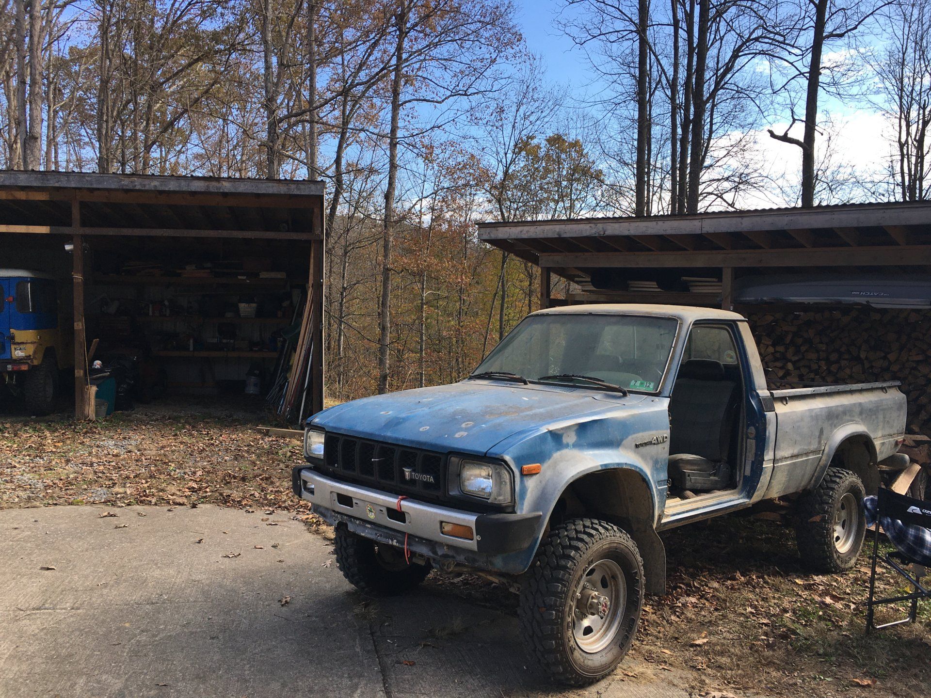

Somebody has a shed full of wood.
I've had all mine cut since this summer, but I need to get busy splitting it. I have enough small 'round' wood to last the first few cold snaps, but now that its cooler weather...there just isn't any excuse for me not to get the rest split up and stacked.
