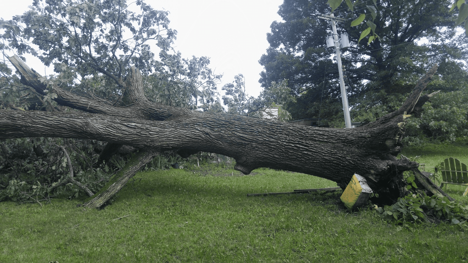

Question for the experts here; This giant is basically held up by 2 large branches (the one in the middle of the pic has already been cut) and I figured the safest way to lower this tree would be to cut a series of ~2 ft sections off the end of one of those wt bearing branches to bring it down gradually. Well, after getting 2 bars stuck it's clear my technique leaves something to be desired.
So, how would you experts cut those high tension branches to limit movement of the tree and keep my bars from getting pinched?

First cut away all the branches that you can in order to see the rest of the tree then start at the top of the tree and whittle it down as much as possible to the branches that are holding the trunk up.
Off hand I would say after you have done all the above I would possibly cut the trunk about where that knot pointing down is.
Start underneath until it starts to give then work from the top and be ready to jump out of the way.

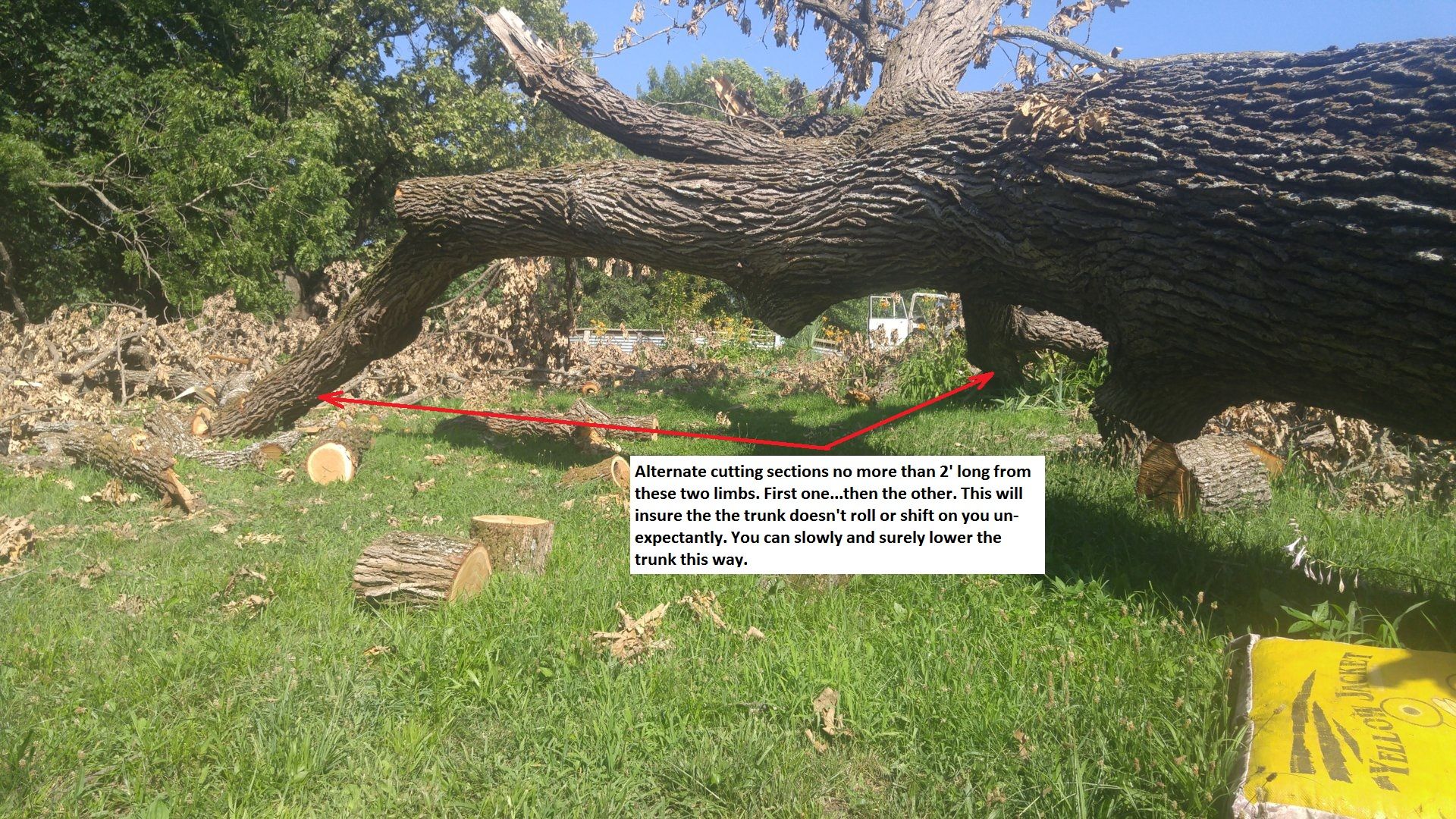

Here you can see both branches that are holding the tree up.
Below is the wt bearing branch that I started to section up a little at a time If you look closely you can see the 2 bars that are pinched and now part of the tree for the time being. part of the problem is that the distal end of that branch is jammed into the ground and maybe there isn't enough slack to move the cut piece out of the way? Maybe I should dig that out and try to get it out of the way.
This is the second wt bearing branch. I haven't messed with this one yet but maybe this is the better branch to go after.

OK.
You are going to need some proper wedges (2 or 3). Splitting wedges are just going to squirt right back out at you (if you can get them started at all).
First:
You'll want to clean up what you already have cut. You have too much laying around underfoot to safely continue. Take your time, rest when tired.
DO NOT cut anything overhead, above breast-height or from a ladder. The limbs remaining above the trunk look to be of no consequence right now.
Don't be tempted to cut long/large sections of limbs off at a time. Looking at the root ball I don't foresee the trunk 'rolling' but it can definitely 'shift' if you take too much off either supporting limb.
Notes:
The limbs are under tension/compression (depending on orientation) from as much as three directions (as you have discovered).
Limbs that are completely off the ground can be cut safely by making a small cut (1/3rd the diameter) from underneath first. Then finishing with a cut from the top. A limb that is OFF the ground has it's underside in 'compression' (will pinch your saw). The upper side is under 'tension' (wants to spread apart or fall). By making the first cut underneath you prevent the portion being cut from hanging on, splitting, etc...and the small kerf allows your cut on top to open up (saw won't pinch).
Limbs on the ground can be anything from neutral to under compression/tension. In your case they are ALL under pressure of some type. You will need to look at each and determine what the influence is. But remember anytime you have a tree with limbs jammed in the ground or a large crown of limbs remaining...all of that is pushing back toward the root ball.
So you have that to deal with as well as the normal compression/tension sides of the limb/trunk you are cutting.
For limbs that you can span with the length of your bar (limbs that are supporting the trunk) cut a 'Vee' in the top side first. This makes room for the limb to close up when you make your bottom cut. Then finish your cut from the bottom (meeting at the apex of the Vee). Be ready to withdraw your saw and move back quickly as it parts. Using this technique the bottom cut will open up and not pinch your saw. IF you see at anytime the bottom cut closing up on you...stop and get a wedge in the cut (top or bottom).
When you get to parts of the trunk that are wider than your bar will span, post back here and we can discuss other methods to deal with that. We are going to need to know your experience and comfort level using a chainsaw. That will dictate what kind of cuts you will want to use.
I know there are faster ways (for Pros/experienced) to do this and no doubt you are going to get some "just do it this way" comments. But I recommend you take your time, use the techniques I have suggested and be safe about it.
Keep your chains sharp. STOP and rest when you get tired. Do NOT saw tired. Keep your working area clear. DON'T let the upper 1/4 of the tip of your bar contact anything (you'll get kickback).

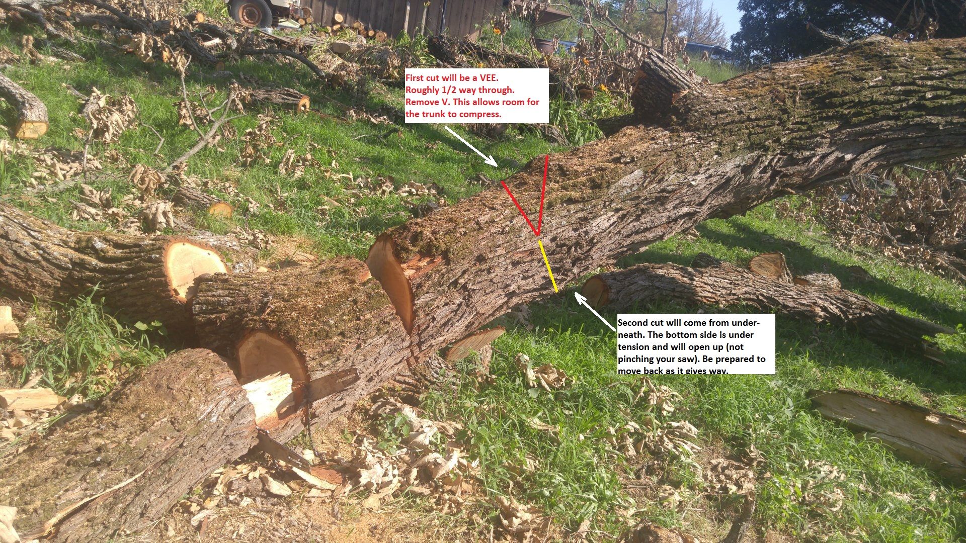

This will pinch the saw bar right from the get-go. The upper portion is under compression. There are a number of ways to address the trunk itself but cutting from the bottom to the point where the tree sags is one I would avoid.
Sawing upward (from underneath) on a trunk at that height will be especially tiring. Better to bore/plunge cut (then saw downward) leaving enough holding wood on top to support the trunk. Then begin at the top with wedges inserted as soon as possible. An offset cut could also be employed. Also I would begin as close to the root-ball as feasible.

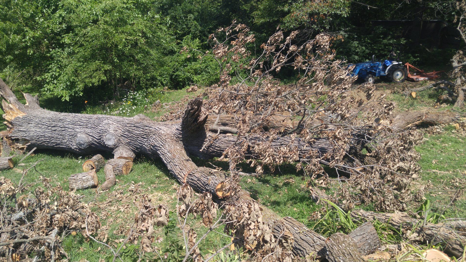

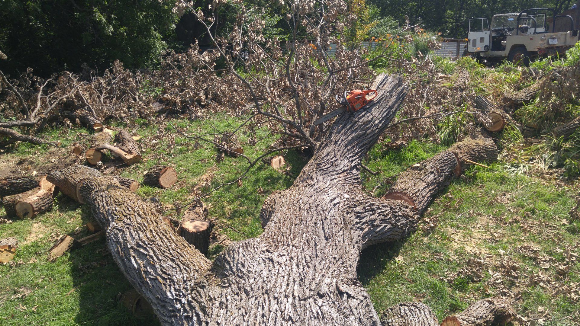

Yep, I'm in KS. I've done a good bit of cutting trails through the property. Cedars, osage, locust, some pines but nothing this big. Just in the last year 3 professional tree trimmers around here had serious accidents. 2 deaths and one guy lost an arm so I'm moving slow on this one.
Pretty well have it on the ground now.

Good job. You've got it on the run now. It's a LOT of work, believe me I know. You are a smart man to be cautious when tackling something larger than what you have done before. Very easy to get hurt when doing tree work. Even for pro's, just one miscalculation or moment of inattention can result in a life altering event.
Shame to lose a nice big Oak like that (root rot)?
Looks like you'll soon be up to the 'big stuff' (Forks and Main Trunk).
After you've cut up as close as you can to the main trunk (where it makes a fork) you are going to have a diameter that your bar won't span. And if I'm not mistaken the main trunk will still be slightly off the ground in places?
So...you'll need to decide what method you want to use to cut through it there. Obviously, you'll be coming in from both sides.
If it were me, at that point...I would stop cutting it from the direction you have been and go back to the root ball. Work it from the RB toward the fork. That way you'll get the trunk actually touching the ground quicker and are less likely to get a bar pinched. This is the part where you will want to use your wedges.
You 'can' work from the top of the log downward (from each side) and use wedges to keep the kerf open, but I'd just do a plunge cut about 1/2 way up from the bottom. Bore straight in the length of your bar and saw downward. Go to the other side, do the same thing (meeting your first cut). This will make the undercut without you ever having to saw upward (very tiring).
Then finish the cut by starting on top of the log BUT getting your wedges in the kerf as SOON as you can to prevent it from closing up as you finish sawing down to meet your undercut. Very important to keep your chain sharp at this stage of the game.
IF you decide to use a plunge/bore cut be absolutely CERTAIN that you begin the cut with the bar at an angle (using the bottom side of the radius) and roll it in only after the tip is no longer visible, then straighten it up and bore straight in. You don't want any kickback due to rolling your tip in too soon. It is a very handy technique to learn, but not one I recommend the average homeowner adopt. But you already have cutting experience I can see. Plenty of YouTube videos showing the technique I'm sure.
If you had a longer bar...we'd go another route, but you can Buck Up that trunk with what you have. DO be careful and rest when you get tired. That's when folks get hurt (get in a hurry or keep sawing when tired).
