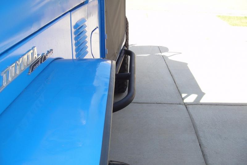

Rock Sliders added
4 tubes each side.

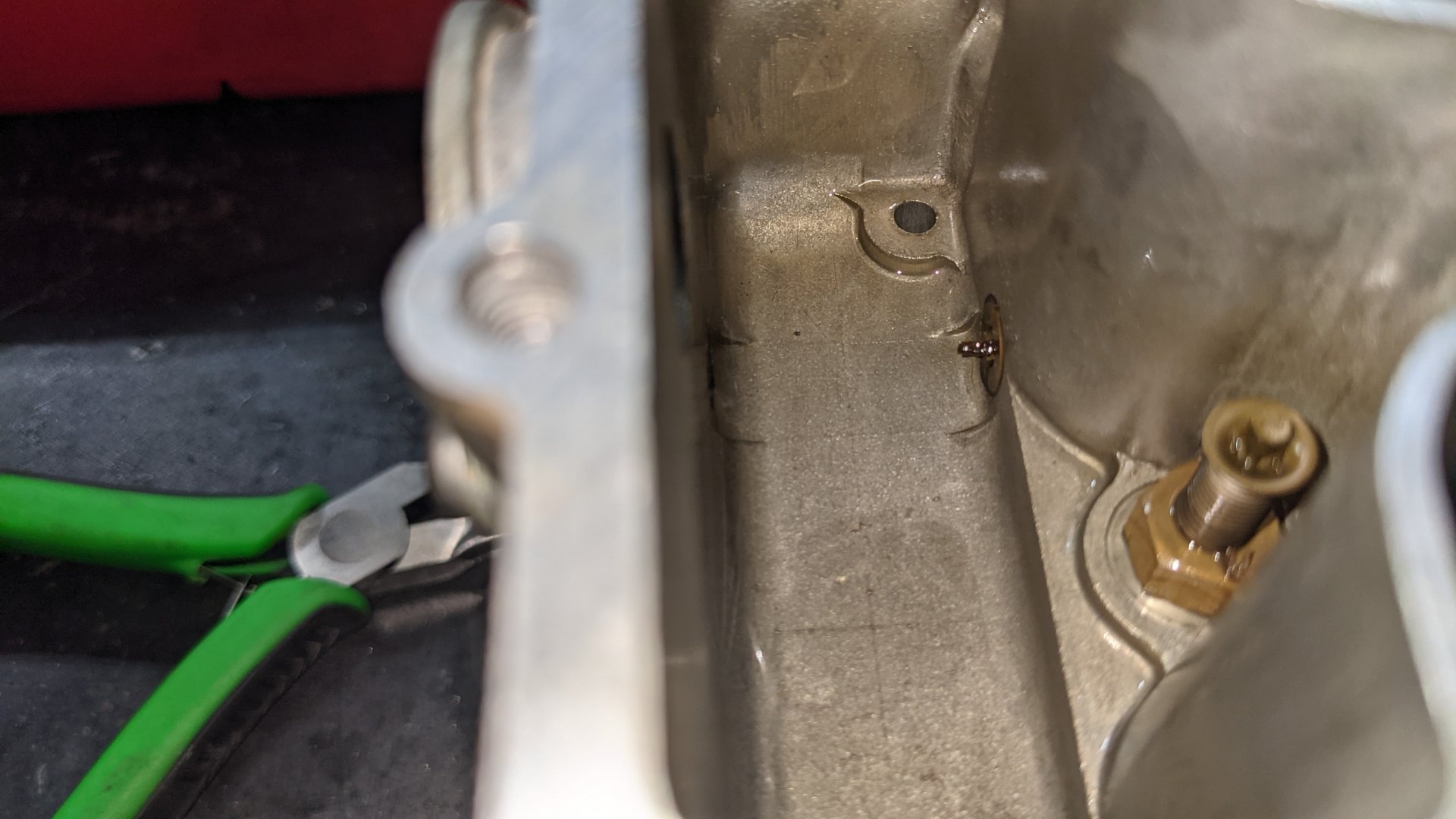

This week I got a lot done to get it running properly. The 40 has sat for the last 2 years so I knew there would be a few things that needed to happen to get it on the road. On attempting to start it I discovered that it turned over incredibly slow even with a new battery and once it started it wouldn't idle well and given any throttle it would fall on its face and die. Looking at the wiring I knew the main starter wire and all the grounds would need redone and looking over the carburetor I decided it was probably worth rebuilding since I could see a lot of buildup inside. So last Tuesday I started it's maintenance by rebuilding the carb (definitely debris inside), put on a new oem fuel pump since it had a weird electric pump with regulator, took the hardtop off put on the bikini top. In between work on Tuesday (work is building land cruisers all day at Overland Cruisers up here in Montana) I managed to get all that done. On Wednesday Polly and I went to dinner on our anniversary in it and even though it still barely turned over it started all Wednesday by itself. Yesterday I replaced the main starter wire, redid the terminals with milspec style clamps, redid the battery to frame ground and added a ground from block directly to battery. Turns over like a 2f should now and starts in less than 2 seconds. Drives fantastic but there is a miss in the higher RPM range that at some point I'll have to figure out. I also changed all the oil in the engine, trans, tcase and diffs just to baseline it and inspect the condition. Now to just drive it and enjoy it for a bit. At some point I'd like to add a radio and speakers but that will likely be a winter project.
