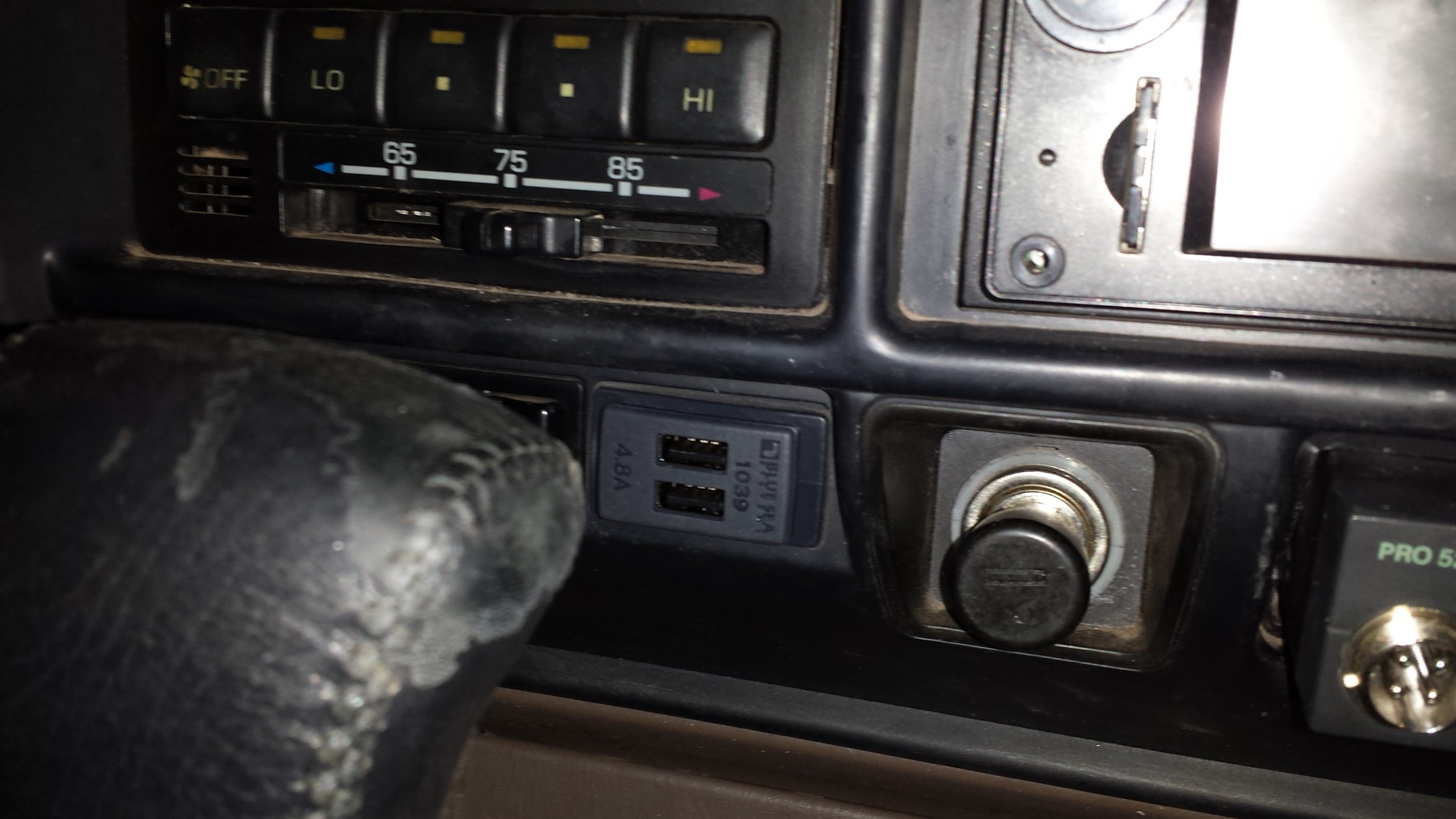

Finally a fast charge USB to fit an 80 series cut out
FYI - on my 97 you definitely had to trim to fit it in any of the knockouts.

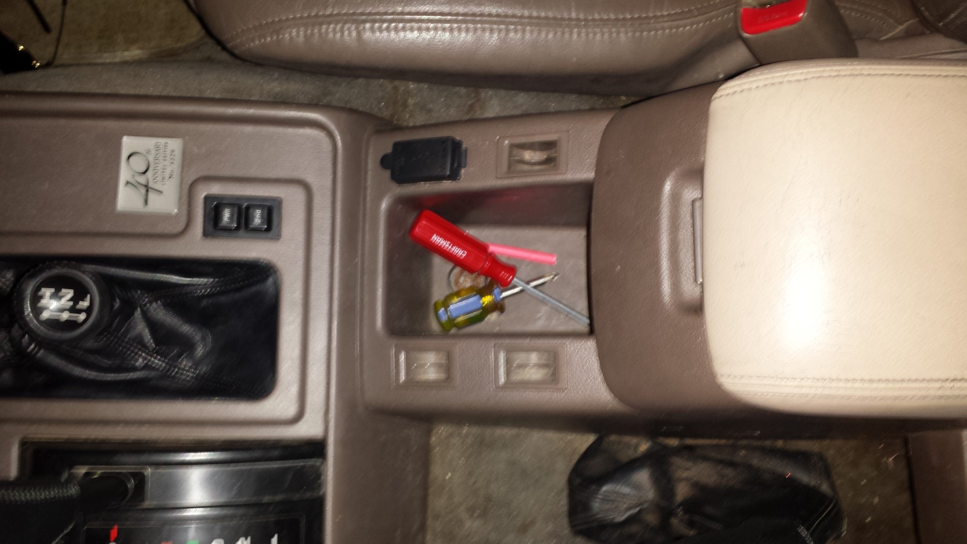

Got it all wired up and it works great but the dash knockout needed to be trimmed for width and the coin knockout needed to be trimmed for width and to make the material a little thinner on the ends so that the barbs would bite. Mine are ignition hot on a relay circuit so no parasitic draw when off. They work great.
Just to piggyback on what @hammerheadfistpunch said. I too got this to fit in the coin slots with minor modification. I had to file about 0.5-1.0mm on both sides of the cutout. In addition to this I filed about 1mm on the top and bottom from the lip of the charger.
Fits like a glove.
