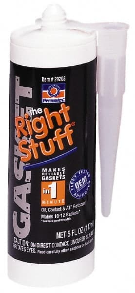

Nope.
5 Ounce Instant Gasket Maker 85635332 - MSC
Also available at your local parts store.
Ordered.

So the Permatex is the way to go on the axle house vs the gasket?
Axle Housing Gasket - Toyota (42181-60070) ??
I used the toyota gasket when we fixed his rig, still using some FIPG to ensure a good seal. However, I think the point is if you don't have the gasket from toyota, this is the stuff to use.
I am getting ready to do the Volvo axles on FOO, and this is the route I will go.
Let me back up.... on both Josh's rig and the Volvo, I welded 1/2 steel plate to the bottom for armor, so I assume that the heat tweaked the flange, so the stock gasket alone needs some sealant to account any varience.
Its common for these to leak. Used the Gasket & sealant still leaked on my stock axle, each time it was leaking the nuts were lose. Titan the nuts to speck, recheck after a few hundred miles. I now check these when I'm checking the Knuckle bolts before each wheeling trip.
