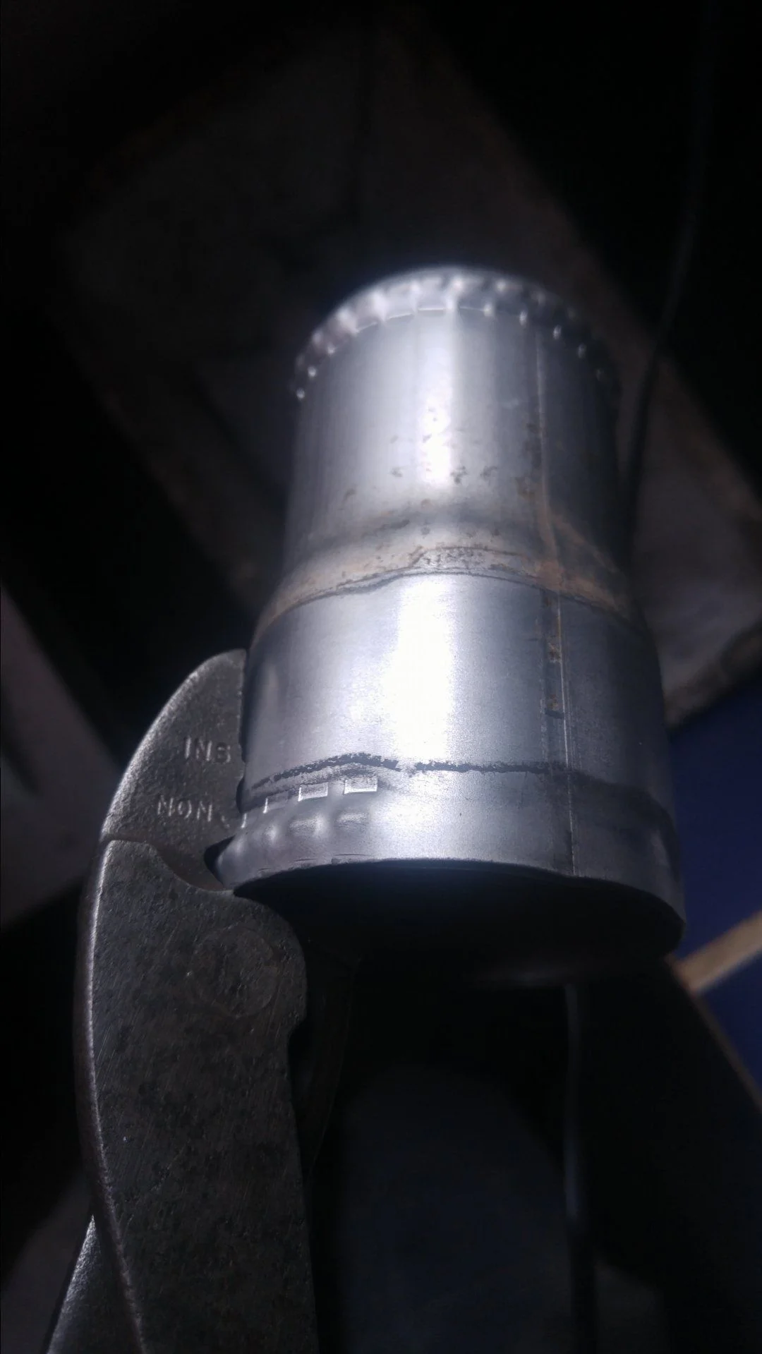

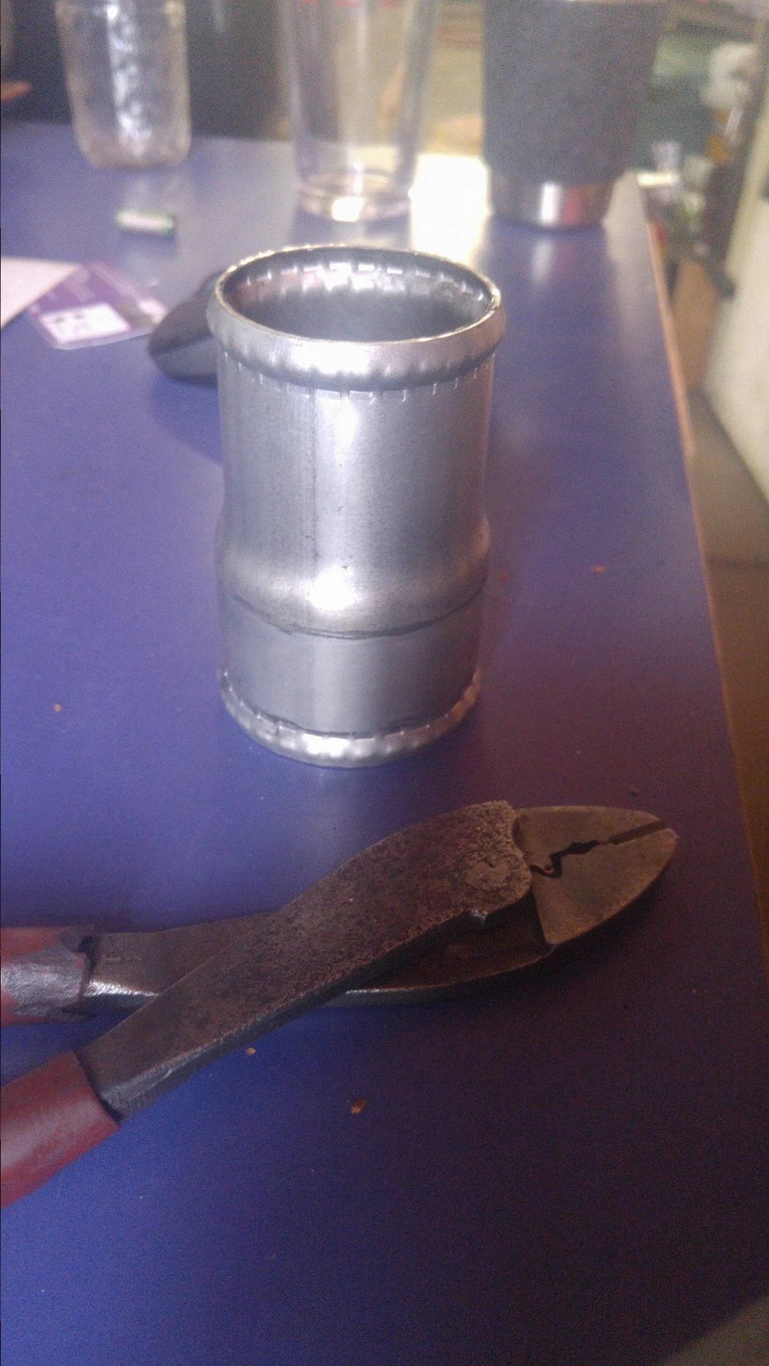

Driving to the shop two days after reading this I lost a boost hose. Limped to the shop, yanked out the offending exhaust adapter and got to crimping.
Worked just fine with exhaust tubing, and I did not cut up my tool, just used it like it is.
