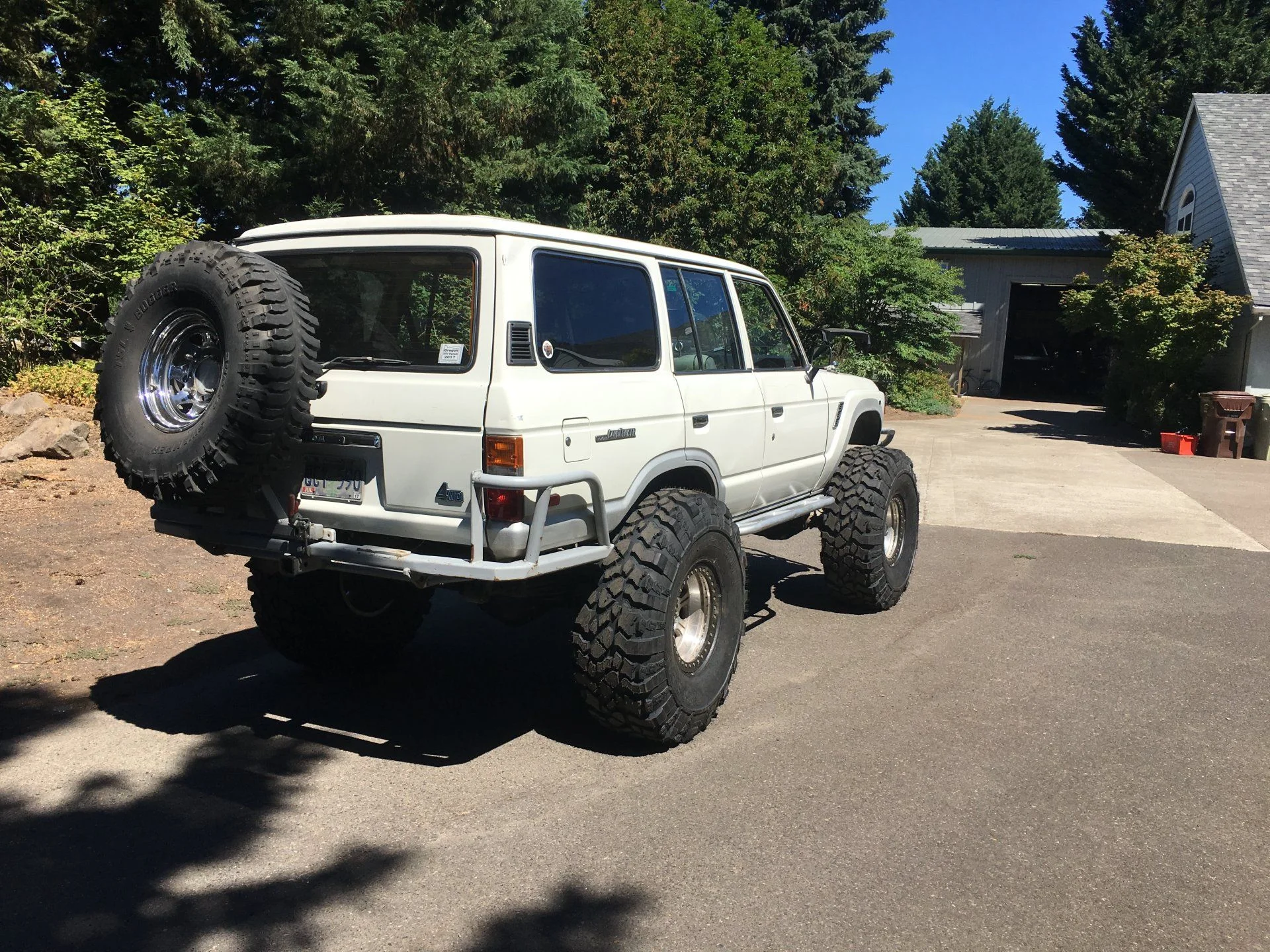

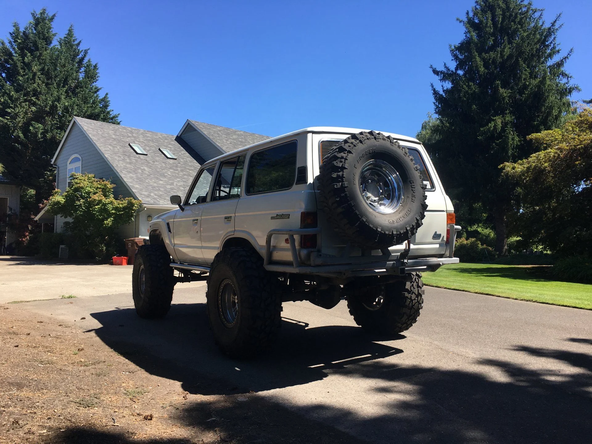

We put one on the back first because I figured that would be my tightest constraint and when it fit Zach said that there wasn't any other option but to put them all on. Here are the pics from that shoe fitting.
Bz0mYnXG-kXoZxEEM62XzI_zPJPbPz-pgrkvtczEZJ3O50nGmImdlqvrN-h5wm3XGfegAQnQGhnFzJDhIkJhfTpB4HlxkWzTPhyGl9X6f5StR0nGM7kBpu6hJ6kfhPm4gms_e4Ji2PXLdEmo0yeVn_hkSqfvpgSQvxycdxDTKfkWtC3y69oDHJLJbzE_4flYokDFWhqey7vuvOnfVRI5xdno6KVsxrmMv30wzDXang0dJeQq4X0lN1dT1RIzfLl06Uddq5jrIsDf-ukw-JPQFhz_oTItp_OkW4Hr36zDR6ARd3dzh_2xNK8Zb_fyxJ1oXTZU563PokZWdEpdzuYIVOFFjgSIauHwT6HT0ZBge_PVfJCQFNR7zYalIaPxPM8dqvOKyu9PAn2slOyfKBP6We5PV7d_zi6ec-cBmaYneRic5O4gBCyf8WEnxbvT3bxnH_sipj4luK2DfkutN6sWBawldPPn6LJx4yRIOXgjZvtyfXNsxU1d5An7GXqmkEBEVU3W5qaQ69L21xvUT0JpnRH2R70tw9ZLBC4Xxc67B0rvLyjjfTnPTti8B7A1FbTVBUjZGmwawH4VAB0t4oq-7e8OM-R5tt2Llg61TD8nVNQ51cwfEGFXJ4IpuP3Czg61TxEZDCj1pgLSkJ2py2f46tpPRET0yRw0k-aIZfTsC8NmSw=w1389-h781-no
At ride height rear.
igET5-jVqZDHdWMDojeNiDTY3K0Ojs4kAj7IKrpgWZ1HDYv5RwyQ8pmLRzPTOHOMQbQLhlR_F91XgED9O8rs2r__N6_PnubiuYP3KkiwDHKOc1IgC3fy5AXEuQahT3V4Ppc2kbqN4tBIW0_JqU7MhkOUmTq4I3YmIxA8l-YLti_awNXmnVs3KbXTbbkfb0kicHxrNu6TrNu-9OhCQyYBCZjfKmdFQ-i-tKU8ekb_SDiGuMkGXFX_jAAqvzcknANQBbi1K-g9dbC6Na65kuAhhJ1Nyo9HTpVG3bZfb4erO35zhVuswi15XmXH7rhLMk5LItLTCdMpFfignsW7YRQZAr5Alg6-aKON44wWdTCdC4Rr7y1BnyO6YAIGrvBl4f9NWHoiX73y29iDILRaCCrvrpvYTKK_ZV8ocQNoFjgdmxOCwvcQinlXkERuoEp_lKX661NeaPHy5xXVlzopZfxZLuK4hC7OiovU3qJkOce3ITpnsmk-HLHmI2ryArayRzEG4jqgZqM12_WQYvksa-e5eBtjHNqxLV4HAhXcuednj6E14eMD1XarjYQ-eoRA-KdHmEsXuoERi4ho-ypzWR3Jp5fNdGclf9tZ09mtM0gdoapVyspVm4BMxekvD3QViWAjvDgEpvHLOjE9kLPROKw2cNDvZhI1AO0fCuHoILLGUGfcWQ=w1389-h781-no
At ride height front.
7KQJy1nvAsJsrGlGwx0GXu428hbM06XyJUO8LRWiNri-sMYBoroIZ5bTkwQ20hrgkcFOpg1ypY0aO8rncJqwp1Ezr5oqCCUTBchdfTQZhNTbN8MN726COJ-oC09PH9QzNMSpKW5VePr5HjHCKhW7tE3NnTgAOT70Pgo3eKBIaEOdDUbor4cMKTtdZeIvGY7QoloiAJeC46diW69W5CN1v27OvH9KCrAicT4uUJO1945tlhX_TAsblRZ-_4T_Oq6gBQYBpzzBAykr8Xfn2yQD9_DVSZX6_RJlAdOP5u-r91EdecI8T_OiT-IZ4KFVBXTETlLqLU9SiUH17wWUoVVuzqsij9rWZAXNmanR6xYDDdwSQ2F5d9QxIGuKUPkDQO1CqSs2MWdZbSzu4cdmnI6_ZTBYO9FWtQ2jzGad95i3Xx5GLlQMVSCpAdlp3jx6jjXd3Ffj8ys_aJ7MohMik4P5cANZisZCmAROKuRetVARHTGHcwKVuyQltW_tEOBncLoevEh335MwwNs_iOK9NywX0ztP7827TKSRg2j5M3wzOLVIJ1xmtmGy5WFc4Ft4wbVvyRna7paoSkFIRHrylboB9oVE0X6_nHw2y_rHhkhyahVc3MEqlQmlMsfsT_j32xcdqetiHSjWE4kLn8Dh68jFiRxQYk7eTj5kCqez1aWZFwTOqQ=w1389-h781-no
Zach's rims are not as backspaced as my H2 rims are so they stick out a little more.
fnjcMWgsjJhE-_rxSyW1HCreoJtV3-xBOzcapx13mGilNRxhGnJkKXj4SQQEPiygJiHxi_hw0GuHbq9FMToJFllEXy6aAlOVw9RWXjt0_19AXqv30Zbf5FMEHkv15dIX30ZSU9Vg1mSuqyUvQ7yF0xb2tYkctM_69xf2XCVYj4wx-pz6UiuB0VRIzXvpfFVITWhwMdw_oTOWH4cYUS916RFdd954WDmh44OCfCLR9vhuwOw9kpqLn2Ut6iAvk5Upvr9Ls5lpilBBdi0LMdHmGlPJkVyYCSPYnfCaTHxcFb4jGwMevMW5KL-WPqZPM_P8faqxP881m4FWt2jWPYlqG87TpFQVC1uHEC288IhUvgv4BM7kGqFFbyKT5B2XiNON69HVXD-GkmnvuzdEEtaa_mNpCfInhGdDtdP20aBiURNQQJtb6hdSXEI236lOdPqsWzMweBkQEsTTOFMbzh5ILHO0-ajtsyAq4Xa1rRWBFZDryyVjArCb2jedQ94uWvNr60AFtYSNbLVURXClIjyz0P6sA9aEnnUuusAW7Xvw9oAlRNVV_k4AoYgBYxgaEpDMT8K1alJAcu1xJ9NHZvC-kDVuprz_9lVI1lW9d-K_x4saN1-y5cgxFskwLvvo4ALoi1wFaJvF1LTecUkS1O7oNjPbK9Rv38COddFV5OAk6yRErA=w1389-h781-no
