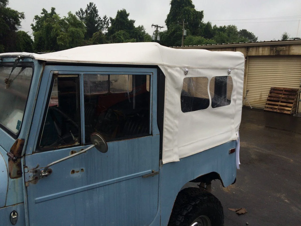

A related question is the original style of side windows on the soft top. FST pictures in both the booklet and the Manual mentioned above show a single plastic roll-up window on each side. Reproduction tops I see available today have two plastic windows on each side. Either will work fine for me, but can someone with an original soft top confirm if they used single or dual side windows?

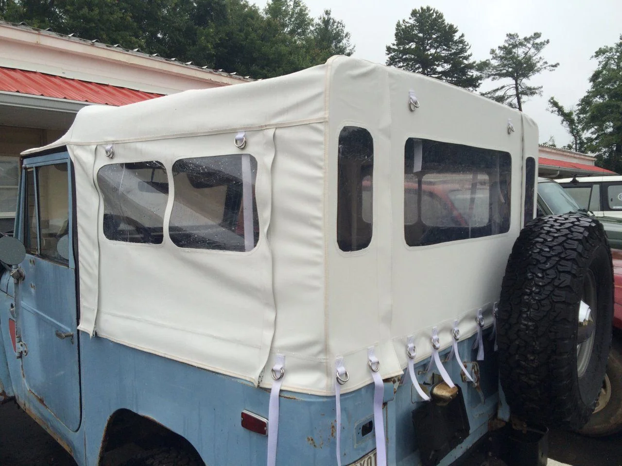

That was my top, a factory oem top from the early 70's. It was vinyl, but the inside was canvas and heavy. The oem tops were very well made and durable. I have had several repro tops and the oem weighed double. Have also had dozens of doors, and all have had the same vinyl covers.
USA would definitely had been vinyl ... And in white
The tan you have was an early kayline replacement vinyl ... The vinyl is on a heavy black denim on the inside... Just like oem vinyl
canvas was used in other markets
Toyota calls them tarpaulin as opposed to hard top and you will see listed everywhere canvas doors ... As generically just soft top doors

Vinyl. Perfect. Gives me a reason to stop canvas production. Which has already begun on the black canvas. From now on I'll only make canvas tops as a special order. They fade, and shrink and require way too much maintenance. Pvc is the way to go.
unfortunately the rip is most likely due to brittleness of the original vinyl because it went so long without care... the old toyota stuff since being on a heavy backing would also shrink become brittle and deteriorate
modern pvc materials and synthetics are so much better than the ol' canvas and vinyls used then.
you could try to save them... but... it will most likely not match the clean top you put on. They are not all that hard to recover. but... if you chose to save them... take a piece of black denim and silicone it to the inside or use Bish's tear mender... then paint the white on the outside ... making your own layer to the outside this way you can control the color and have it blend better as well.
