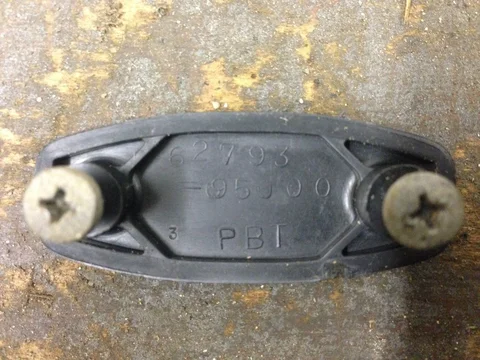

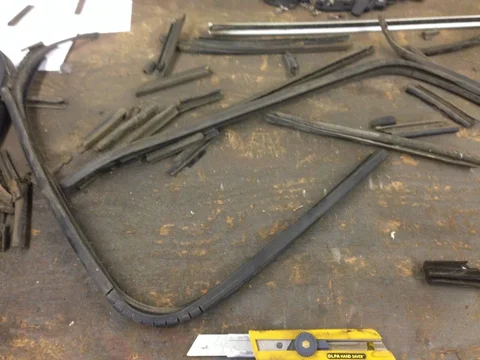

Well, I got my used sliding windows. Pretty much unable to be used. The inner window rubber felts/guides are garbage.
Completely deteriorated,. Disappointing, as I asked before I bought them if they could be installed and used. Two of the latches are broken, parts
missing, not sure I can get them, I was told in perfect working order. So pretty unhappy with this purchase so far.
I took the inner guides out in bits and pieces. The frames are okay, going to sand down and repaint of course. I will now try to find the parts
as listed on Toyodiy. The pic of the latch is the piece that goes through the glass to secure the latch and it flush to the outside.
