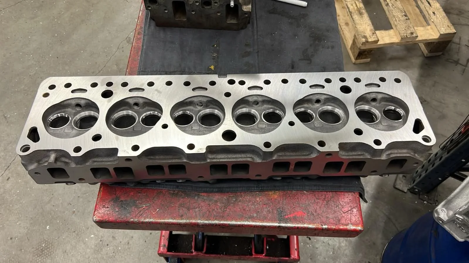

Just out of curiosity: Where could I get a cylinder head like this one (60051)?
And how much would such a head cost approximately?
I think you can forget about finding one in Germany...
Good question. Mine came with the truck. The previous owner made this swap. But if you can find an F engine from 1974. Here in the U.S., they occasionally show up on the market place.

I've been thinking about taking my cylinder head (61030) to an engine specialist to have it ground down by 2 mm.
That way I can go from 16 mm on my cylinder head to the 14 mm on the 60051 head.
Theoretically, that should be doable, right? What do you think? 🤔🤔

Be careful that in Europe we didn't get dome piston as far as I know (at least not on the F.5 in 1974). So mixing a US head with an Europe block you would need to be very careful you have matching chamber/piston style.
I think Dunkane on this forum, which is in France, found an original F135 for his 40 so will probably be selling at some point the F155 F.5 that is inside currently... but it's fully working F.5, not just a head.

In theory, it should work, but read more before trying it. I believe some people have already done it here, though. Don’t take my word for it.
