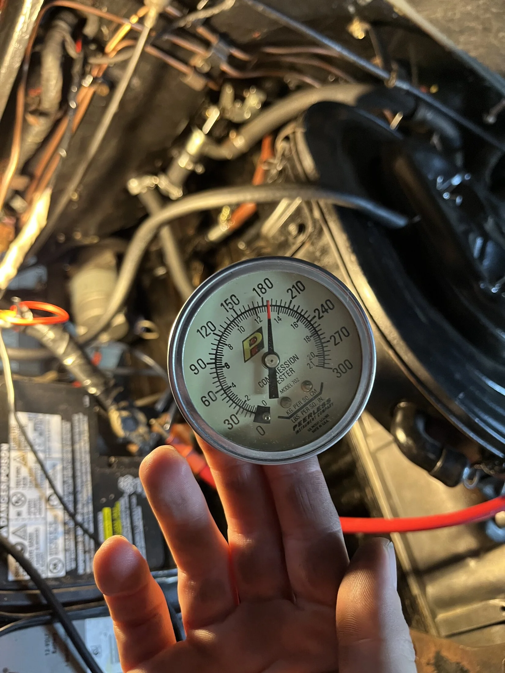

This time, I checked the compression correctly (dry).
1: 180, 2: 180, 3: 185, 4: 185, 5: 180, 6: 185

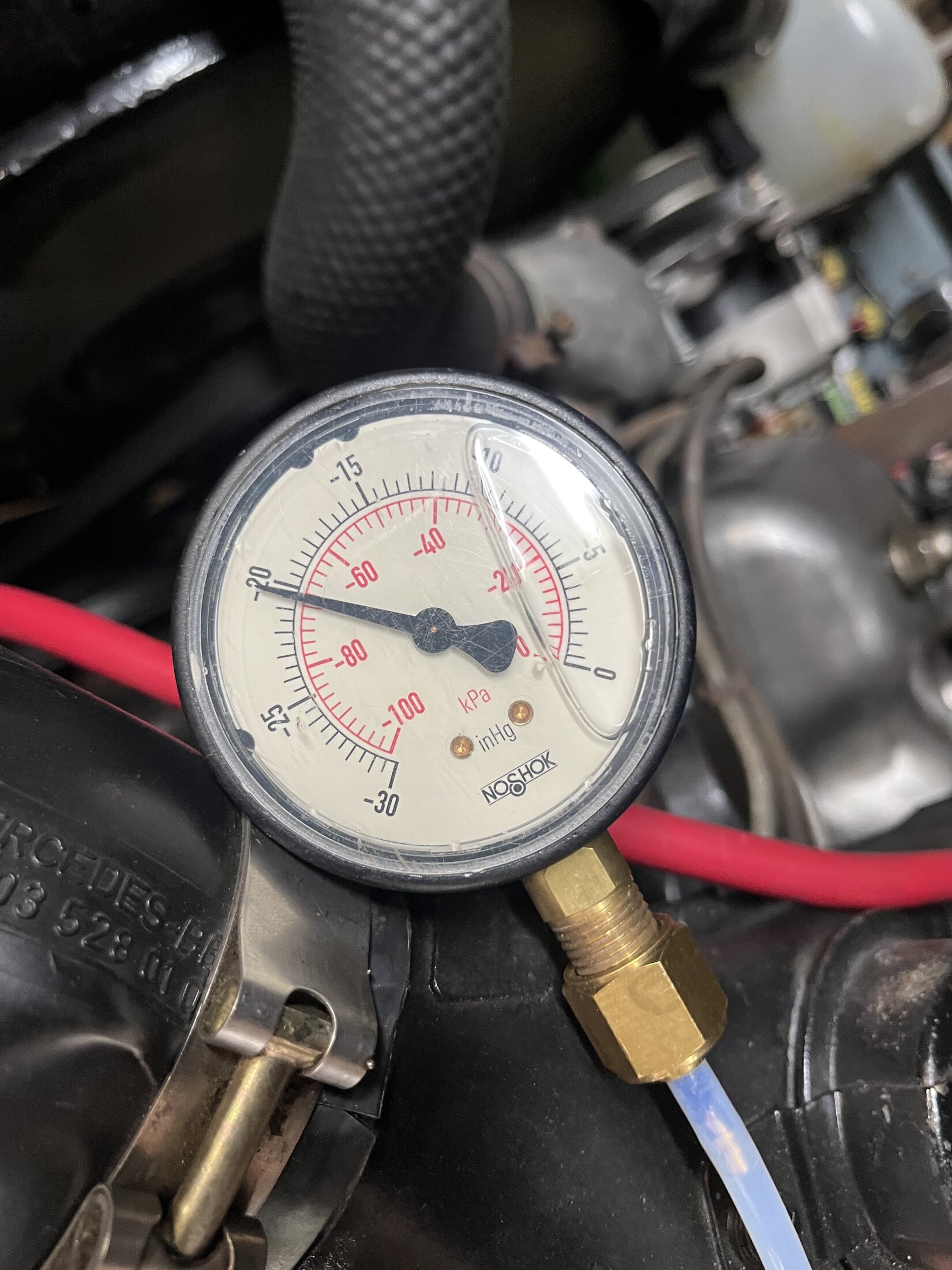

idle vacuum -20 inHg (at 650-660rpm) timing set at 11 degrees BTDC
really good numbers, when last i checked I was in the 135-140 range and like 16-17 on vacuum

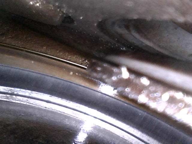

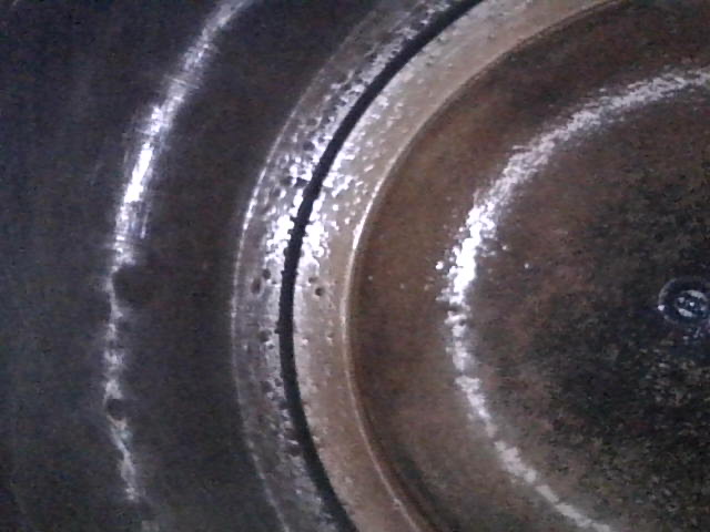

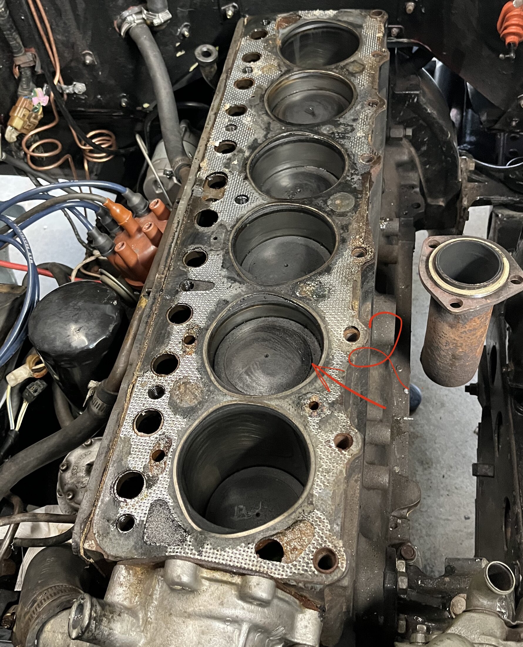

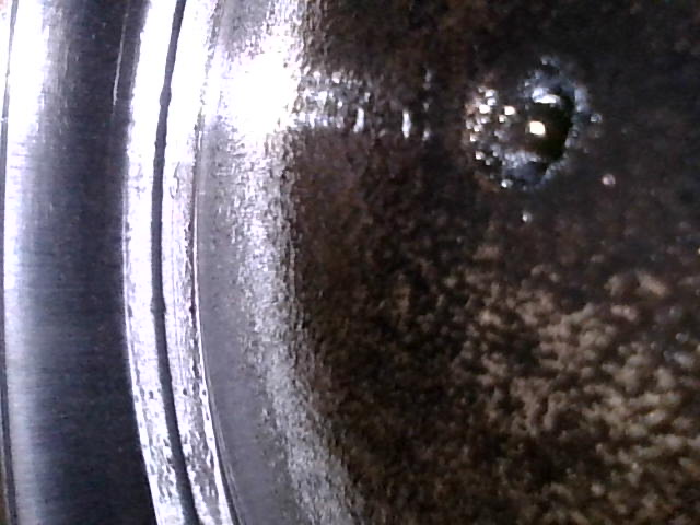

This is how the pistons looked before I swapped the head — about 300–400 miles ago.
I cleaned and installed a rebuilt head from a '74.
I didn't touch the block, only cleaned and put a new gasket.
Is it just me, or does the second piston look a bit greasy and oily? If so, it is more likely the ring issue.
MMO might free up sticky rings - could take several treatments - maybe thin some with acetone to help it penetrate. Soak for a day or two then go burn it out, soak R/R Cheap, likely not to cause damage.
Broken or worn out ring(s), damaged piston/bore... you can't fix that so easily or sadly cheap. The longer you wait the more damage you can cause.

Compression increased from 180 to 190
