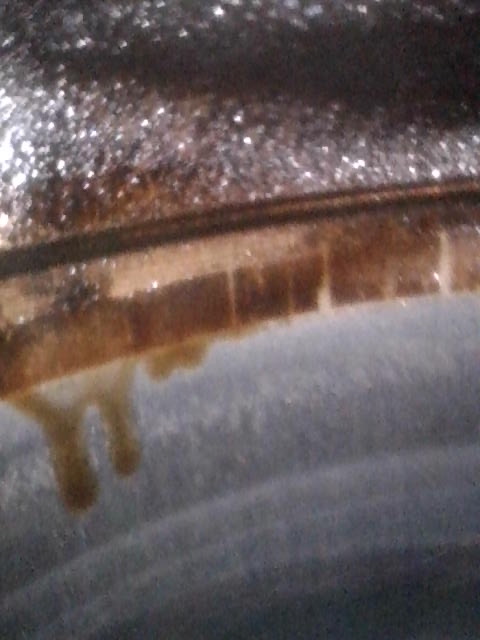

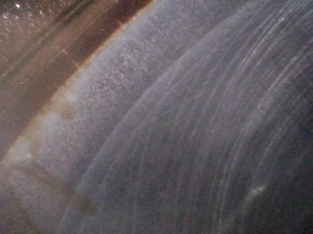

Finally, locate the source of the oil. This was in a cold engine. I will replace the valve stem seals in this cylinder.

Great work isolating and finding your issue.Finally, locate the source of the oil. This was in a cold engine. I will replace the valve stem seals in this cylinder.
View attachment 3949521View attachment 3949522

That is great news. Did it actually fix the oil issue, or just reduce it?Finally, locate the source of the oil. This was in a cold engine. I will replace the valve stem seals in this cylinder.

I checked it twice after fixing it, and it looks good. It is running, and there is no issue. I don't want to look inside anymoreThat is great news. Did it actually fix the oil issue, or just reduce it?
