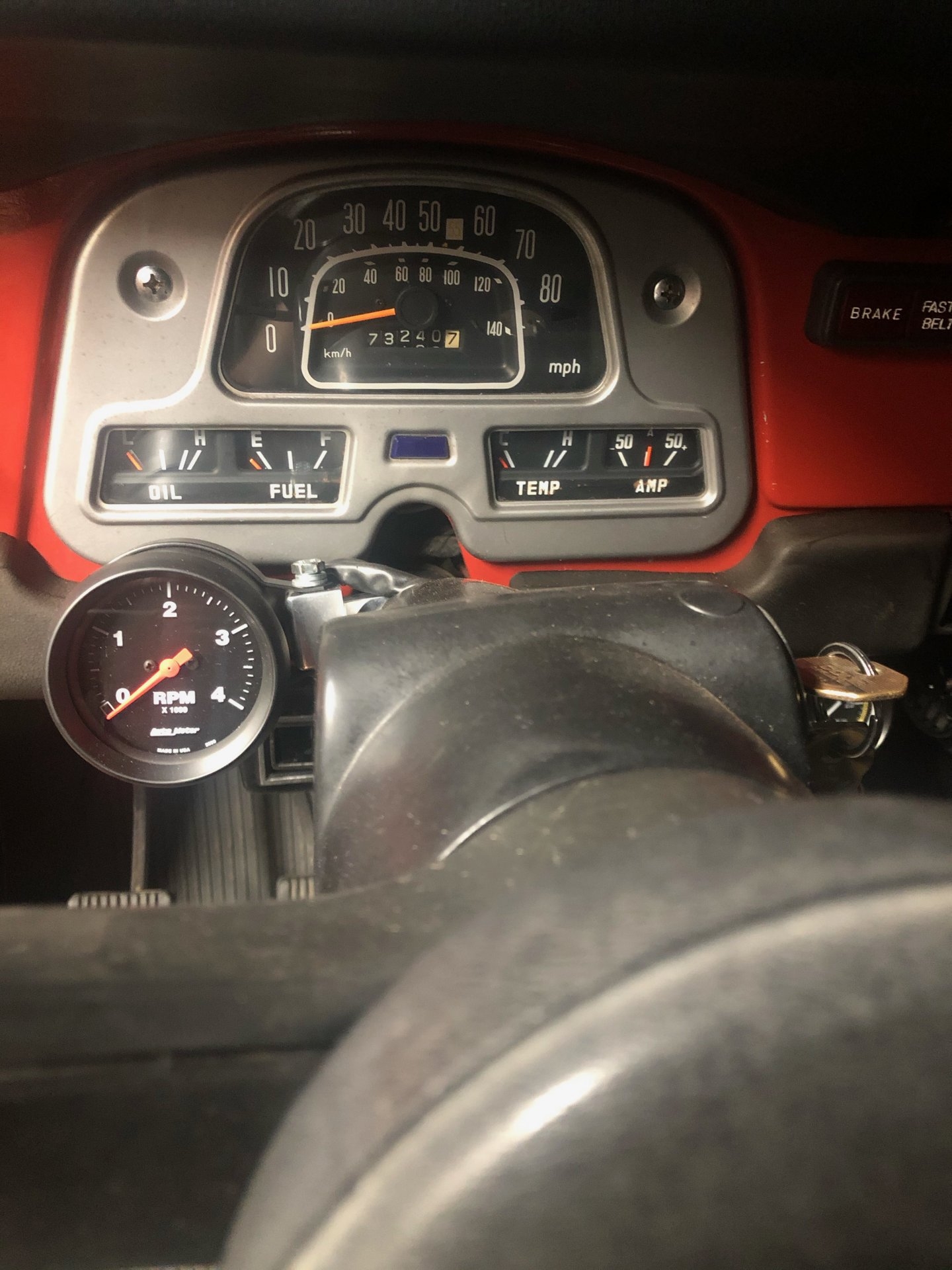

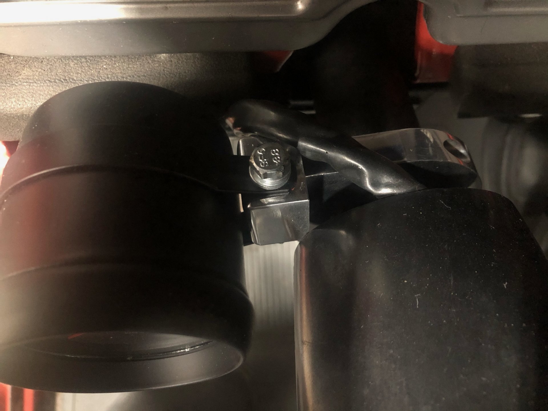

I just mounted the autometer tach listed above. Install was easy. I used this billet mount to put it on the steering column (1.5”) - I was going to cut the dash but decided against it. @Mopdog has a nice kit if you’re looking for an oem look. Will post a picture later.

Those are top notch for sure. But those require a hole to be cut in the dash, which some are reluctant to do. Having an option of a column mount would be great.
