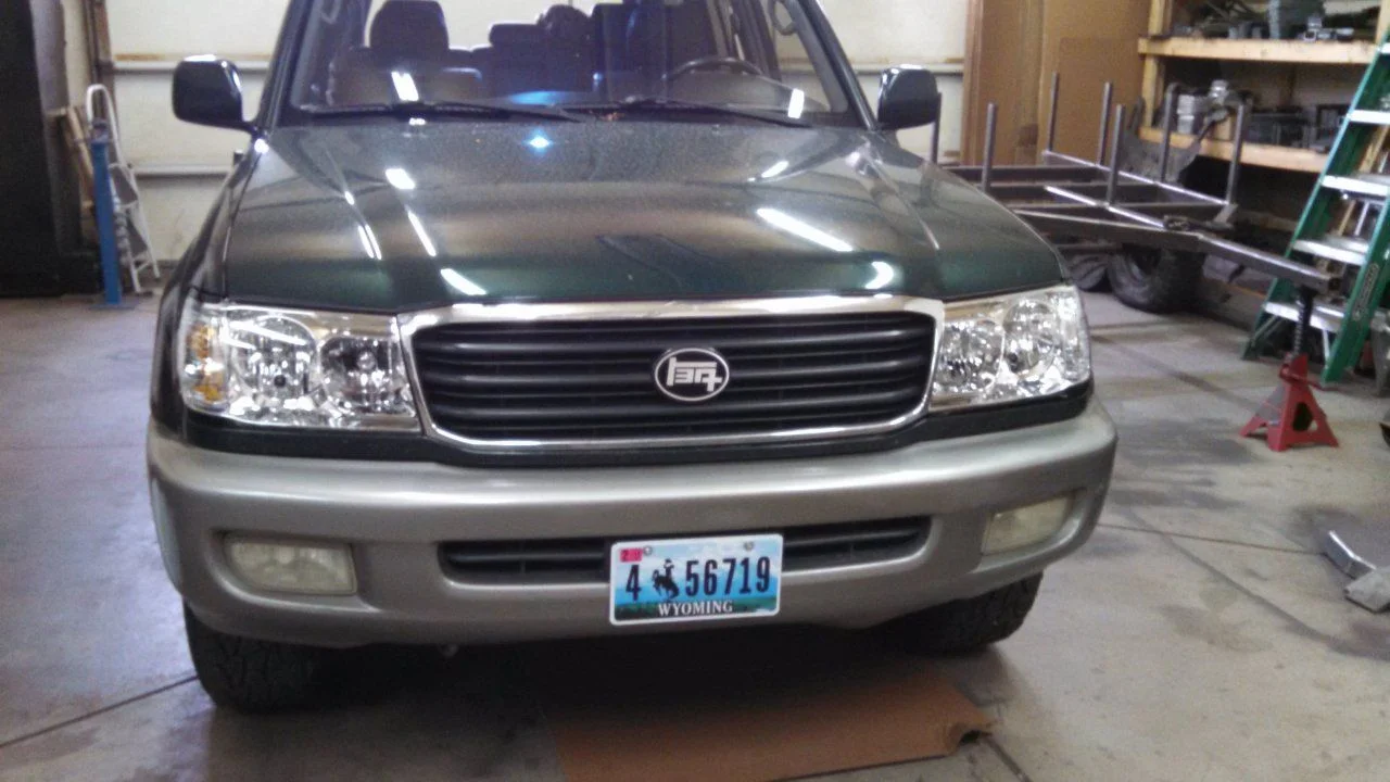

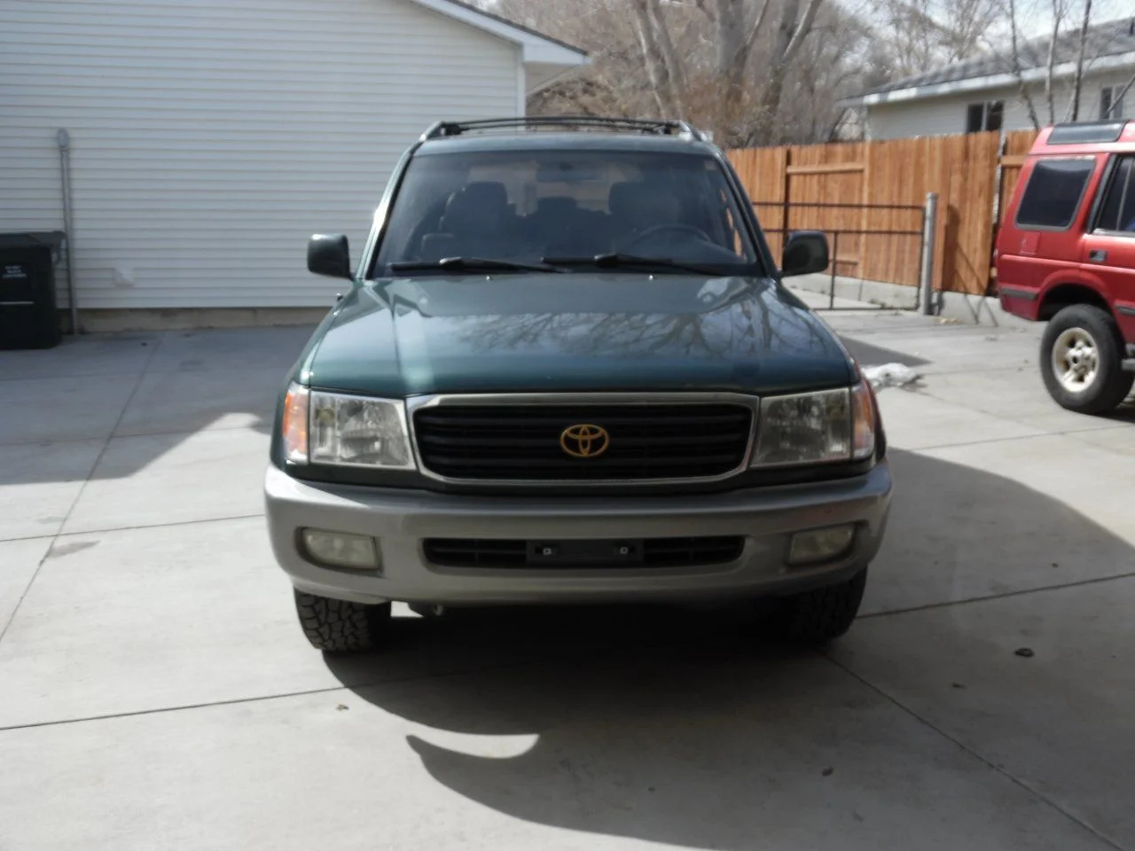

Swapped out the headlights with the one piece Depo lights.
J
Before
After
Looks good
Great looking 100! Looking forward to watching your build. Can you tell me about the headlights? Where to get them and how much?

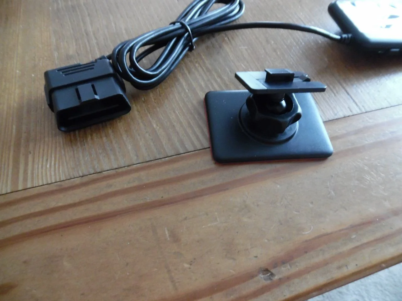

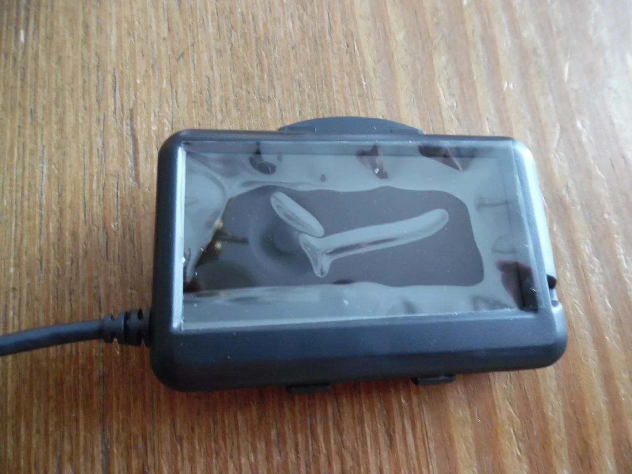

^ will the UltraGauge grab the tranny temp?
Dan it is my understanding that the "MX" model reads Trans Temp. I know a few of the FJC, Tacoma and Rover guys that bought it specifically for the Trans Temp feature.
Shows below that it does. I will play with mine once the rig gets back from the dealer.
Ultragauge

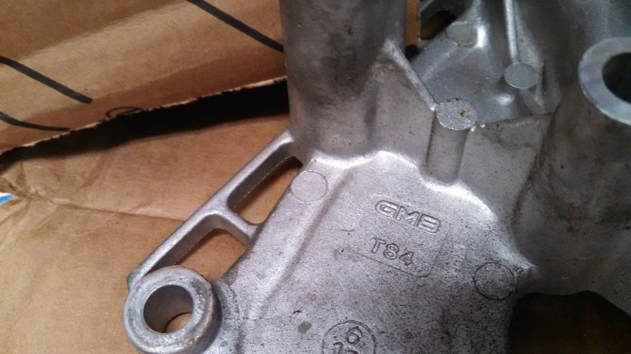

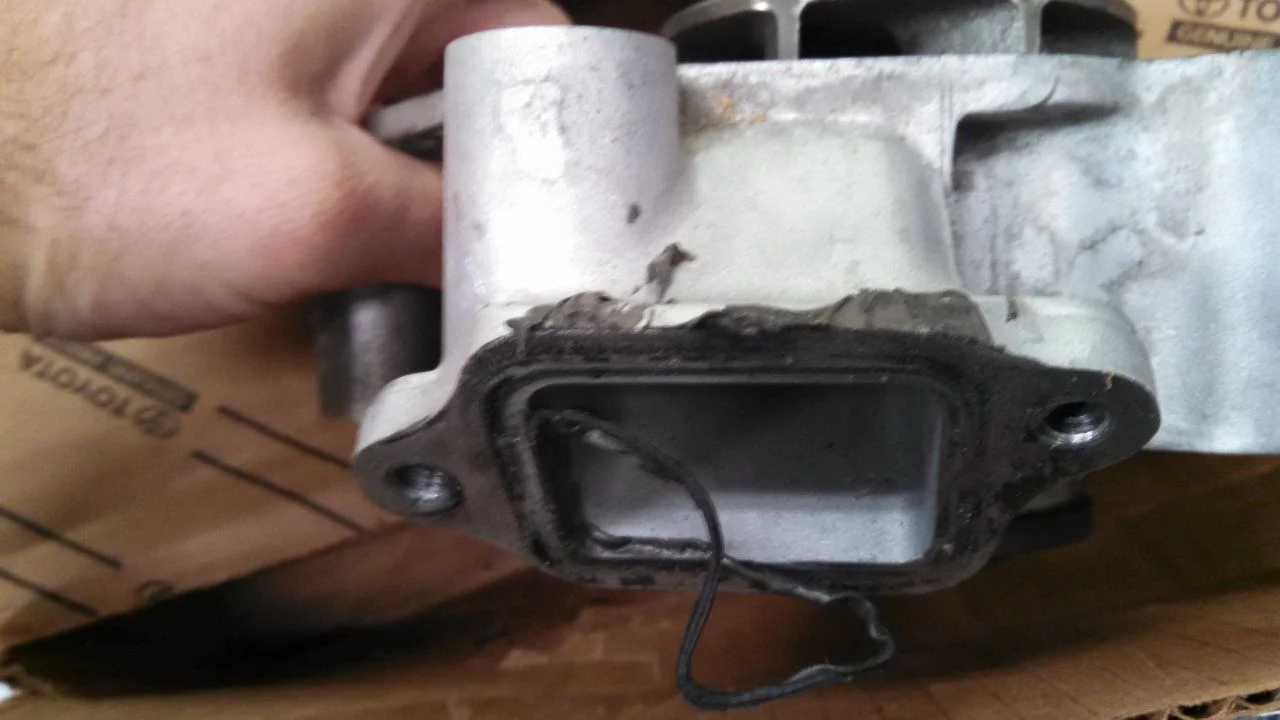

My buddy called from Toyota. The water pump, belt and idler are all new. The water pump bolts were loose and the gasket was torn in two. It was an aftermarket pump not OEM. A new OEM pump was previously ordered, so that will go on and Esme will be headed home soon!
Just shoddy labor from the previous shop.
J
I dont understand how people can go aftermarket on key items like wp/tb... Smh. Glad you got it figured out though.
Picked up Esme from Toyota this morning. $436 for new OEM water pump and labor. Perfectly fine with this expense.
The GMB pump was new but poorly installed with a ton of black silicone. Looks like the previous shop knew they tore the gaskets and instead of getting new ones in they just siliconed things... Also, loose bolts.
Shaft seal was already leaking.
