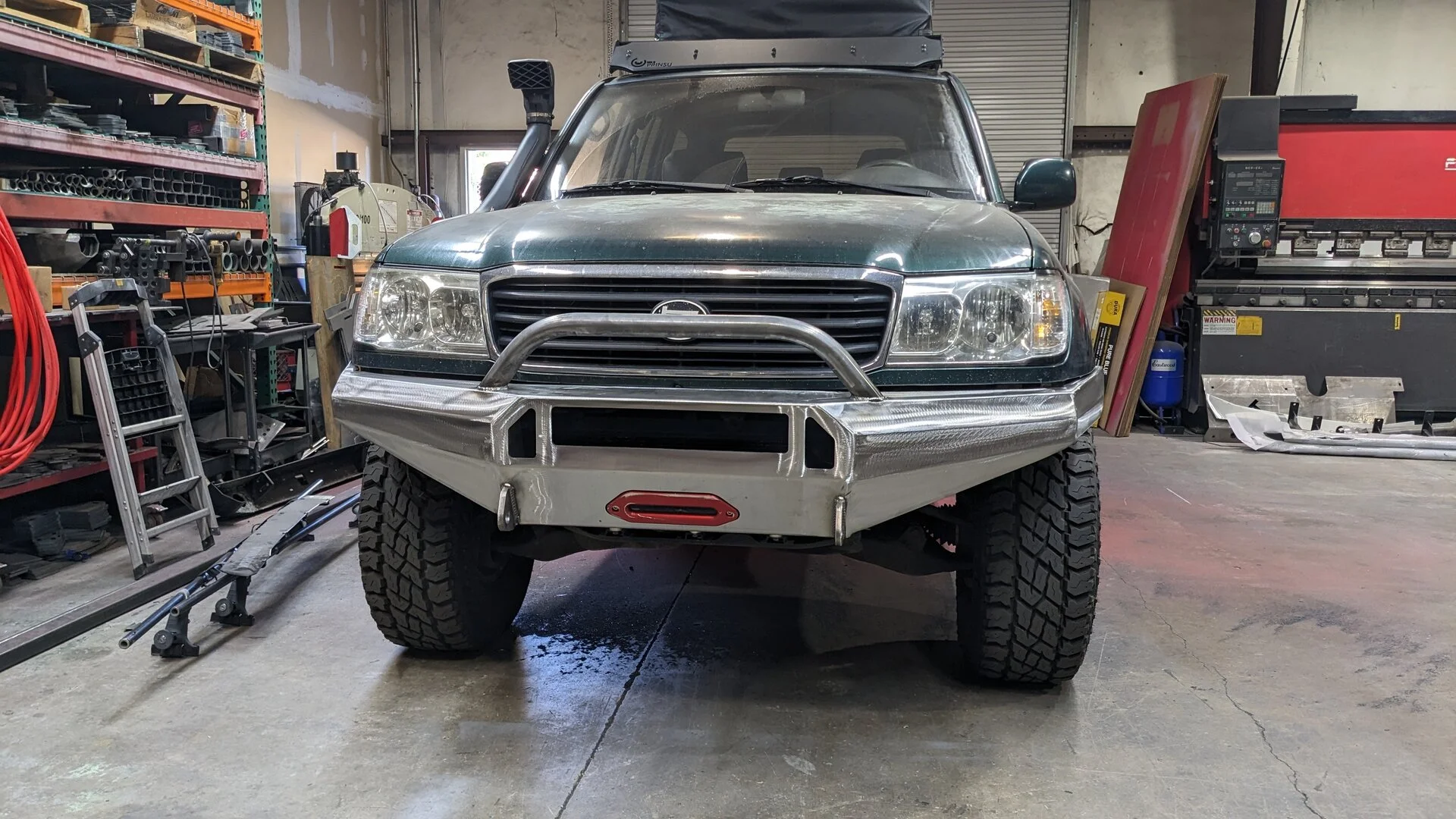

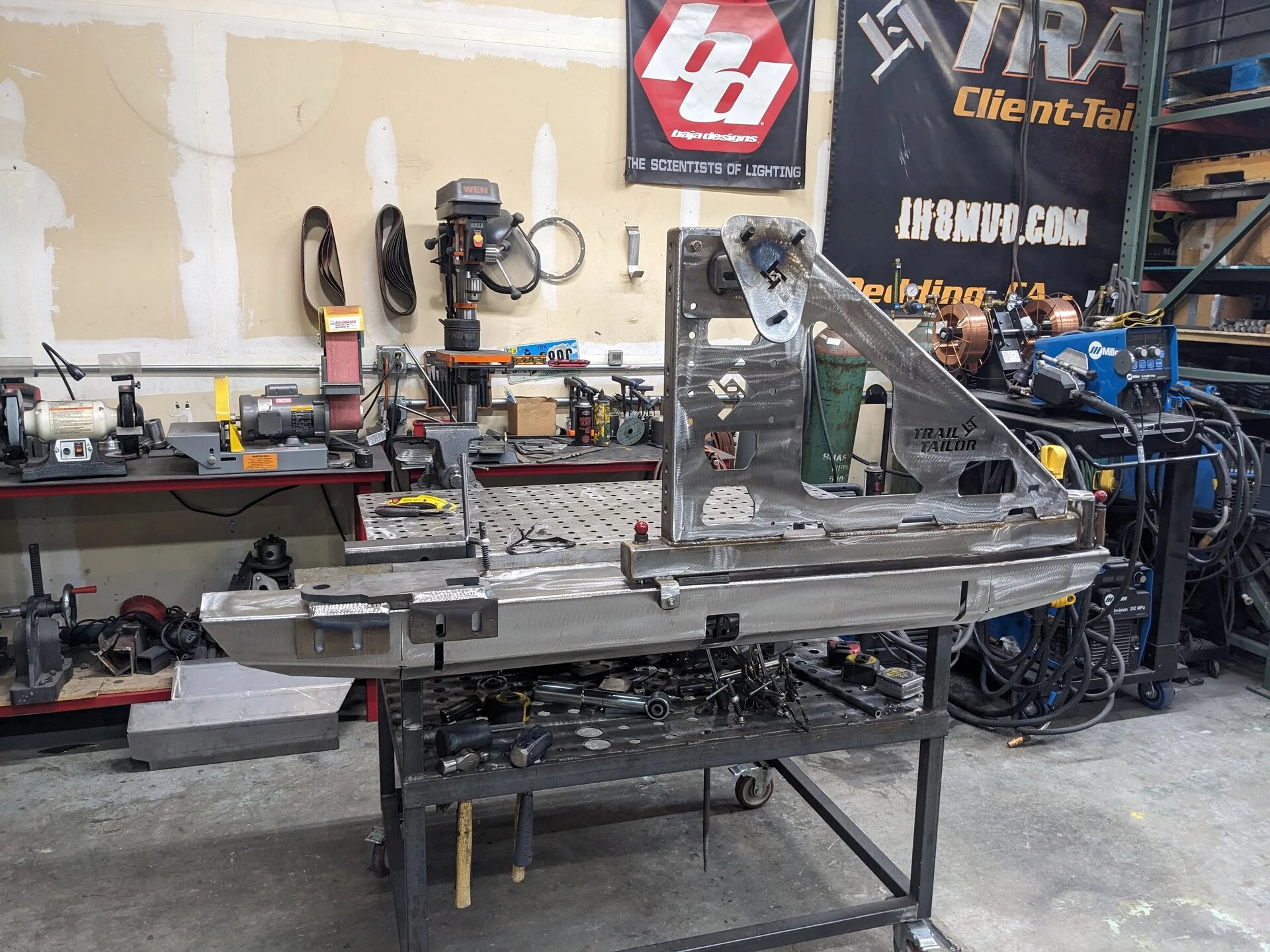

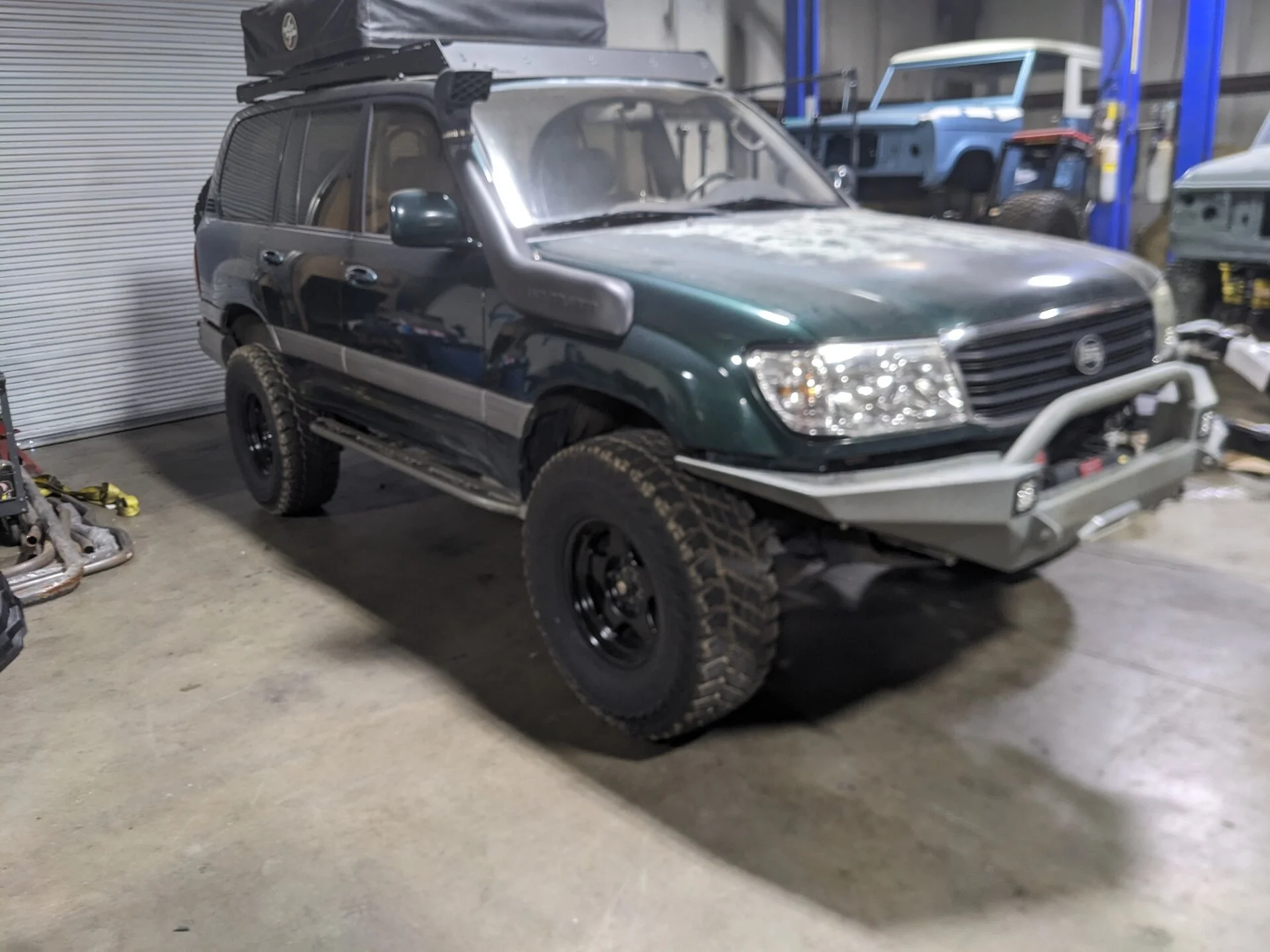

I will be making new bumpers and sliders for ESME. The ones on her currently are in great shape. Just need a powder coat refresh. No dents or gashes.
It will take me about 3-4 weeks to make the new ones and ship these out.
All parts- sand blasted to bare metal - Front bumper w/baja design squadron pro LEDS, rear bumper with dual arms and sliders - 4000.00 shipped to the lower 48.
Can see bumpers and sliders in this thread. PM me if interested. No interest at the moment of separating package.

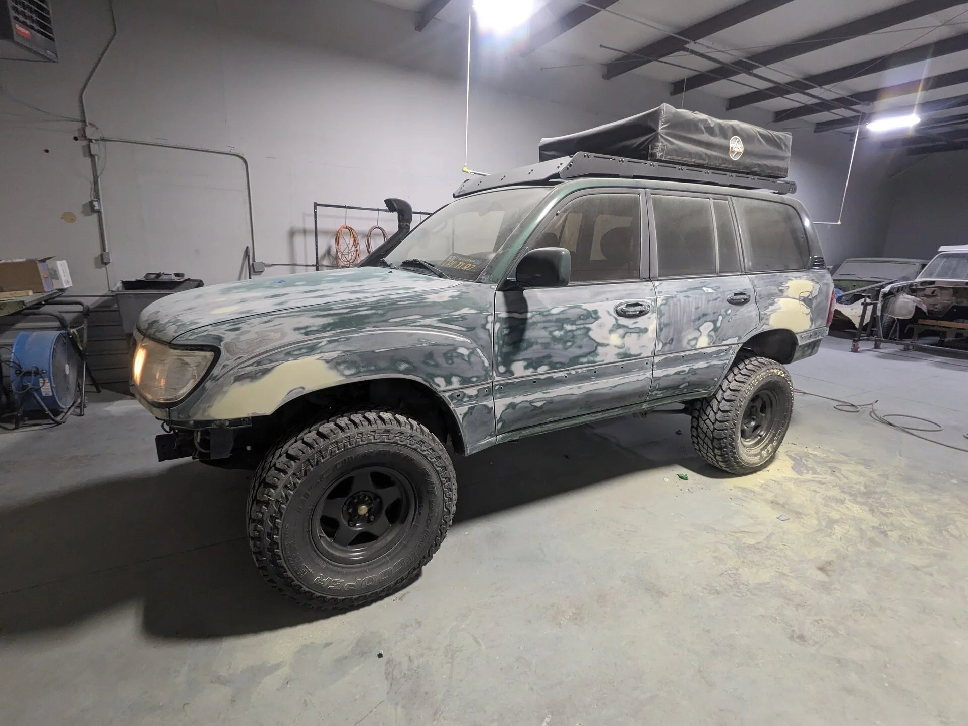

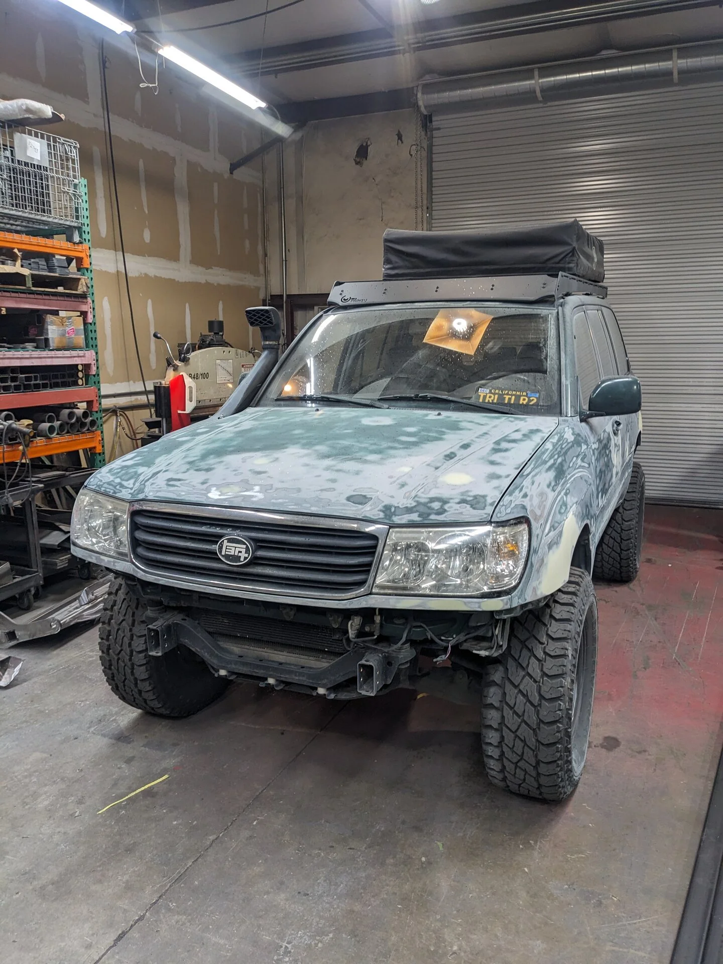

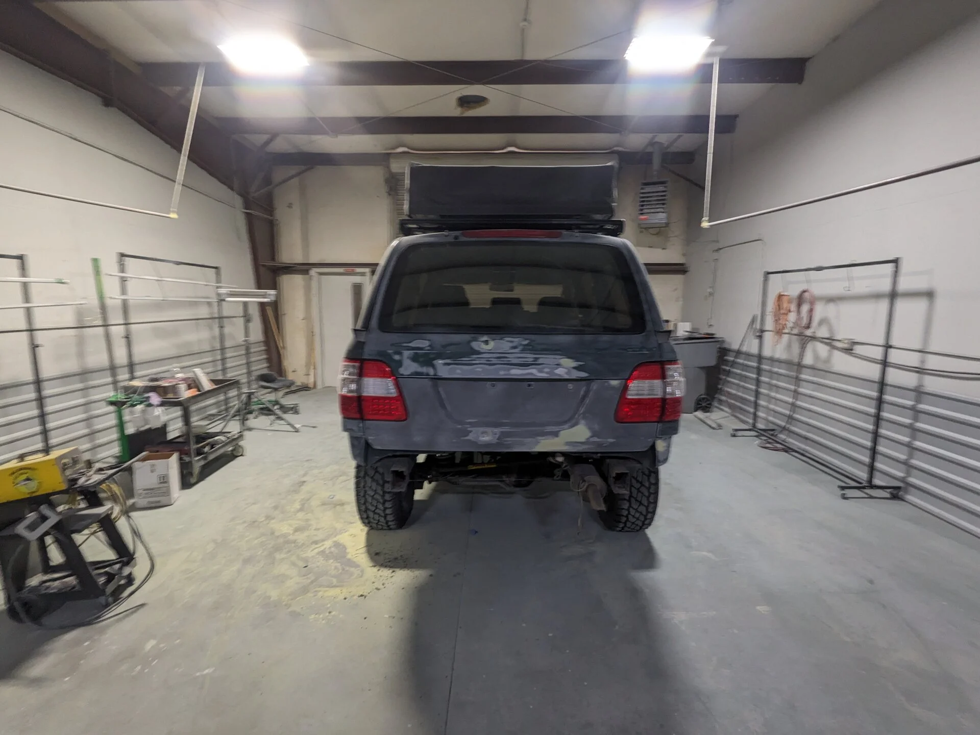

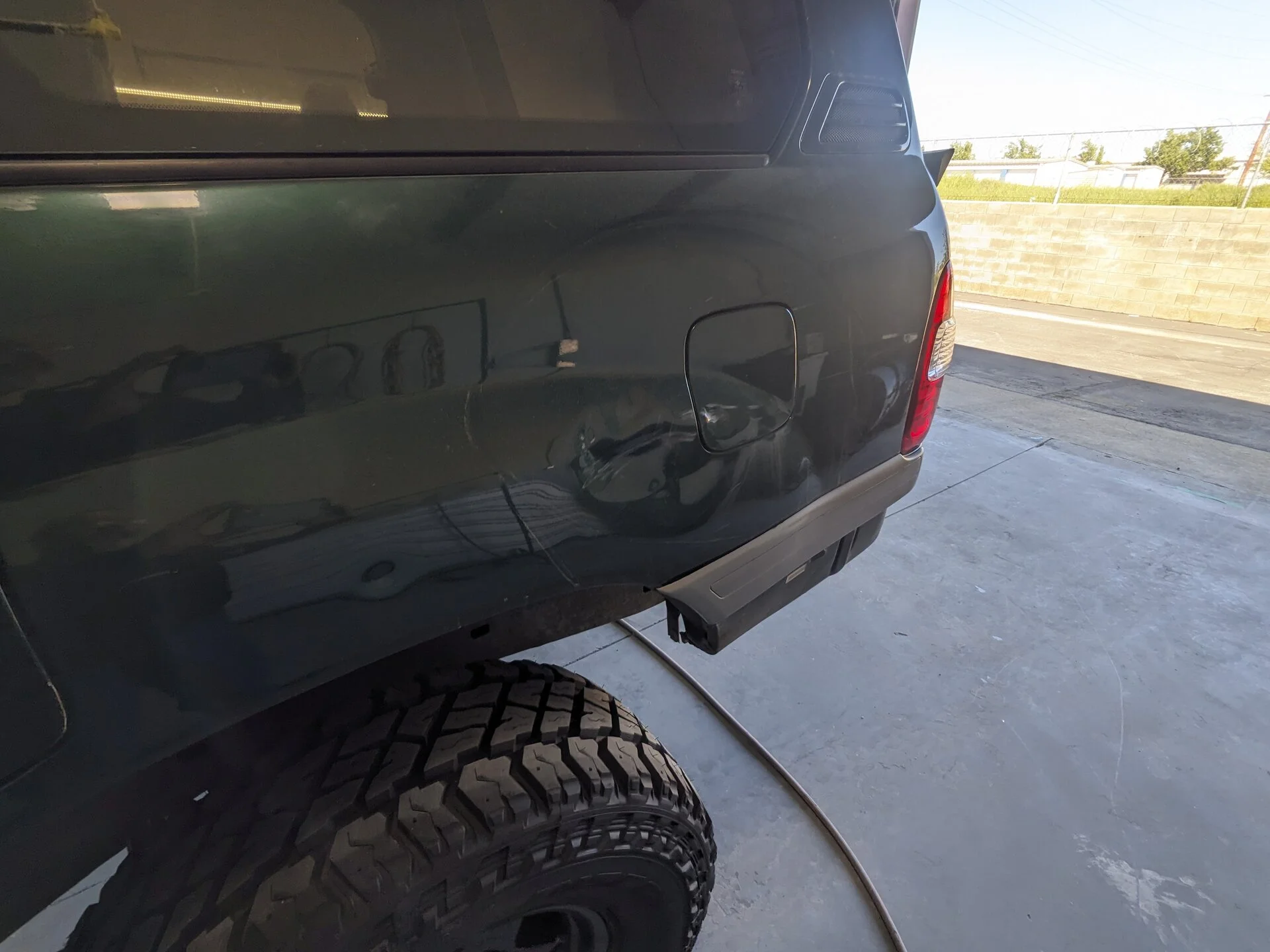

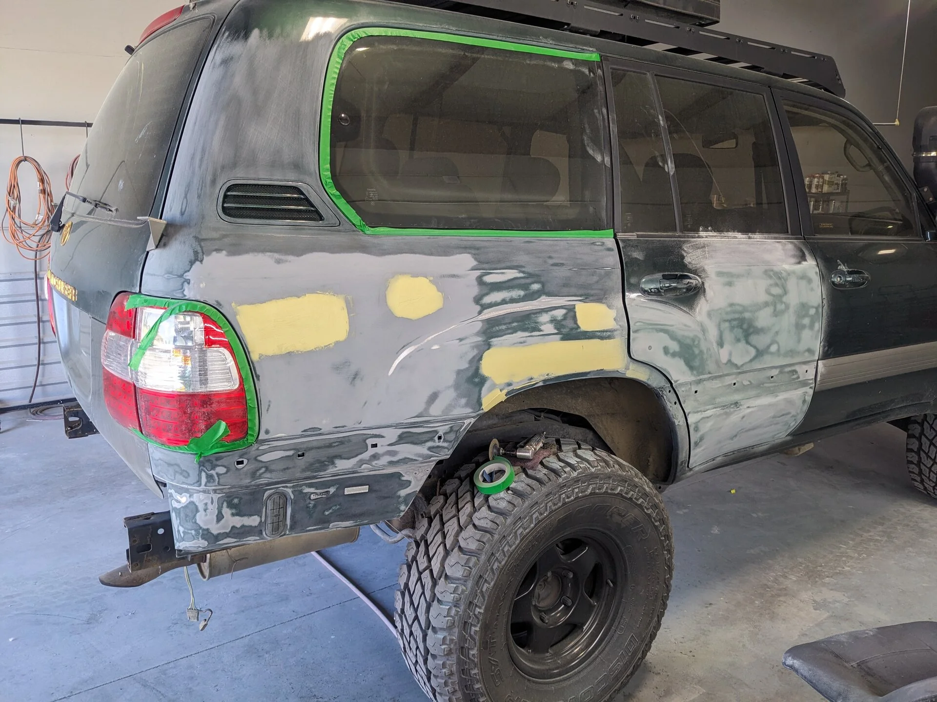

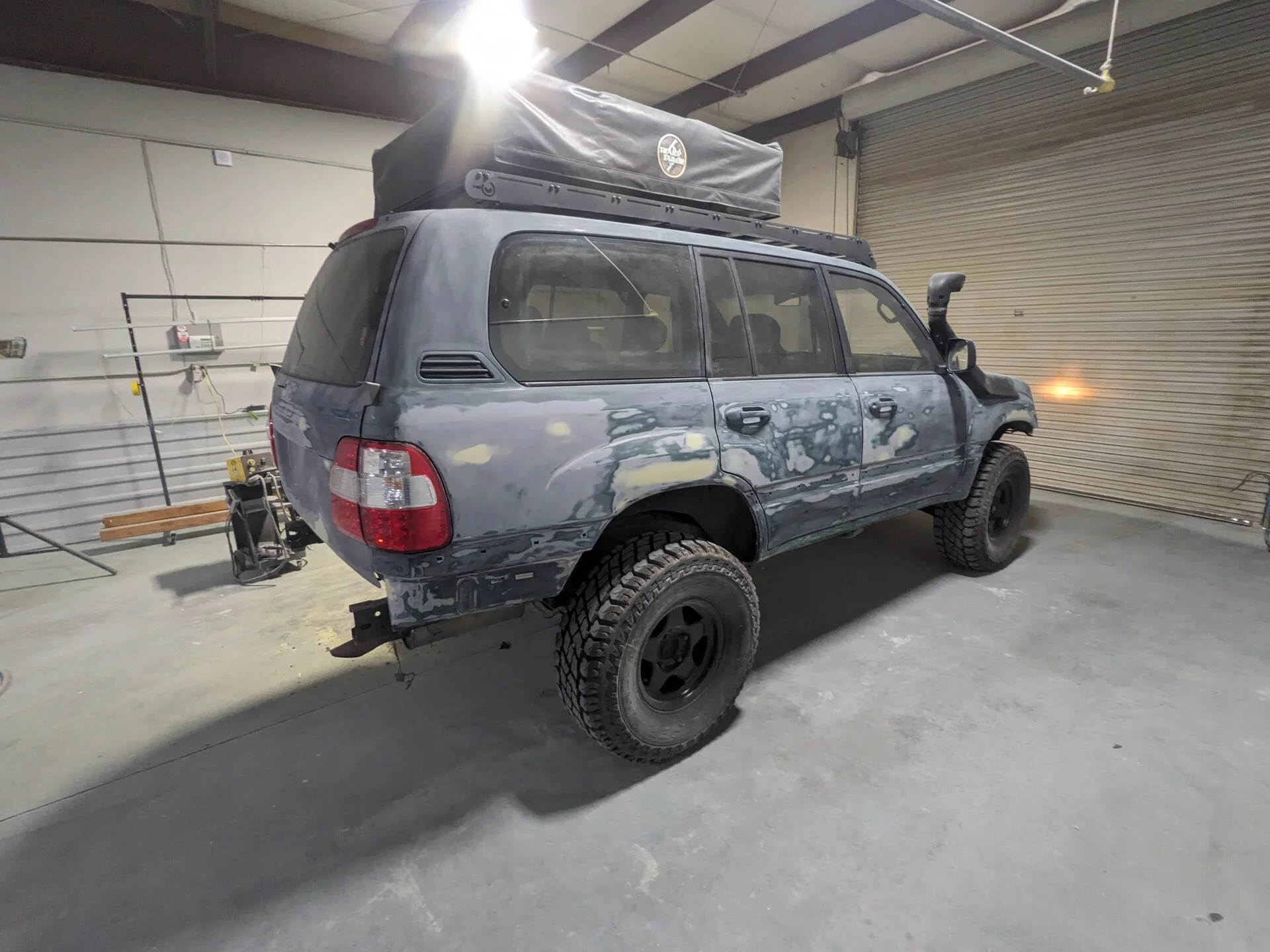

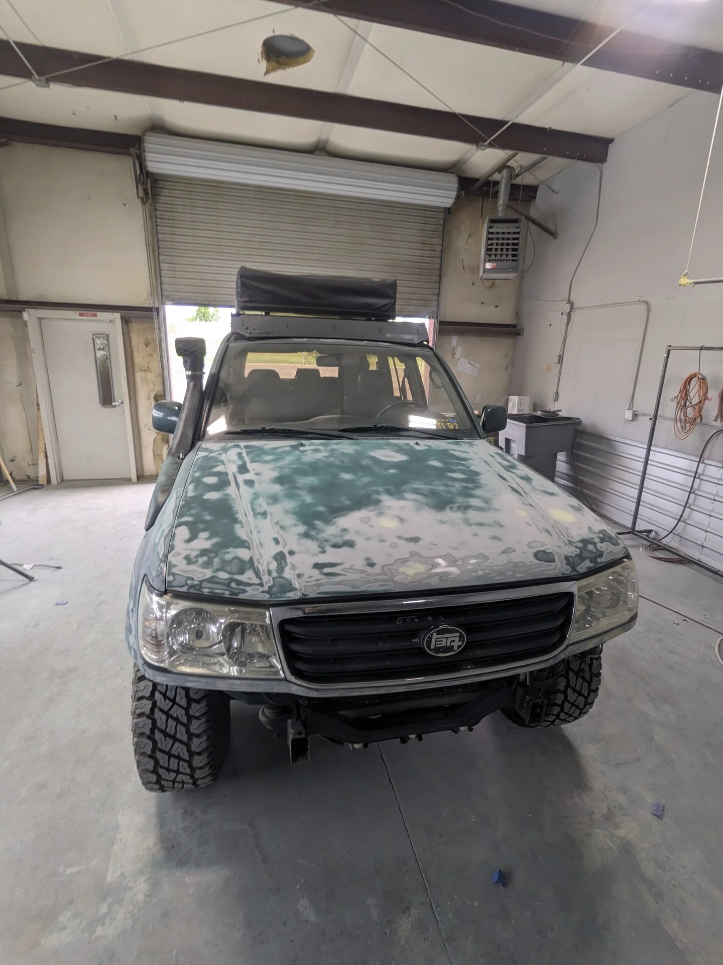

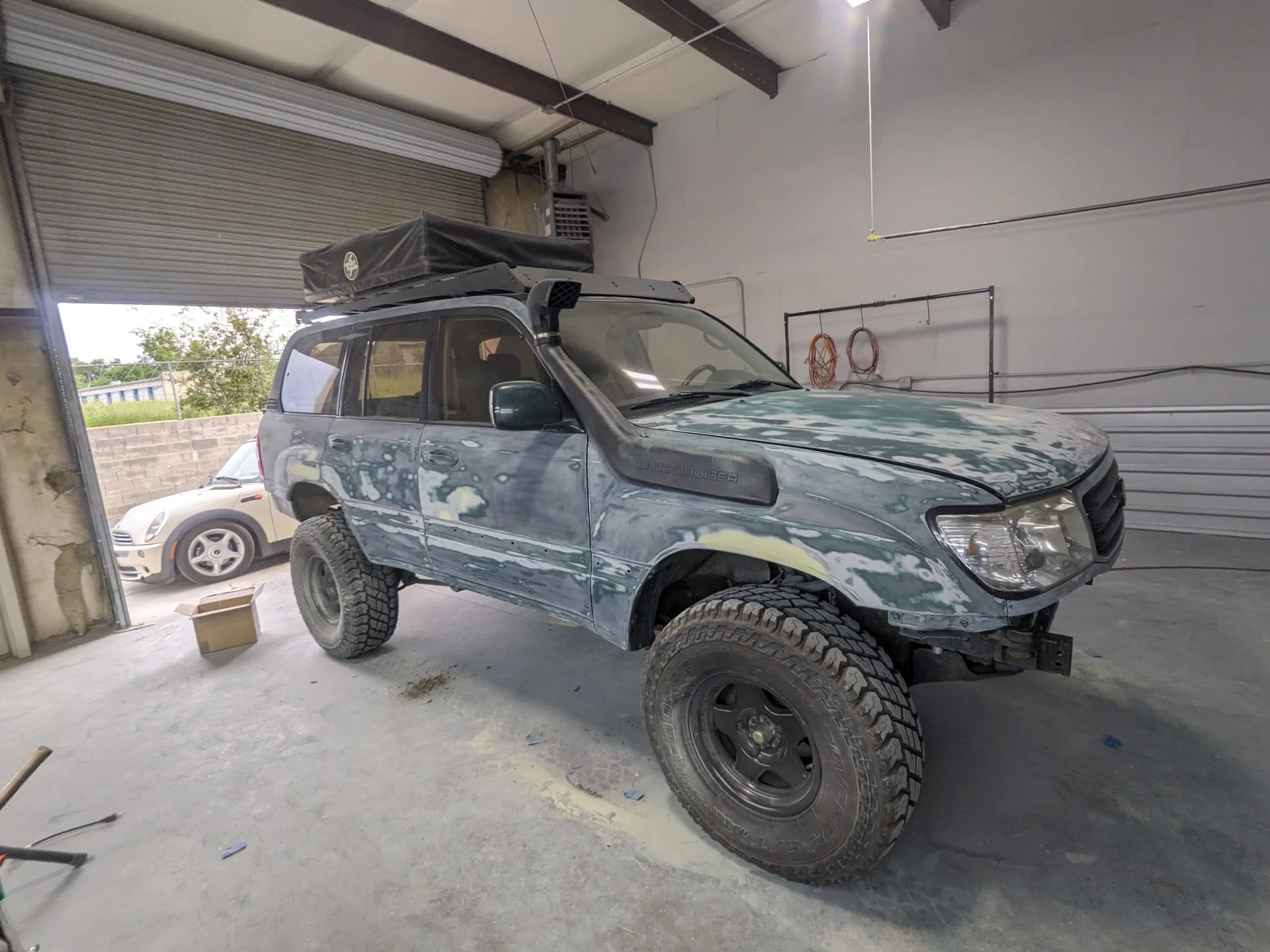

With the new dings, a rear quarter dent and rear tailgate changed out. I was going to do some bodywork and have her wrapped. But with the quotes from 3800-6000.00 and I have to sand and re-clear... Might as well make the exterior trail proof.

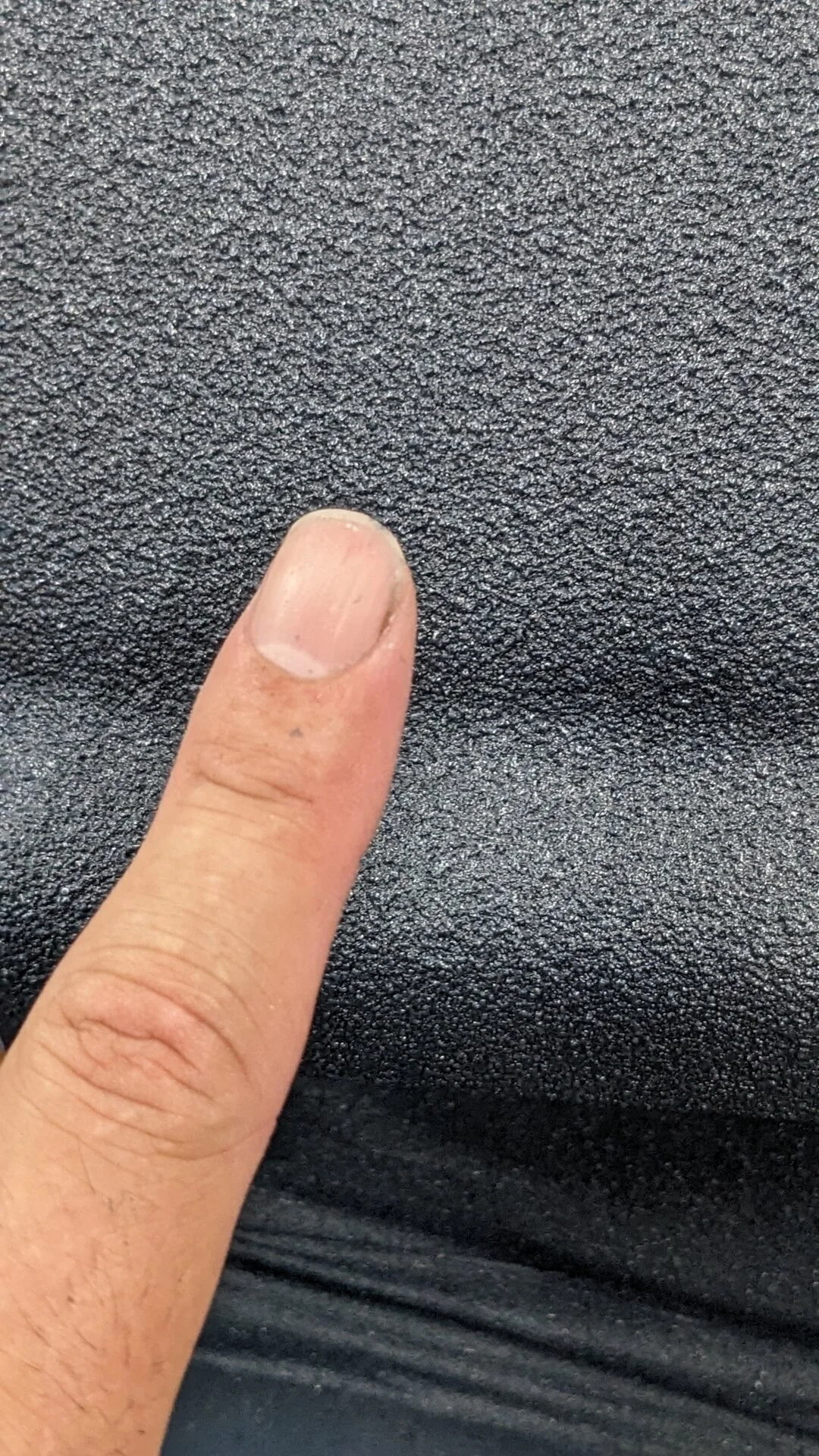

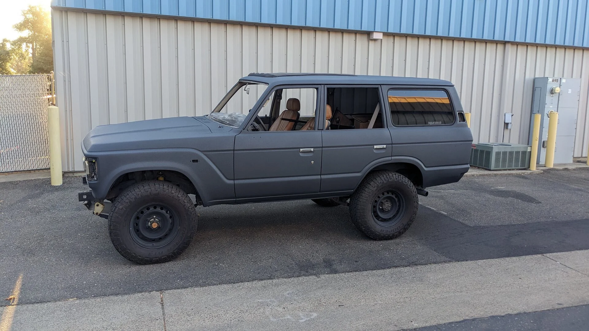

YEP-- I will spray with Genesis poly and get the OEM color match. Most people think this is a bedliner material, but it not. It is an industrial top finish. I can sand the entire rig down in about half a day and no harm to the sheetmetal from heating up. Just simple 60 grit and a DA.
Last one I did this week on a HJ61. Texture is the size of the head of a pin for reference.
Jason

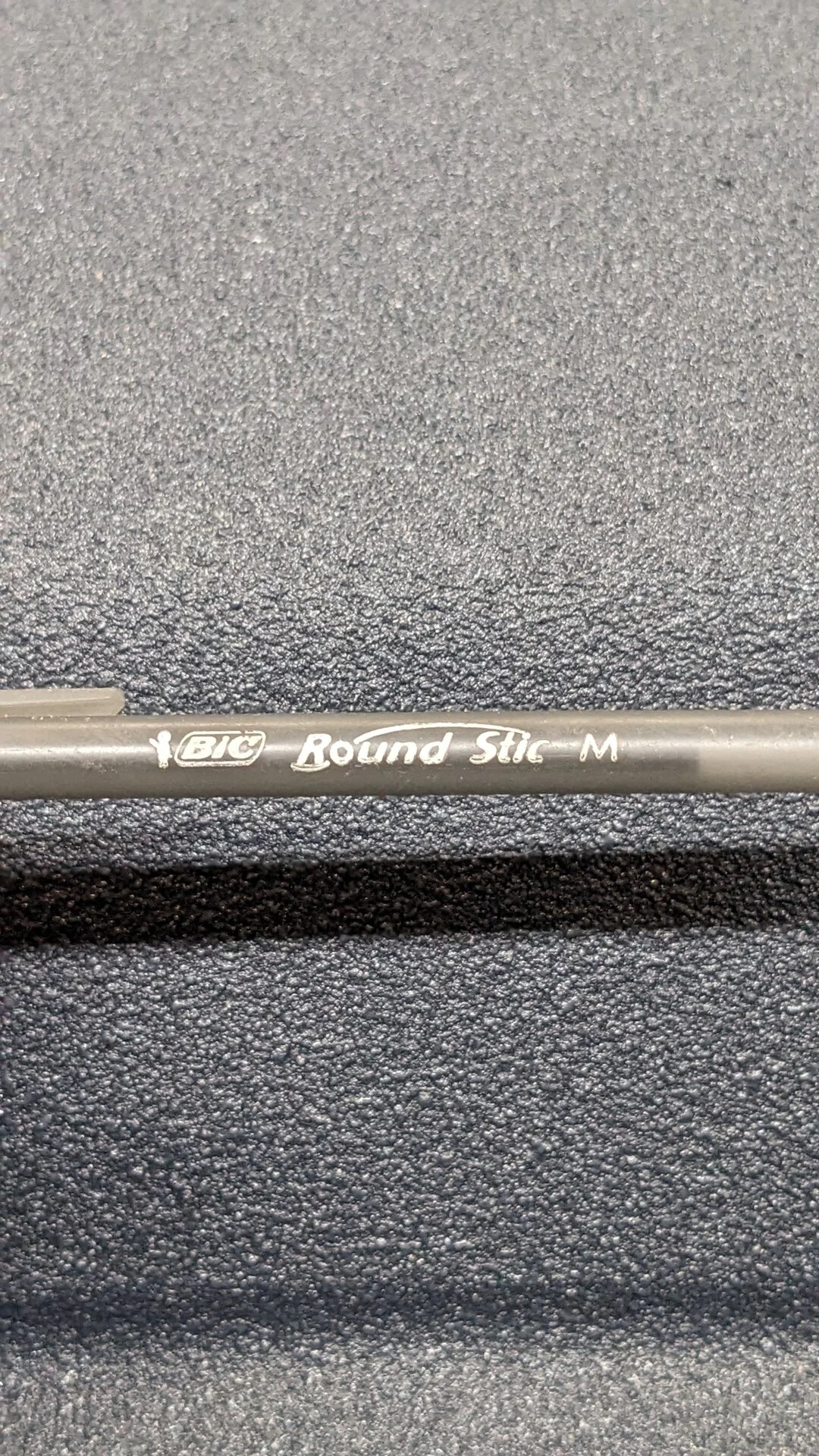

Jason
View attachment 3399772View attachment 3399773
What color is that? Looks gun-blue-black ??
I like it
Are you saying that esme will be oem green in this texture? If so that’s sounds really good
I like it
60 above is OEM #155 Dark gray metallic even has the metal flake in it.
Yes Esme will be the OEM #6Q7 Imperial jade mica with all black trim.

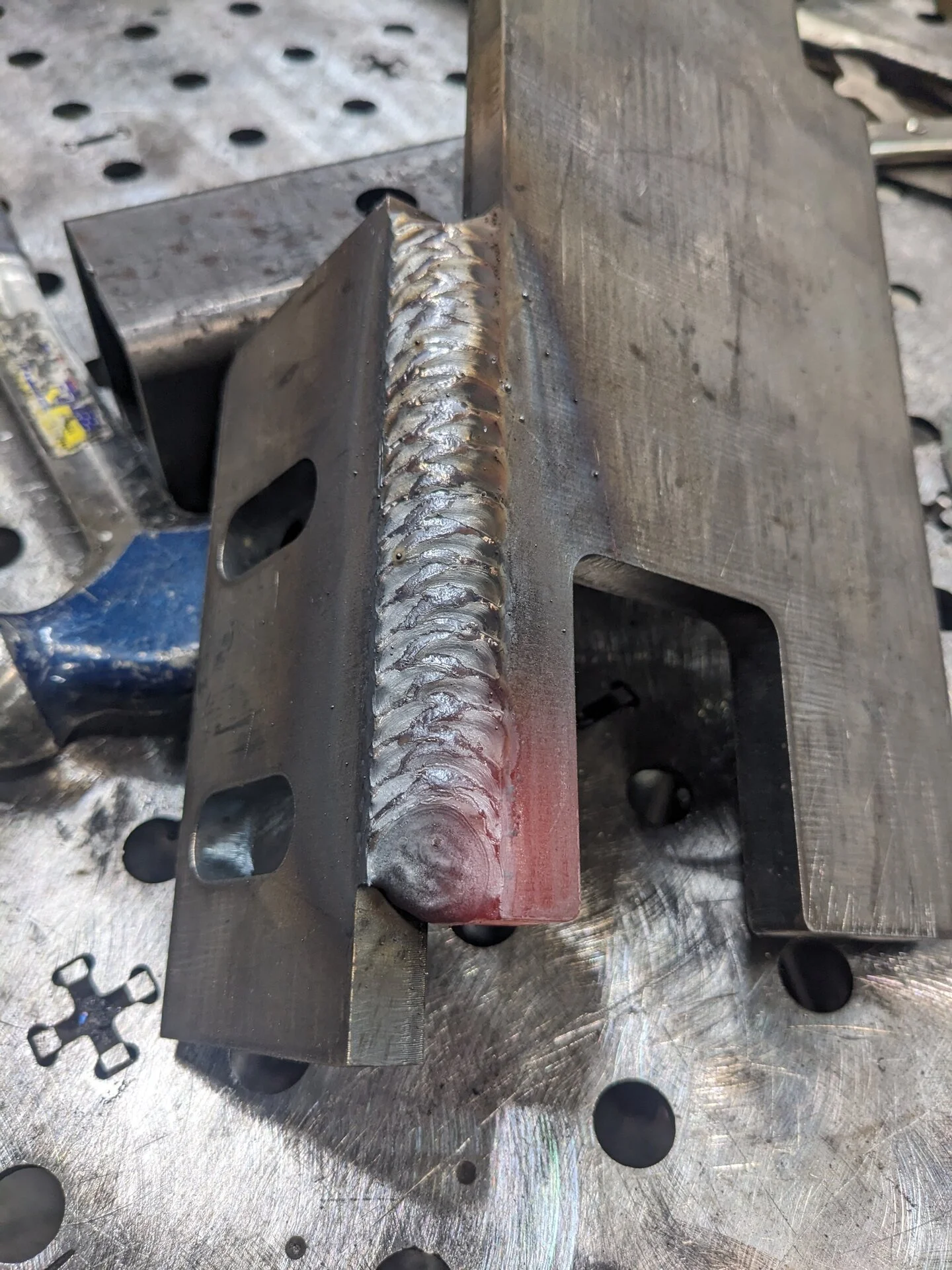

I remember that design. It’s like the one that guy chased you down to buy off the back of your truck 😂

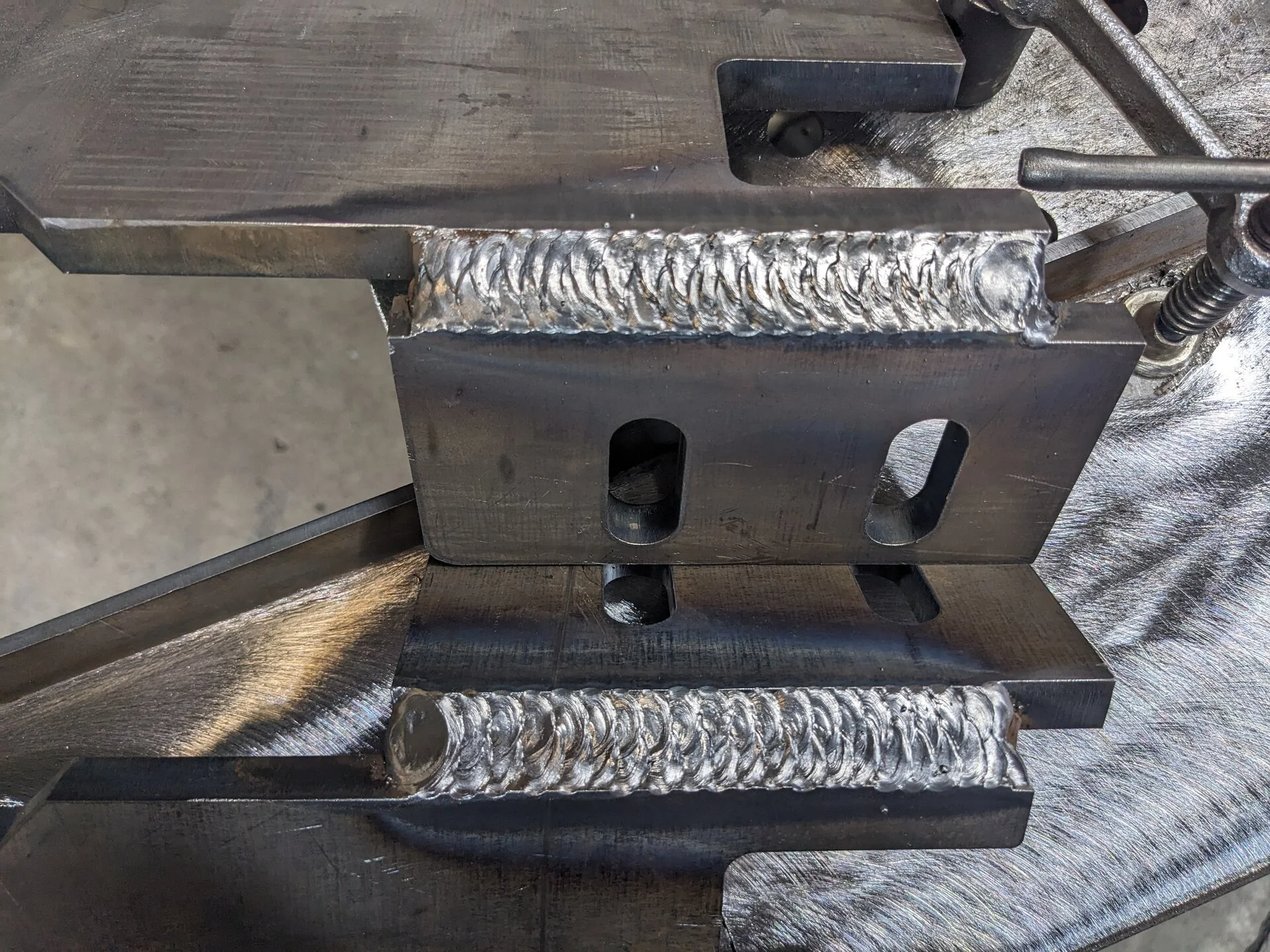

I almost shot that guy... I made 4 of these arms and 2 remain. This was the most complete and cleanest. Been sitting for a couple years in the corner collecting dust.

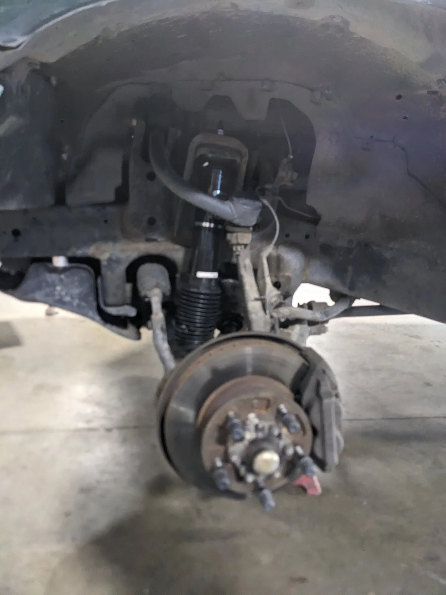

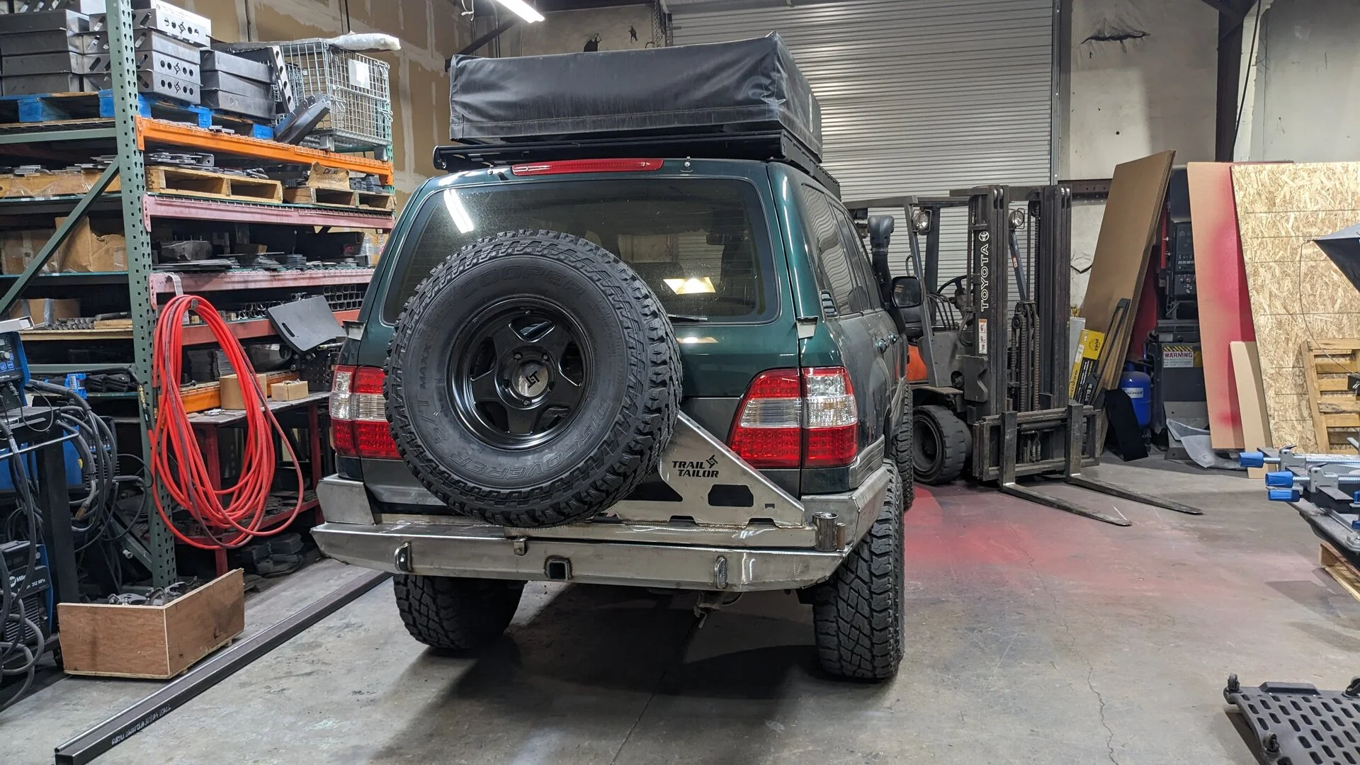

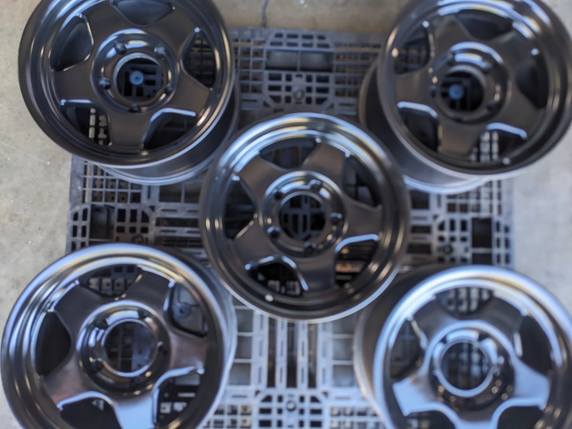

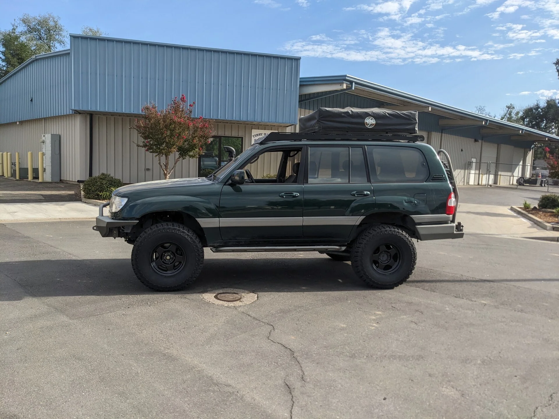

315/75/16 (34.5") Cooper ST Maxx are mounted and balanced on the SCS wheels. Satin black color change on the wheels.
Dobinsons IMS front (extended length) and rear shocks added this morning after breakfast with my good friend @Butt Ugly Chuck
I'll be cranking the arms Monday and gaining another inch up front and getting a little better rake. The extended travel shocks get me back to 60+mm of droop after the crank.
Sorry for the crap pictures... I'm on phone # 2 this week and waiting on #3. Rough week for phones at Trail Tailor.
Jason
