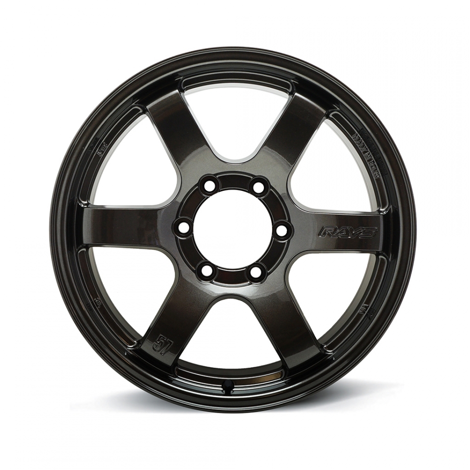

The more sets of STs F5 wheels I see, the more I like them. Simple, not too flashy, just nice. I'm a fan of minimal logos on stuff; If the Rays/Volk TE37x didn't have stuff machined all over them they would be a wheel I could talk myself into.
Rays Gram Light 57DRX might be a hit for you.
Not bad at all.
