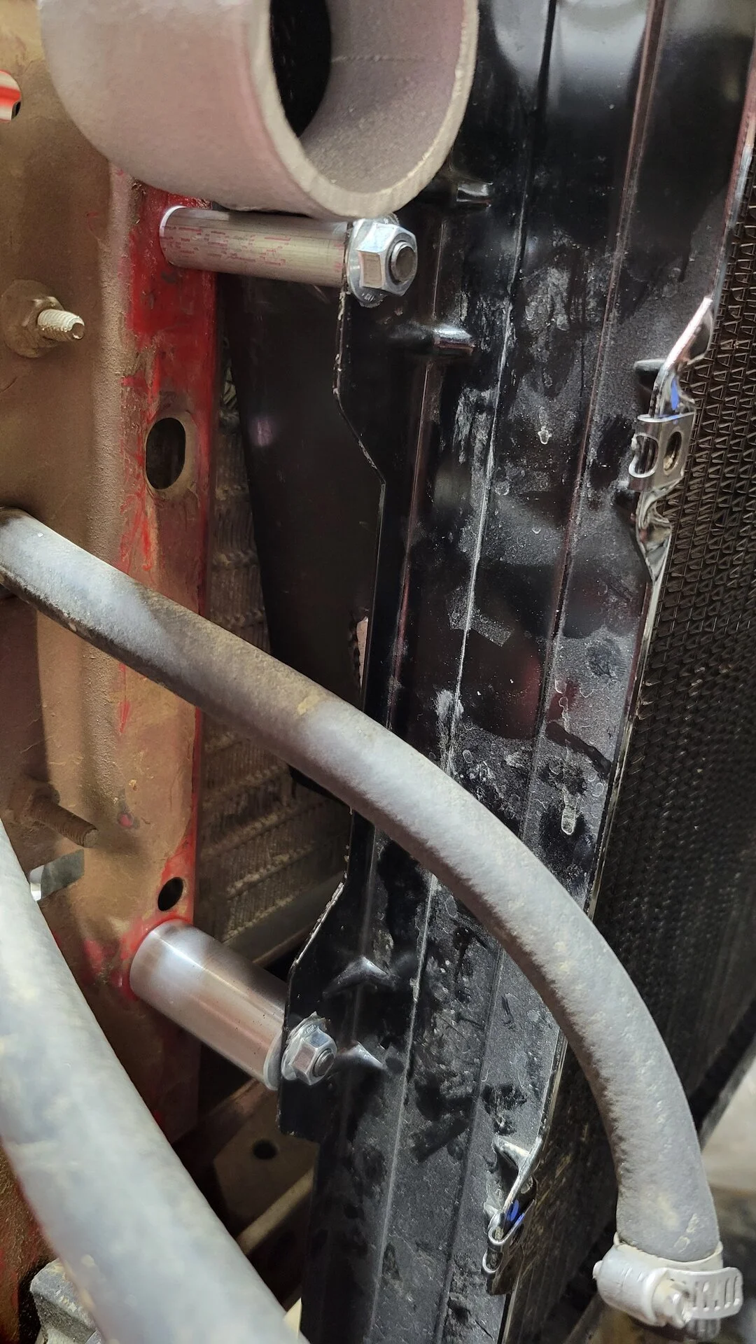

Radiator stand off aluminum spacers. My print had them at 2.150", came off the lathe at 2.1505" :D

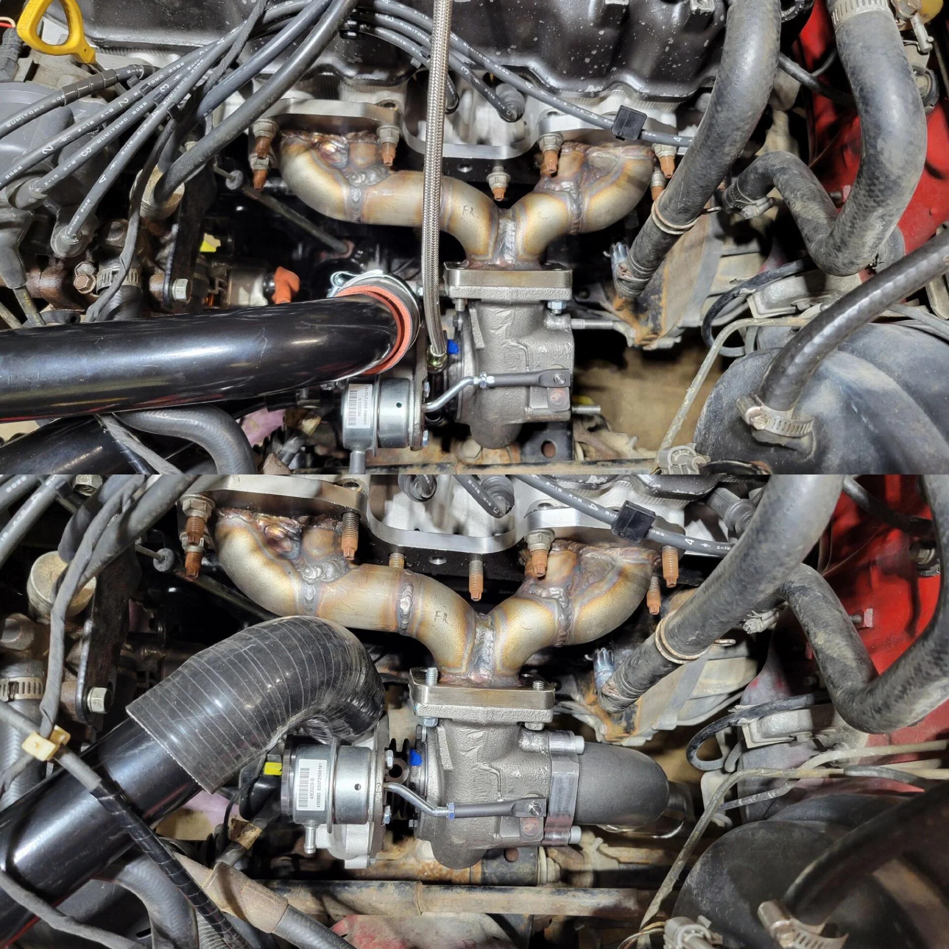

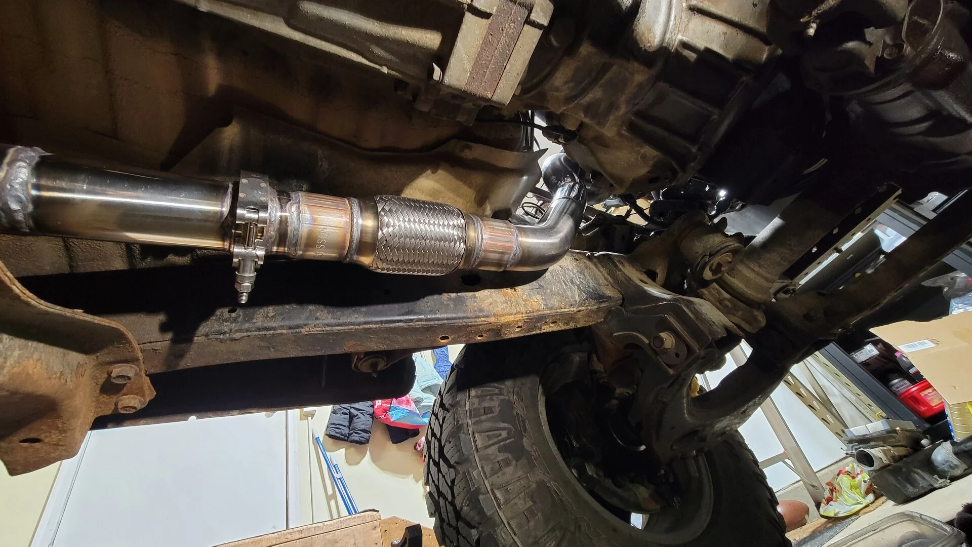

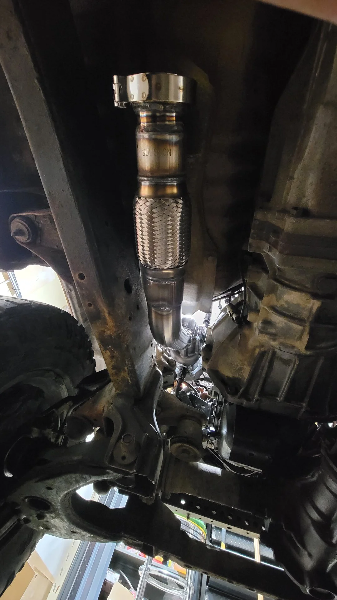

Down pipe is done. Still need to tie into the old exhaust.

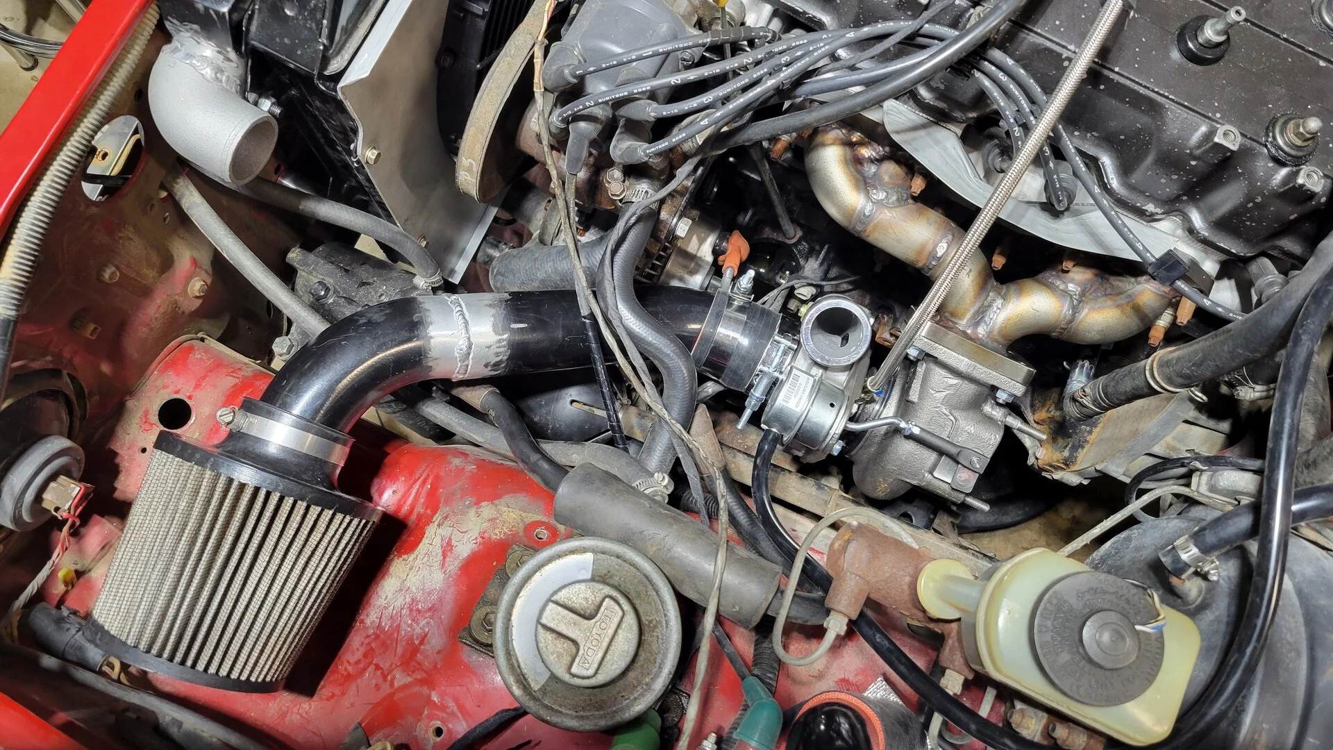

2.5" aluminum pipes arrived for the compressor inlet/air filter. Chinese bead roller for $50, too. Have all of the tube I need to finish the fresh air piping
Exhaust is done. On to fresh air side: TiAl blow off valve location, bead rolling and air filter location- maybe a filter box in the future.

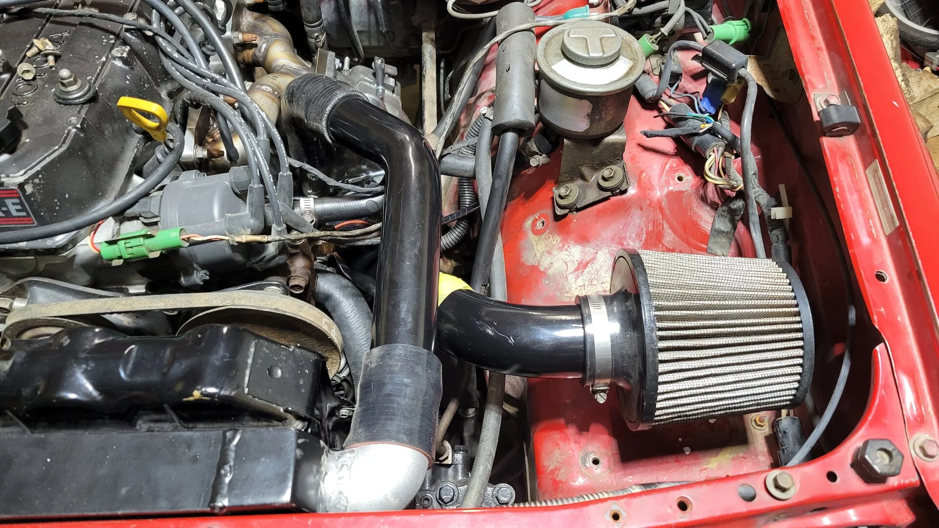

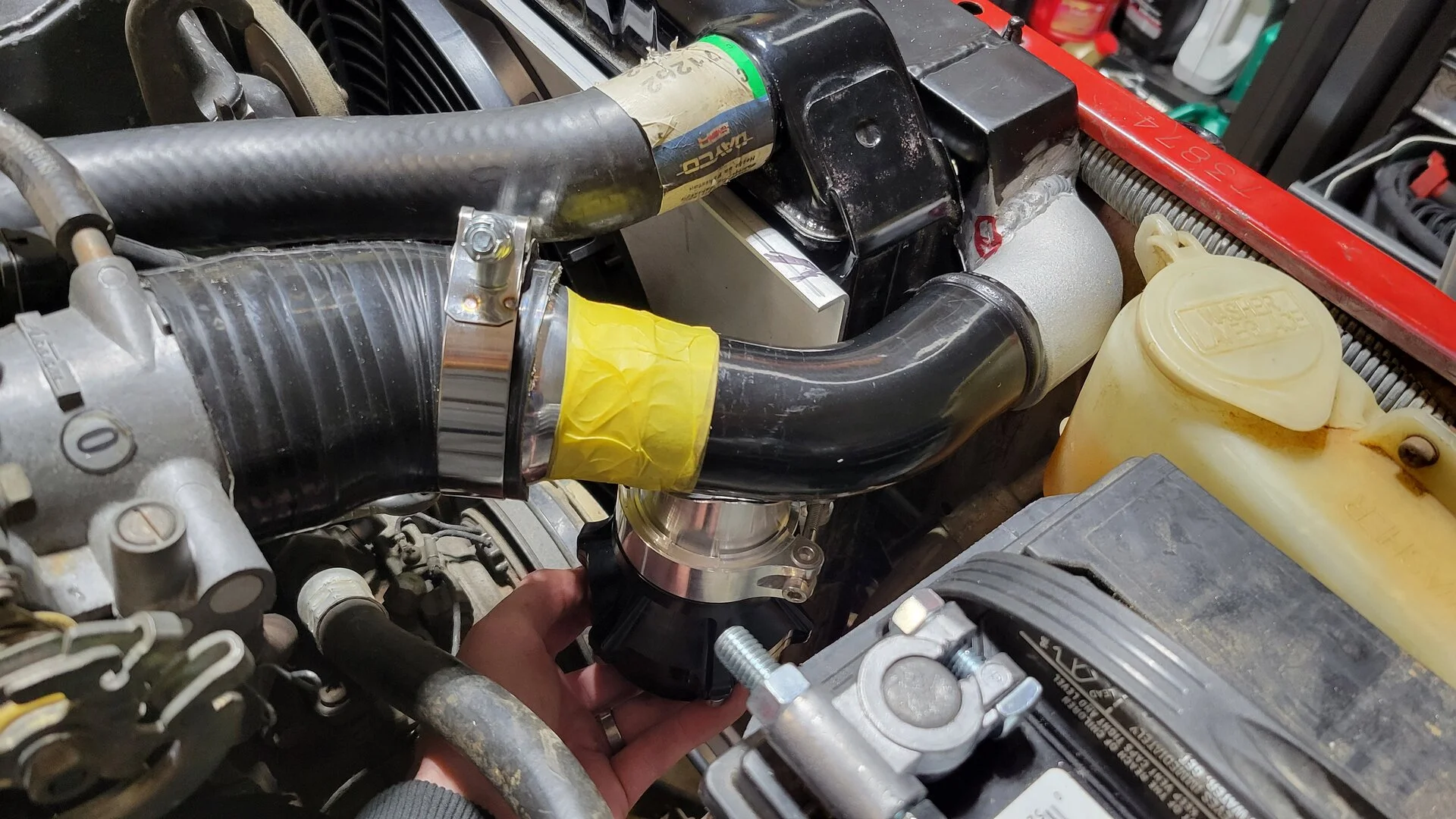

Compressor inlet mocked up, 2.5" aluminum 45deg bend cut down and 90deg bend cut at the correct angle to make it work.
Ready to start welding thin aluminum 😳

Clocked the compressor outboard to get it further from the manifold. Now the oil drain hits a compressor cover bolt so I will need to figure that out.

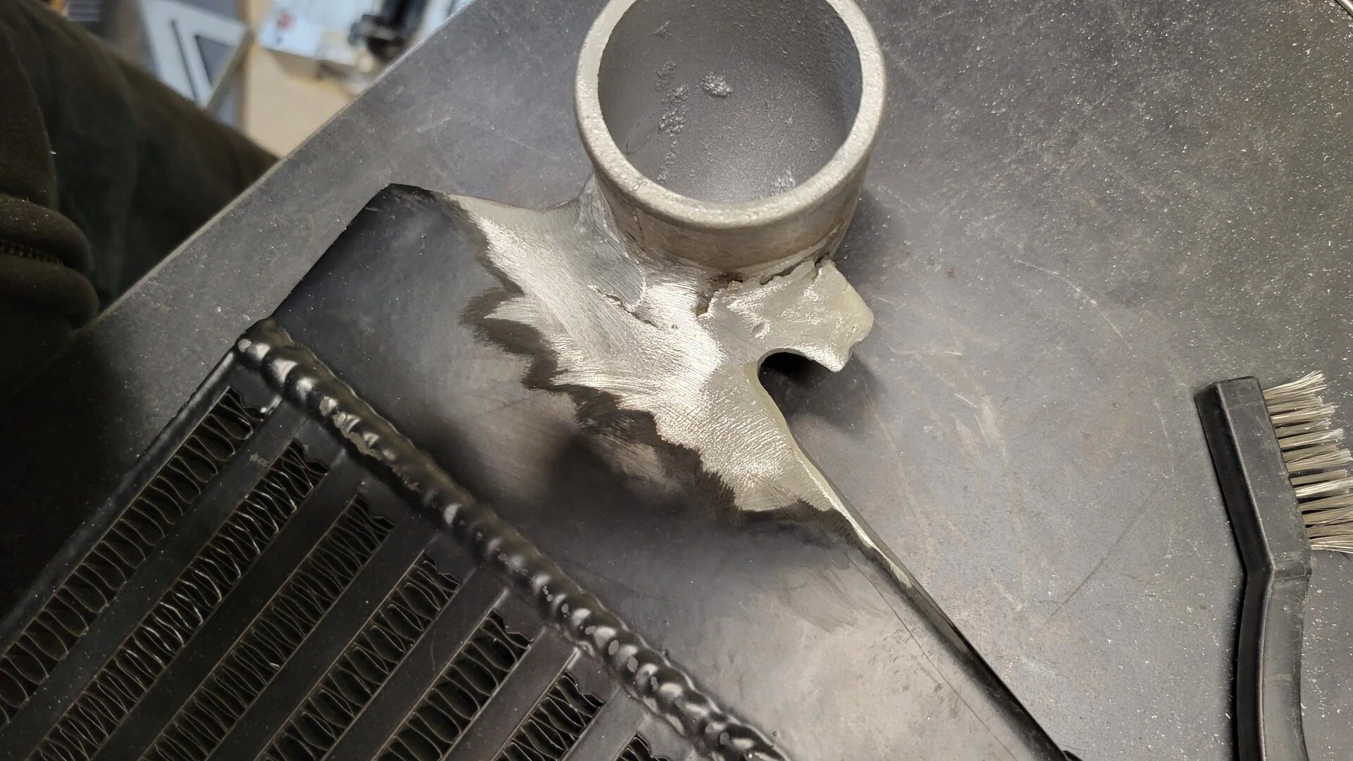

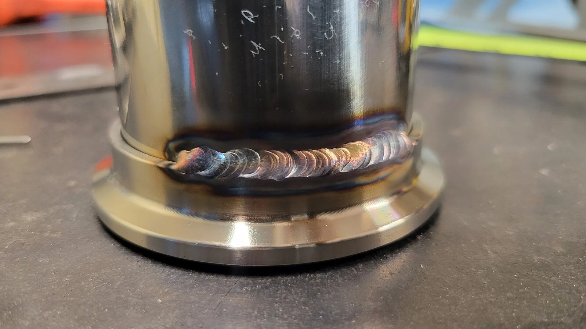

Ditched the spacers up top and just welded on these Intercooler ears/slotted tabs- done and the intercooler is mounted. Starting to practice welding tube on cut offs.

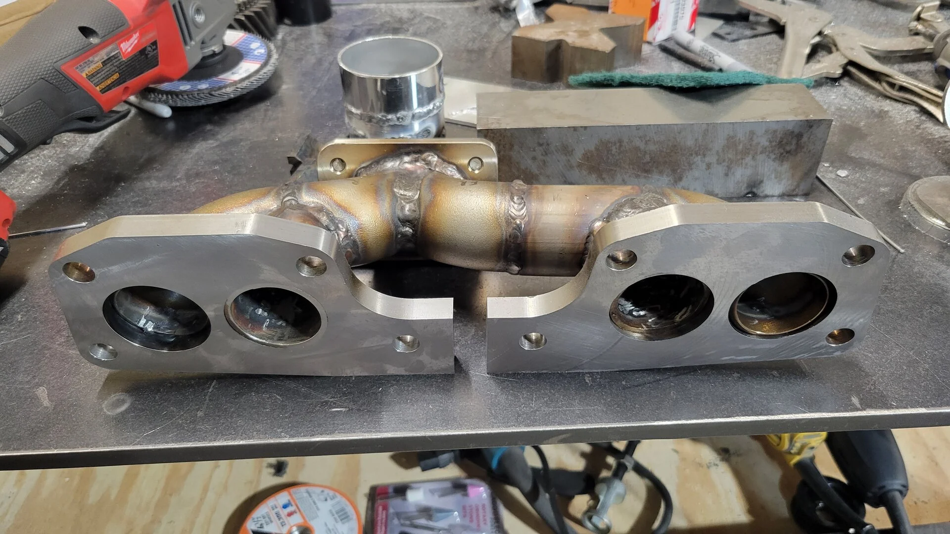

Exhaust manifold, turbine housing and down pipe are ready for ceramic coating.

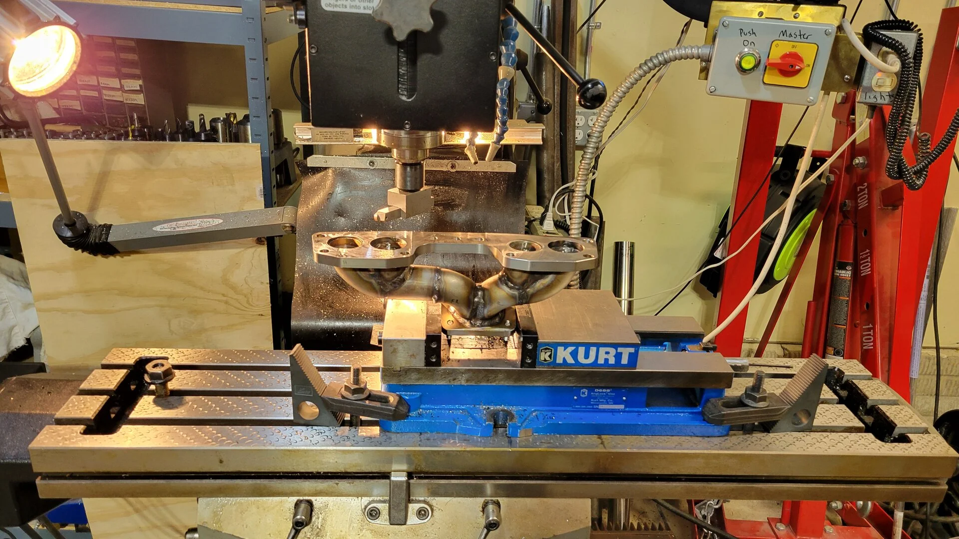

Faced the head surface and then split the flange, this should help the end studs from leaking/pulling out.
Ignore that aluminum practice in the background...

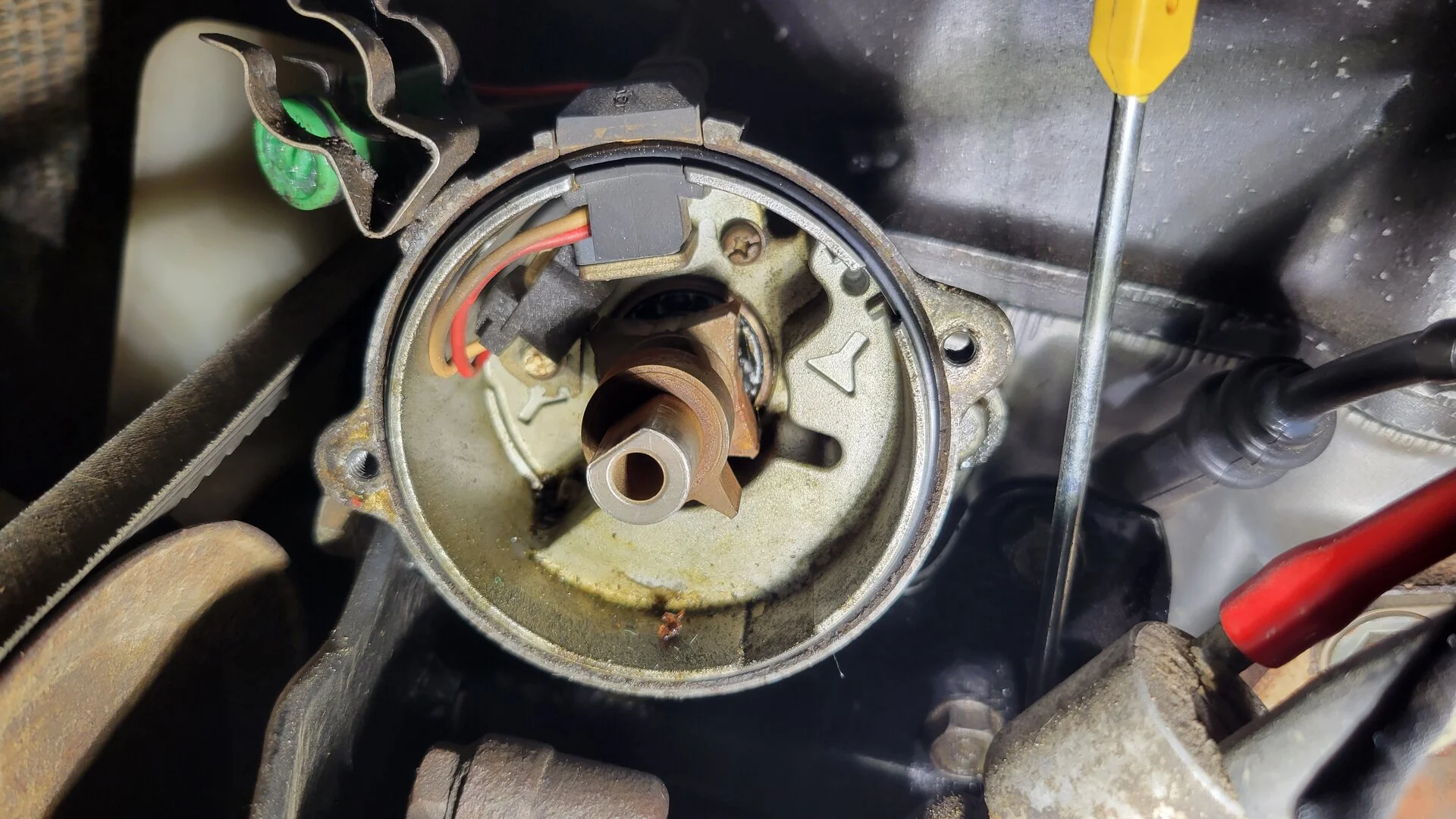

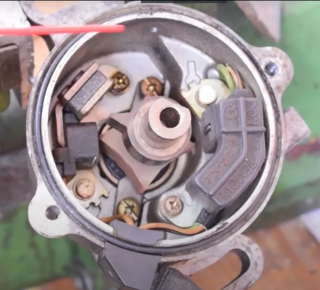

The 4 tooth cam wheel is engine speed. There is a 1 tooth reluctor next to it but no VR sensor. I bought an OEM signal generator magnet and am going to try and drill and tap it then see if I can configure MS for a 4+1 cam/cam trigger. The 4age distributor did this prior to going to the 12 tooth wheel

4age
Not sure how bad the resolution will be but hopefully good enough for sequential

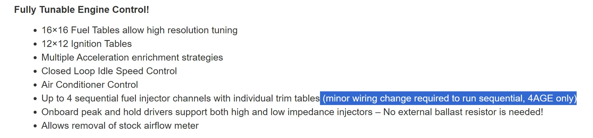

Looks like DIY Autotune updated their marketing material for the 22RE Megasquirt after the blunder we had about 22REs being able to run sequential with a wiring modification (that I did). Still haven't tried to modify my distributor to pick up the single tooth but I do think that it would work.

Fab new oil return flange

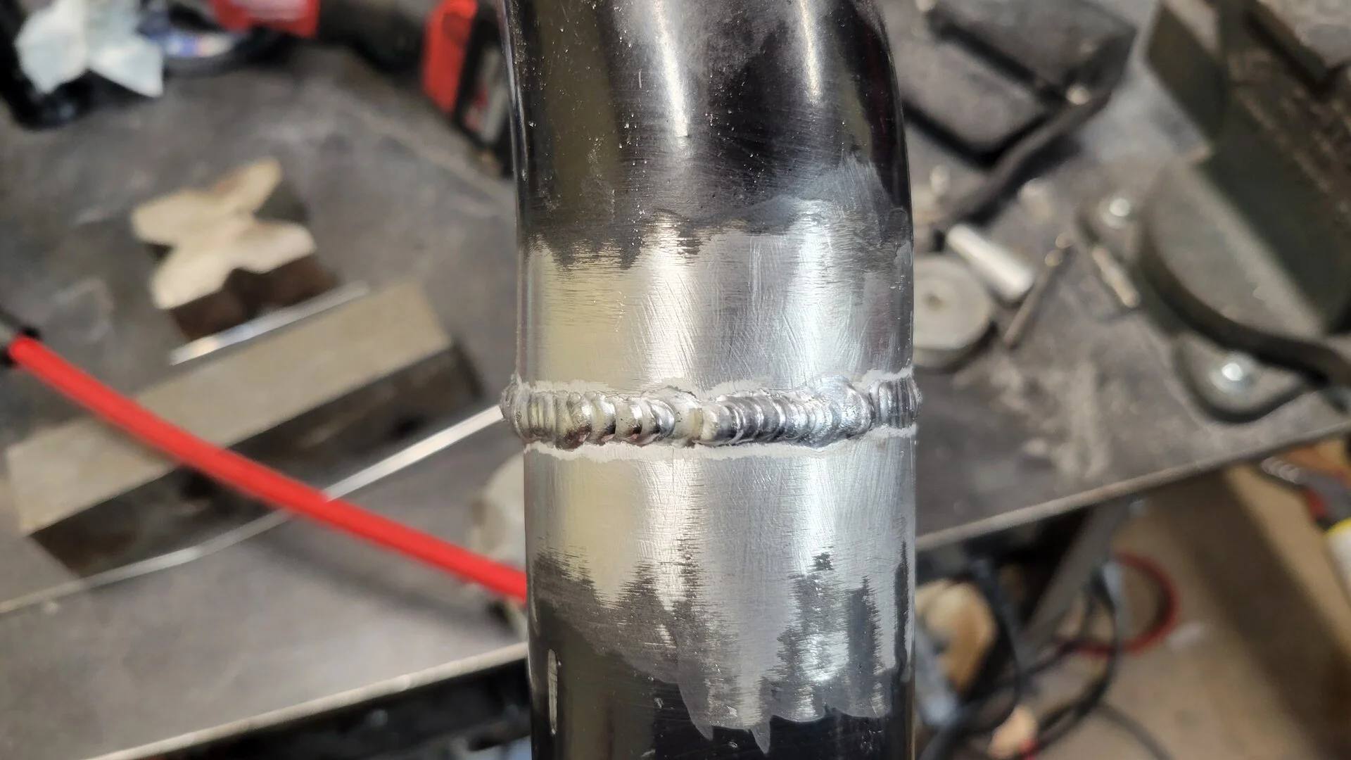

First aluminum pipe
Out of argon 😒
Vacuum manifold for wastegate and BOV, coolant pipe coupler, oil line p clamp

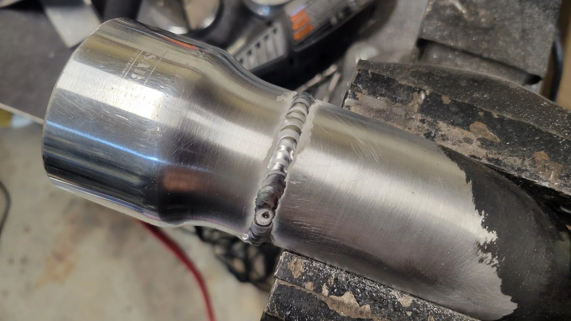

Second pipe done. Not pretty.
Ebay universal coolant overflow bottle.

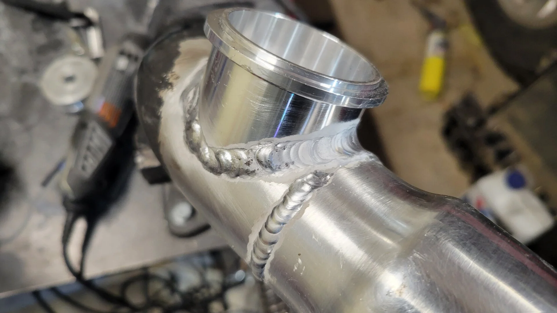

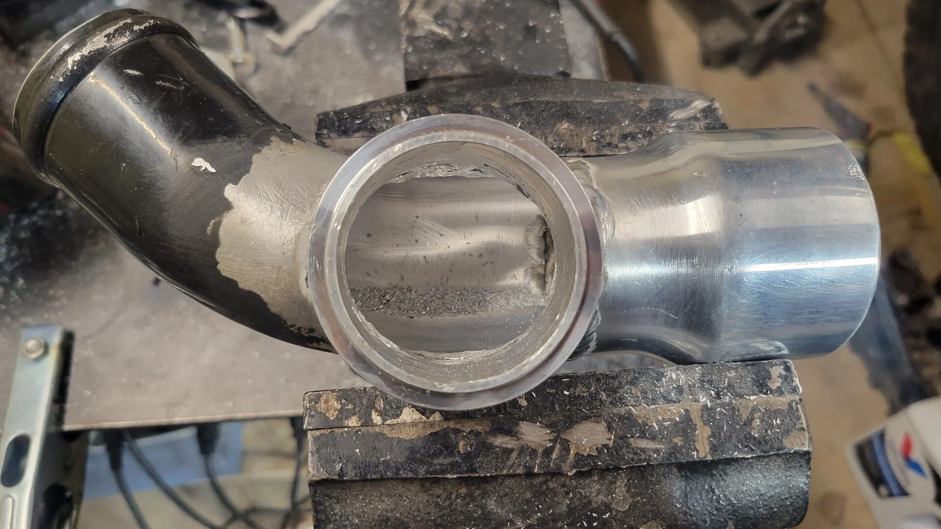

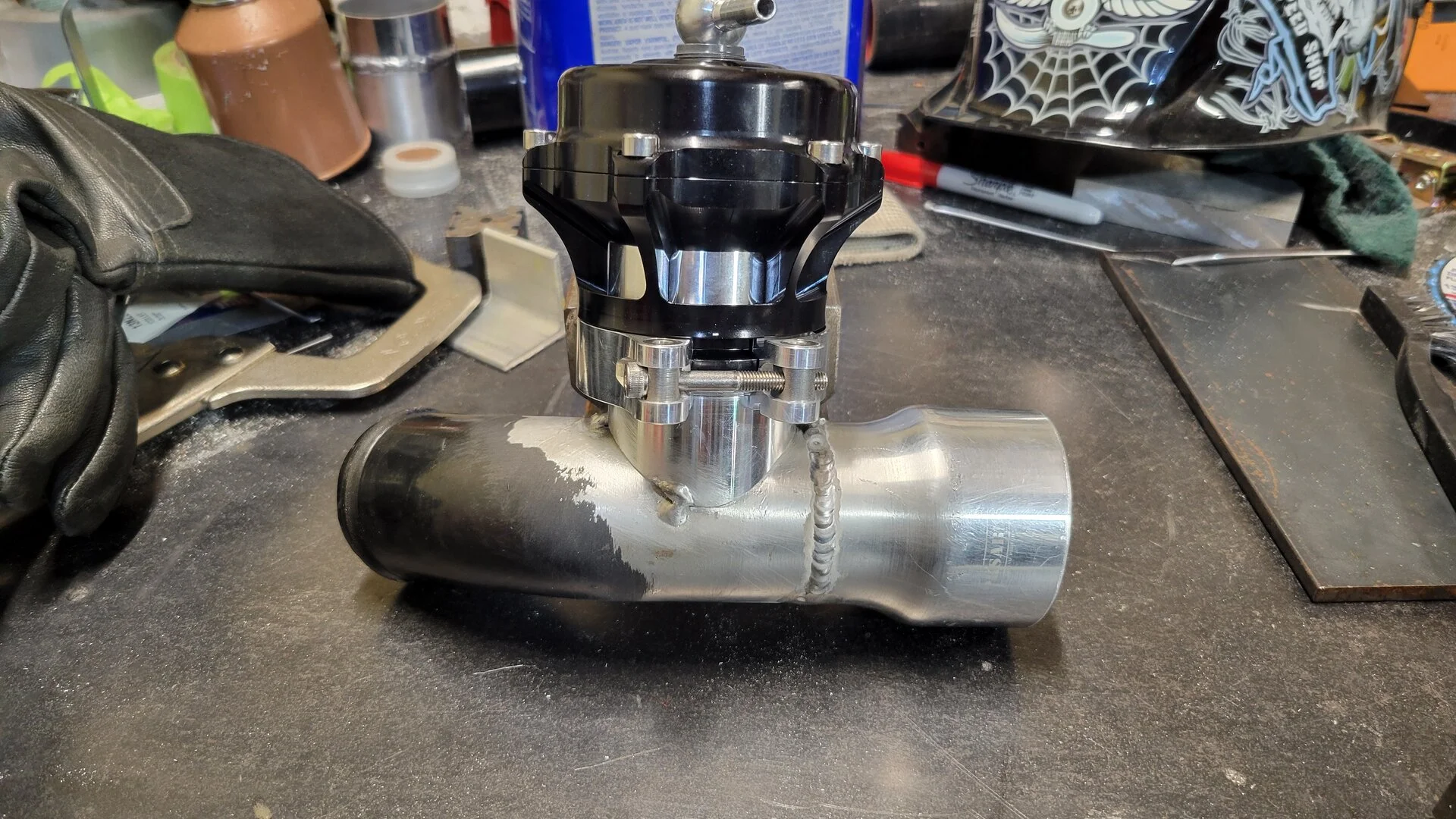

Third pipe better. BOV tacked
Bov flange welded and cut out.

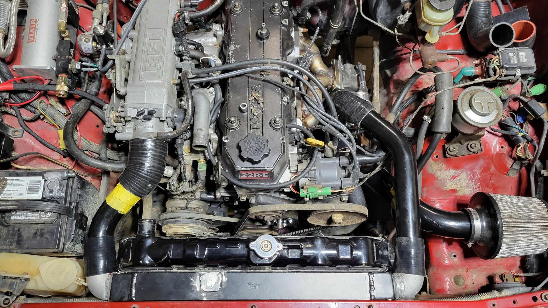

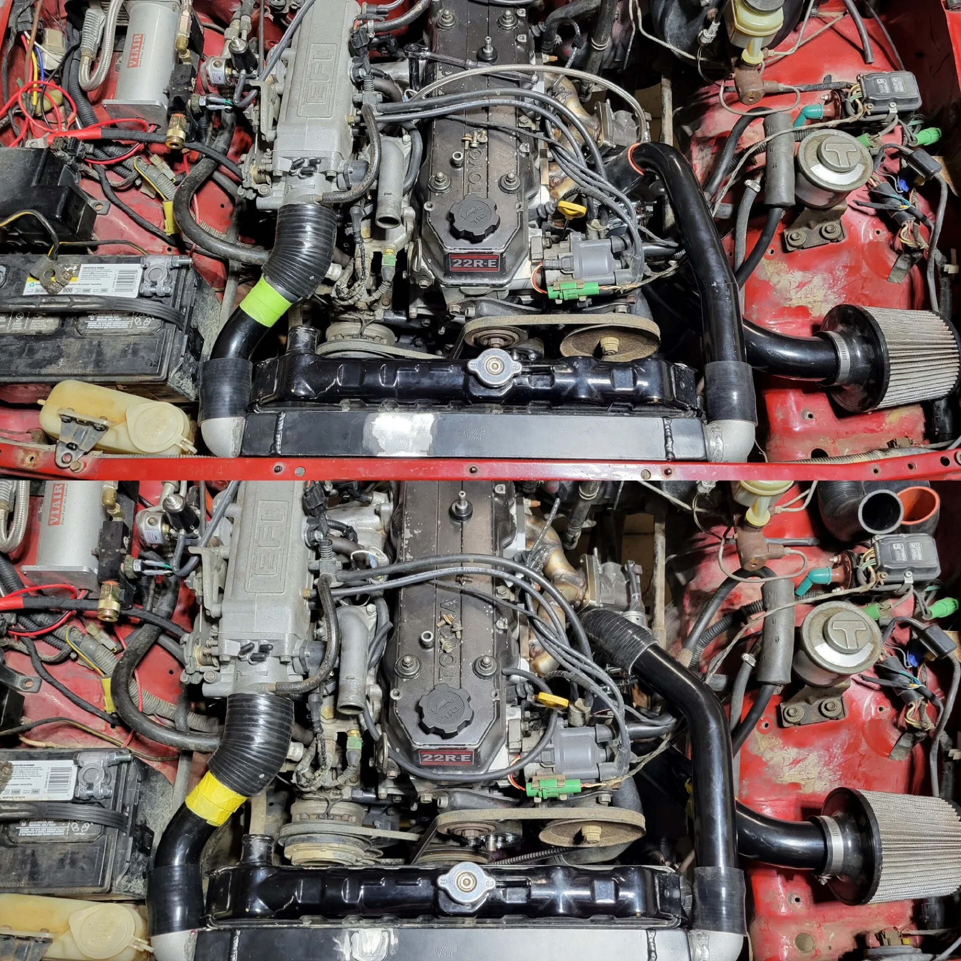

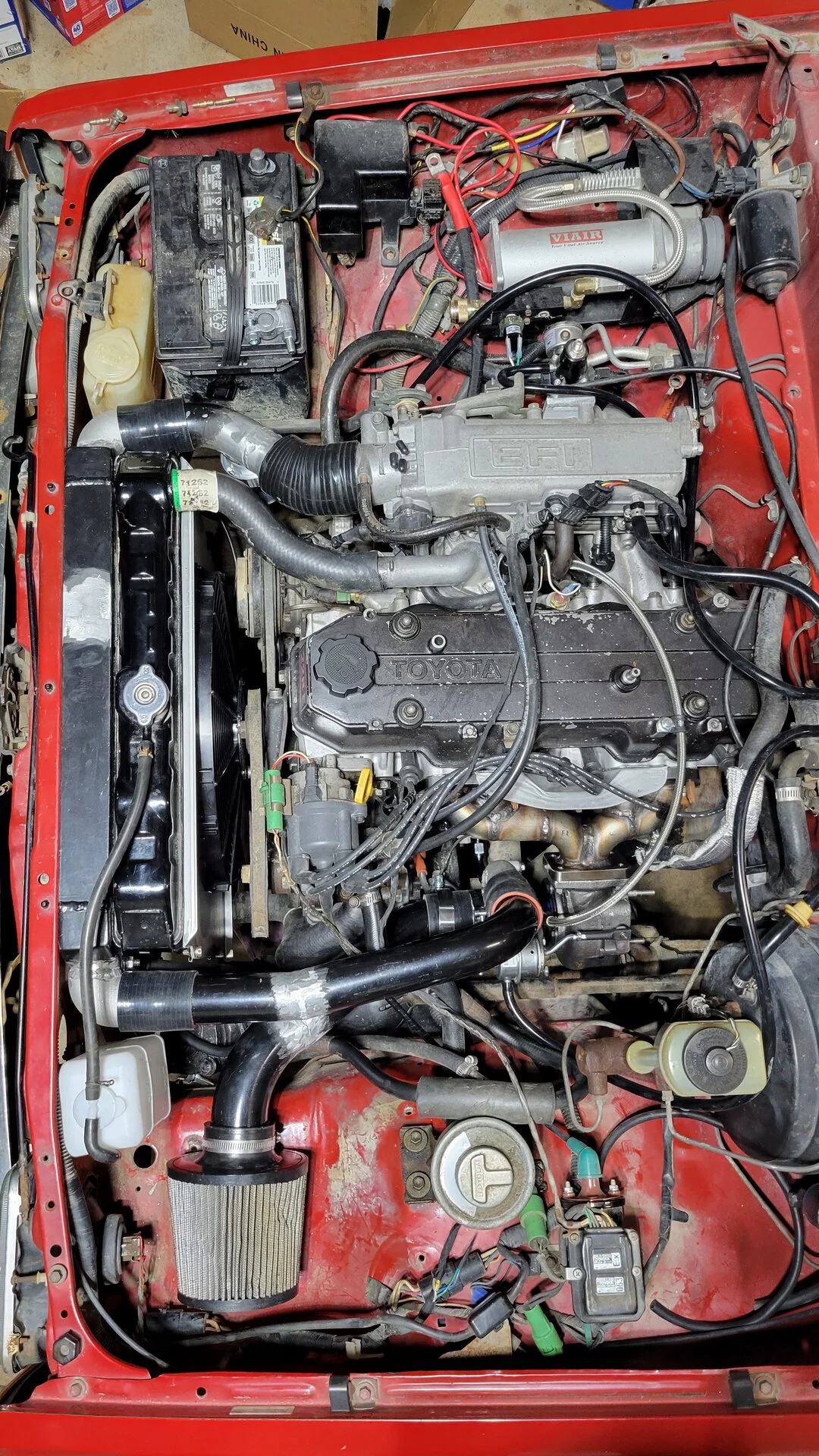

Intercooler piping is done.
Ceramic coating, paint pipes, crankcase breather/ catch can, wiring, heat shields..
