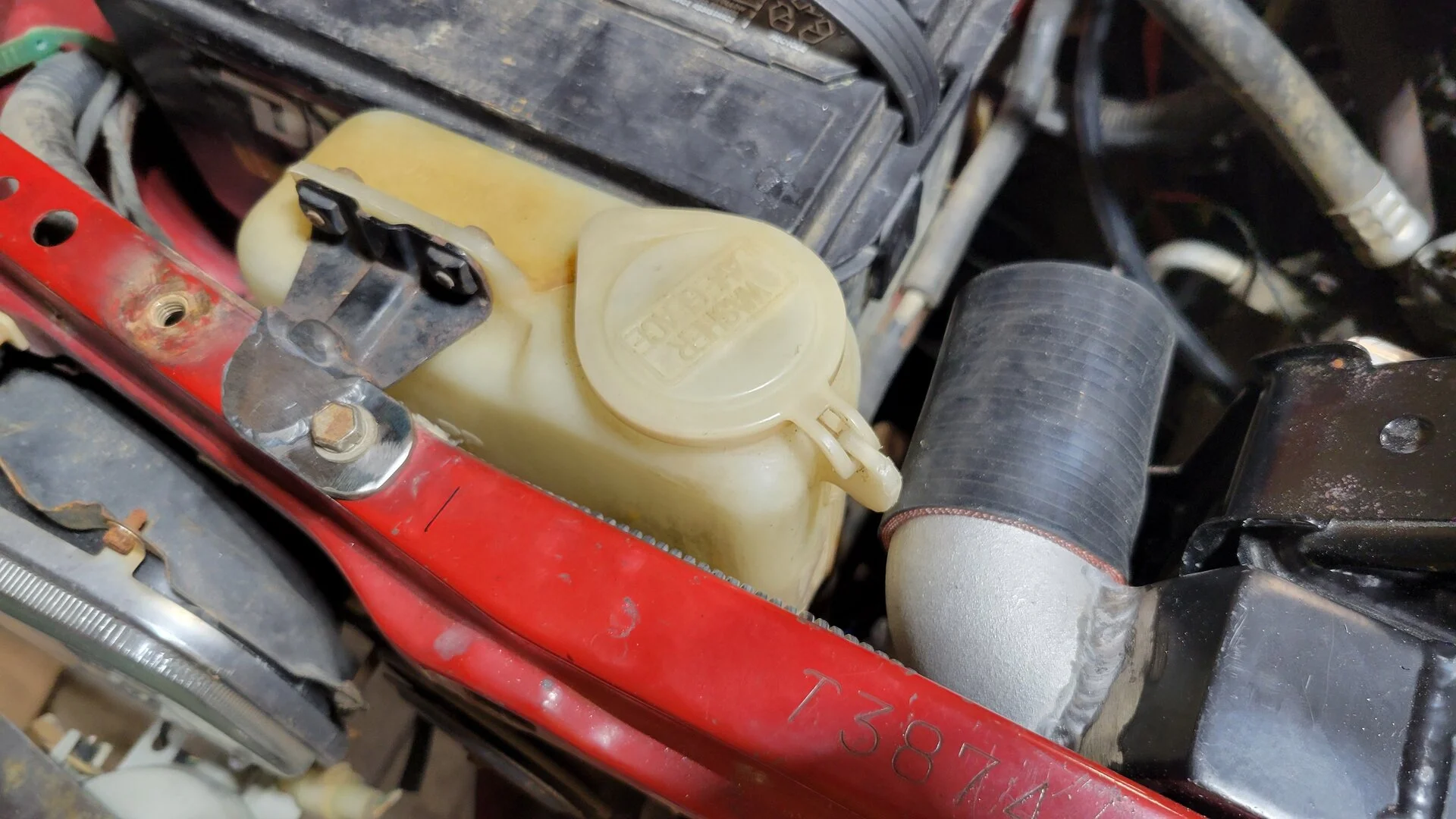

Boring update but if you want to build it like me you have to shift your washer bottle over 1 inch. Remove the plastic donut and modify the bracket

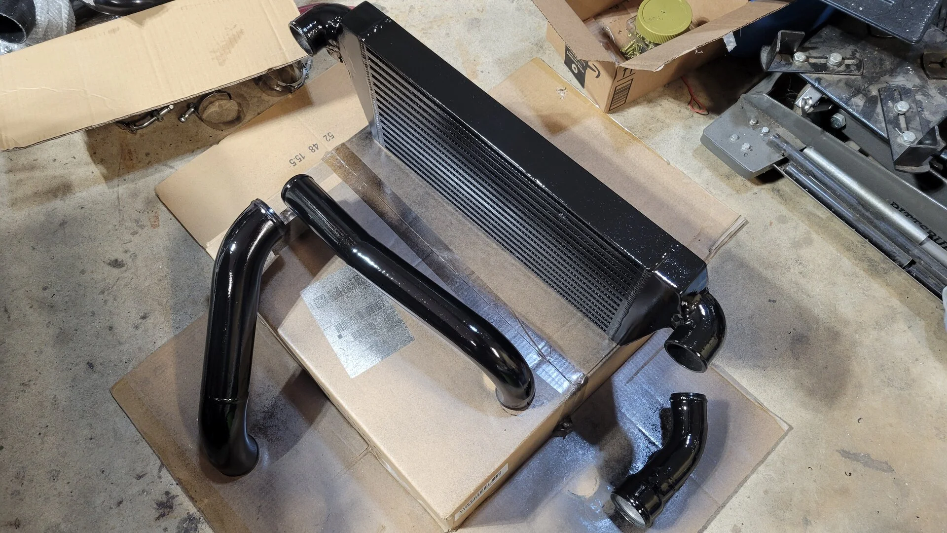

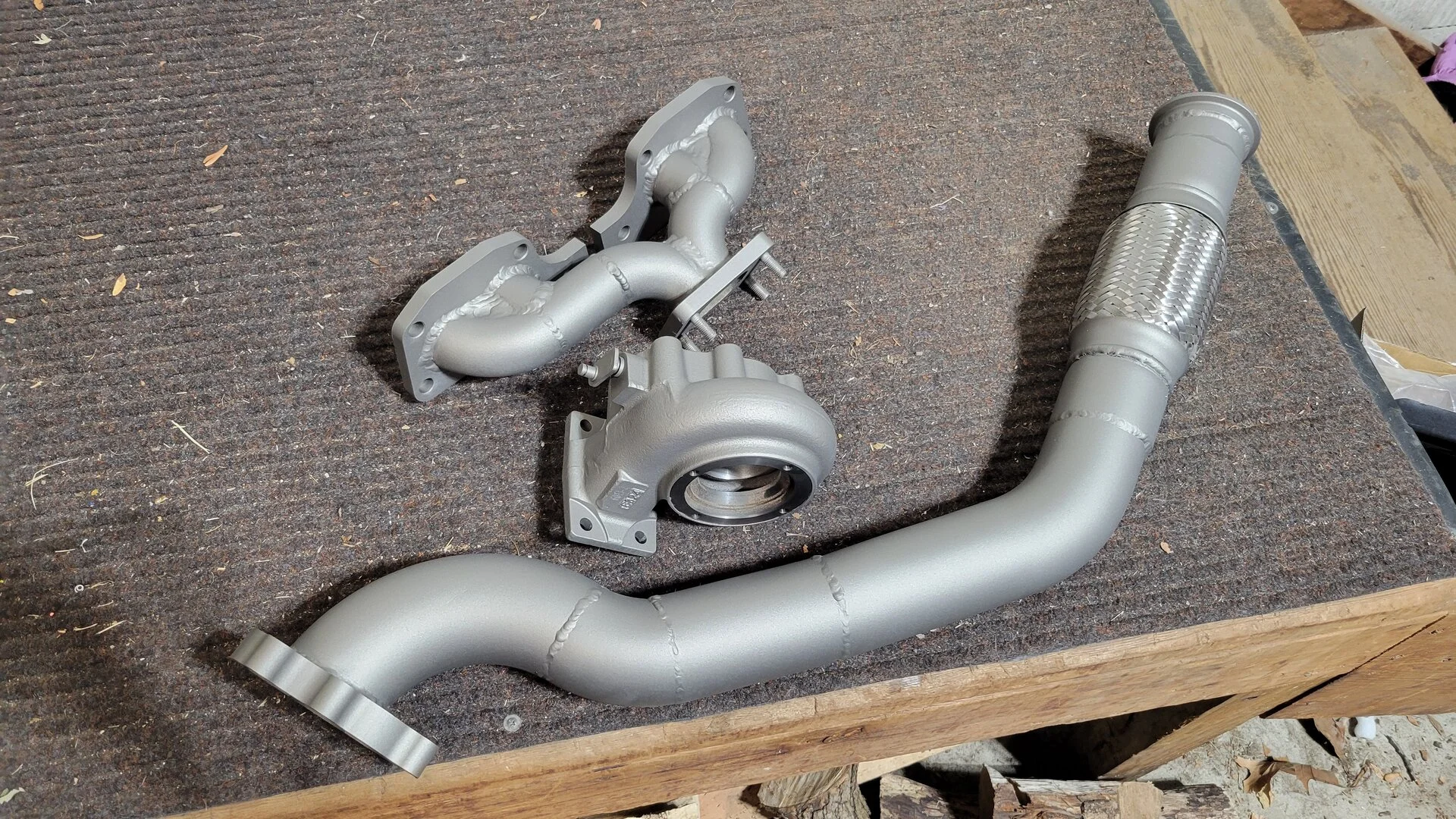

Off to get cerakote.

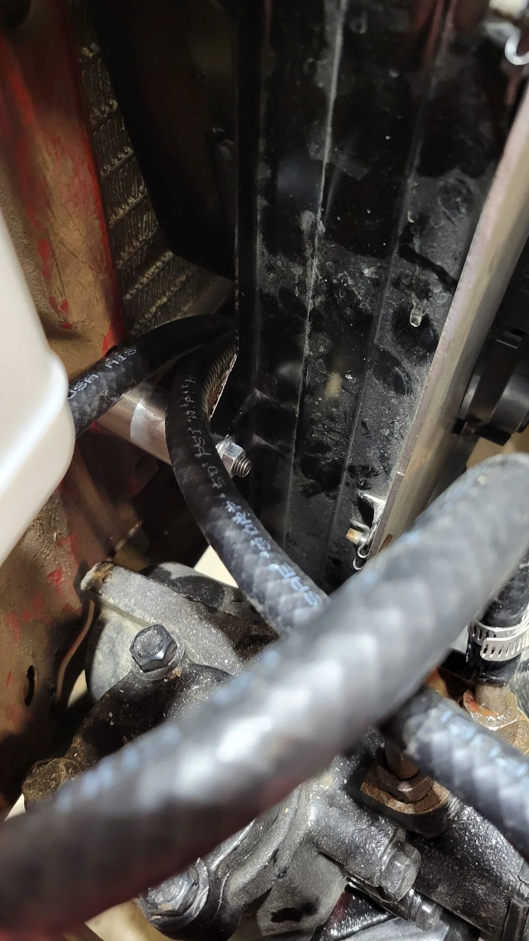

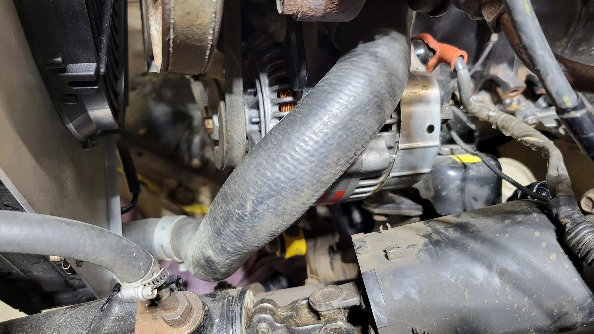

Lower radiator hose trimmed to fit with the radiator moved back 2 inches.

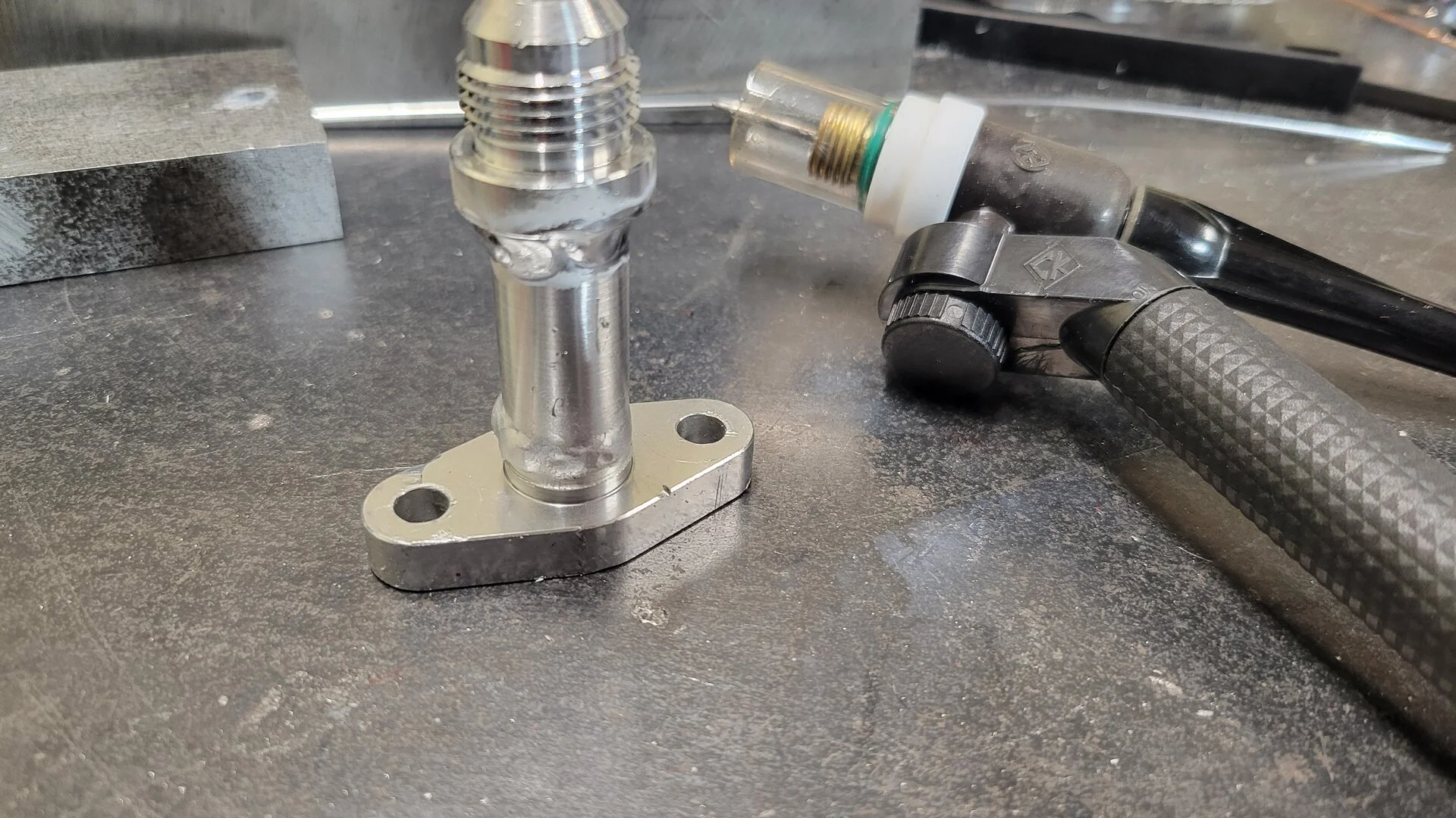

Modified oil drain flange to clear compressor cover bolts

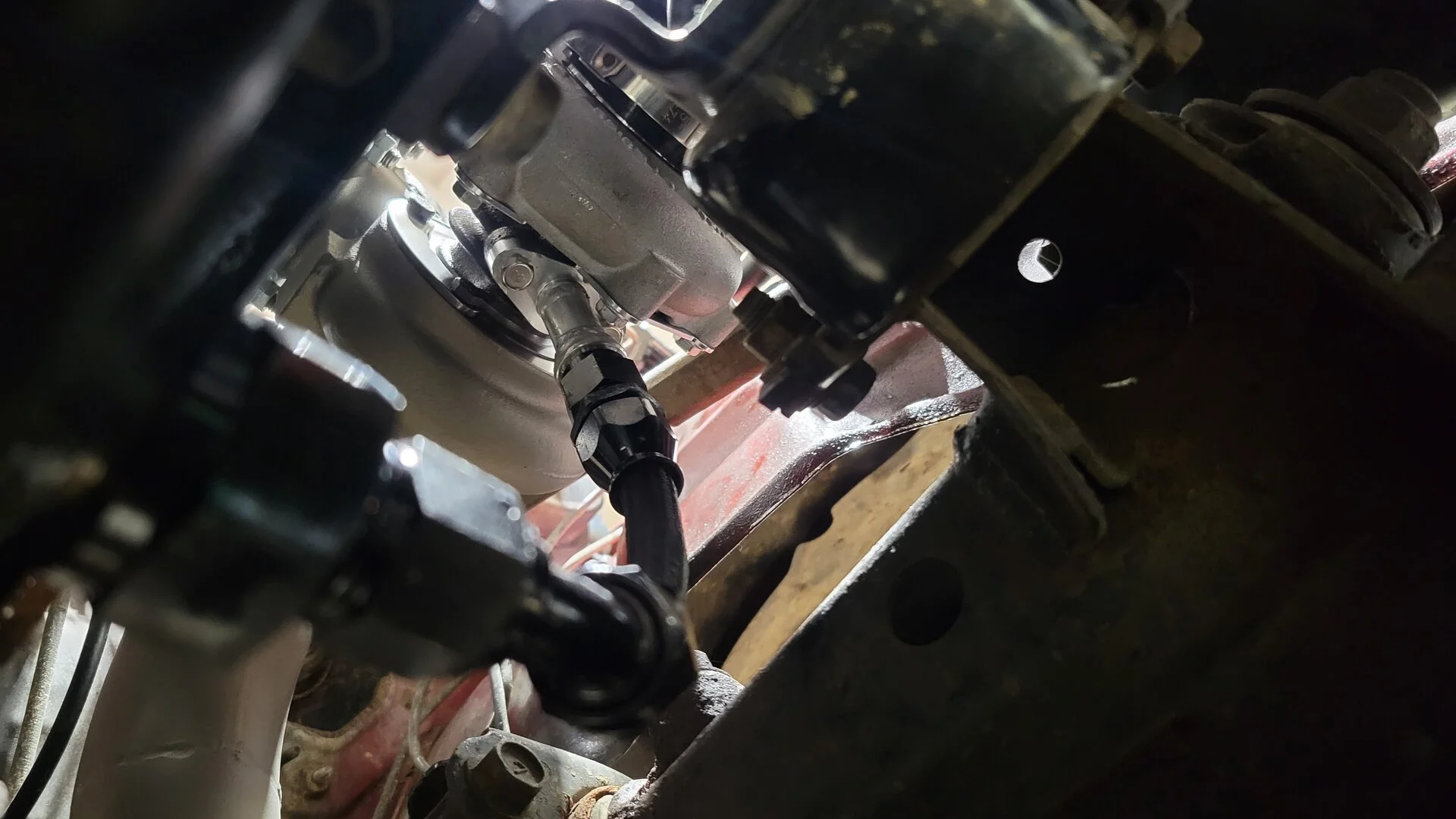

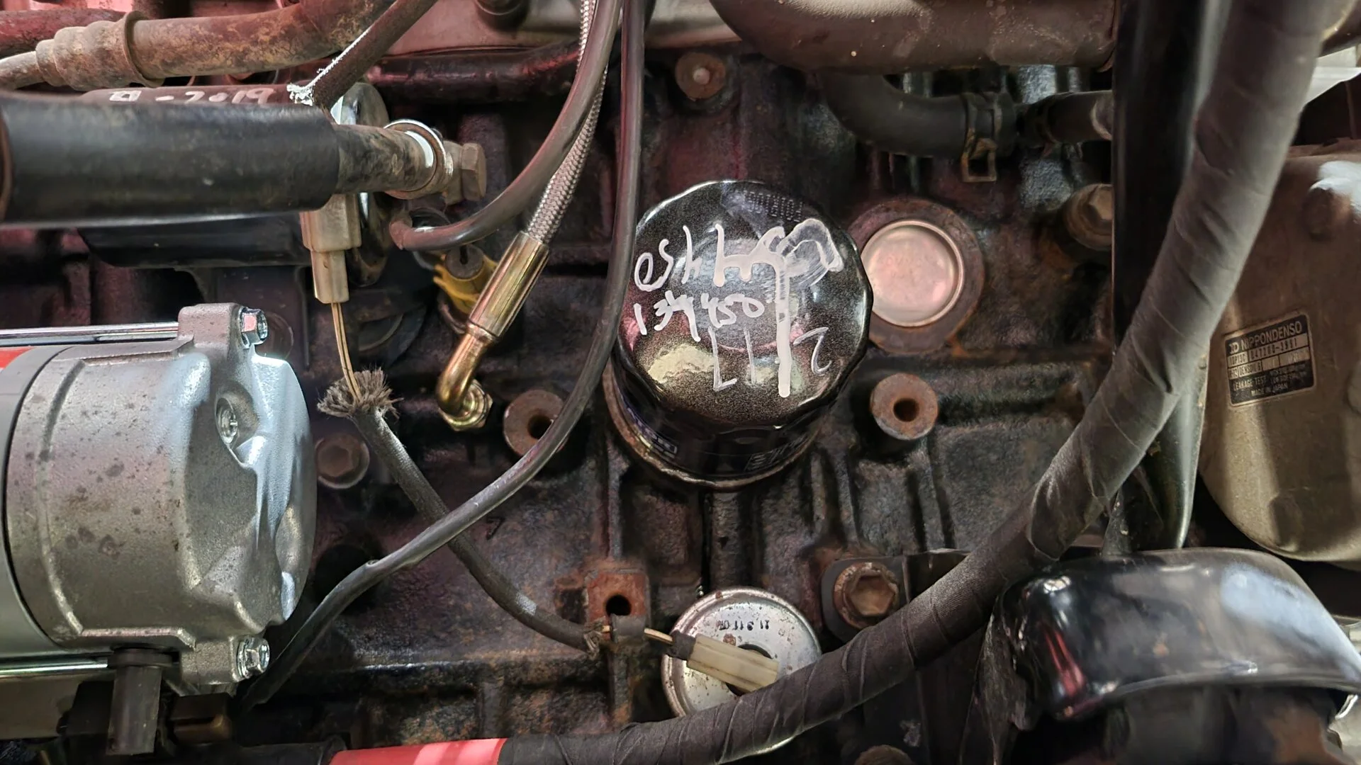

134450 miles. Oil supply line is tight

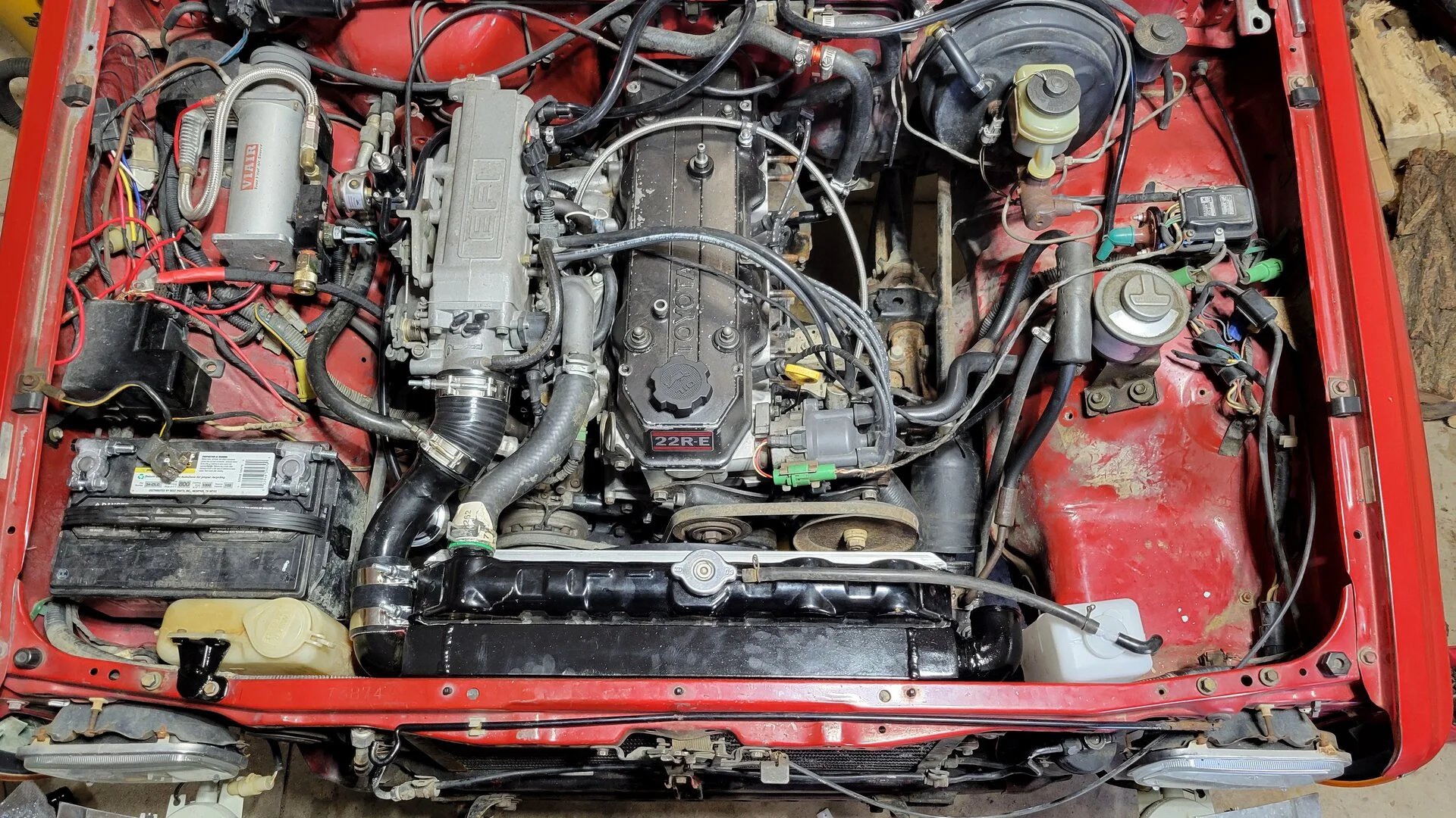

Coolant system done minus wiring fan.
Cold air side done.

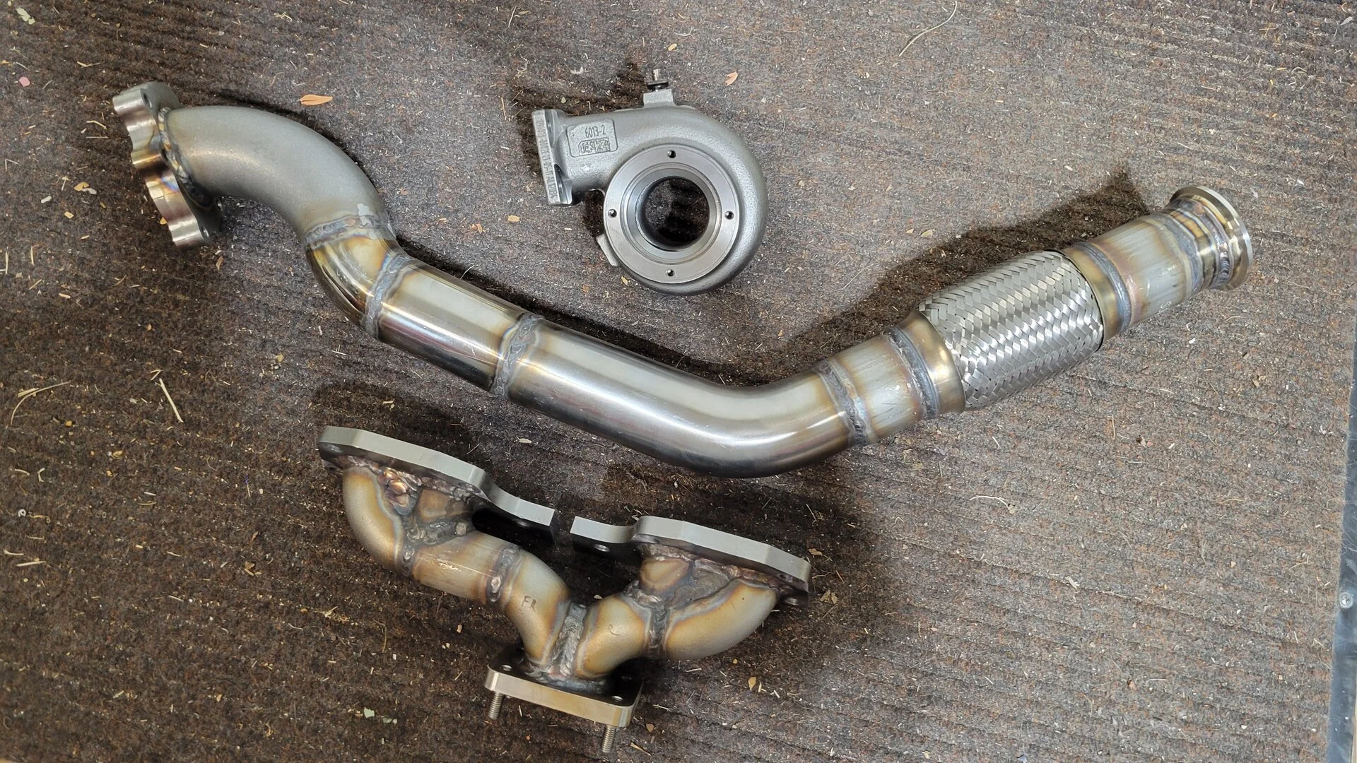

Waiting to get exhaust parts back and tackling odds and ends

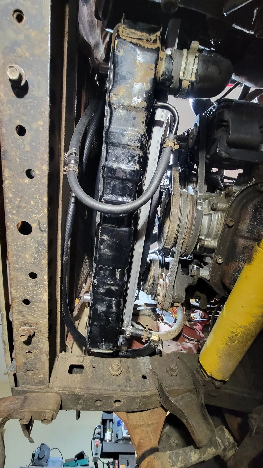

Under shot showing the spacing between ac condenser intercooler and radiator
Cerakote titanium. The end is in sight! AN fittings in the mail for oil catch can. Need to finish wiring and finish the oil drain but I'm waiting on new CK torch parts.

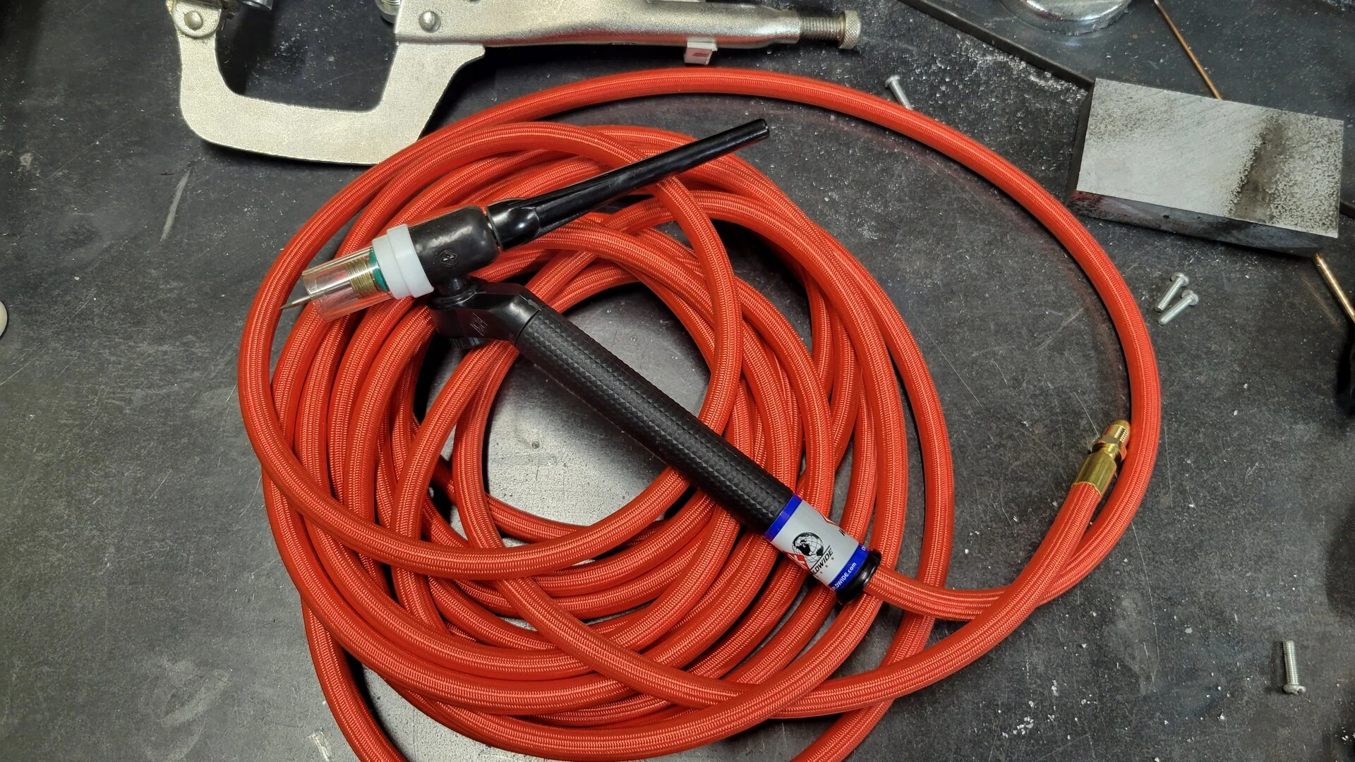

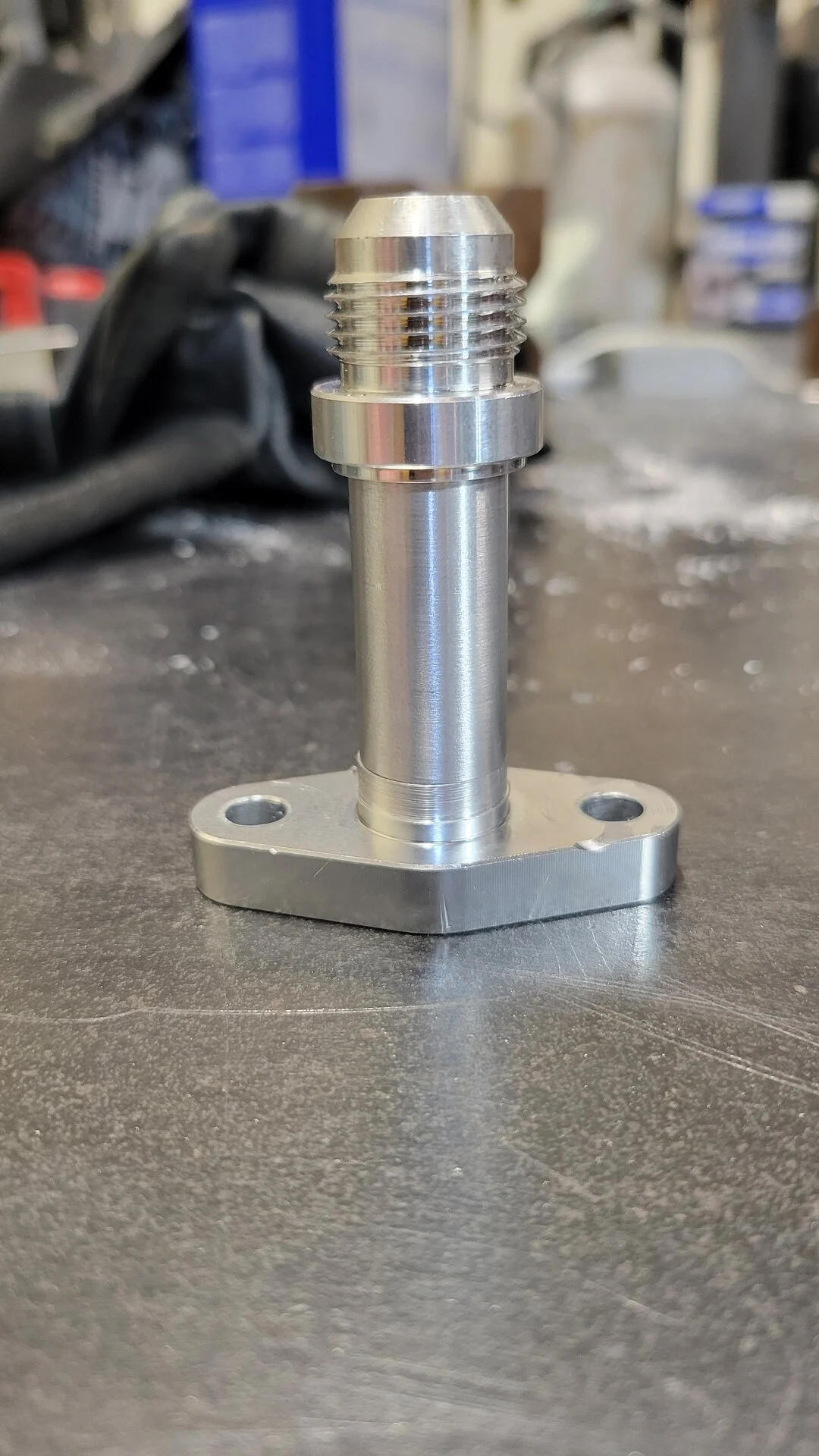

Back from vacation and welder parts came in. Oil drain flange done. One less thing.
cerakote looks cool. Where did you send that to have it done? How much?
Coworker has a side gig and he only charged me $100. Not sure what other powder/ceramic coating shops going rate is

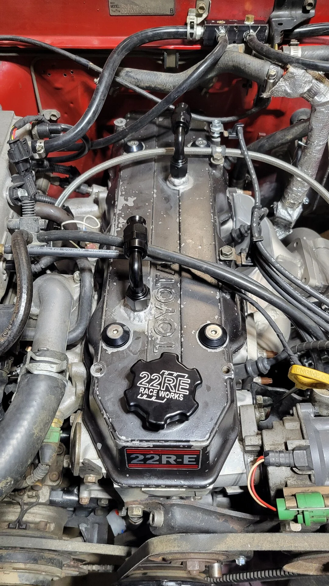

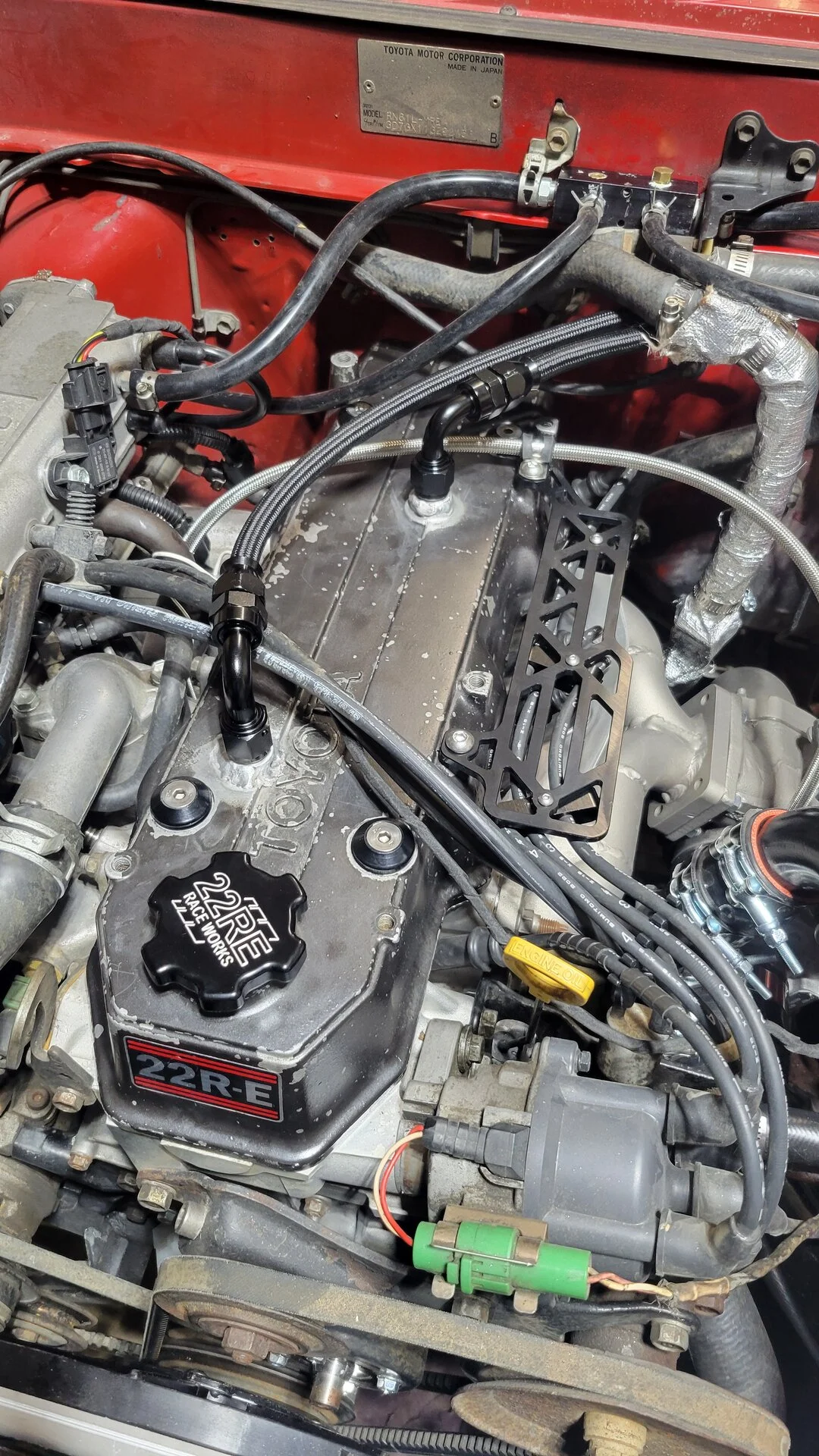

Valve cover AN bungs and some valve cover goodies from Jim.

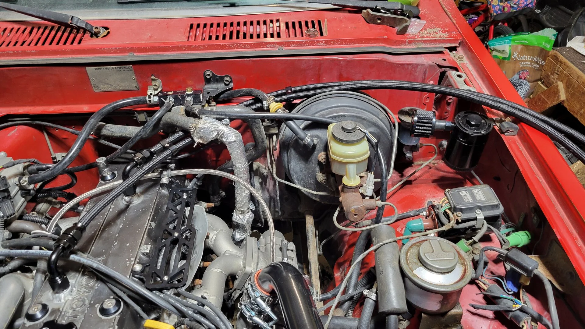

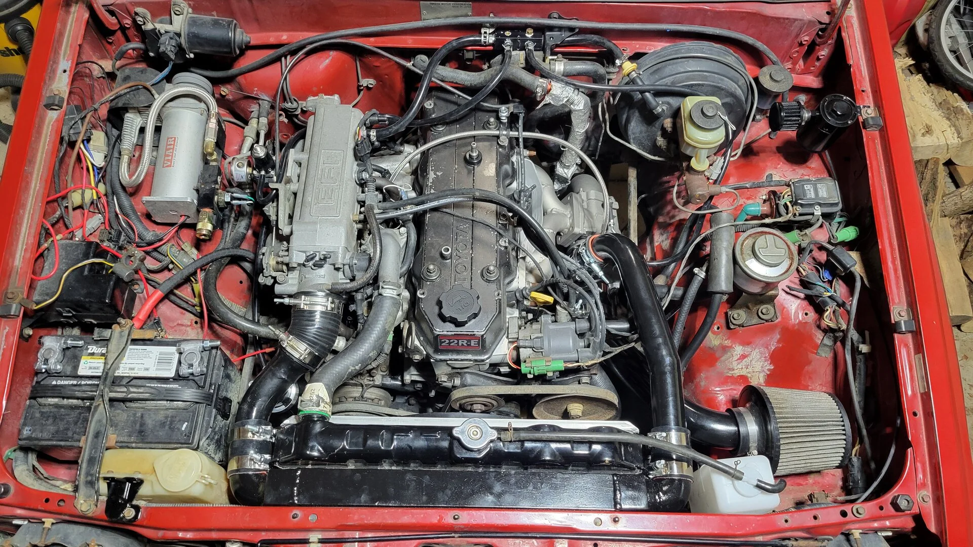

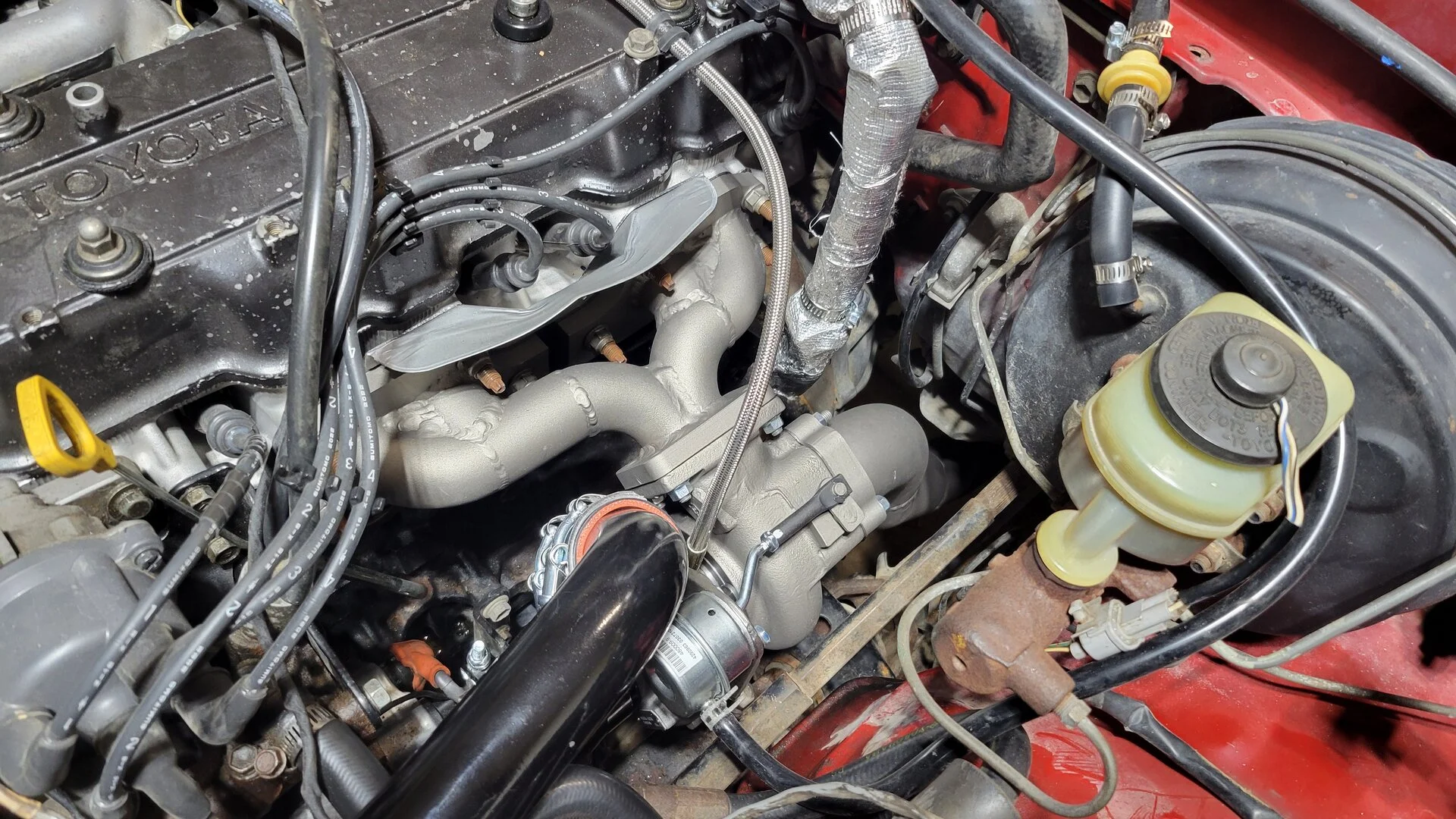

I see what looks like a vacuum manifold on the firewall with hoses to fuel regulator maybe, brake booster and down near the turbo? How will the catch can be plumbed in? I'm trying to take it all in.

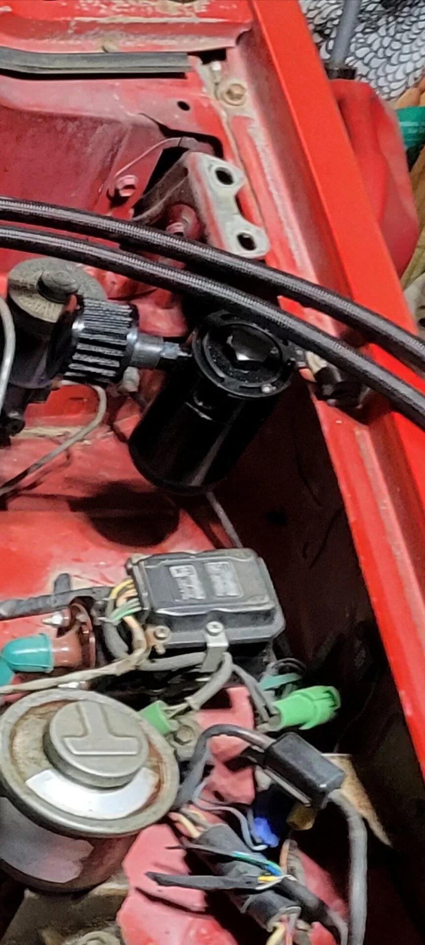

This can has 2 inlets, a baffle, and a filtered outlet with drain on the bottom. The can also unscrews
But you're right about the vacuum manifold to brake booster. 1 line to the wastegate, 1 line to the blow off valve. Fuel pressure regulator vacuum line is in the stock location off the intake manifold.
So no vacuum to the catch can? Basically a vent for crankcase pressure?
I'm looking forward to how this performs.
Correct. Boost will increase blowby and instead of dumping oil, exhaust and water vapor into the engine, you vent it to atmosphere. Closed crankcase is an emission regulation for on highway since the 1960s. All heavy duty off highway diesels run open crankcase vents
