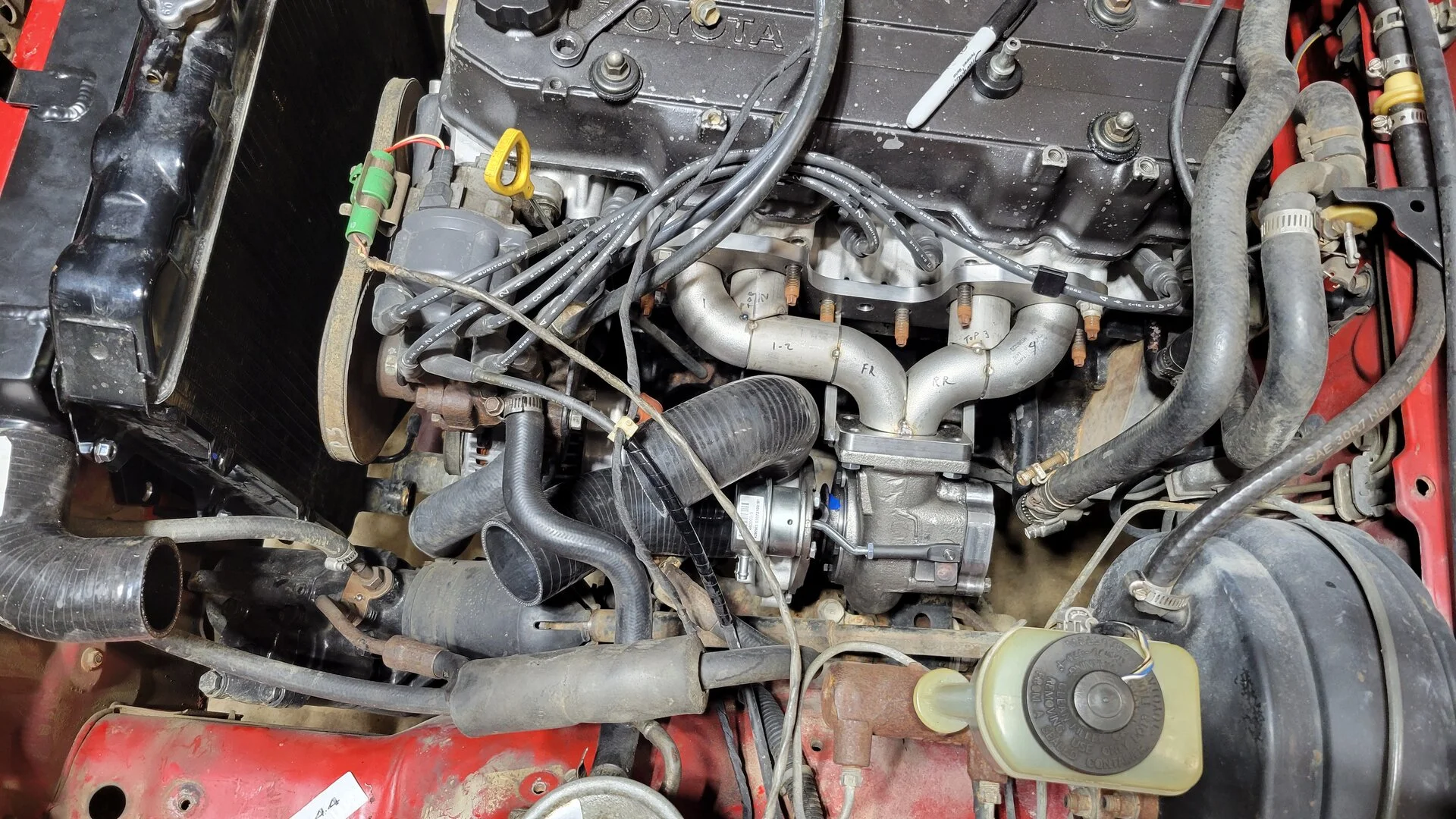

To do this winter:
Exhaust manifold and down pipe
Intercooler piping
Intercooler mount
Radiator standoff and electric fan wiring
Turbo intake
Crankcase vent
Oil supply/return line

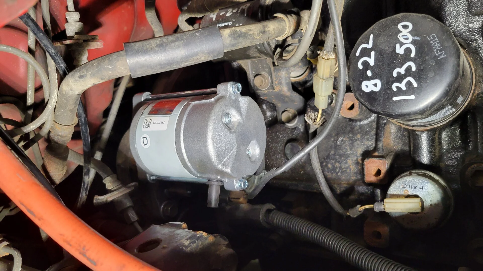

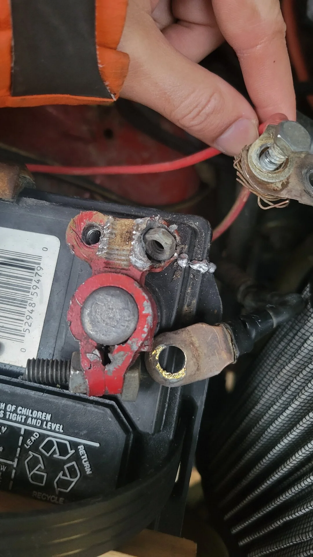

Starter tried to set me on fire. Replaced with OEM Denso reman 1.4kW and 1/0 cable. Cranks at 900rpm now
So the starter was actually fighting against hydrolock!

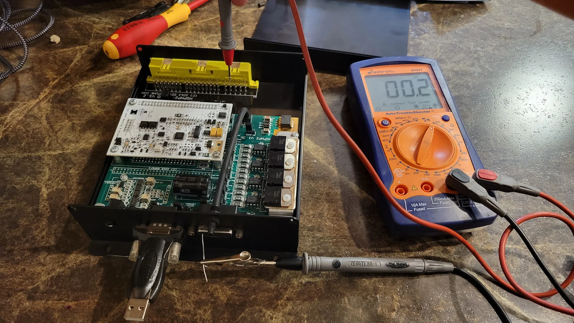

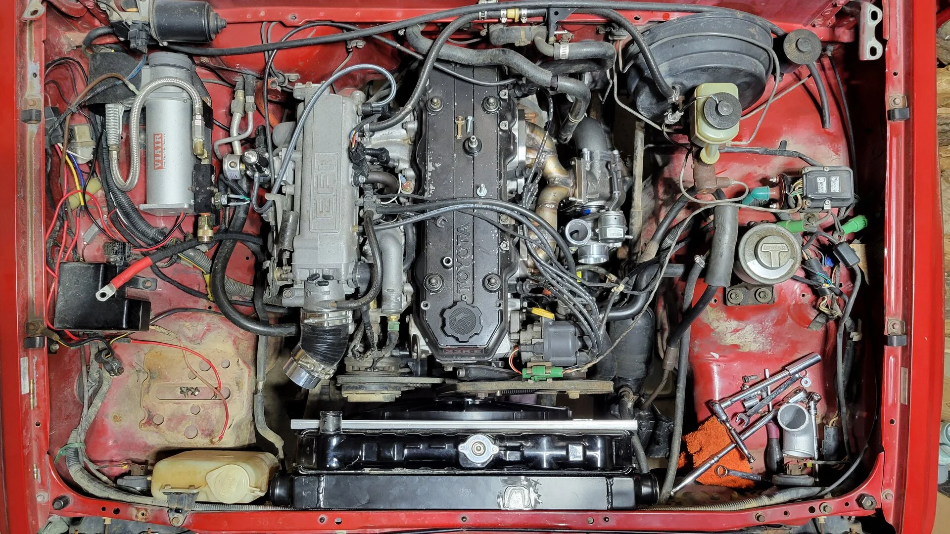

Megasquirt injector driver failed and flooded cylinder 4 with fuel.
Going to limp it into the garage on 3 cylinders and then start the winter project of turbo and MS2 repair.
Hopefully the head gasket is alright

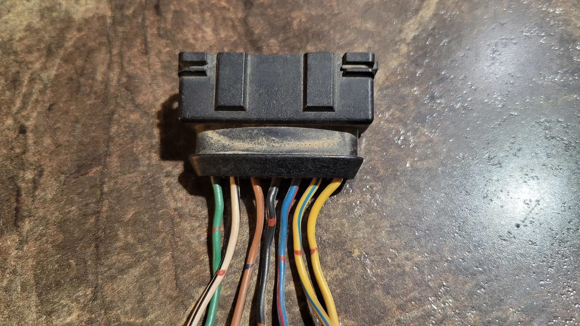

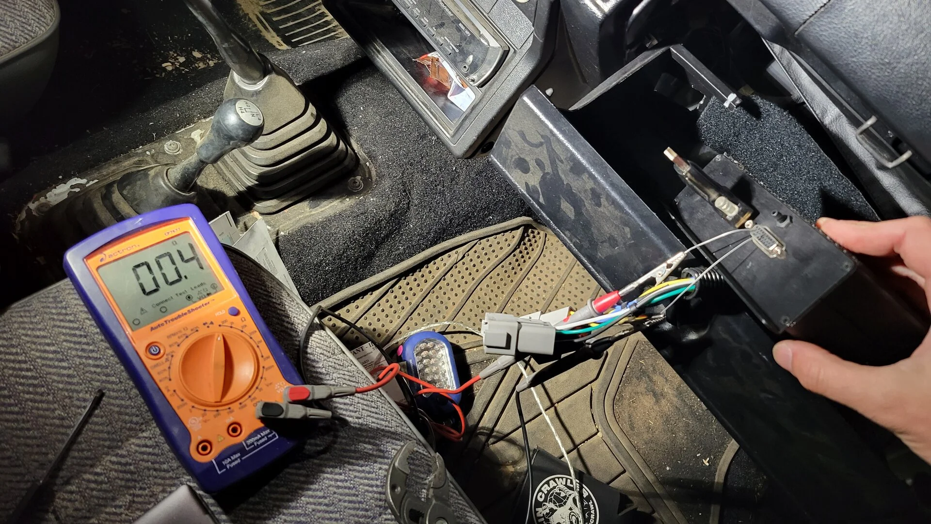

0.4 ohms and continuity between injector driver C output and chassis ground when the MS2 is powered by 12V
Figured out that the MS2 board was fine.
Driver C is not only connected to pin 18 out of the option port, but also connected to the ECU connector for the cold start injector. I had cut the connector off and taped the ends but it must be shorted to ground. I was also able to rewire the fuel pump correctly so now MS can actually turn the pump on/off instead of always being on. Pin 1 to Pin5 from the AFM, mine was green and blue/red.

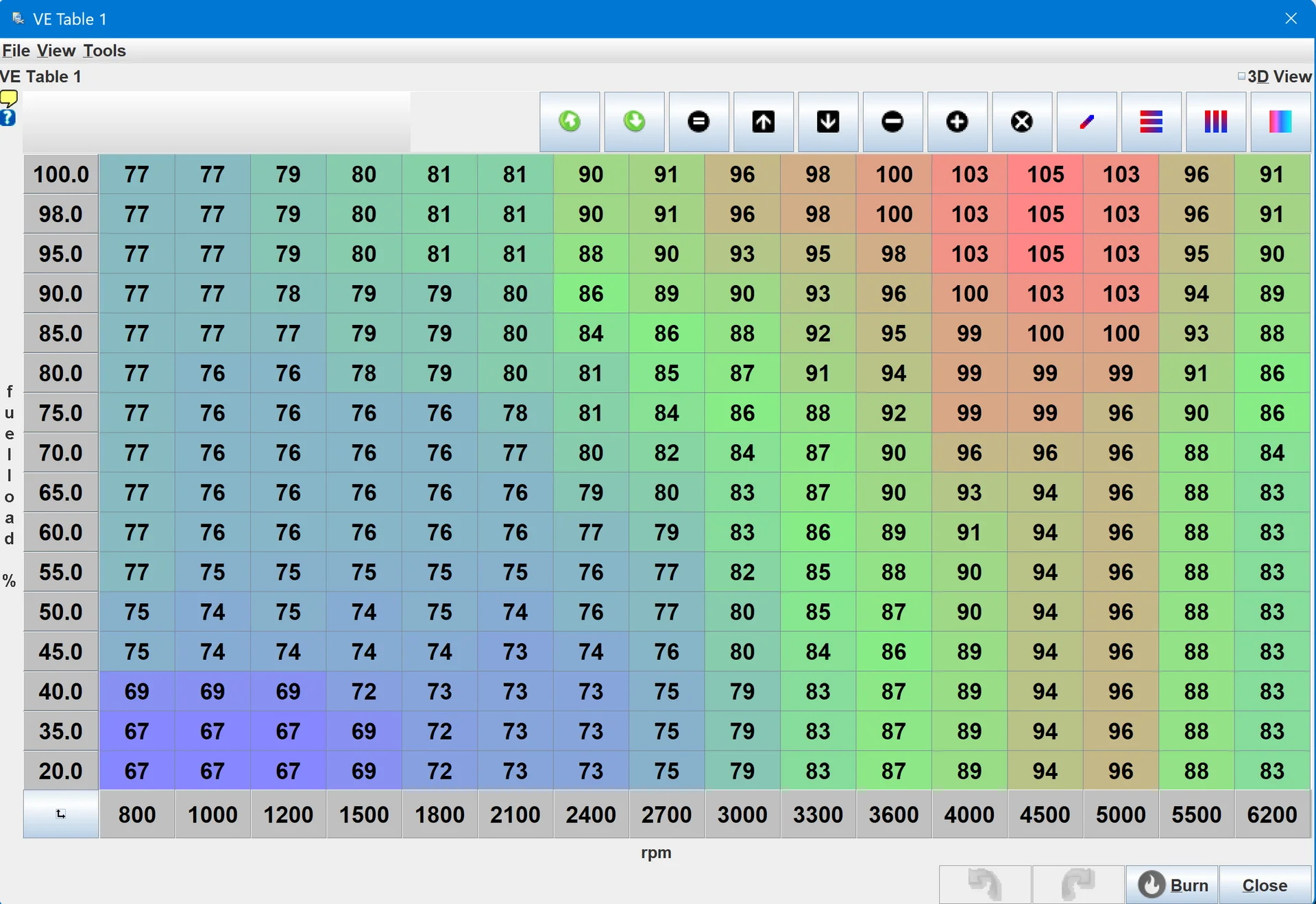

Pulled Injector bank A,B,C pins out of the factory connectors to avoid shorting any other cylinders and it fired up. My VE table was WAY off (25-30%) and I'm pretty sure that cyl 4 has been stuck on since installing the 550s but now does it sure run smooth. Wideband is less noisy. I can actually run leaner than 13.00 and it doesn't randomly misfire.

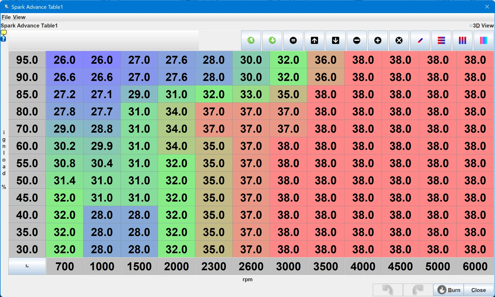

I was also playing around with idle timing and recorded a data log sweeping timing from 12deg up to 40 deg. I think as expected, engine RPM increased as I held AFR and increased timing. I found that the engine RPM stopped increasing around 34deg and consider this maximum brake torque timing for idle. I set my idle timing to 28 deg and its been running pretty good.

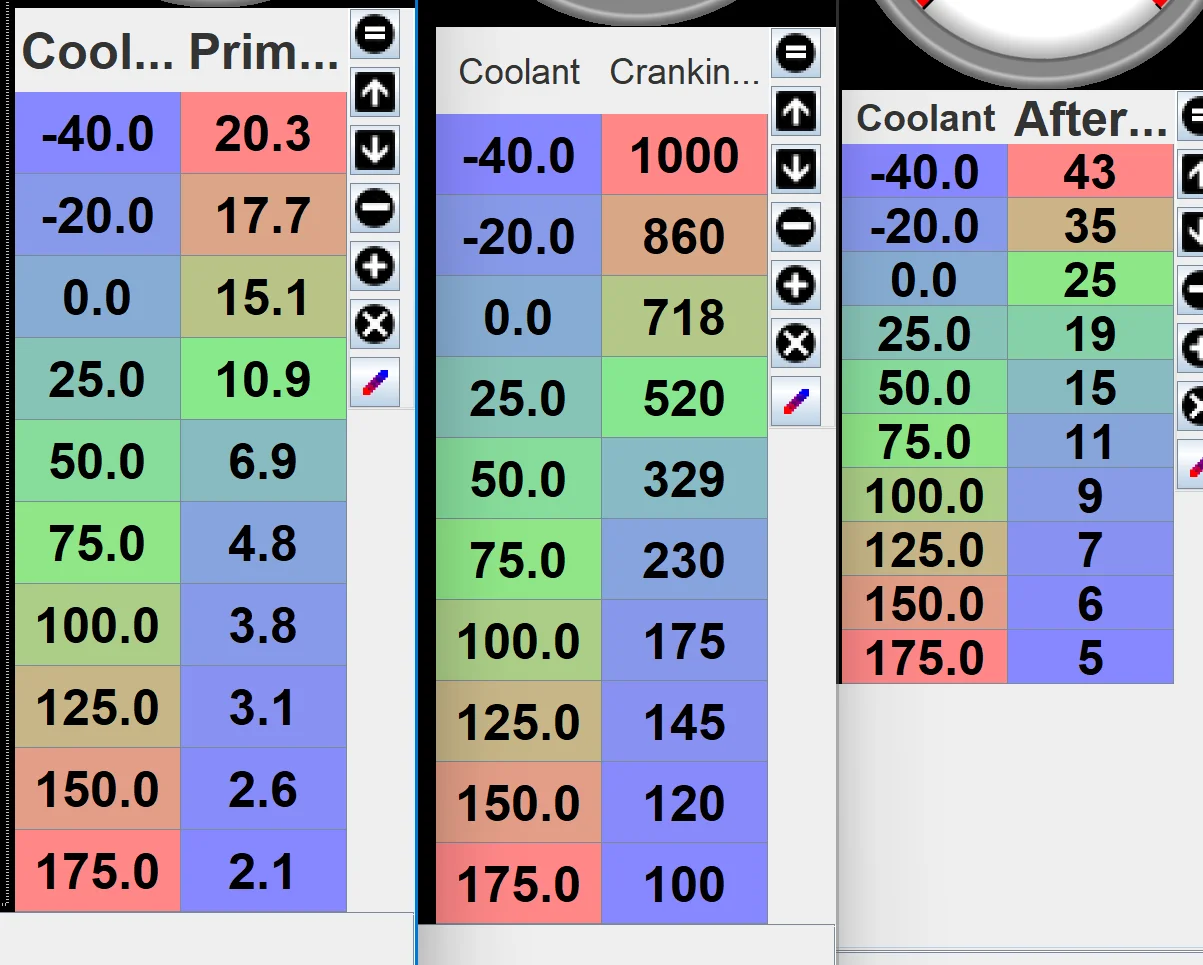

I also set my prime pulse to be equal to the cranking PW to give the ports 1 shot of cranking fuel.
Prime pulse = Cranking fuel % x 175F pulse with (2.1ms in my case) / 100.
Current VE table when all injectors work.
Timing without boost

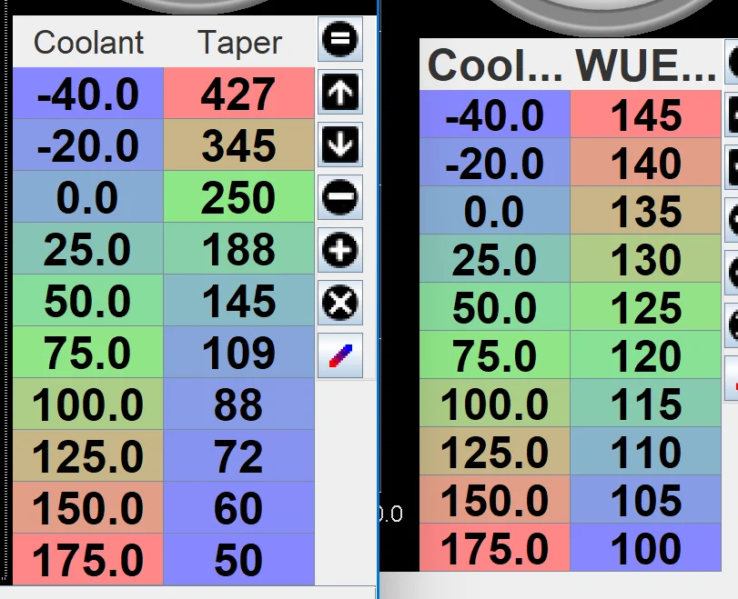

Prime, crank, after start enrichment, after start taper, warm up enrichment

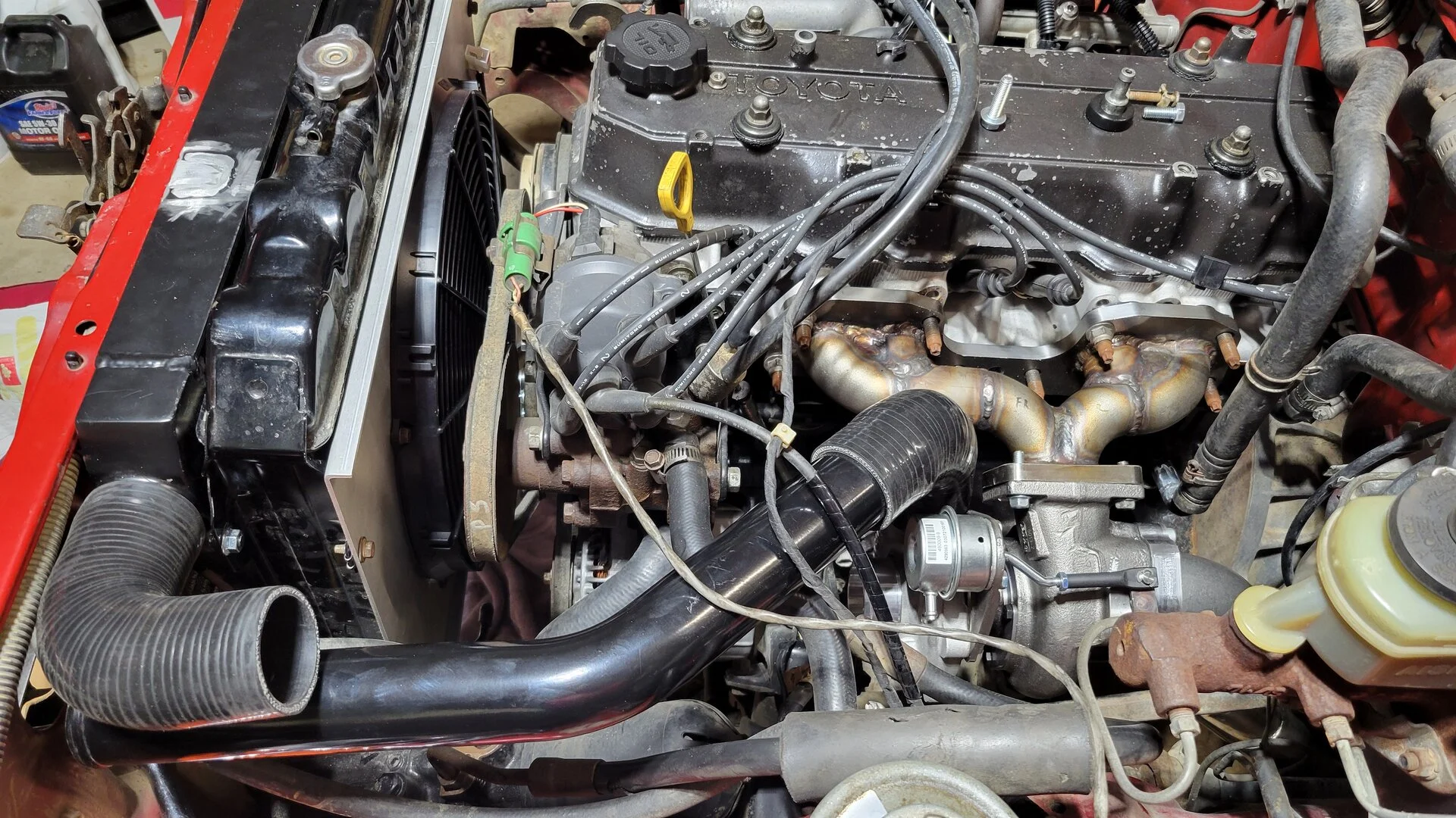

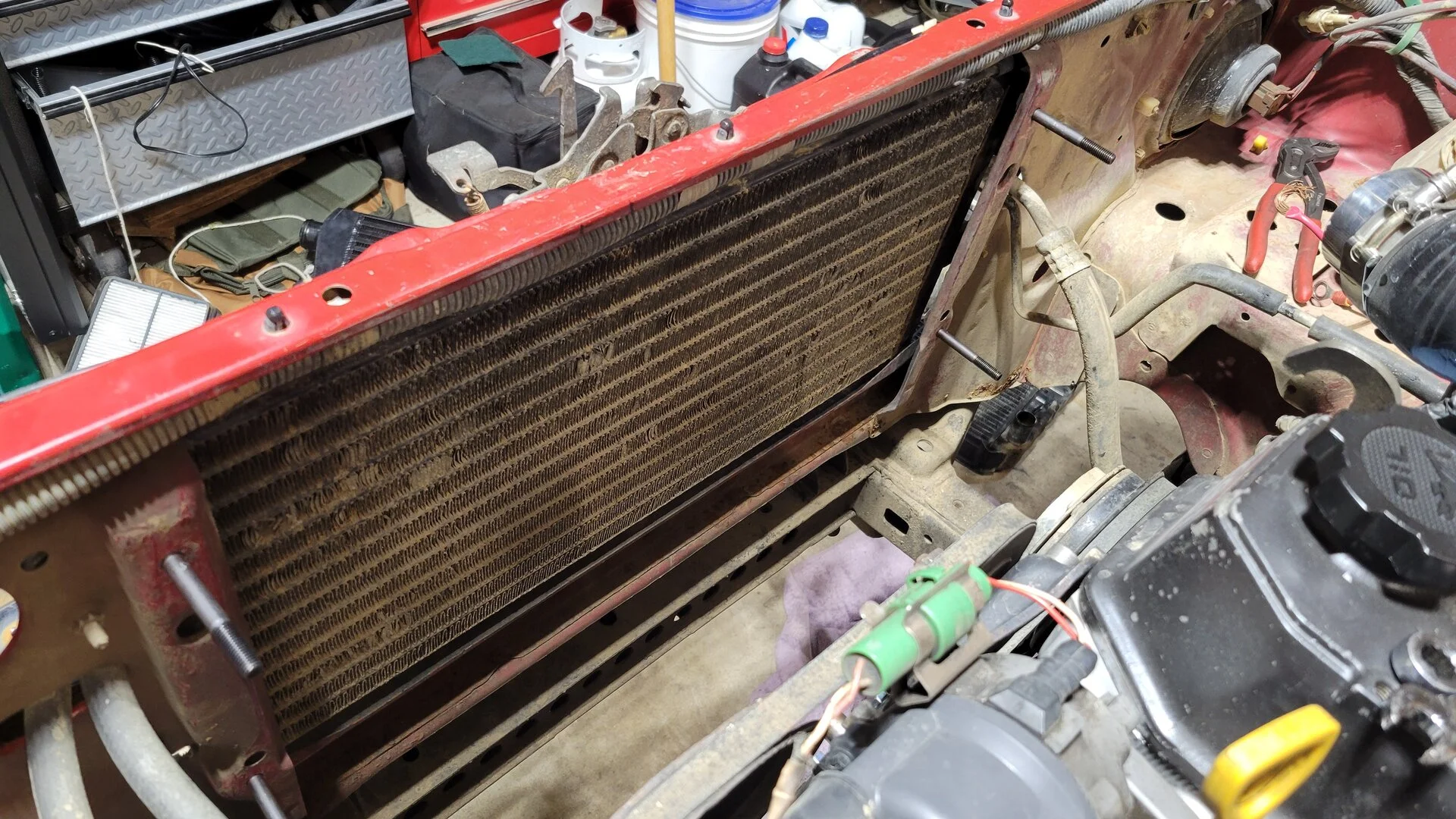

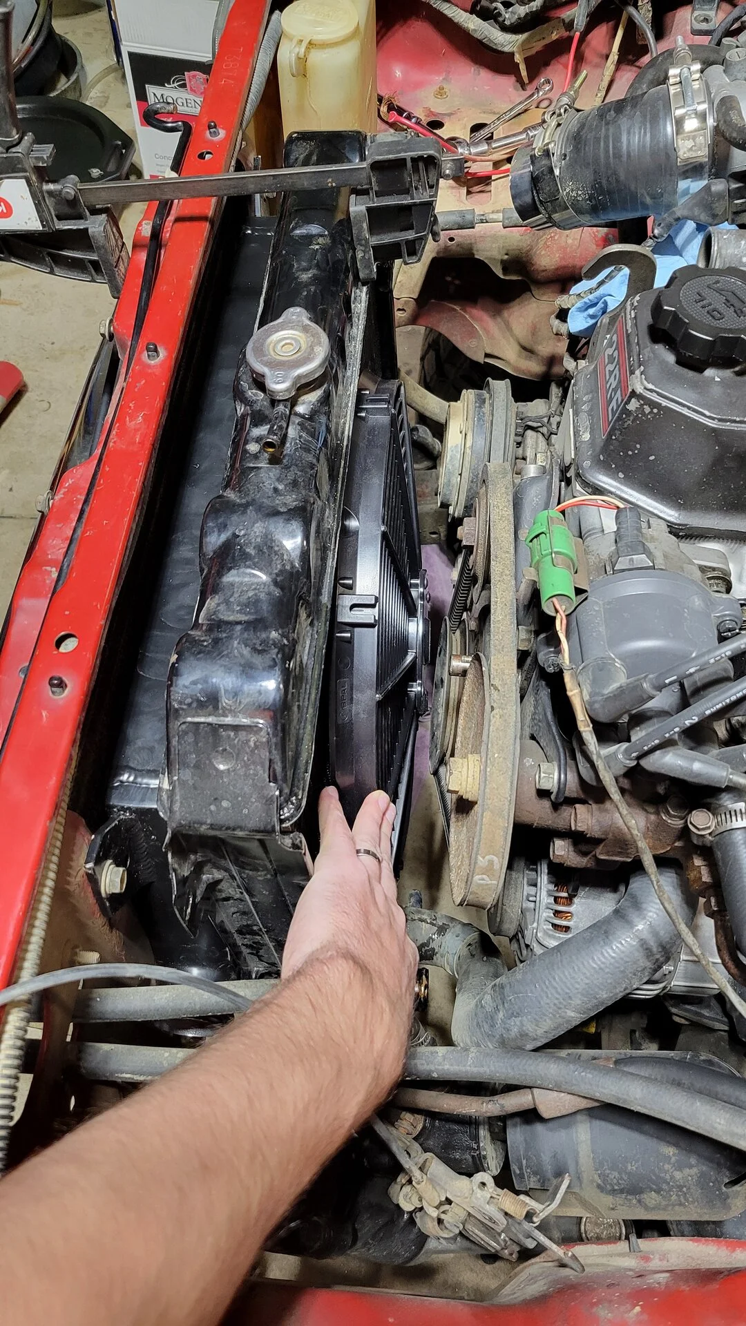

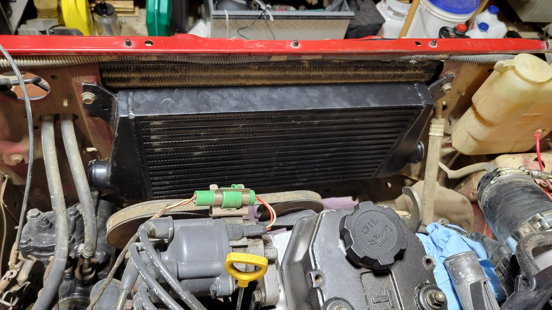

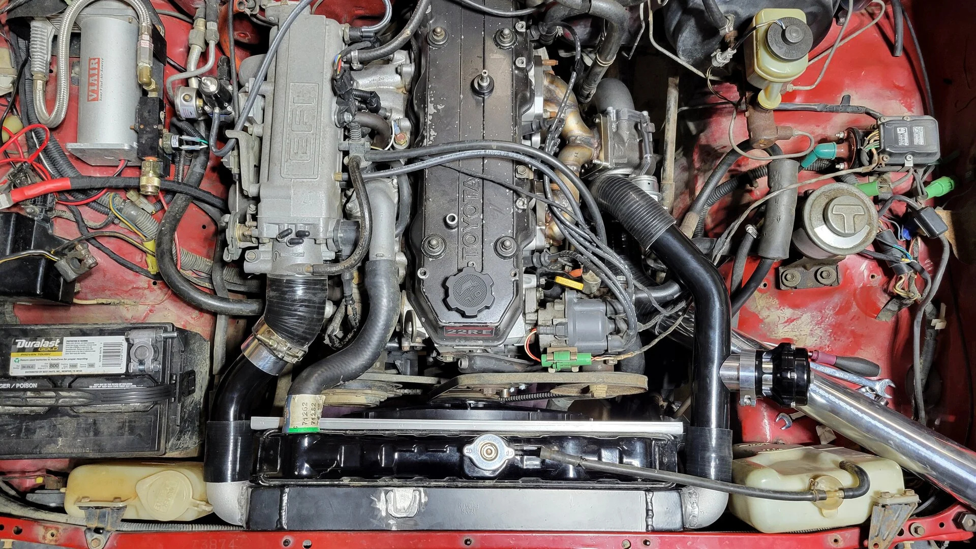

Mocking up cooling package depth. Looks like my intercooler + 3 row radiator + spal slim fan will fit.
Goal is to keep AC while minimizing pipe length. Sacrificing slightly warmer MAT temps by mounting behind the AC condenser but significantly less pipe length and pressure drop

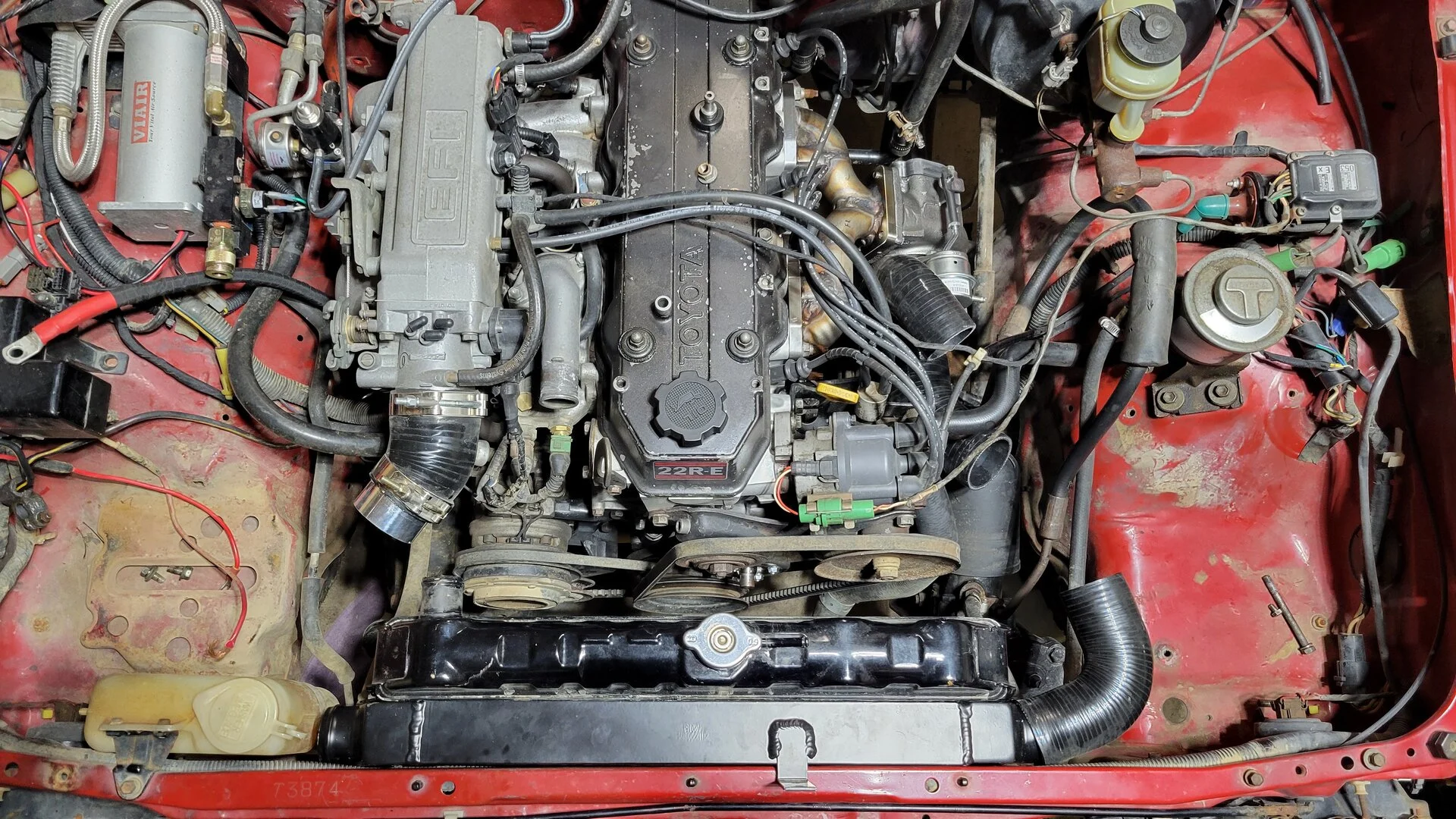

Studs and spacers for mounting the radiator and intercooler.

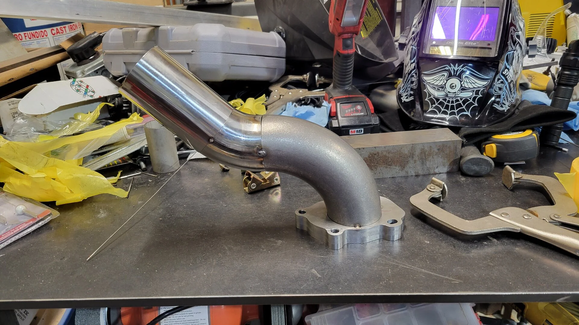

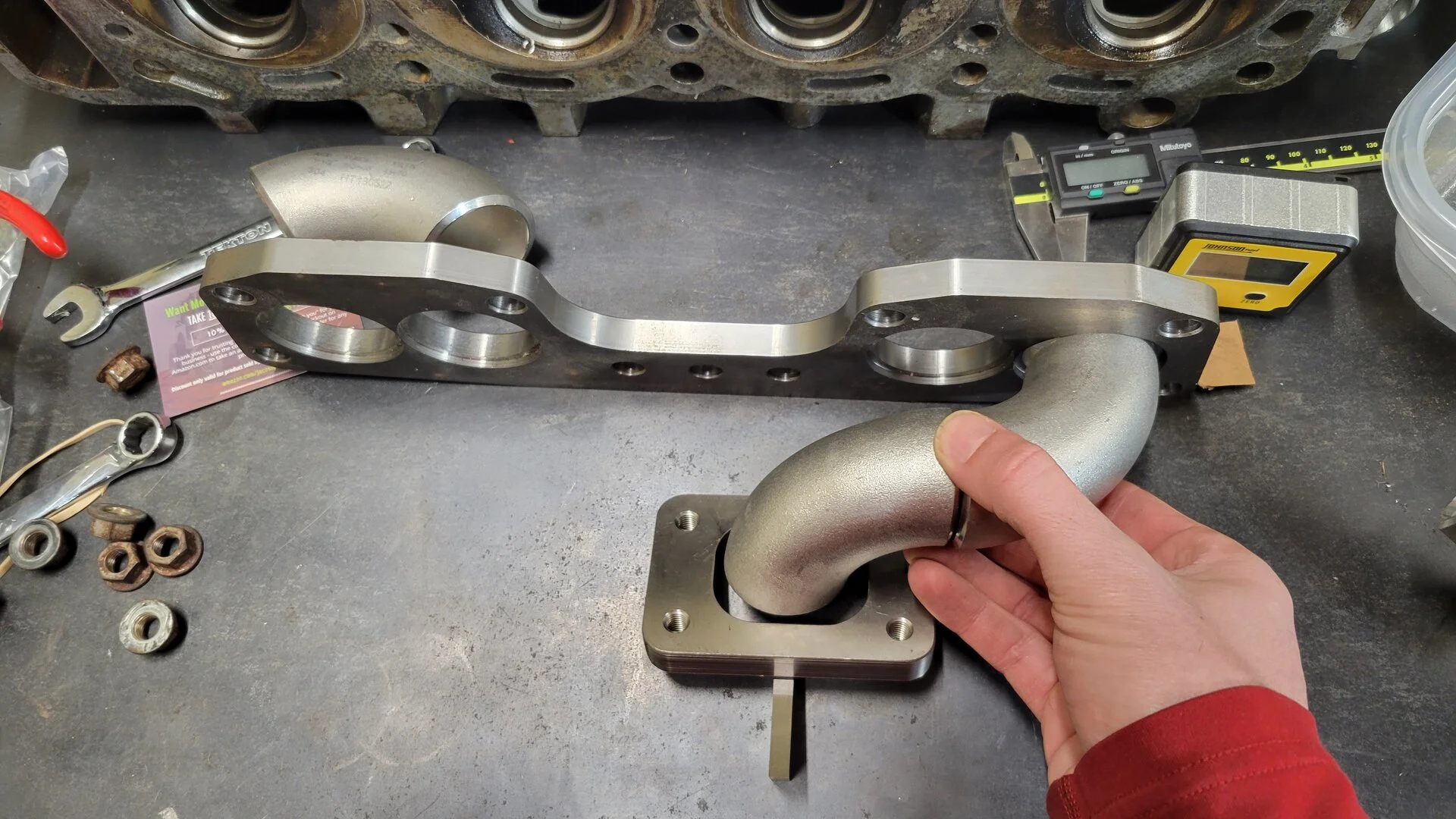

Cast 90deg elbows in the mail

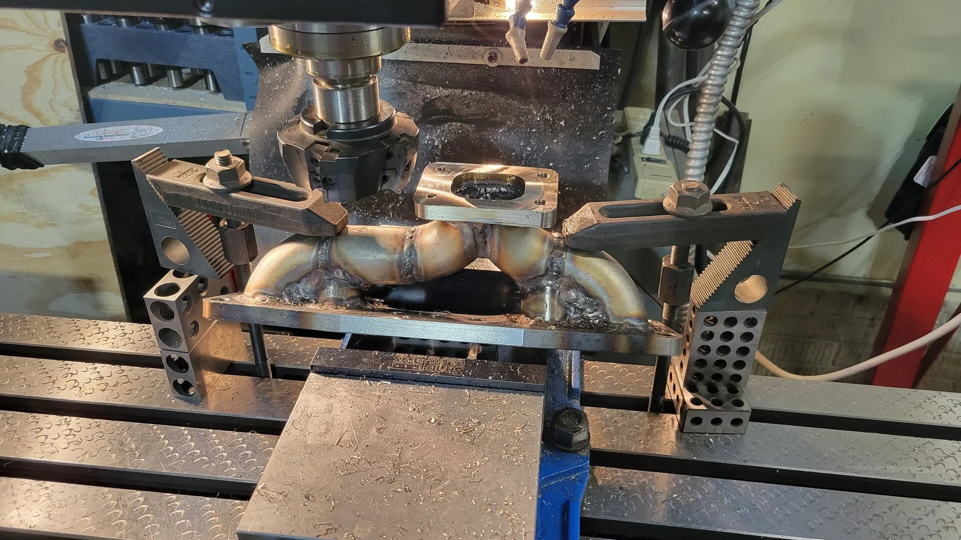

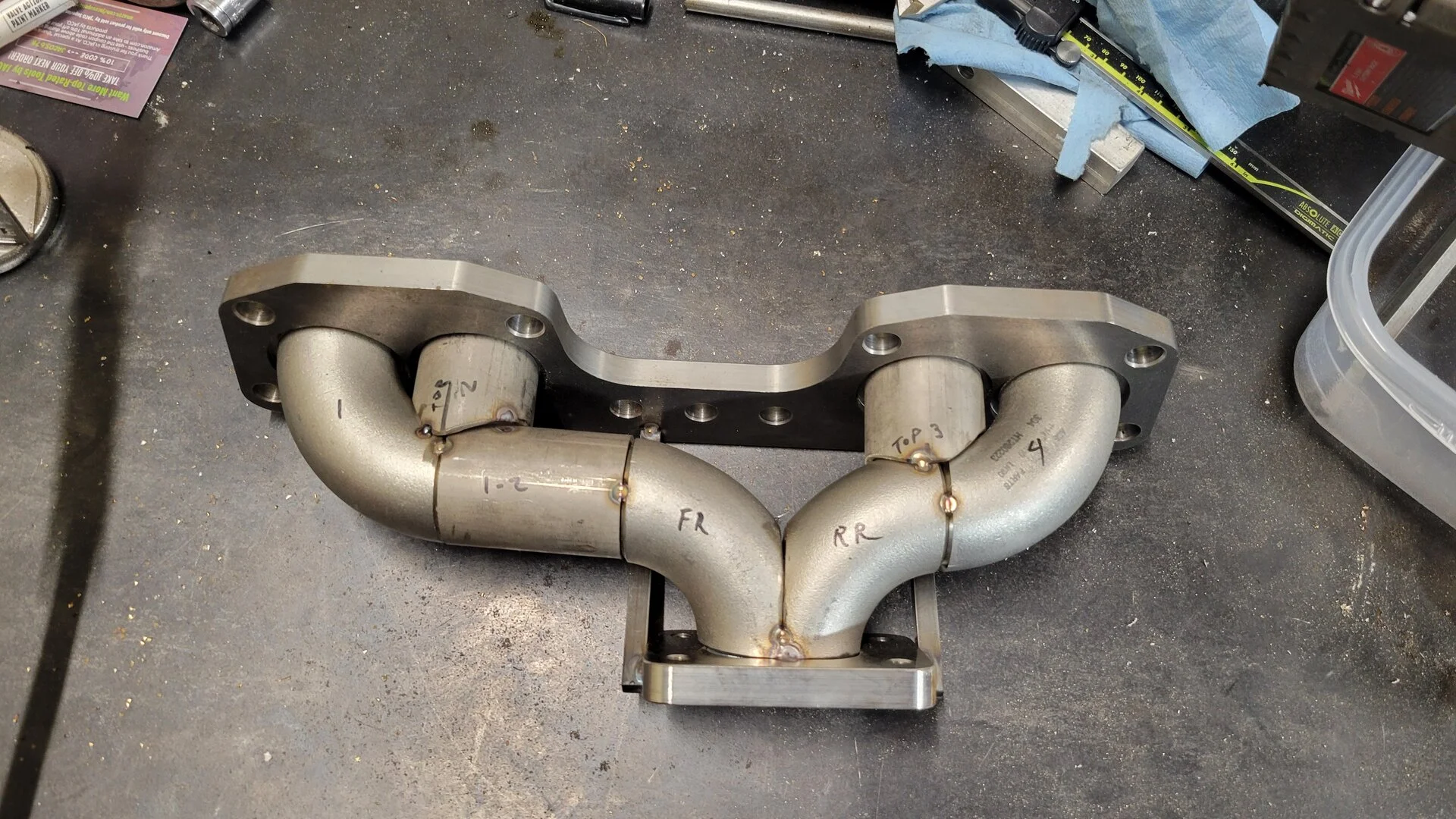

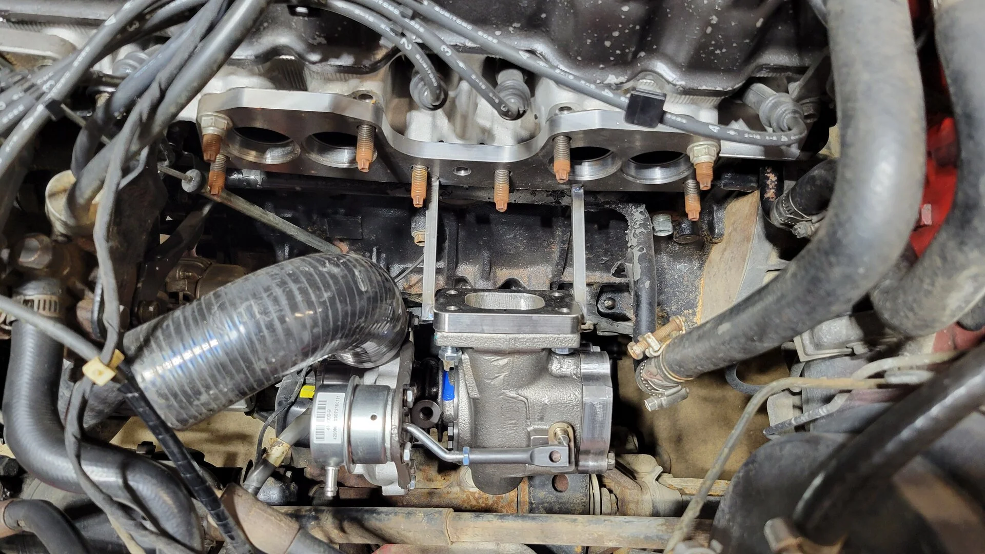

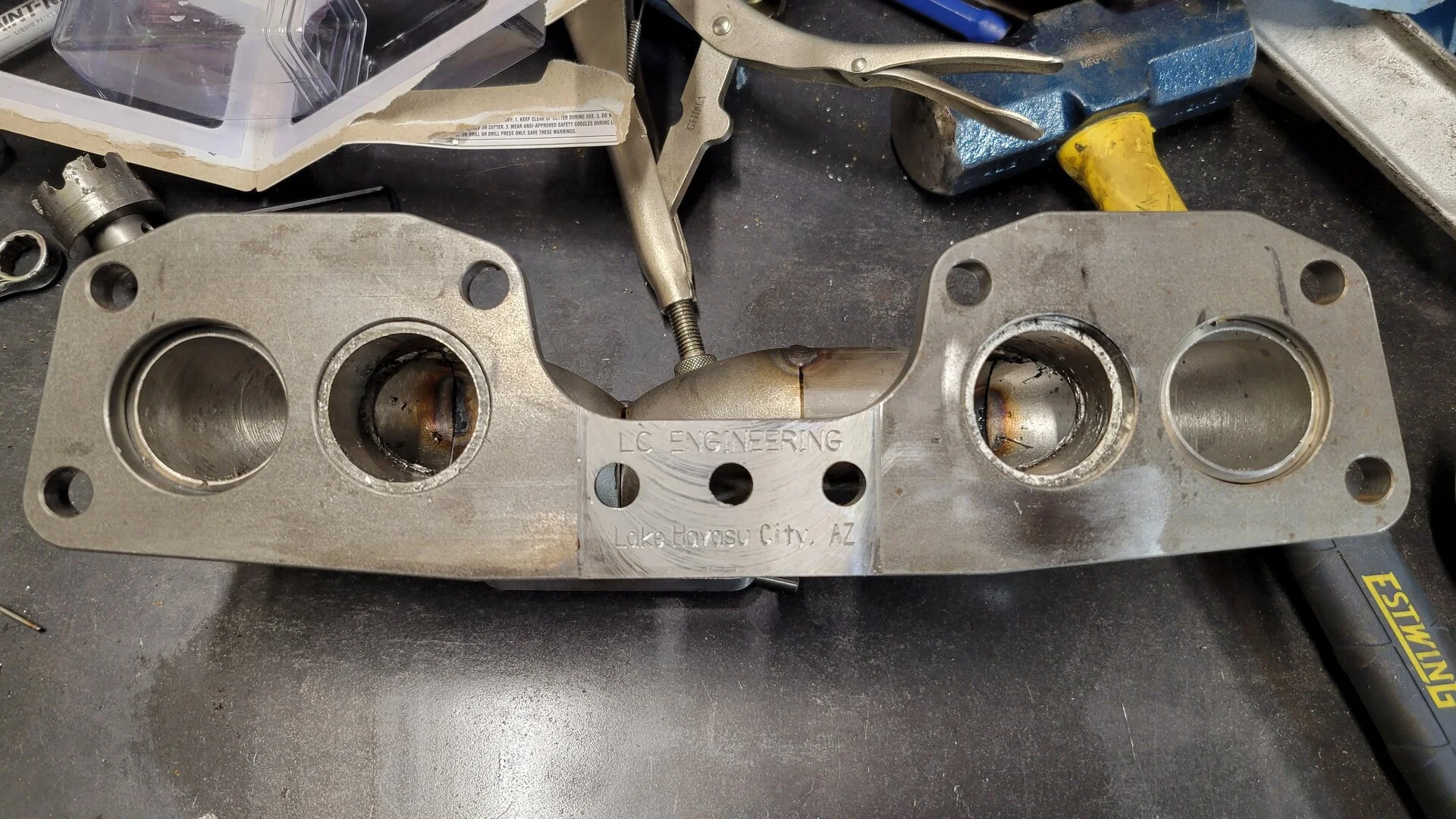

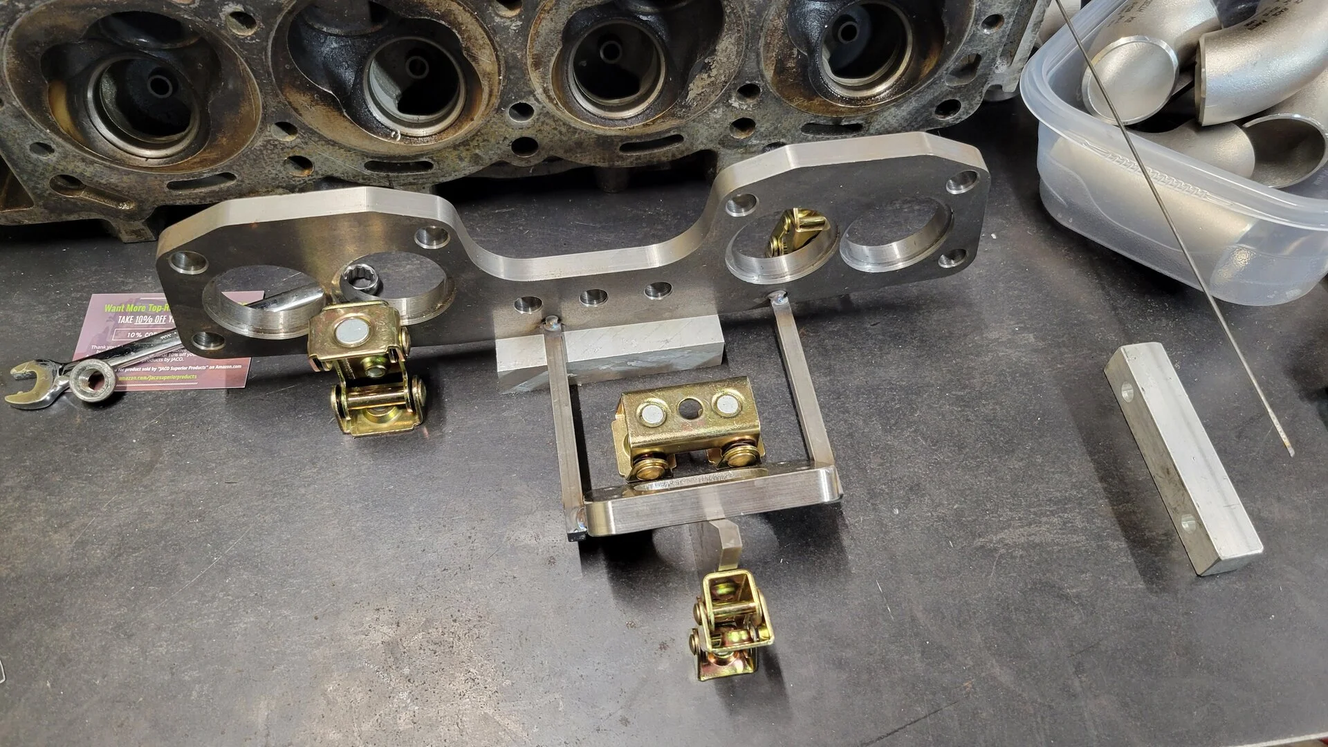

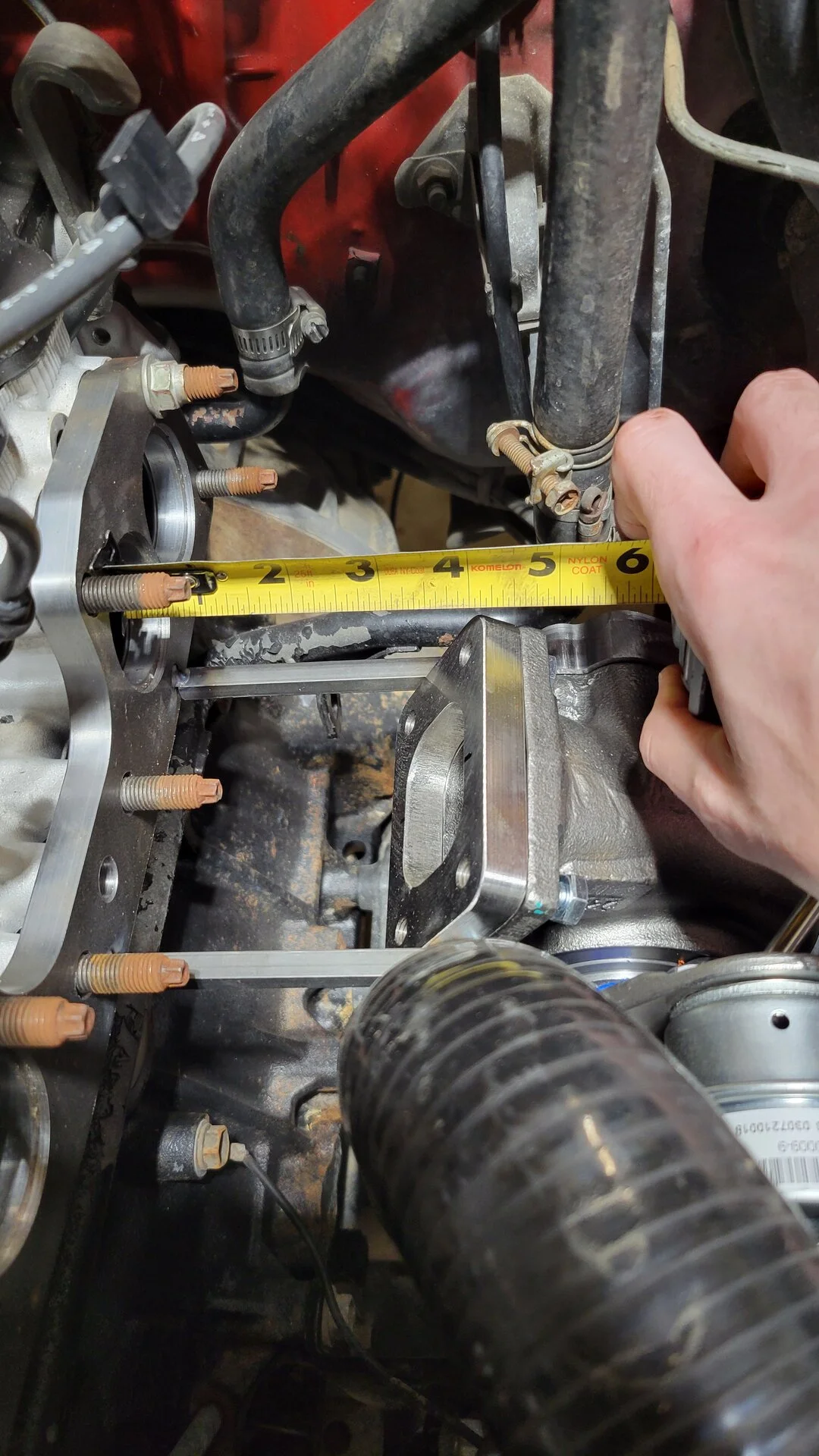

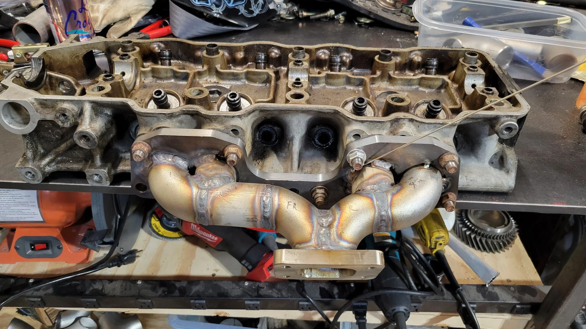

Was a good day. Tacked up to figure out where I need to drill through for port 2-3.

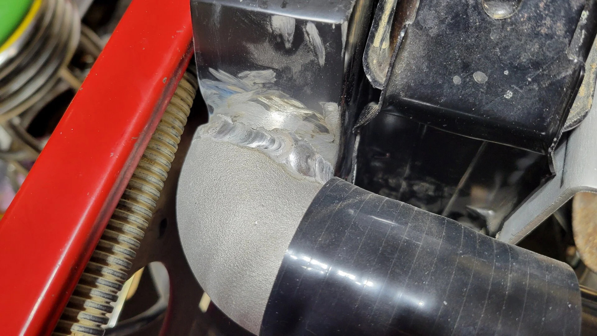

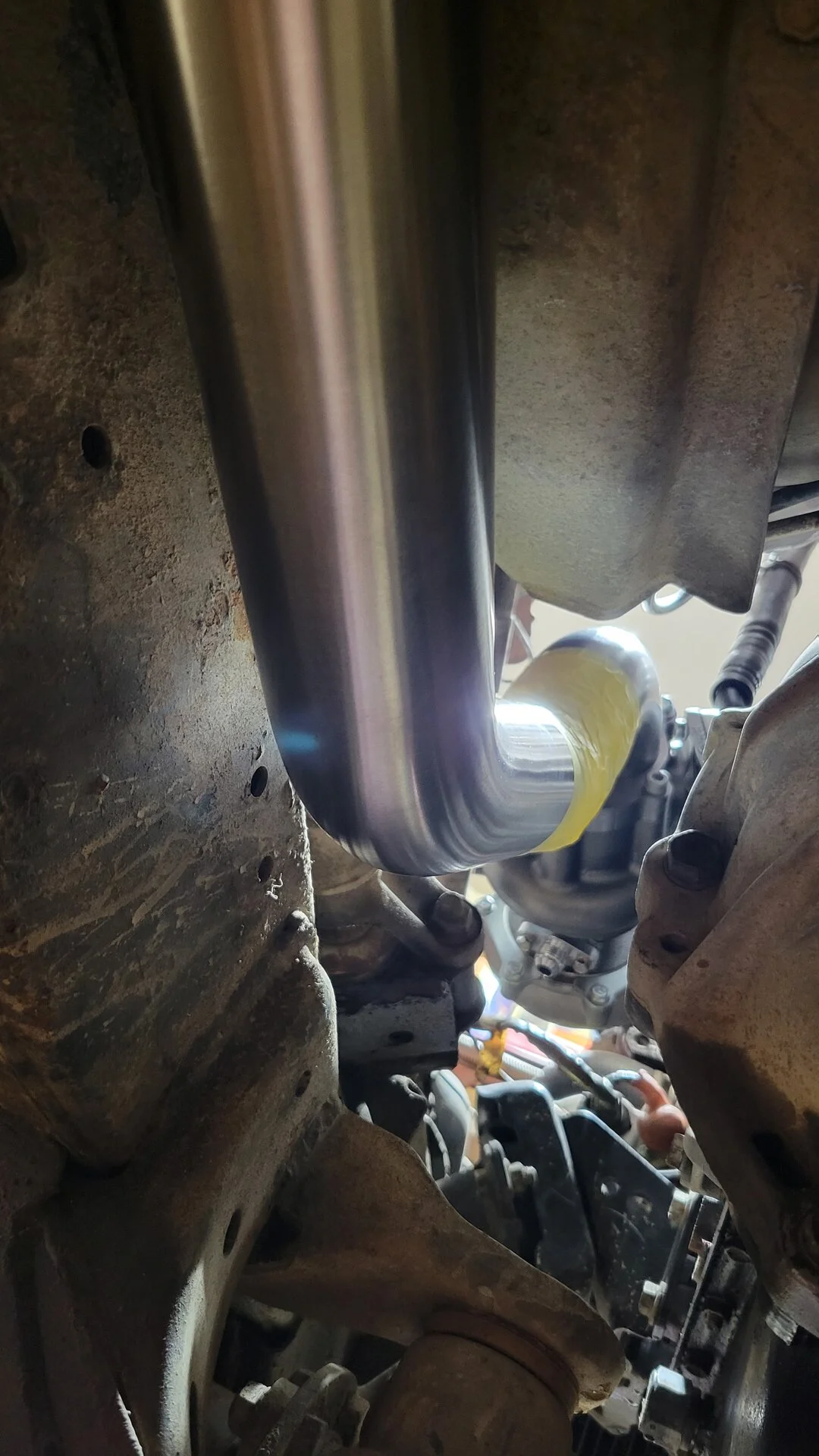

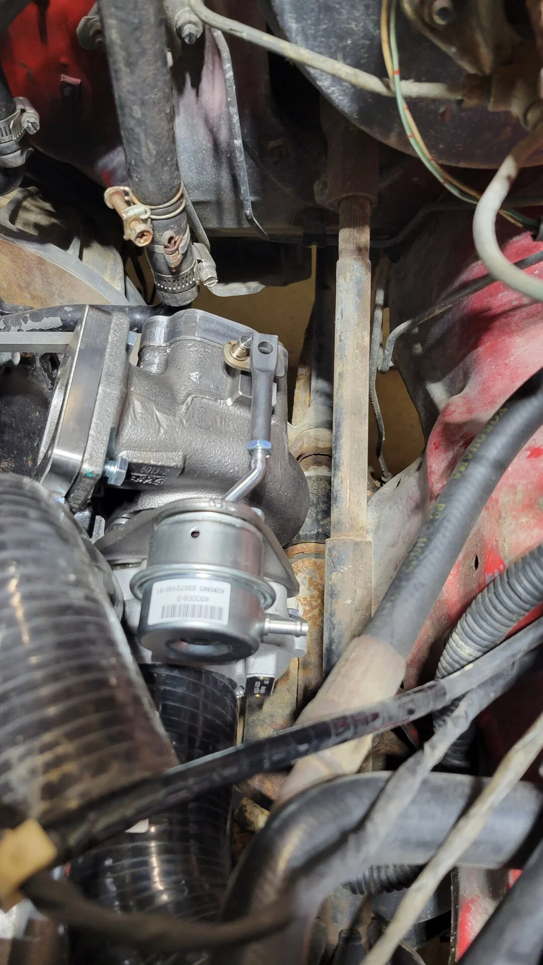

For a first attempt at pipe fitting I'm happy with what it turned out to be.

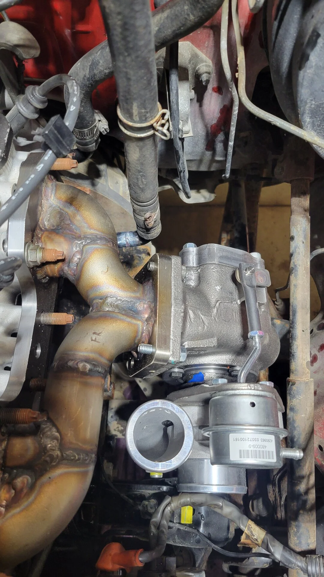

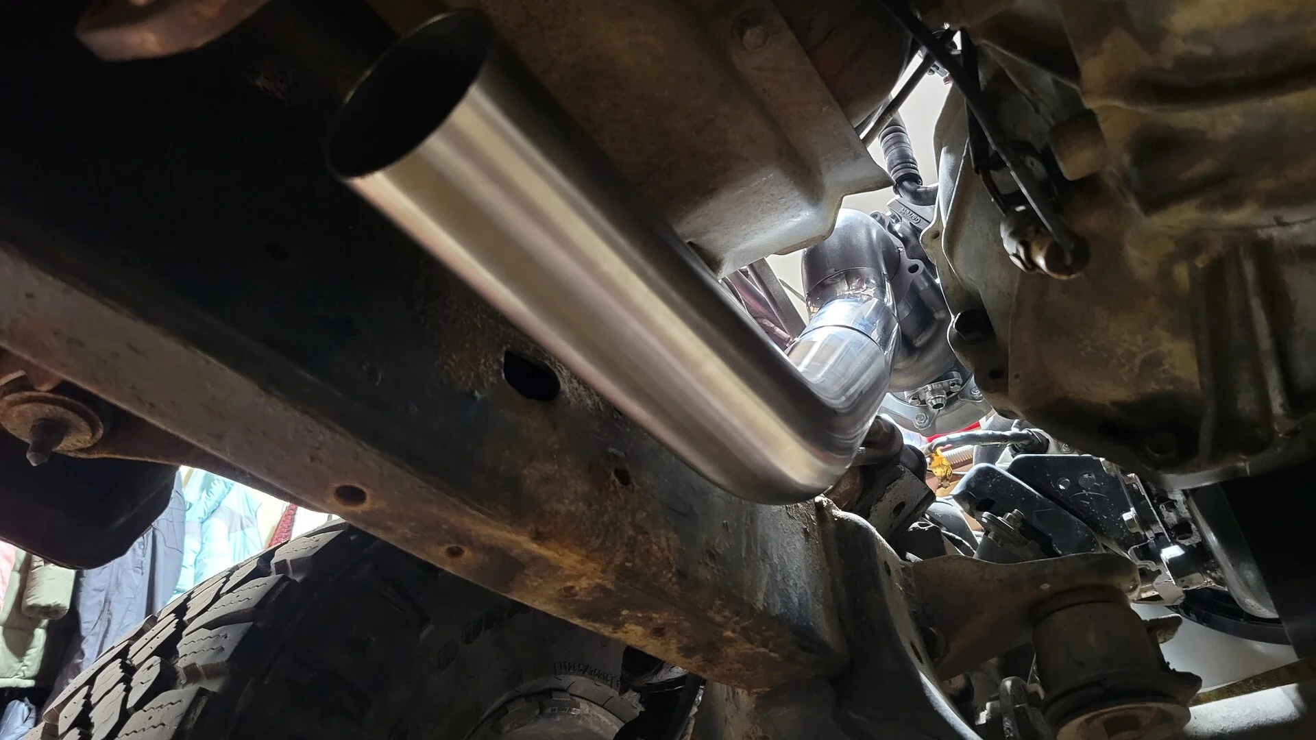

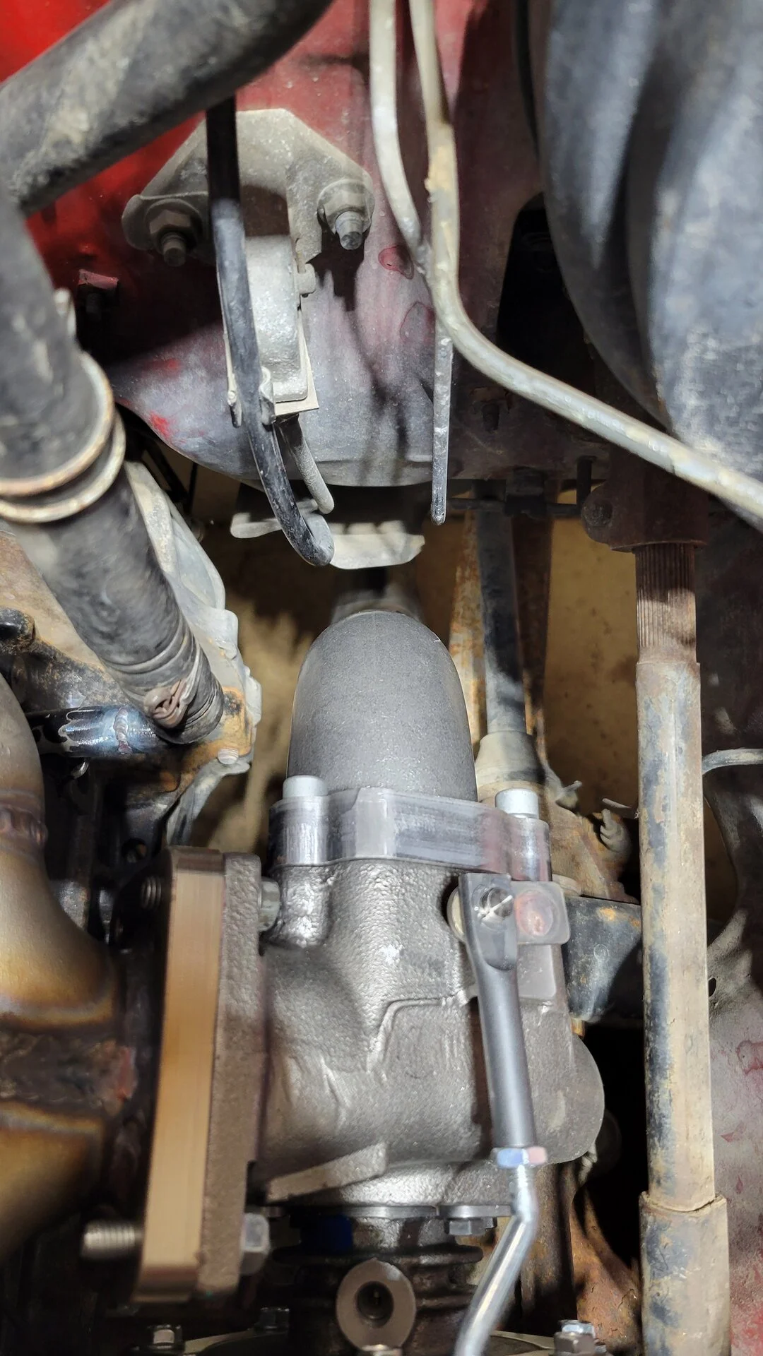

Cut 2 inches out of the heater core pipe to clear the downpipe

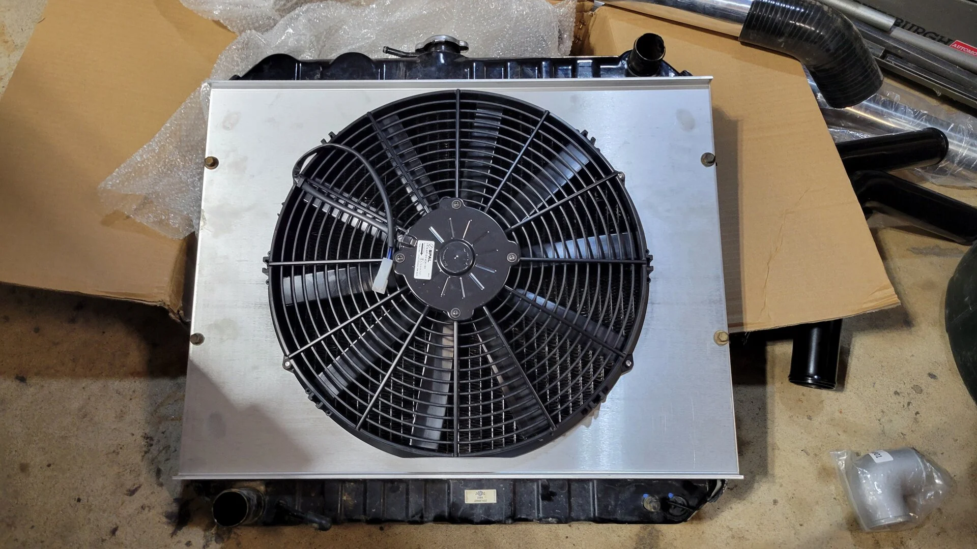

1/8th aluminum sheet with m6 flush studs for spal 16" fan
