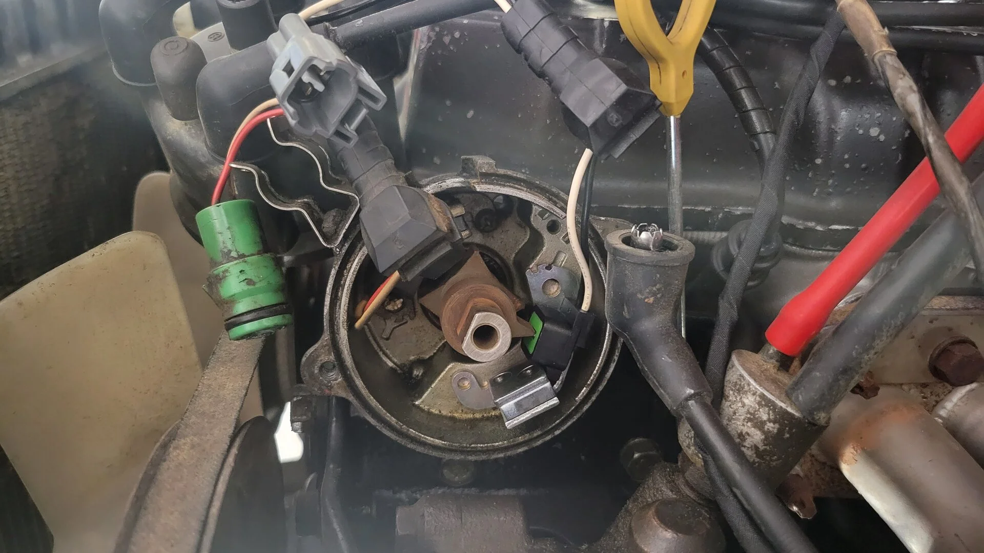

can you not use the distributor pickup as a cam sensor ?

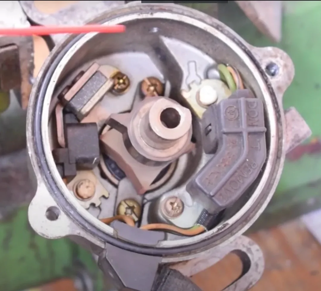

The 4 tooth cam wheel is engine speed. There is a 1 tooth reluctor next to it but no VR sensor. I bought an OEM signal generator magnet and am going to try and drill and tap it then see if I can configure MS for a 4+1 cam/cam trigger. The 4age distributor did this prior to going to the 12 tooth wheel
Mine
4age
Not sure how bad the resolution will be but hopefully good enough for sequential

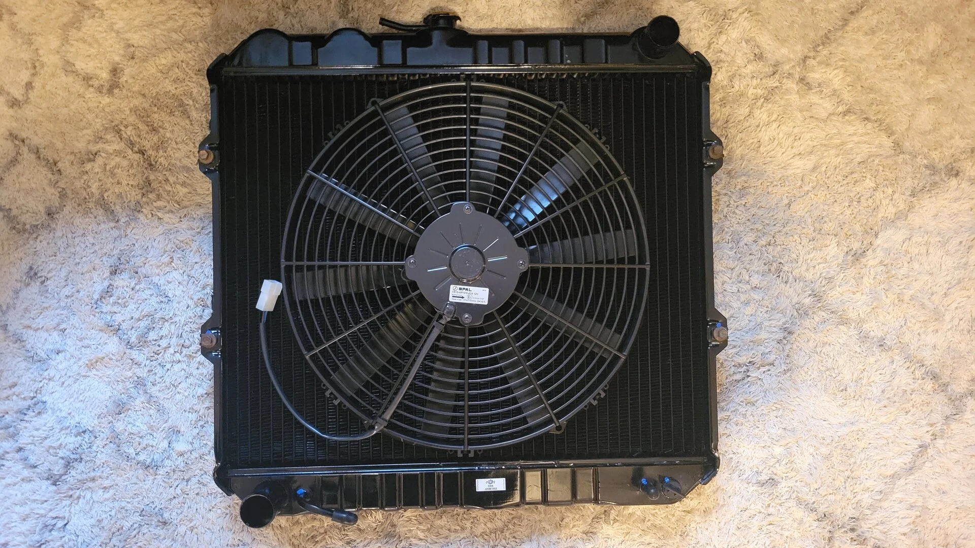

SPAL 16" low profile puller

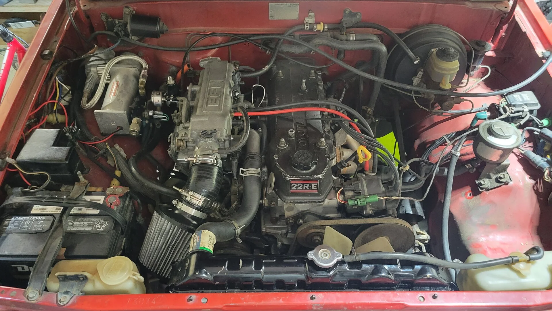

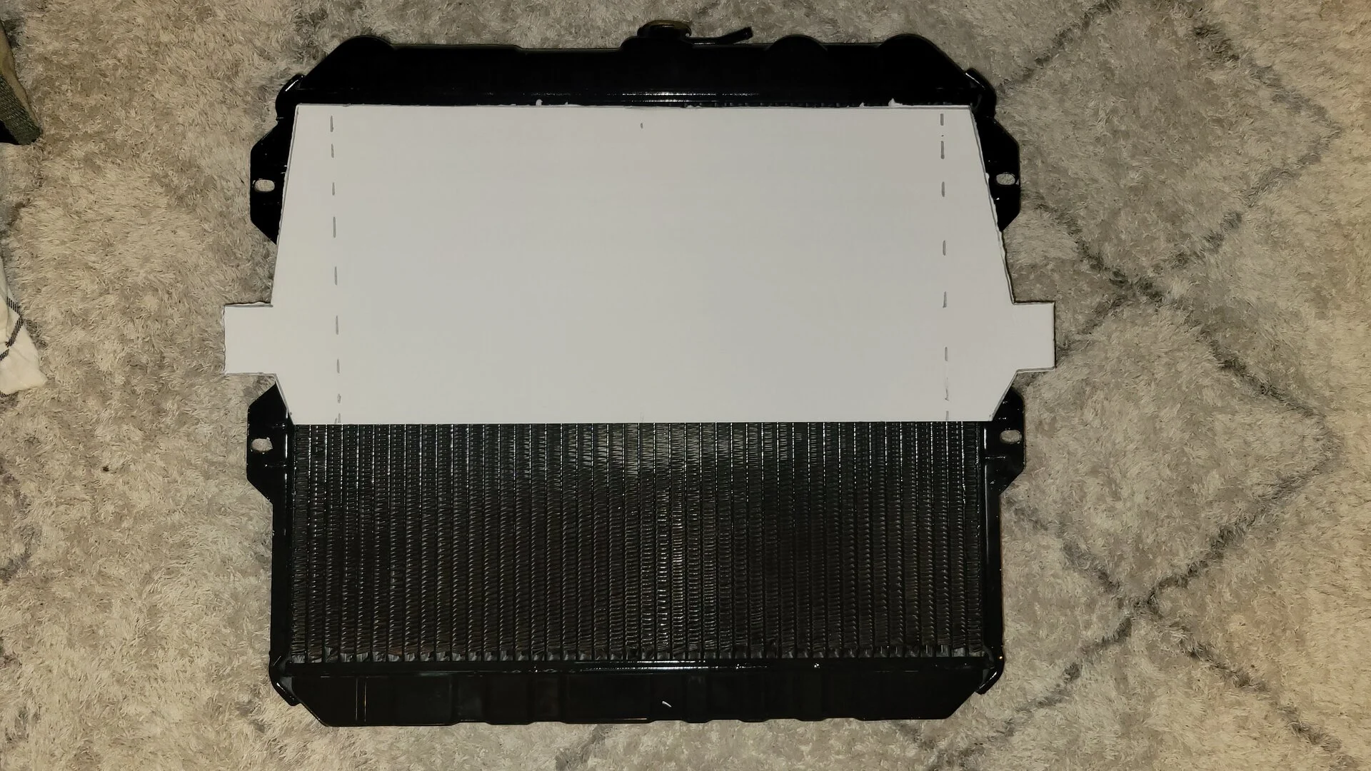

Also scoured the internet for intercooler dimensions and am going to try a Volkswagen passat intercooler after mocking up some cardboard.
Ends up being 24x10x2 and am going to try standing the radiator 2 inches off of the support and squeezing it between the AC condenser and radiator

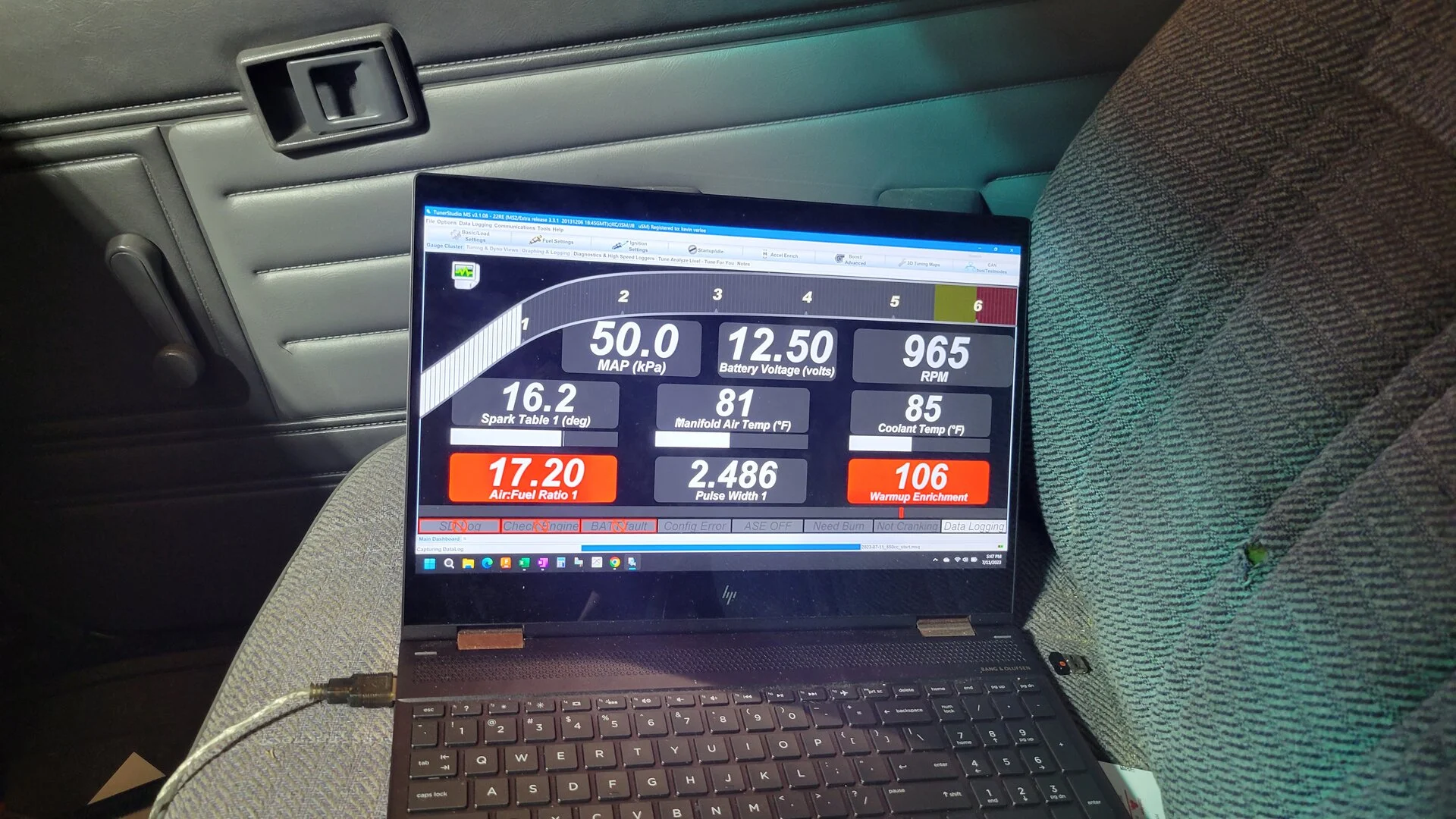

It runs! First crank 🤙
Noticeably smoother idle and slow reving to 5000, probably because of consistency in fuel quantity.
NA tuning to come but I don't think I'll have to do much
Intercooler came in and my cardboard design was spot on.

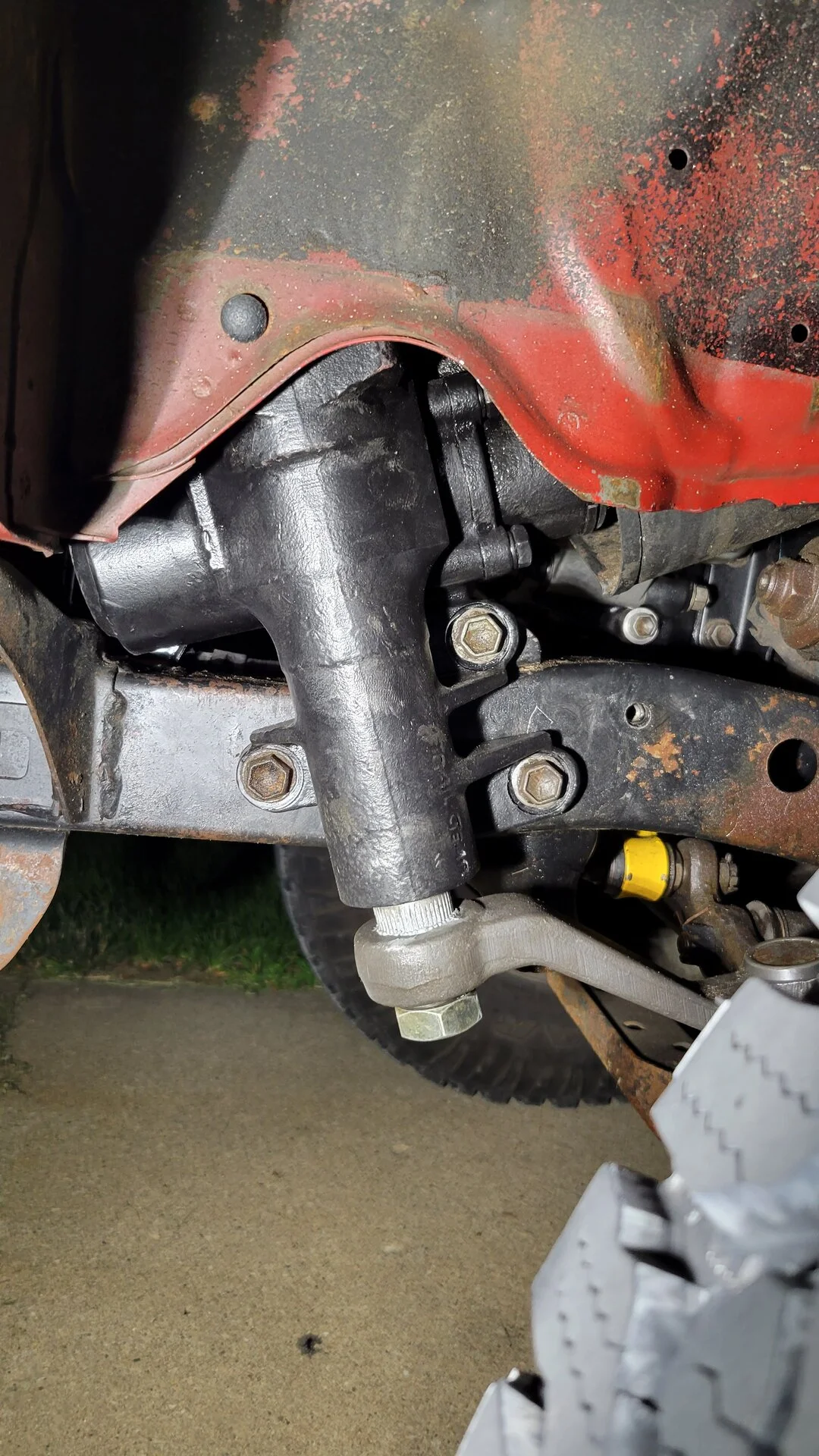

Tired of trying seal kits to fix my leaking power steering box. Trail gear had a sale on a tapped box, we'll see how it holds up.

Is your steering box leaking at the input shaft seal? That's the one that always leaked on my 88. (early style box) At least you don't have to pull the box to change this seal on the early style box.
Here's the part number to the typical leaking seal. The number on the seal is NOK AP8096E. The Toyota number is 90311-19002
Output/sector shaft seal was toast for the second time. The sector shaft is so rusted and pitted that a lip seal does nothing now
