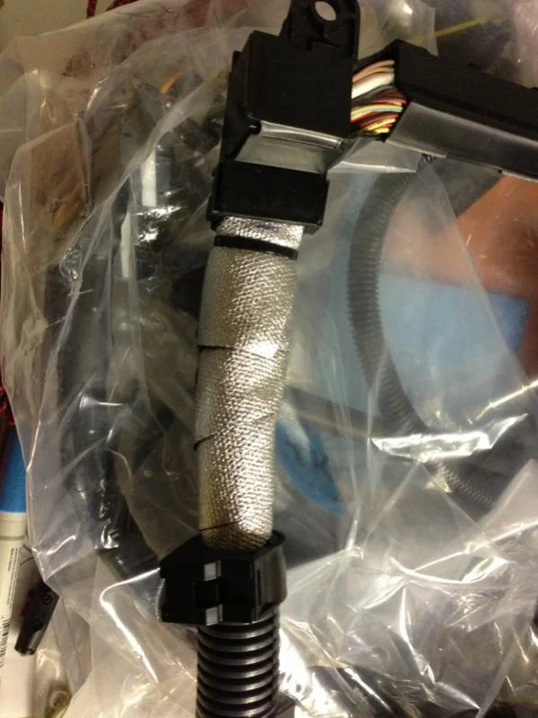

That plastic retainer I mentioned is the one in the picture. It breaks and then the harness is free to contact the egr pipe. You might consider removing it and then use the zip tie trick.

So on a whim I packed up the kid and some camping supplies and drove to Yosemite. I will do up a proper write up with pics and s*** but here from the trip I got the following CELs: 303, 325 & 401. The knock sensor one is new. I talked at length with Richard from K&H about doing the new harness. He literally begged and pleaded with me NOT to make him change out the harness. He said he knows exactly how to repair it and it only requires removing the hood, the EGR and pipe and then getting into the loom. He said he has never ever had to redo a harness repair and begged to try that first before going thru an entire harness. I figured I'd go that route first.

Engine harness has been repaired. According to Richard at K&H there were three wires that needed to be repaired. The battery was disconnected so it still needs to reset but I can already feel a big difference. All I need to do now is getting the overheating under control and the SC will finally get installed!!!

So I just ended up fashioning up a heat shield out of an aluminum beer can. Hopefully that will help. FWIW, my plastic harness clamp had broken loose, so I've zip tied it back over. Good idea to check them suckers if you haven't.

Richard at K&H's fix to the engine harness too care of all three of my CELs INCLUDING the dreaded 401!!!
