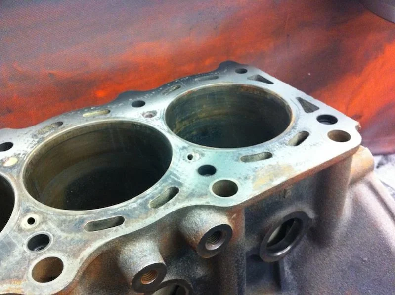

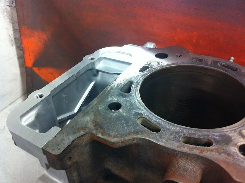

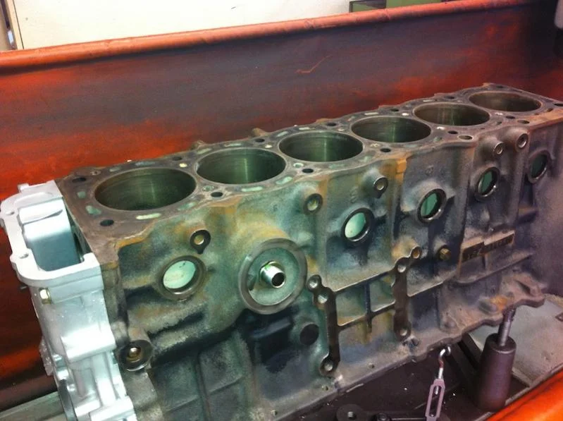

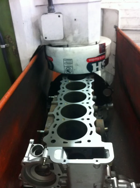

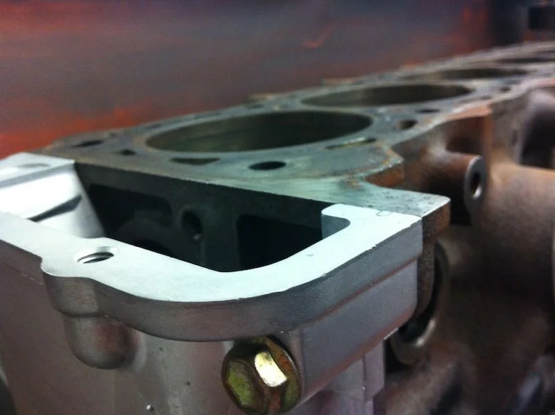

So found a few pics that I didn't post up. Figured I might as well. Earlier in the week I stopped off at Martin Davidson's shop. I had asked for him to let me know when the block was going to be decked because I wanted to see the amount of warpage. For those that don't know, you must deck the timing cover housing bolted to the block so that they can have matching deck heights.
As you can see from the first pass, its definitely warped, bowed in the center. By the second pass most of the deck was match. By the third it was good to go. Now that the head was surfaced we get to see what thickness the head gasket needs to be. My particular head gasket needed to be .070 to keep the stock compression. The OEM is .060 and the stock Cometic is .053.

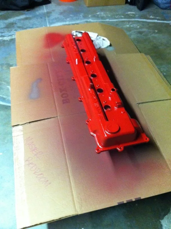

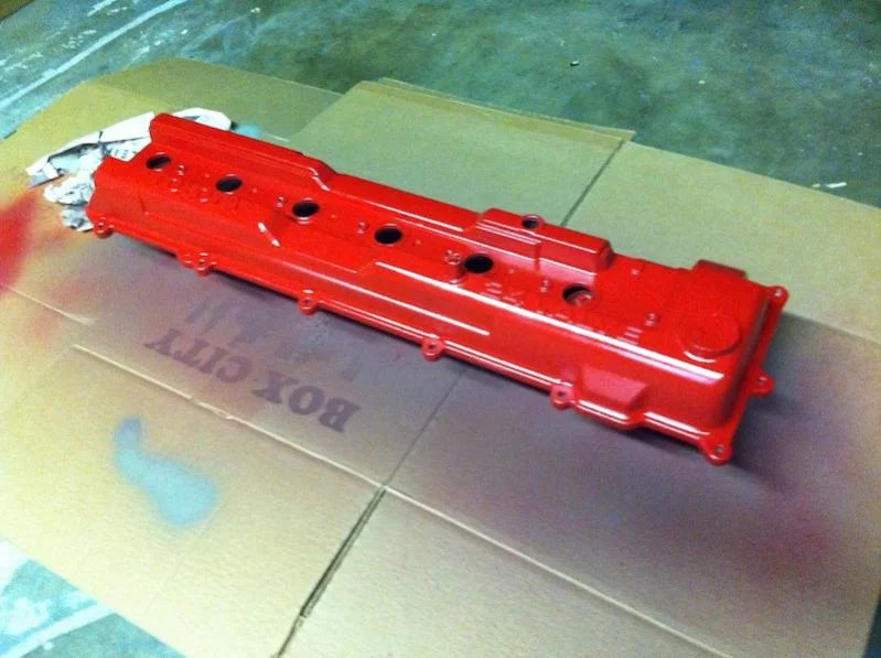

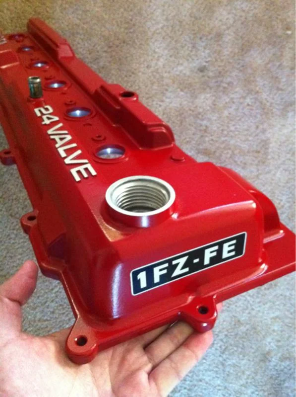

Valve covers were hot tanked and I had pie in the sky plans for the valve cover(s) but I just simply ran out of time. I still have two valve covers here that I am eventually going to experiment with. I want to still anodize one and powdercoat the other. For mine, well hi-temp engine enamel it is. No choice. Its not a bad choice but not the direction I wanted to go in.
Great pictures of the block being decked. Informative to see all stages of the process.
