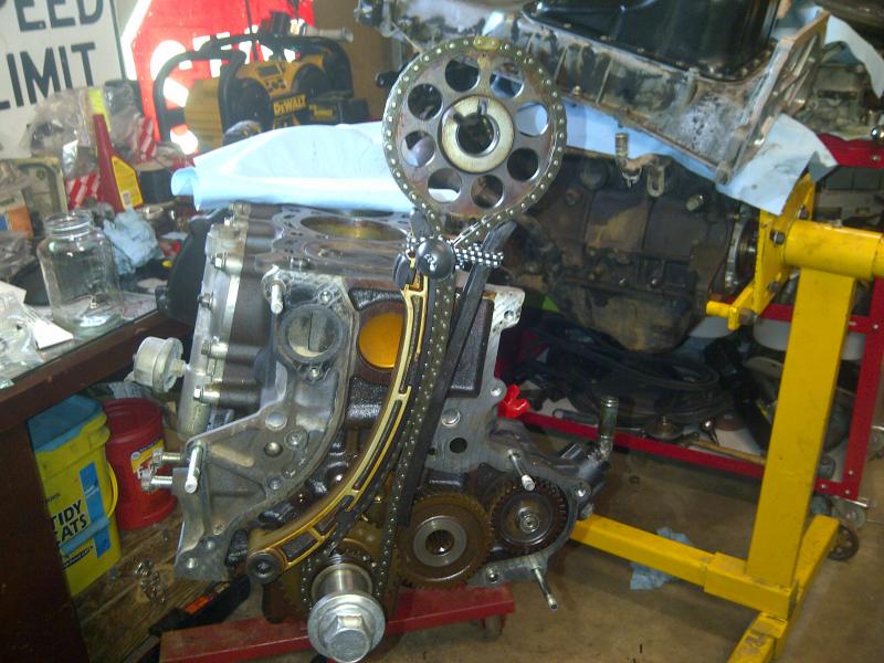

Embarking on what looks to be a simple 80 series engine swap.

Bunch of stuff done, started out with those two o-rings. and a pretty stripped down block at about 10am.
Then I moved on to the oil pan.
Then the oil seal gasket - o-ring thing. Whats awesome is that the bead for the oil pans need to be between 3-4mm... its the same width as this cavity.... good way to eye it up.
Ok, then I installed the oil pan 2 and then the ps pump that I completely rebuilt... that was fun... this is all fun. Loving it.
all of the sudden, my bolt pile starts to disappear and I have more space around the garage... good feeling.
So I pulled out the NEW gasket- The old one here for comparison. The old one doesn't look bad except where the FPIG was pulled from the head.

First picture - see anything wrong? This is where I had to do rework. after assembling the intake because I couldn't fix it with the injectors in. doh... and at this point I decided that I should call it a night... .an hour later I did.
