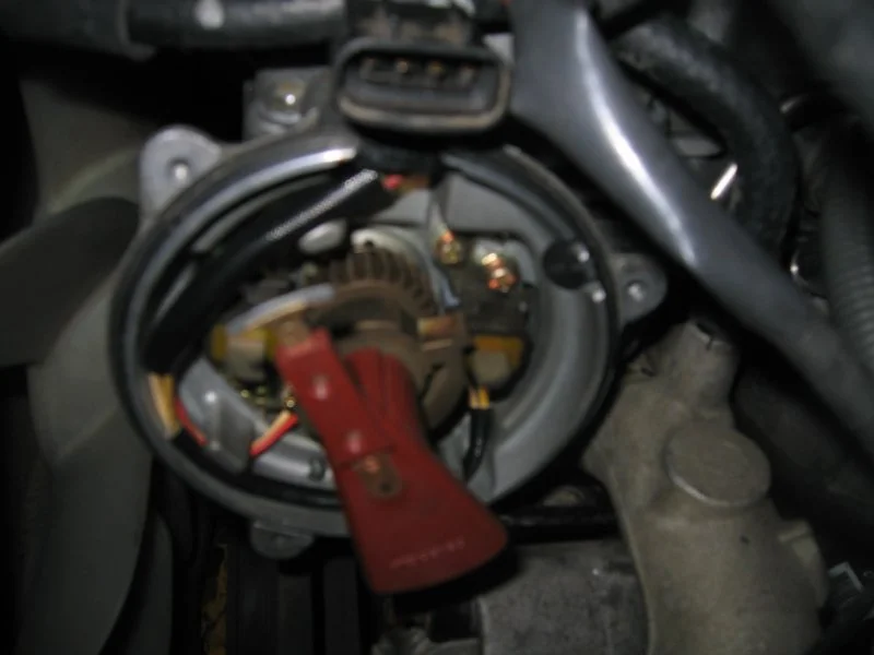

Now I need to hit some dinner, but when its over, I hope to hear this beast running. For those that put in a new filter, new injectors new everything, did it take a while for fuel to get up in there? Either that or my tdc dizzy stab is 180 off. It hesitates here and there and tries. ... i think i can... i think i can.

My dizzy had to be set at 11:00 Oclock, 1 OClock didn't work for me.

Given that you've tried to start it a few times, I'd say that your fuel system is properly pressurized. You could be 180° off if she doesn't want to start. I think you did make sure that 1) pulley is at TDC 0° AND 2) the #1 piston is at top AND 3) dizzy rotor is pointing to #1 spark plug wire.
It's always great to see another revived 1FZJ :D. Awesome job! :cheers:
Thanks! Yea, initially I had it at 1. Then I winged it moving it to maybe 9, then back to 11/12.... It runs!
... You could be 180° off if she doesn't want to start. I think you did make sure that 1) pulley is at TDC 0° AND 2) the #1 piston is at top AND 3) dizzy rotor is pointing to #1 spark plug wire.
Yes, I made sure of this.... Maybe I wasn't patient enough.
