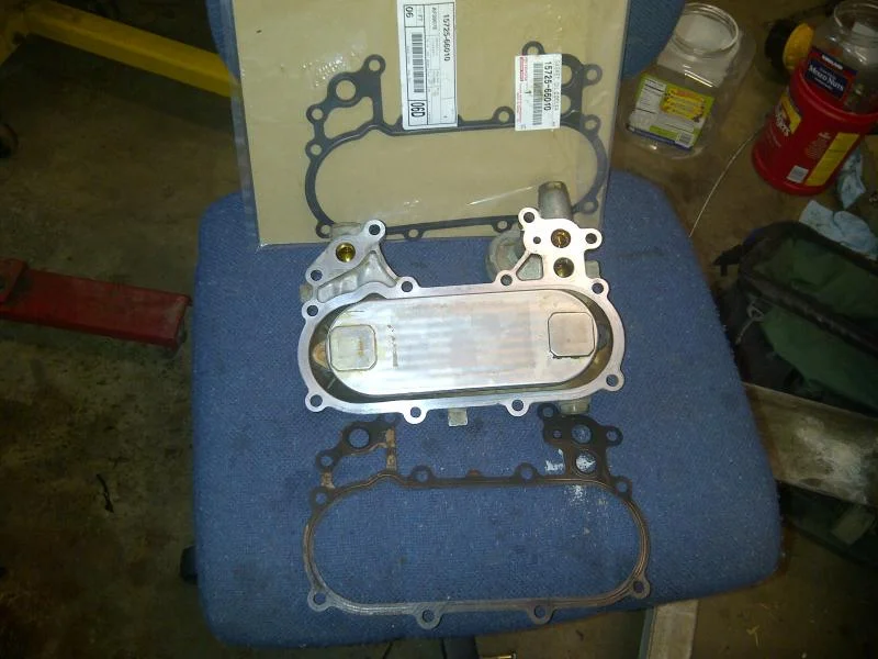

So the Oil Cooler got reassembled
2 gaskets, then assemble cooler to cover, torque the 4 nuts to 12 ft/lbs (easier to do when mounted to block)
Then put on the cover to block gasket (it only fits one way) and put the cover on with I think 10 bolts and 2 nuts. These get torqued to 15lbs.
here is the numbers for the gaskets you need for this. Hope it helps....

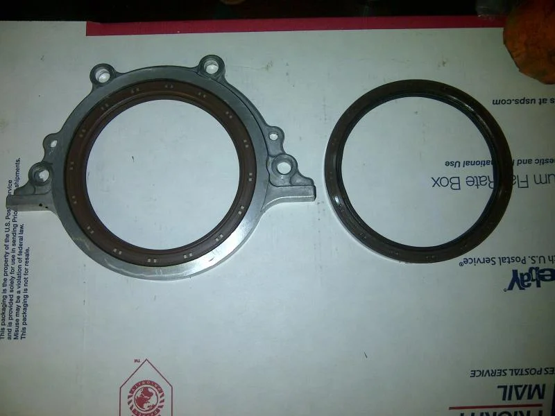

Then on to the rear main seal thingamajig. After cleaning, scraping, cleaning and noticing a slight burr on the outside (fixed it by scraping with a razor blade) I put on the rear main seal. I like clean.
Keep in mind that (IDONTTHINK) this engine leaked at the seals or the FPIG... I'm just doing it while in here.

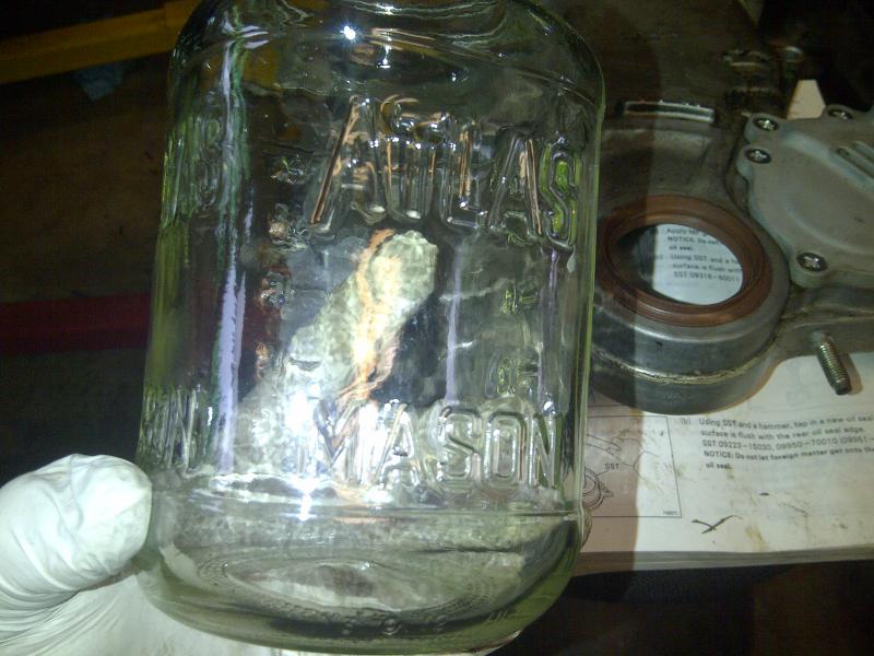

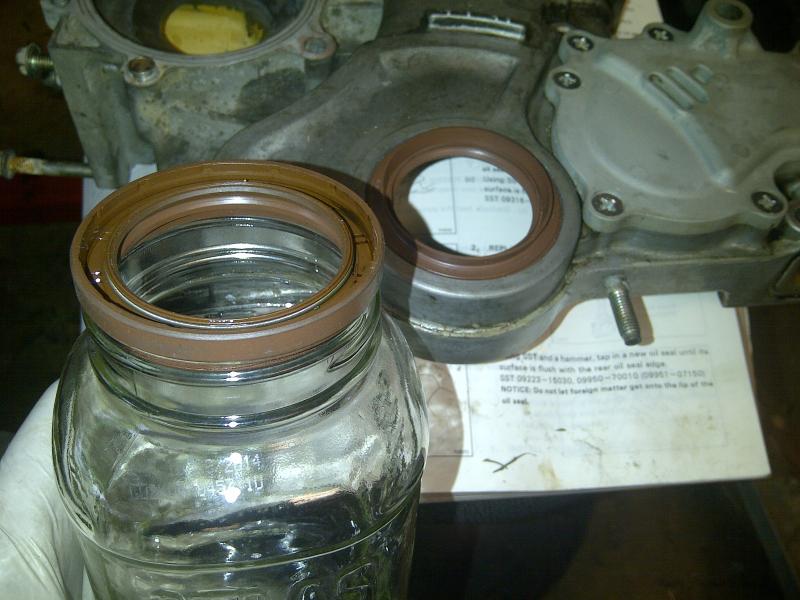

Then I used the MIKESTA SST tool to install the front main seal. ( you can see that the old seal lip fits inside the mason jar and stays there with gravity - new seal already in.

- rear main seal - before installing this on the Cshaft, check to see if there's a groove. If there is, locate the seal little bit fore or aft of this groove. Just an extra precaution against future leakage. Again, another Robbie suggestion.
