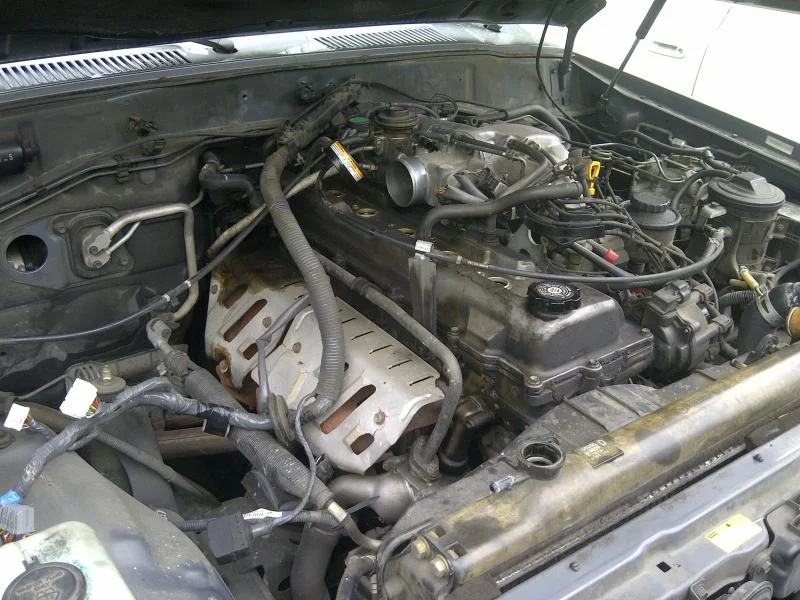

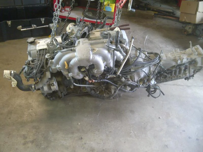

Here is the sick rig 247,XXX with a knock (still runs and drives)

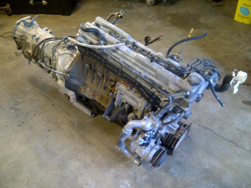

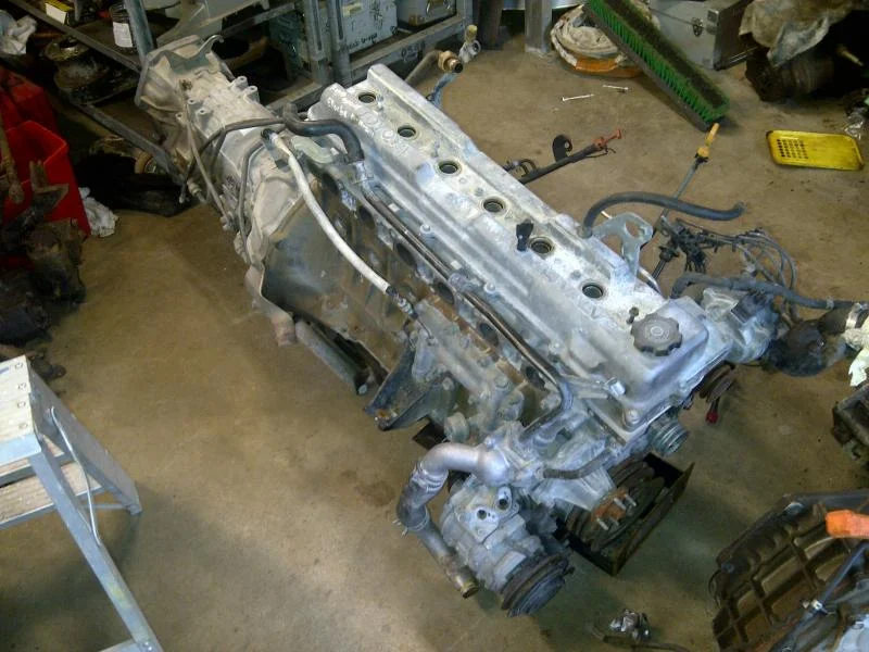

Additionally, here is the engine that will be going in it

My donor engine is 150k miles and it looks super clean, but it is out so I'm asking for any recommendations.
I have already sent the injectors in to be cleaned and will clean out the intake. This is my first 80 engine swap. I've never done an auto.
So should I order up a Pilot bearing? Rear main seal (though it doesn't leak yet)
What else... I'm pretty sure after I'm done with the swap this will be my camper rig (putting a camper up top) and I'd like to keep it for a Long time.
I was really hoping that the timing gears were the issue. Well after seeing a serious cloud of blue smoke today, don't think this is the case. I'll share what I determine the Knock is coming from when I take the engine apart.

Here are some pictures. Its the middle one and is now queued up! Wish me luck!

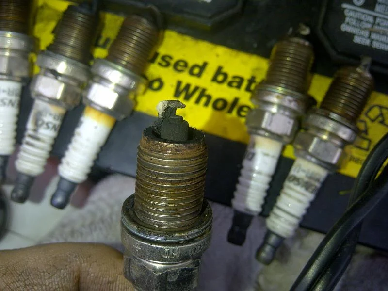

Compression numbers front to back
170/180/155/165/180/180
This is after letting it warm up for 5 minutes, pulling all plugs.

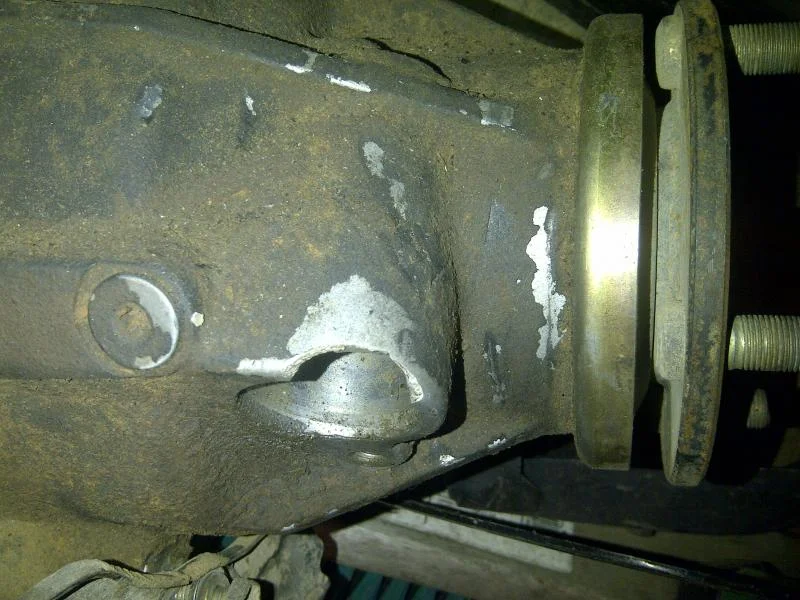

On a side note, I noticed my spare t-case has a chunk taken out of it, likely from when it was pulled... bummer
Pictures - because everyone like pictures. No progress other than this today.
That chunk that is missing appears to be the speedo connection on the rear output of the tcase. Assuming you have a decent one on your old rig, that is a real easy swap, and the seal for that output shaft has to be replaced by going through it anyway, so my .02 is to take the guts you want from the new tcase and put them in the case from the old one AFTER you put in a new output seal.
