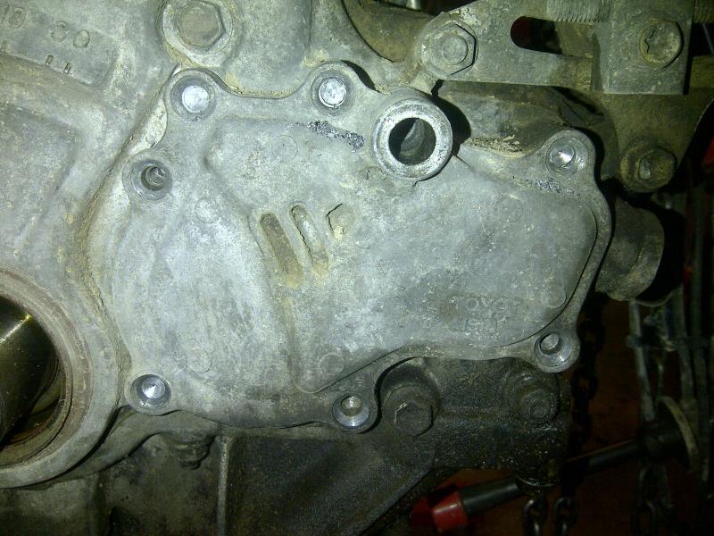

Next segment - Was able to get to the oil pump seal easily with the engine out
https://forum.ih8mud.com/80-series-tech/72514-how-replace-oil-pump-seal-w-pics-9.html
Even with full access to the front of the engine and applying the techniques in that thread, was only able to get 2 screws out. Others had to be drilled

Here you can see that the cover cleaned up nicely :)
I tried to put the seal back on, but it was too stretched out, so I did the best that I could and got the top part good... so no dirt gets in there.

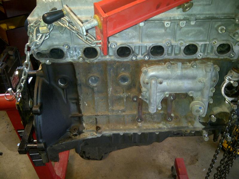

I was debating on painting the block, but it didn't come painted from the factory and no one will really see it so I opted to just clean it. Here is a section that I cleaned up. I think it came out nice.

Got the engine block cleaned up a little better

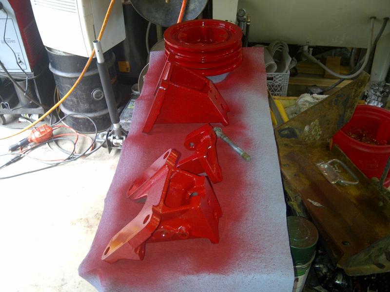

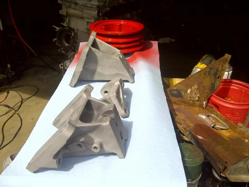

Sandblasted and painted some hard parts
Put some paint on them... I just picked a can out of the cabinet... thought it was white, but guess it was read so all the hard parts will be red.
