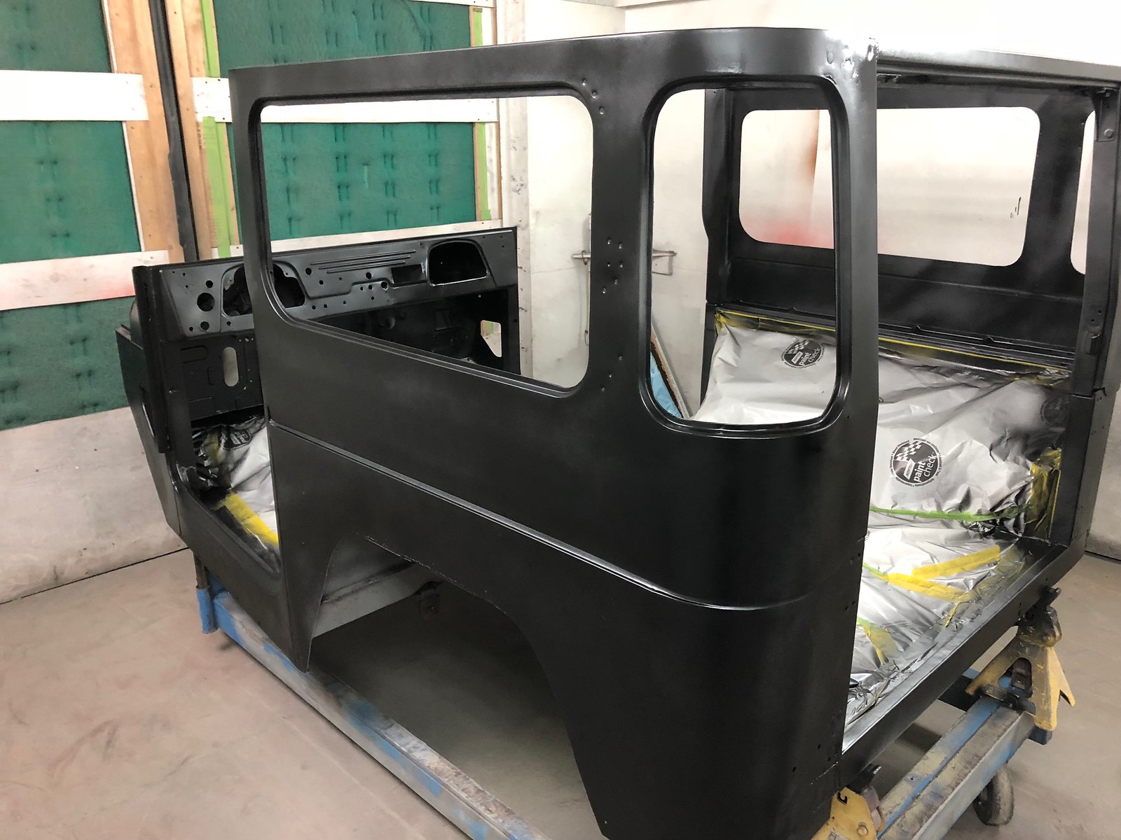

Here is the recipient 40 for the in-line 6 system... Gonna go back to the original green, and we might even flip the bezel in the process :cry:
