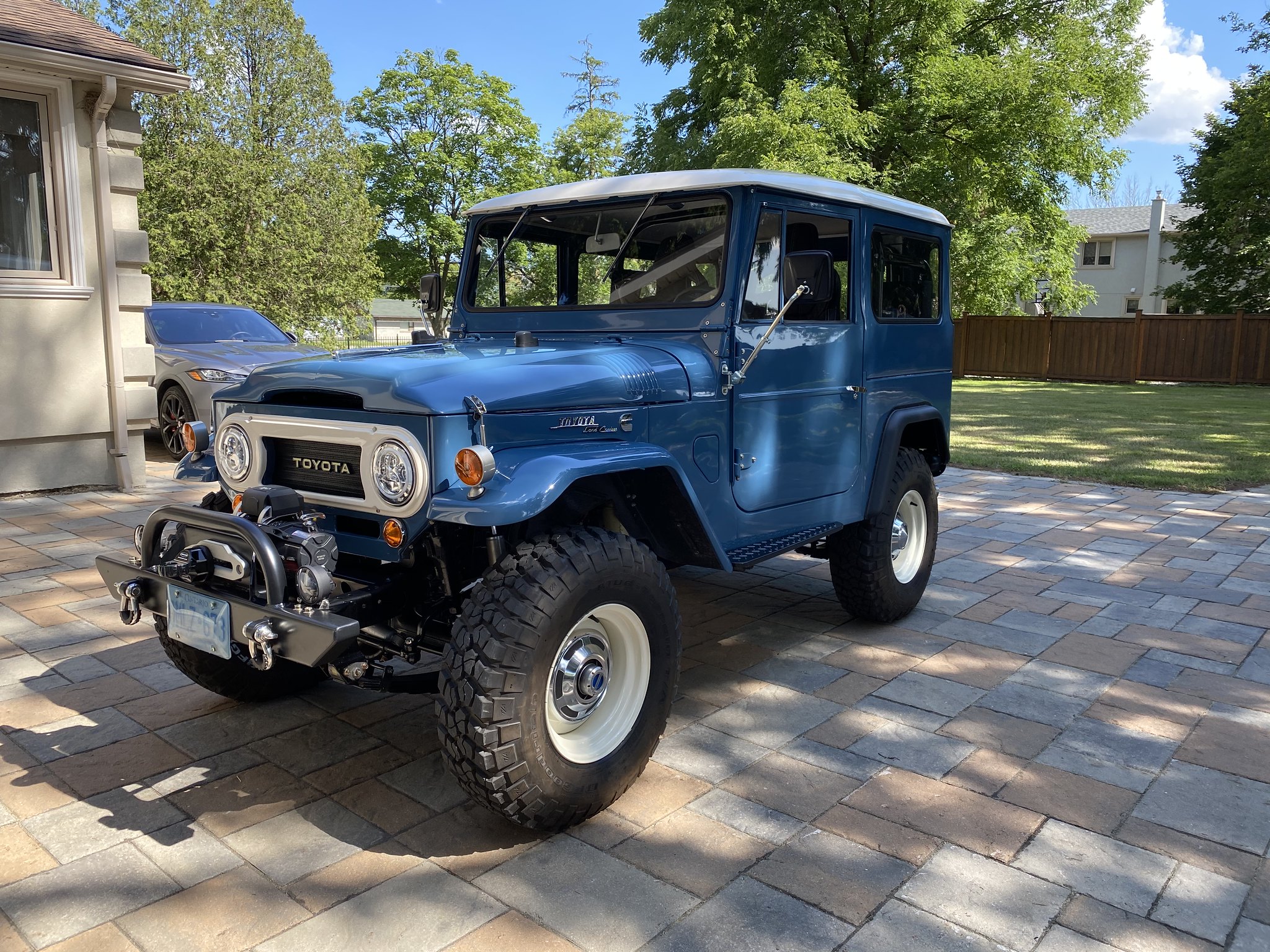

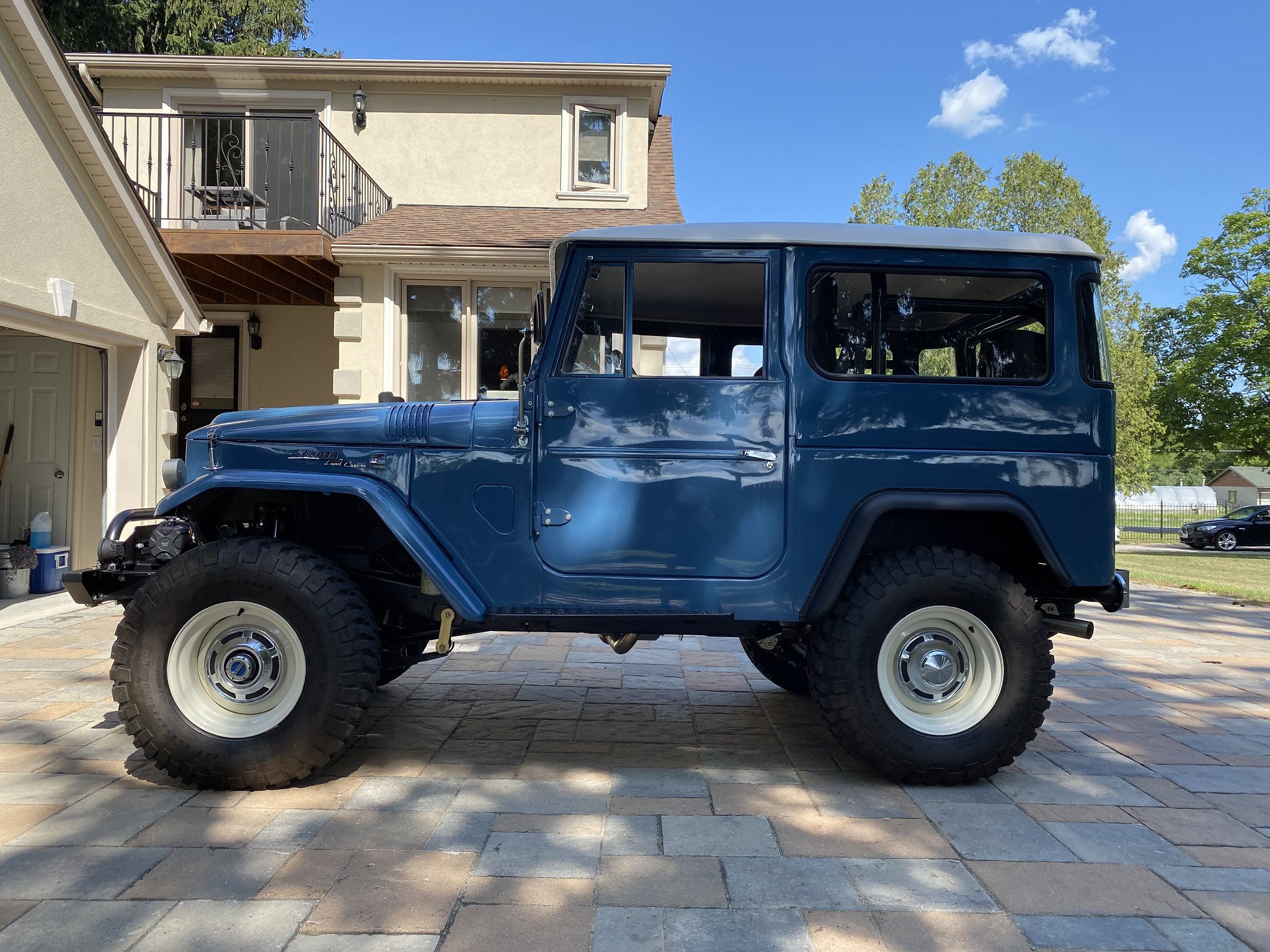

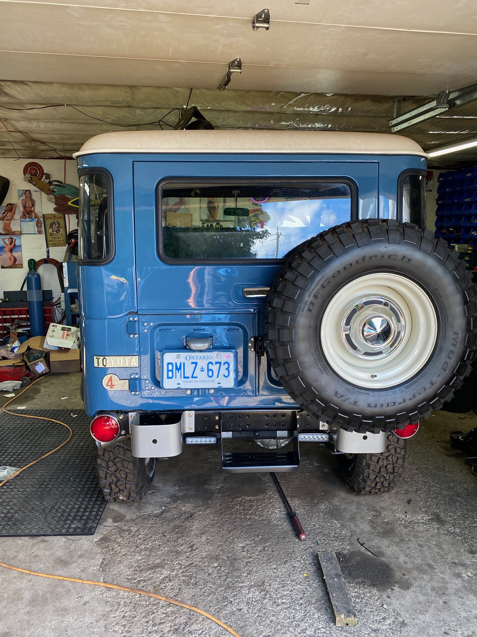

So driving update ...
R2.8 review
Heating and cooling system is working great ... on the hot days she gets up to about 210 but mostly sticks around the 190 mark
She LOVES to cruise at 60-70 mph ... all gay long
The R2.8 is a little noisier than expected but its fine, its extremely nostalgic and a ton of fun to drive
My only gripe that will be fixed today is the diff gearing at 4:11's. 1st gear is completely useless and 2nd as well. The issue is this engine does not produce any power without the turbo, and the rev's are so quick in 1,2 and 3 that the boosted power is extremely short in duration ... its not until 4th and 5th that you can spend more time in the boosted power range. So any stop and go driving around town is not so great ... for now
This will hopefully all be fixed today as we are installing a new set of Nitro 3:70's
Few notes ...
bead the turbo piping as the pipes WILL blow off as the little turbo produces a lot of boost
Again, unless you are 4x4'in this thing all the time install the 3:70's before you finish the truck LOL
Actually VERY happy with the ride quality of these tires in combination with the 2" lifted OME springs ... tires set at about 28 psi
Though kind of expensive, the FJ60 steering conversion is fantastic
The dual tank system is working just fine, just need to sort out the rear tank signal / sender to the Dakota Digital gauge
Thats it for now ... let you guys know about the 3:70's
Cheers
Steve

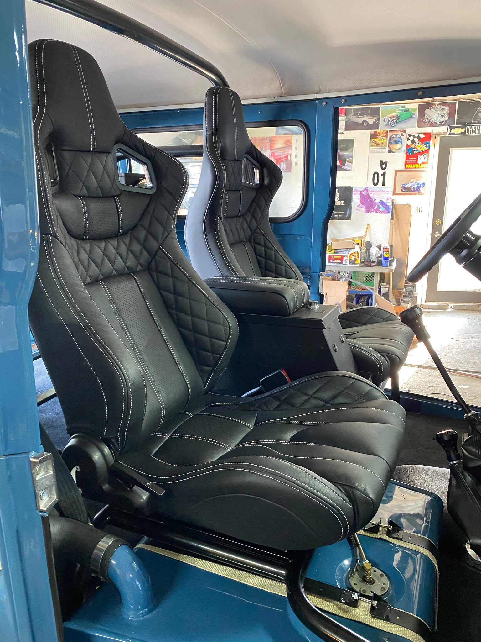

GMAC ... these seats are from the UK

When you say Hot Days about how high was the outside temp those days. I'm in Texas and we had 106 degrees 2 days ago??? I'm just trying to get an idea for what I can expect from mine, I used same cooling package you did, hoping it's enough.
Also what size tires are you running and what was the RPM's at 70 mph on yours, I'm running 34" tires, I really don't want to change the gearing???
What kind of trouble was the 2.8 install?? I’m considering it for my ‘69?
BIG thanks guys !!!
Wish I could take all the credit but I have the vision and some skills, and my buddy (mechanic) has serious build skills.
Sometimes he wants to kill me because what I want done cane be troublesome LOL
The R2.8 was 'ok' but harder than the LS conversion for the following reasons.
- space is VERY tight with the al the extras
- adapters
- piping
- engine position
BUT that being said ... worth it
VERY different ride/drive than the LS, I'll make my final decision once we get the 3:70 gearing in it this week which I like better
