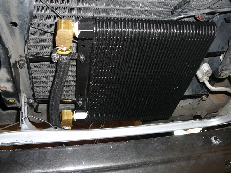

Is your rig manual transmission? All of the US cruisers I've seen have autos and a cooler in that location.
which model is it? Thanks
Amazon.com: Spal 30102030 12" Swept Blade Fan: Automotive
keep in mind this it's their HP version there is plenty space there for it, but it draws decent amps ( spal recommends 40amp fuse )
was auto ... then I used to have my tranny cooler there
then I move it under my winch to make space for this fan ..
