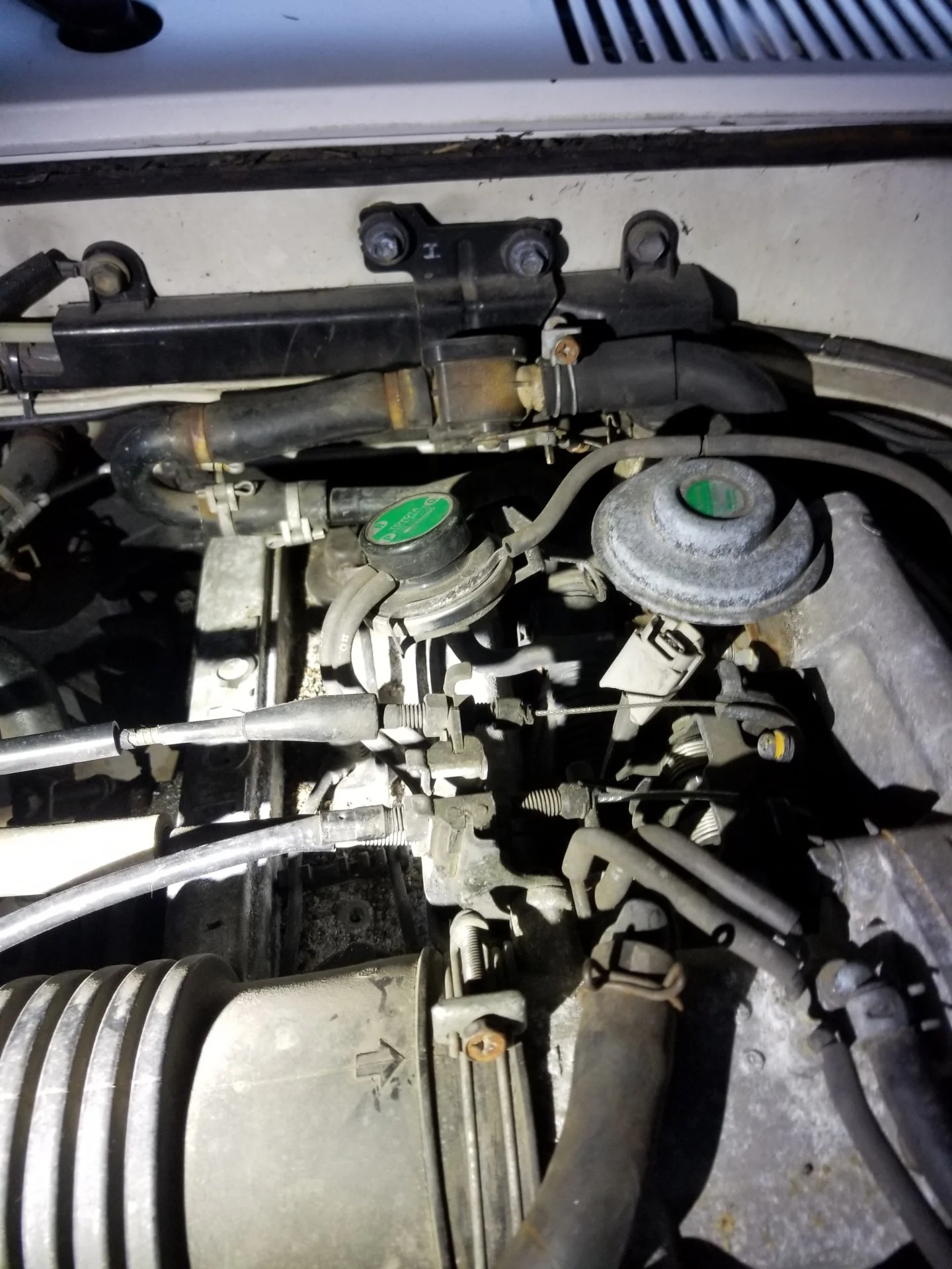

I got the kit in a few weeks ago for my 93. The plug will not fit mine and Hudd thinks the factory plug was changed out. Has anyone had this problem? I'll try it again tonight just to make sure.
I'd change out the Heater Valve while you're back there. It's looking pretty 'iffy'.
There should be a number on your old temp sensor connector. If you can read it....we can tell you if it factory (looks factory).
