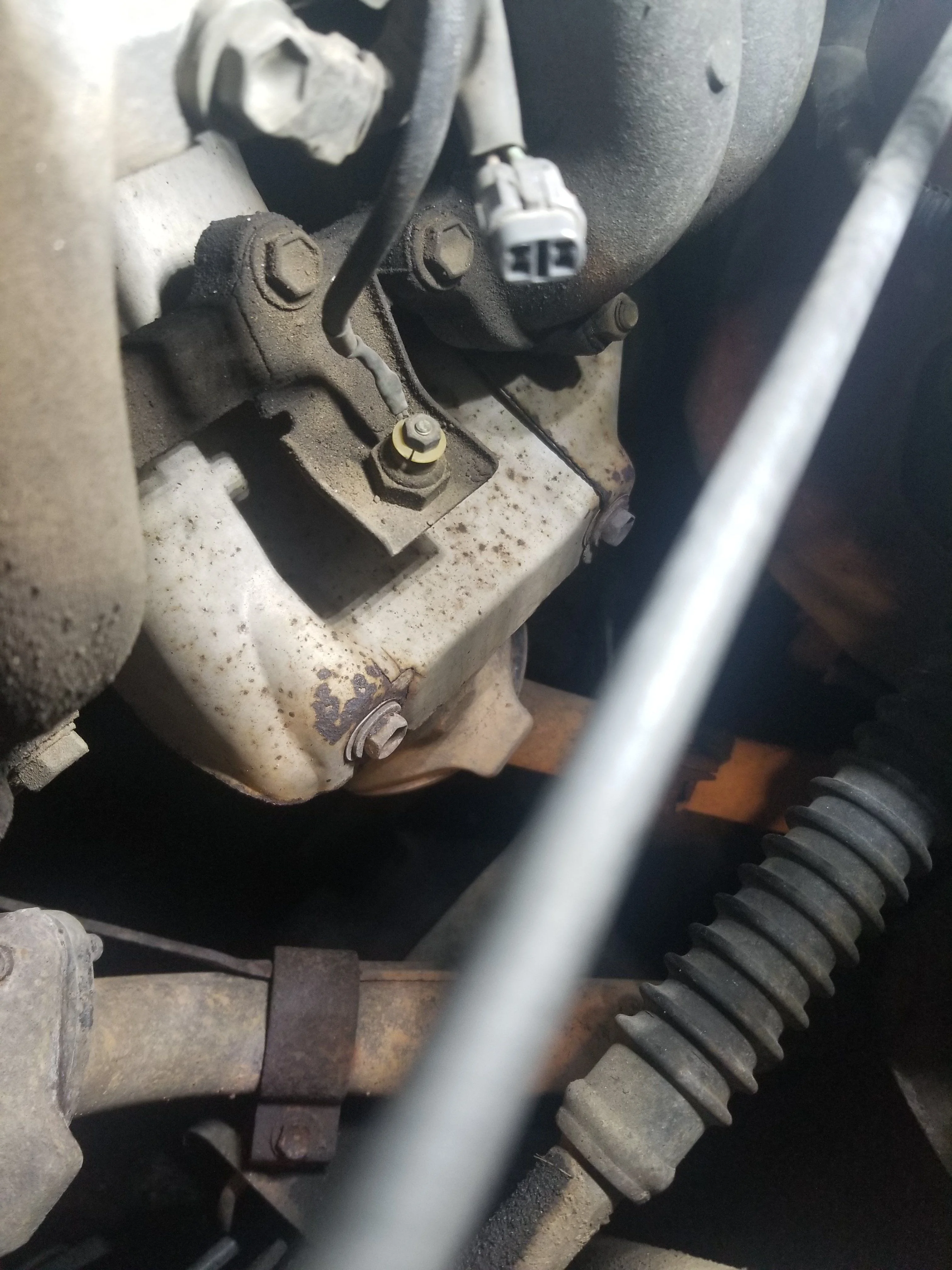

I don't believe you need one for 91-92 as they are not OBDI or OBDII.
I just did egr and pump removals on my 91 fj80 with almost 300k.
Got a cel. I think this is because mine must be a California native.
(From what I've gathered on here the cal 91and92's got an egr temp sensor. I guess your just supposed to be able to jumper the plug with a paper clip and no more cel. Idk but ill try it.)
I also have all the vacuum thingies still bolted in where they were and the electrical plugged in. I have all the vacuum lines plugged and the bypass for the intake pressure sensor in. I think I can just unbolt the "vsv's" I think there called and unplug and remove but I've read somewhere on here that the vsv closest to the firewall is for fule not sure about that but I'll try unplugging them and see.
It would be nice to have a neater looking plug than a paper clip but i suppose i coyld just connect the wires

Get me a pic of the plug on the sensor and I will see what I can do.

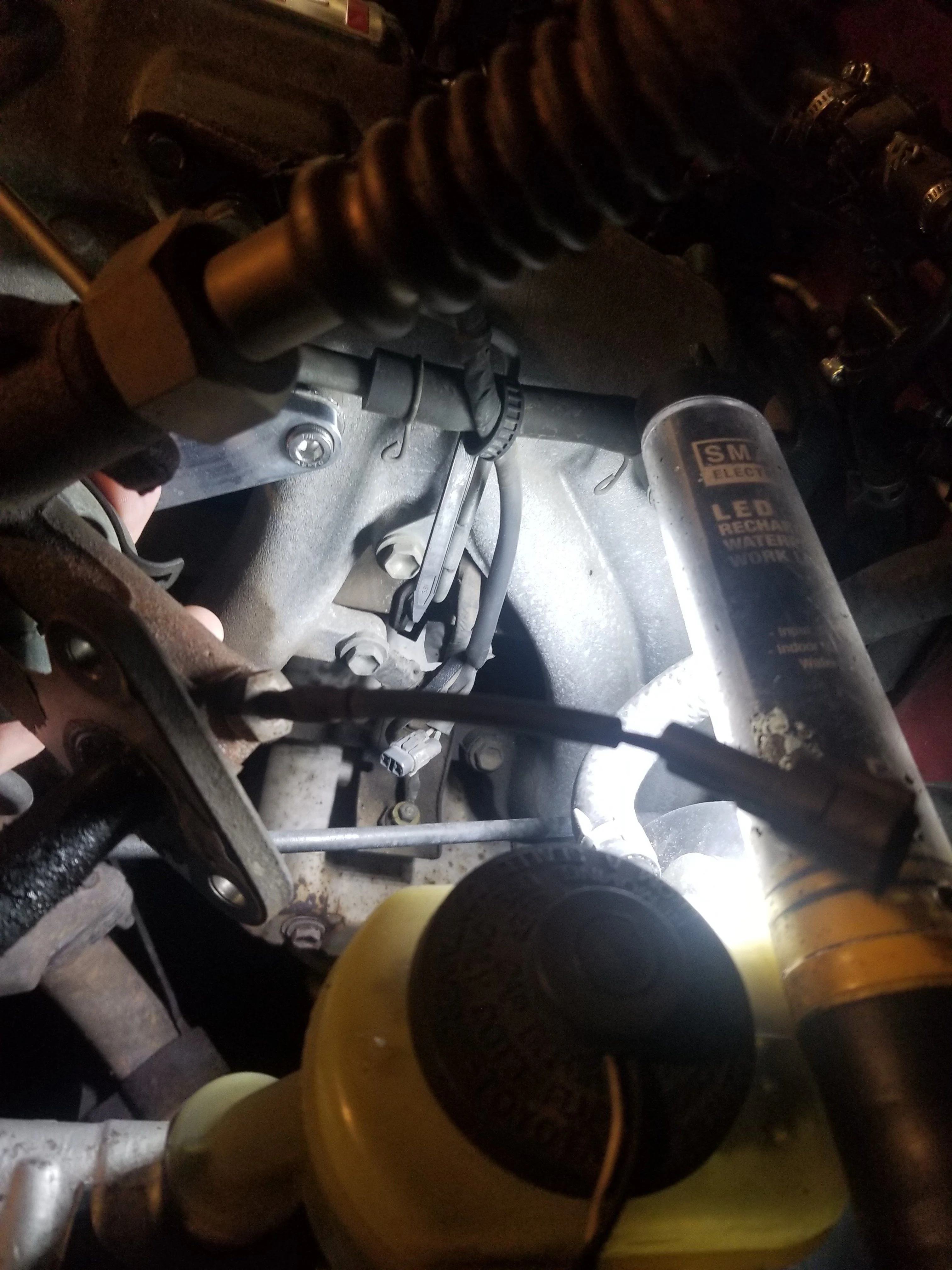

I just removed all the vsv and the blower. I took the old egr temp sensor out of the egr and plugged it in and stashed it next to the intake. I have the battery unplugged now going to see if that'll reset the computer and turn off cel.
Yeah so CEL still comes on after a while with the EGR temp plugged in and stashed on the intake. I guess I'll have to try and jump them with a paper clip and see if that works.
