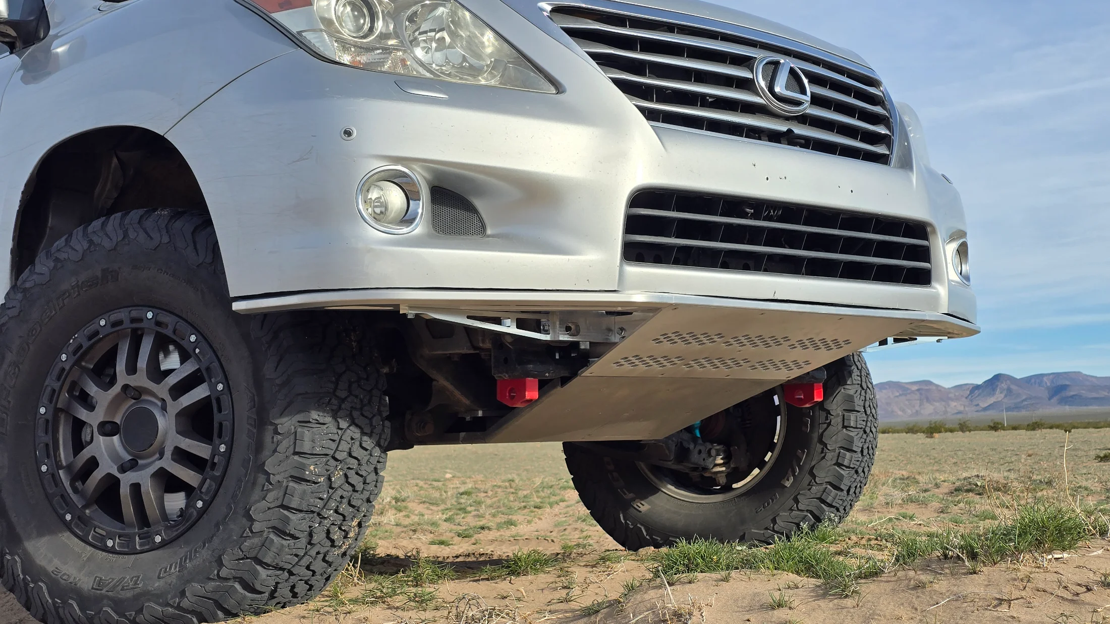

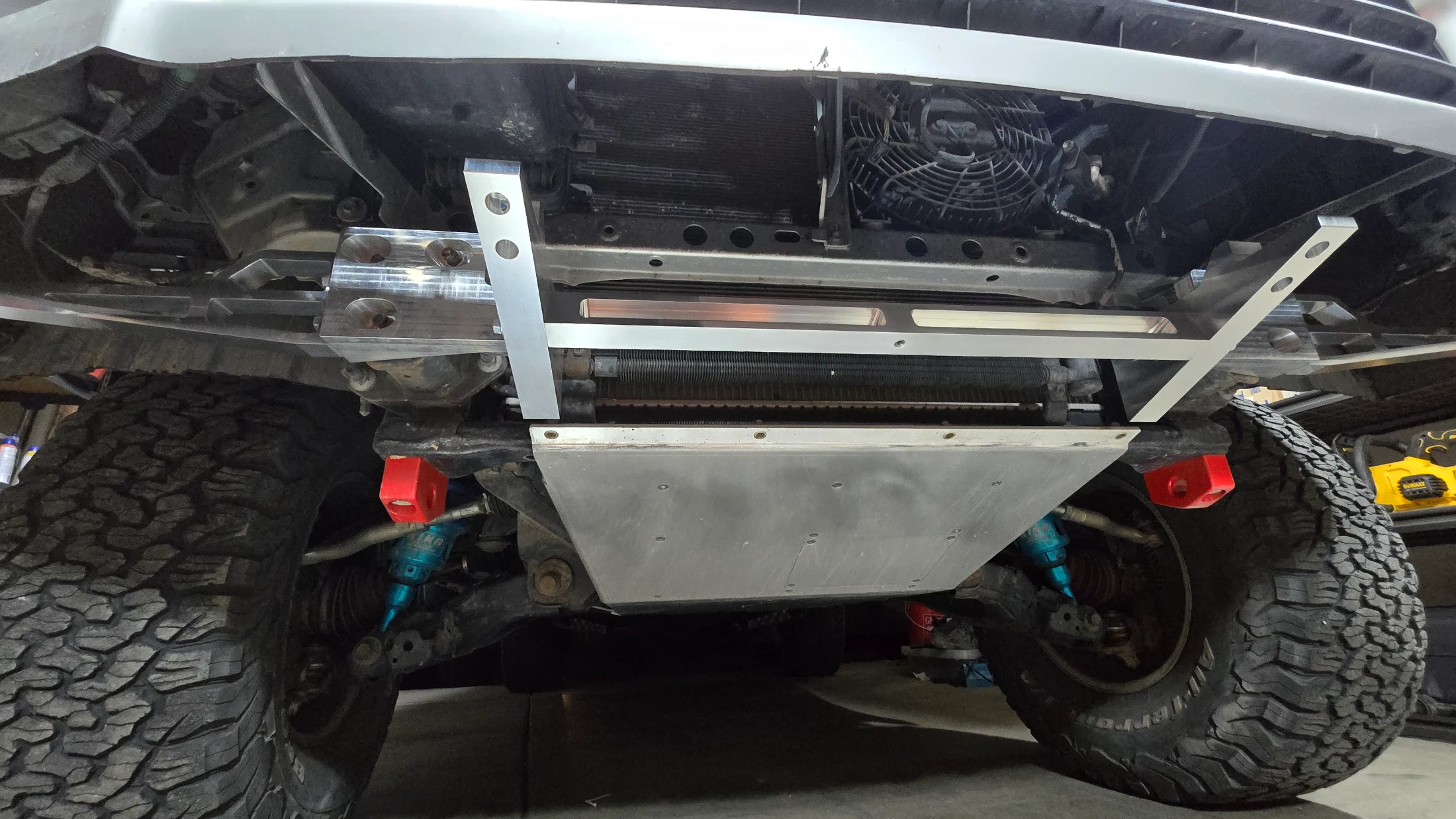

After the first test, I needed to cut another 1/2" off the plastic, I like how easy everything comes apart.
View attachment 4092746View attachment 4092747View attachment 4092748View attachment 4092749
This is a great solution, looks very nice and certainly increases clearance which is desperately needed, what is the weight on this setup? Using all the aluminum should be some nice weight savings but I read where you mentioned there was a 1" thick chunk of aluminum under there, that is some beef!! :)
Currently it is 48Lbs, it has pockets cut out of the 1" thick parts.
To add winch mounting, it would probably add at most 10lbs.
Crash bar is 22lbs
Other things removed is probably 10-20lbs
I don't notice any additional weight.
I also painted some of the bumper parts black.

It really looks incredible, great job!
I like the black wings with the Al center skid

After this weekends desert trip taking some woops the size of Moon craters I found a bunch of love marks on my front bumper. I’m thinking this setup would solve that issue easily :)
The approach angle is definitely better. I'm not sure if I'll make more of the bumper or not, we will see.
