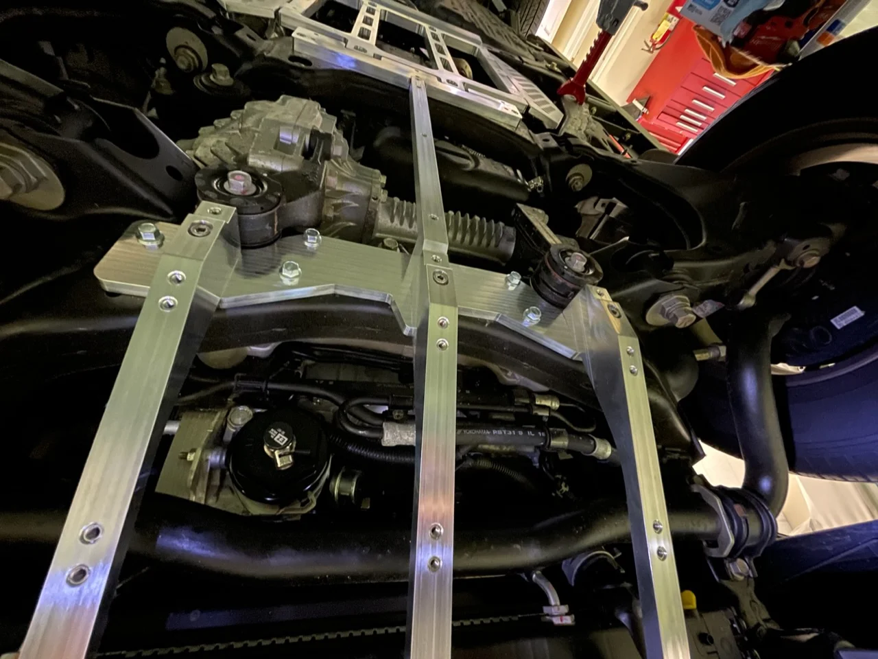

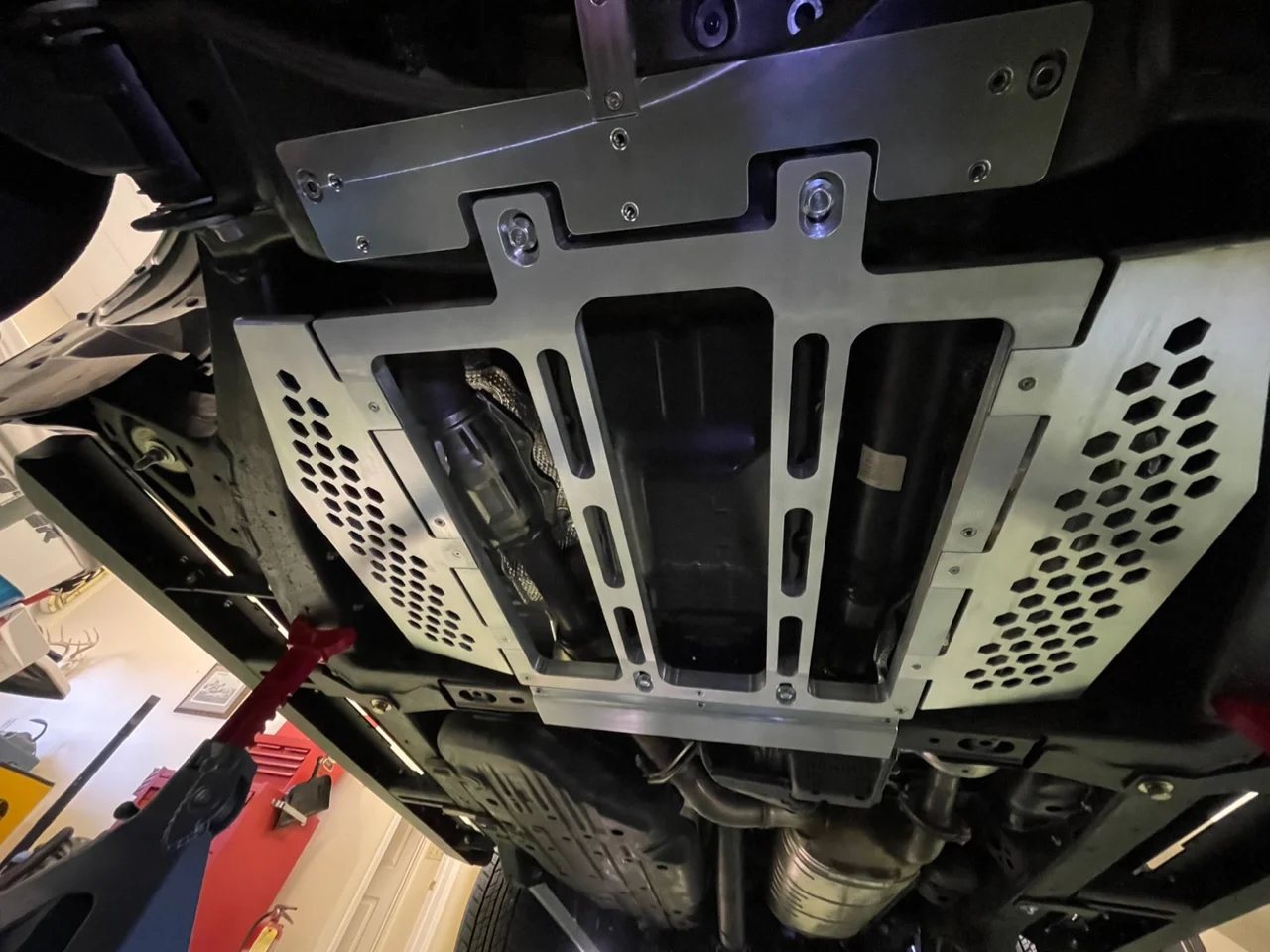

Well the cat is out of the bag, a few of us were early adopters/late pre-production beta testers for @turbo8 and his new all aluminum skid plate system branded under his company E&E Off-Road.
I was drawn to this skid plate system because it was aluminum (60lbs) so it would keep the added weight to a minimum and because it was the most streamlined/cleanest flush belly design on the market. There's no exposed hardware, everything is completely flush and it all ties into itself from one panel/skid to the next. Access panels to both the oil pan drain plug as well as the oil filter helps aid in making your oil changes that much easier.
The transmission subframe is insanely stout, made from 1.75" thick 6061-T6 aluminum, the subframes are simply a work of art. To round it all out, all of the hardware is stainless, lord knows we don't need another thing to help accelerate rust under these pigs. The vented theft deterrent panels for the front cats is an added bonus as well and rumor has it that he will be releasing rear cat deterrent plates alongside of the t-case skid he is currently working on. The install took me roughly 3.5 hours to do solo, while completely on my back on the garage floor (this included removing the factory skid plates). If you prep the hardware with Loc-tite prior to the install and grasp a good understanding of how the system fits together prior to crawling underneath the truck one could easily cut an hour off of the install, possibly even more if you have access to a lift.
There are a few tweaks being made to the final version and the t-case skid should be an added option soon as well. I am happy to report that I have experienced zero noise/rattles/squeaks from the skid plates after driving over rough surface streets and on the highway at speeds of 70-75mph. IMHO this is one of the most thought out skid plate systems for the 200 series currently on the market. I know that some prefer the durability and ease of slide/glide of steel skid plates, but if you're looking for an insanely clean design and aluminum material to help keep the weight down then this is quite possibly the best skid plate option available to the 200 series community. Not to mention that it helps support a fellow 200 series owner and forum member.
I've added a few pics of my skid plates below both during and post install. I invite the other early adopters out there to add to this review along with their pics and opinions on the kit. I for one am grateful to finally have proper protection to the underside of my truck and I am proud to have these particular skid plates adorning the belly of my Cruiser.

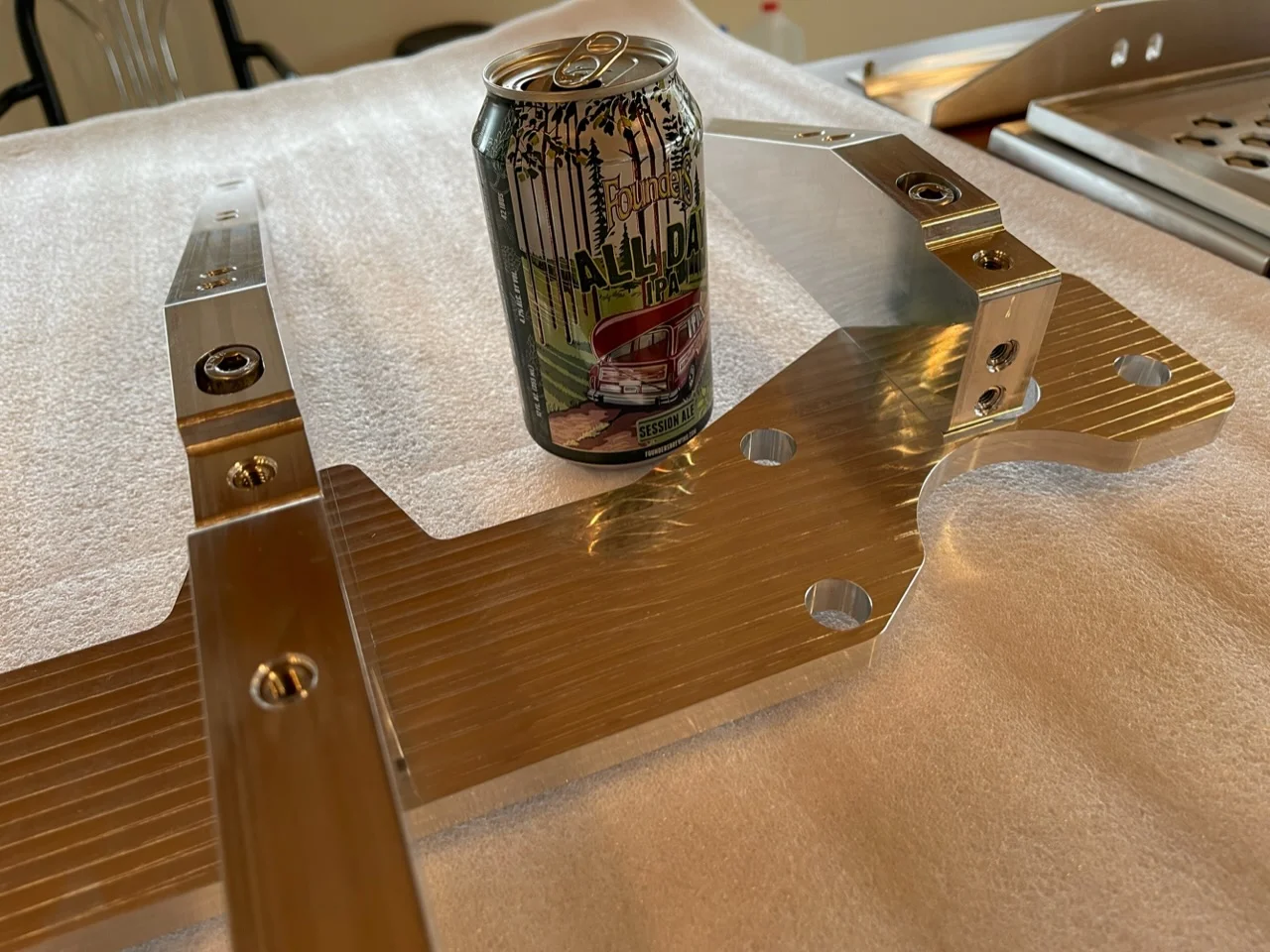

According to my calipers the skid plates themselves are just shy of .250" or just over 5mm. They are made with 5052 Aluminum which would make them very similar to the construction of the Dissent, Coastal, Rival and any of the other aluminum skid plates that I have seen available for the 200 Series LC. I would very much place these in the full-on off-road use category and just as strong as any of the rest.
The main difference I see between what E-E offers in terms of their design philosophy is that they build the subframe as an independent piece for the skid plates to mount to instead of molding/shaping the skid plates themselves to the contours of the undercarriage like most others. This allows for a completely flush underbelly with no exposed hardware to snag or deform and a fluid connection from one skid plate section to the next.

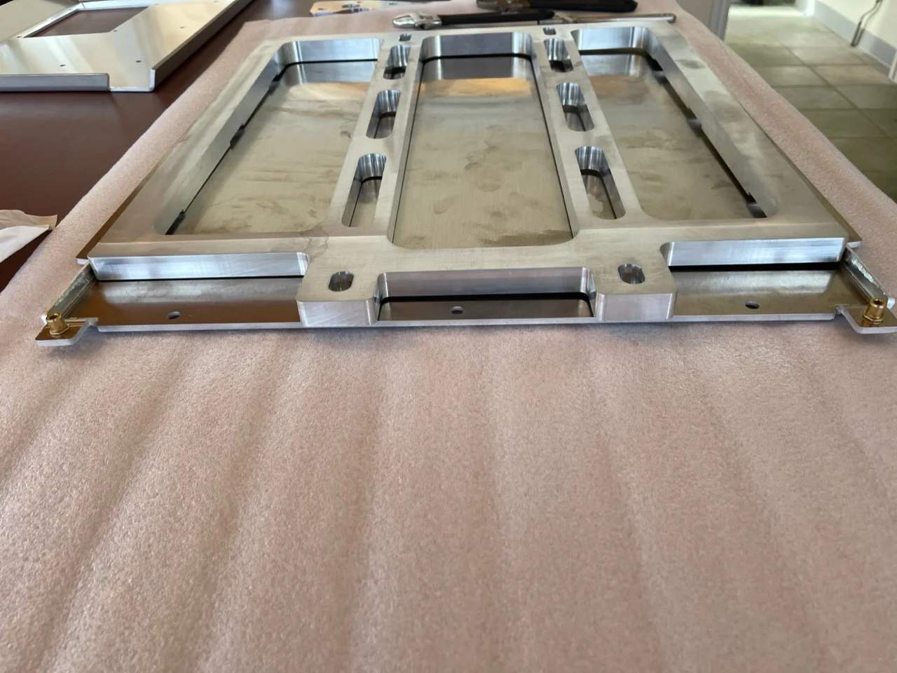

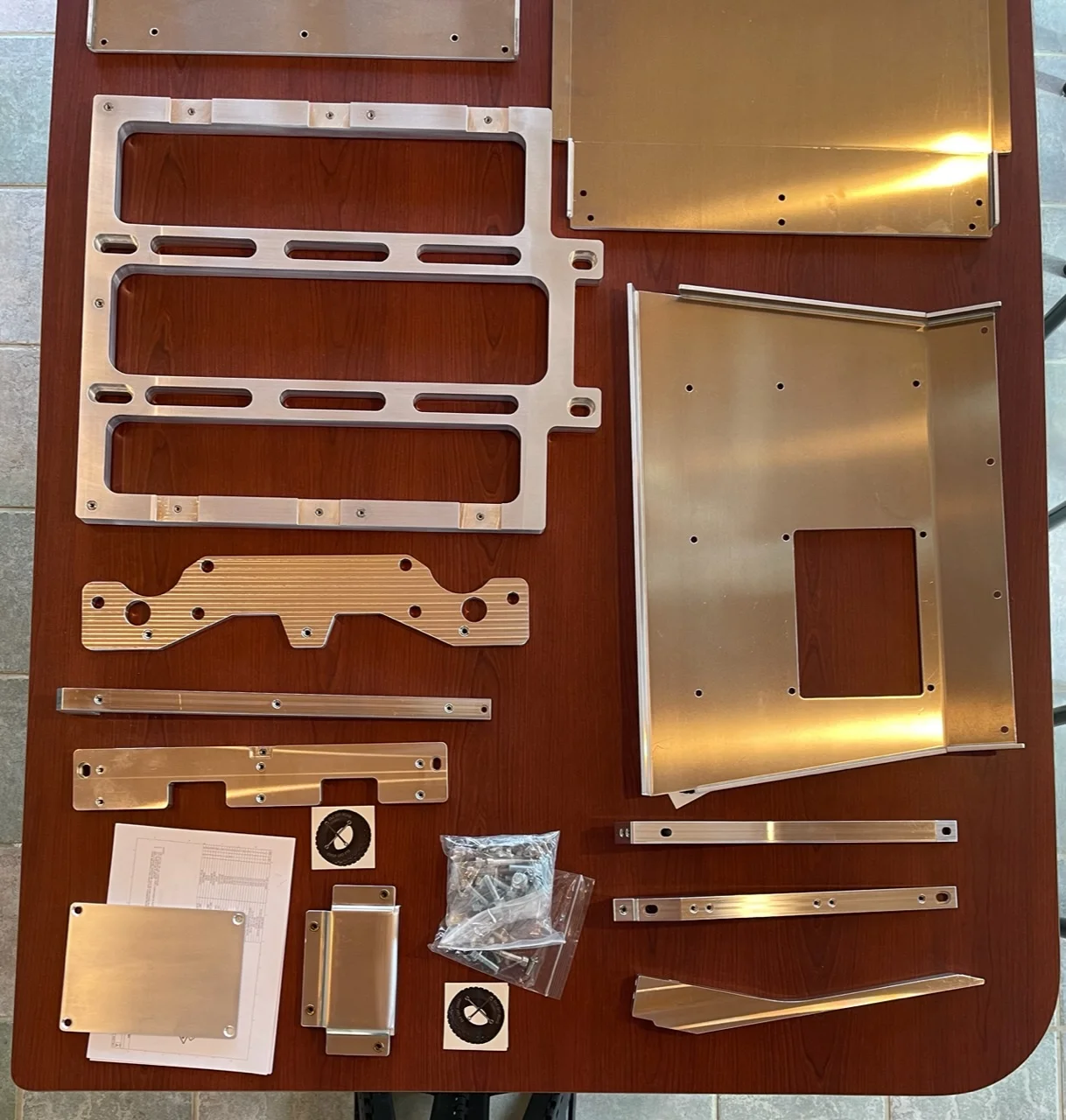

I also installed a set of the E&E skids. The subframe that Oliver produced is hell-for-stout. These are seriously strong skids. I have no idea how you would quantify strength in skid plates, but I am seriously impressed with the craftsmanship and engineering that went into this system.

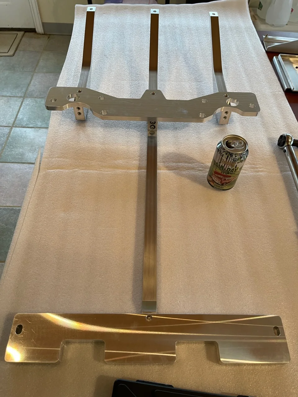

I’m assuming that only hard use and time will tell how strong they are in comparison to what else is on the market. Like @Tex68w said above, I would expect these to be as strong or stronger than any aluminum skids currently available. Here’s some pictures with a beer can strategically placed for perspective on scale.
@turbo8 ... someone who can actually design... These unboxing pics are fantastic!

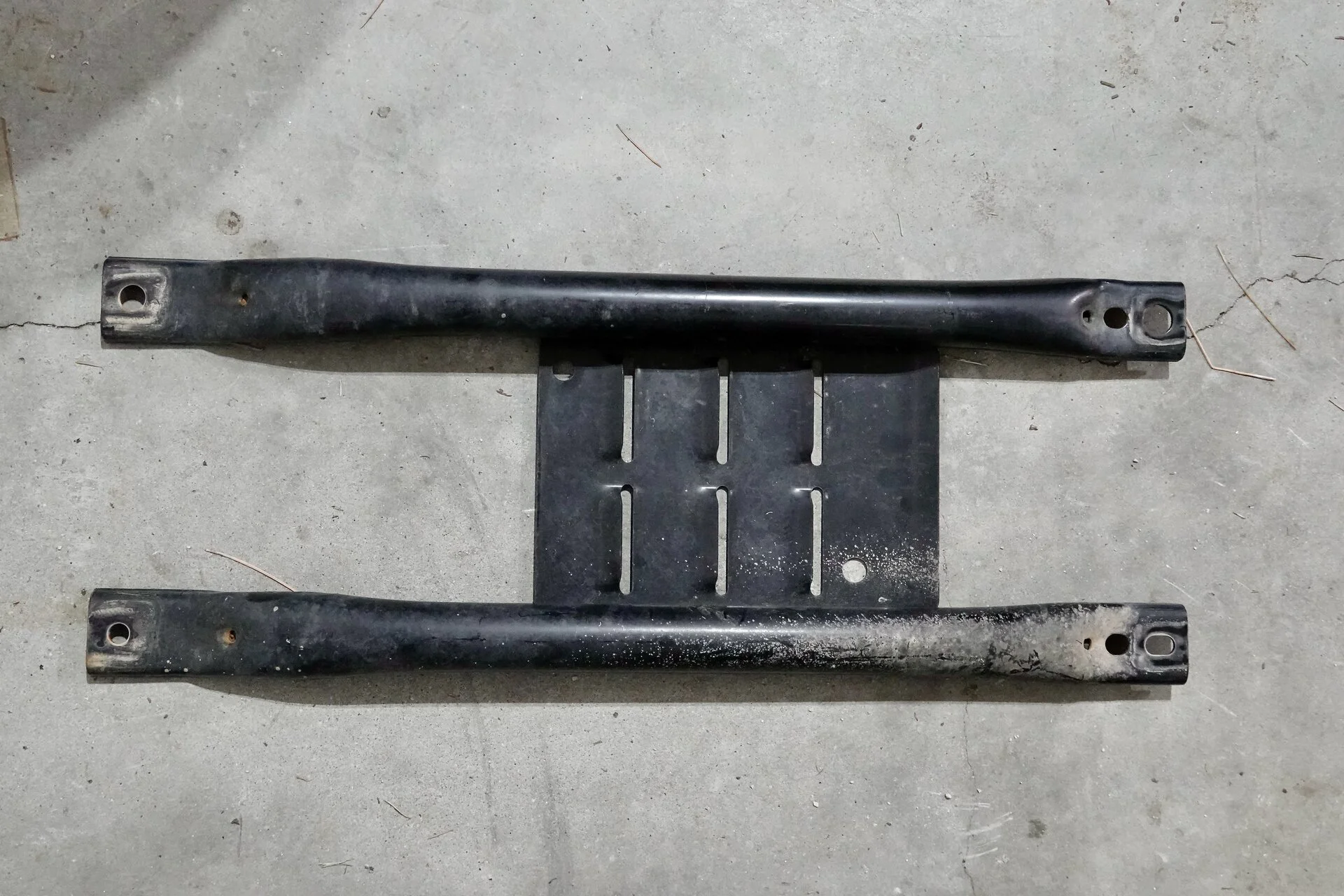

Did that include the weight of the 2 metal braces that get removed under the factory splash guards?
If you are talking about this, then yes:
There is a small plate that is directly beneath the transfer case that does not get removed with the Slee system.
